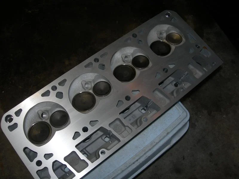

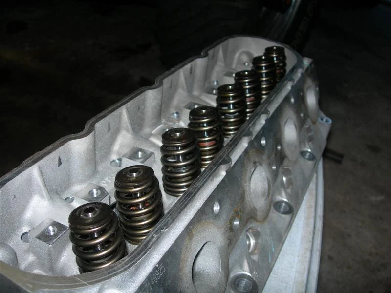

here are some shots of the rebuilt heads and the oil press adapter. Also showed the water temp...
new head has comp cams springs and retainers in it, and the block has new comp cams pushrods. went together pretty well. hopefully tomorrow i ge tth eecu back...

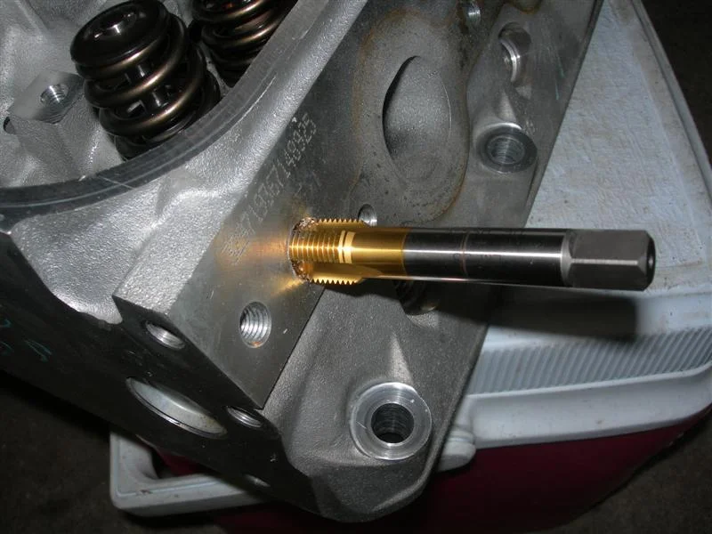

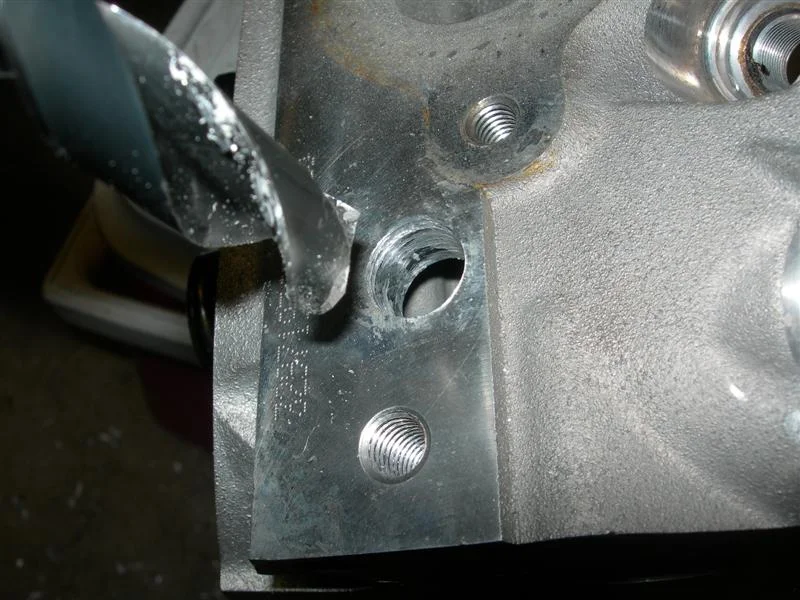

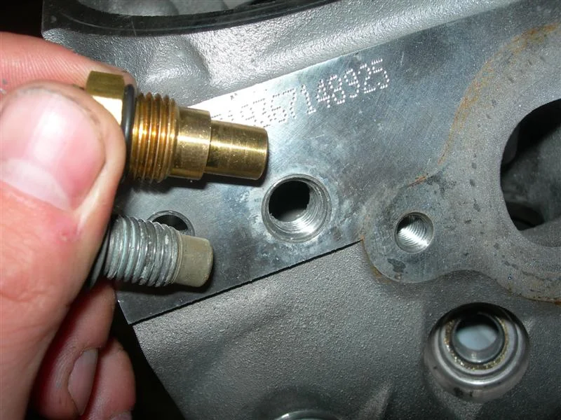

For the water temp, i used a blocked off hole in the right vortec head.. it had 12 x 1.5mm threads in it so i had to drill it out to 14.5mm and tap for the factory 2f temp sender which was 16 x 1.5mm threads.

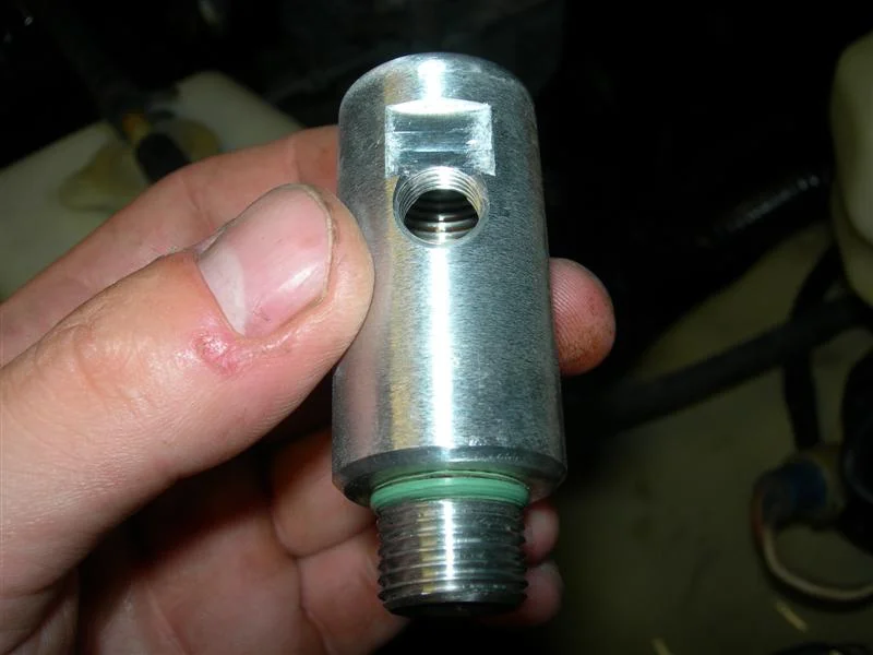

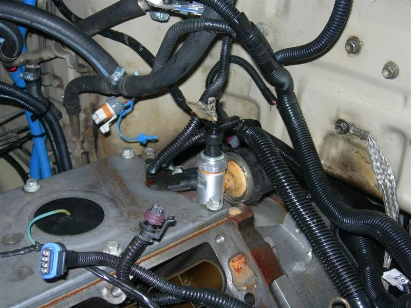

here is drilling and tapping... also a shot of the oil press adapter. the vortec oil press sender had 16 x 1.5mm threads on it and the 2f oil temp sender had 1/8" pipe threads. had to make this adapter since there didn't exist and fittings that i could find. Dan Hart at work machined it for me (thanks a billion dan!!)

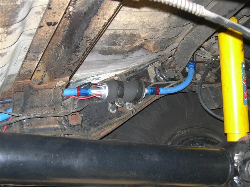

here is a shot of the oil press adapter installed and the fuel pump location also. I used -6an push loc hose for the whole fuel system. basically did a hose clamp on the feed line with the -6 hose to the pre filter for the pump, then the pum, then -6 hose to the FPR.. then -6 hose from the bypass port to the hard line return that was already in the engine bay.
hasn't leaked a drop and i tested it to 100 psi.

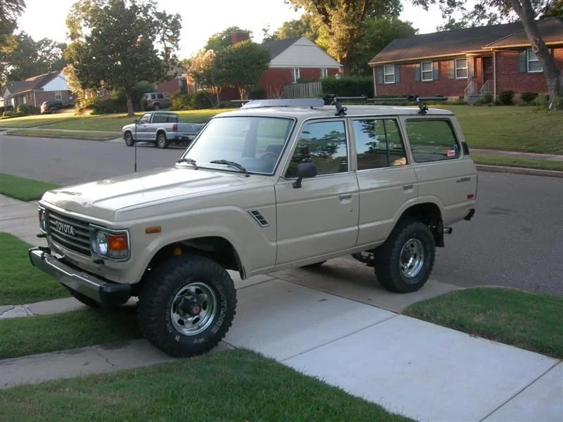

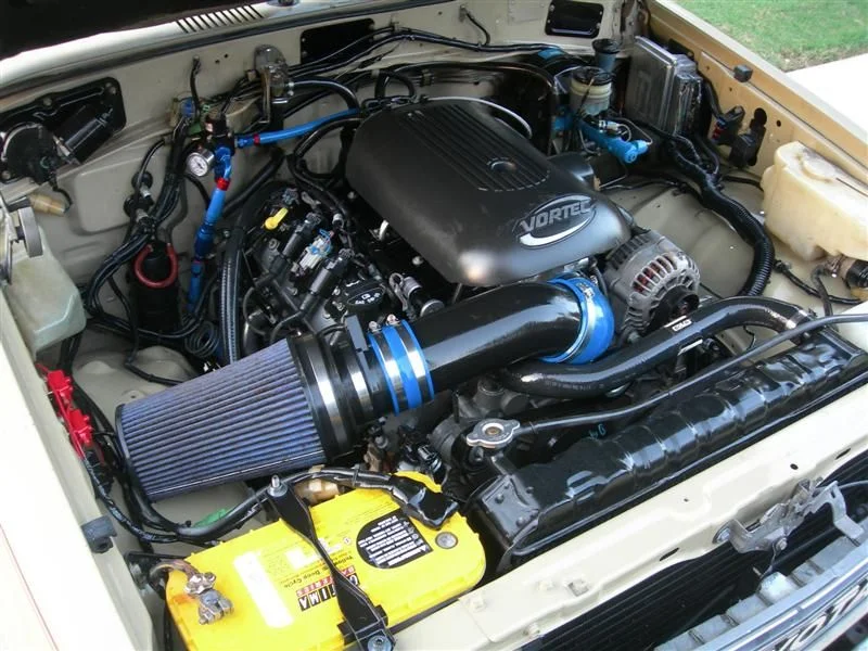

man, after seeing Elberts truck i had to clean mine up. here are a fw shots of the swap done and how it sits. not really on level ground, but you get the idea. Still wrestling with the o2 sensor crapola... gotta get it sorted before making the move to Co at the end of the month.
