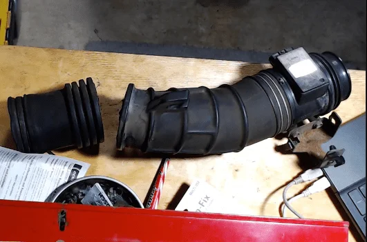

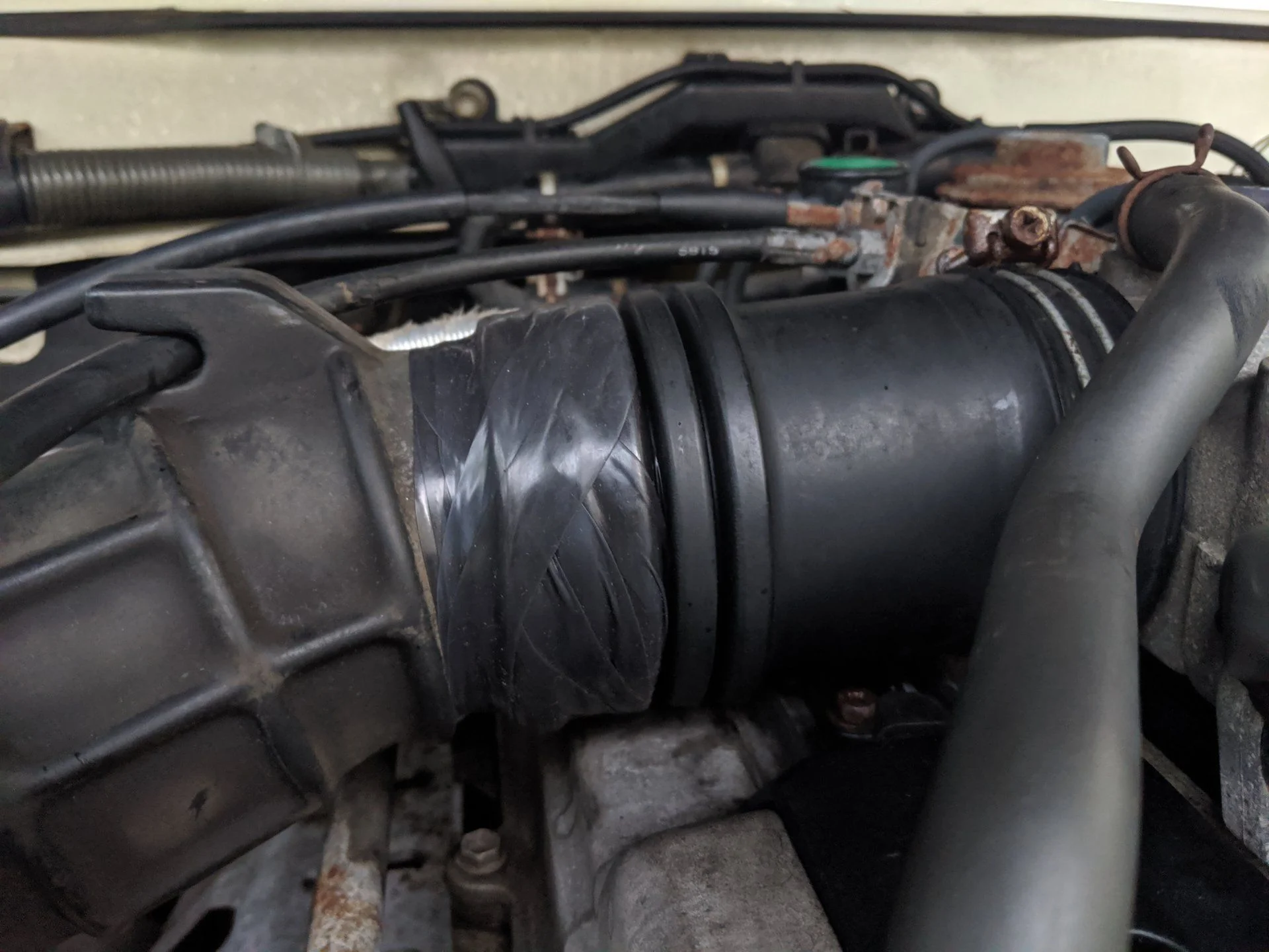

yesterday i did a tune-up for PM and to address a misfire. that all went pretty well, except for tearing the 326,000mi-old intake hose:
it wasn't very surprising, as the hose feels more like hard plastic than rubber at this point. i managed to get silicone tape properly stretched around it (after a few failed attempts) and i think the repair looks pretty good. i'll replace it eventually, but the tape seems sturdy enough that i'm not in a big hurry.

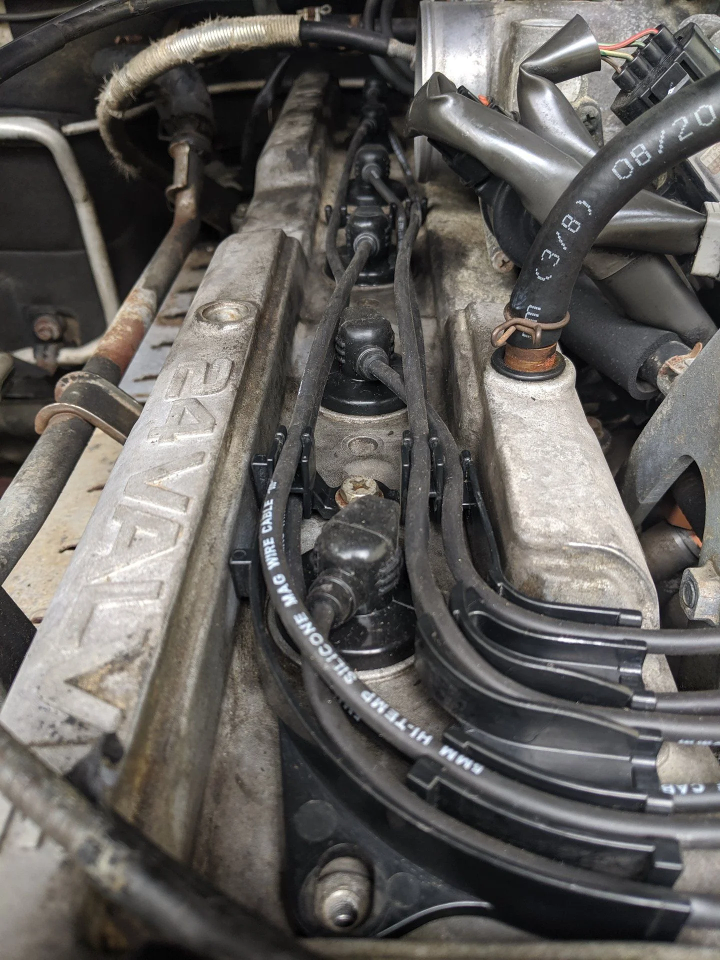

the tune-up consisted of:
  • plugs (Toyota)
  • plug wires (Denso)
  • distributor rotor (Bosch - but actually Denso?)
  • distributor cap (Bosch)
  • air filter (Denso)
  • cleaned MAF
  • wiped out throttle body
  • checked timing (about 3.5-4deg)
hooboy, i hope i don't have to service that #6 cylinder again soon. did the ignition system and HVAC system teams even talk? a slight angle to those hoses and the job would be so much easier. at least i can say that i have fully sat inside the engine bay.
note that i'm missing ALL of the loose wire looms/holders/separators. all the bolt-in ones are in good shape, but this came with none of the others. the Denso wires are also a tiny bit longer than the red ones in there before, so they're a little more chaotic when popping out by the distributor. i got them run pretty well to keep them off the metal, but i'm still going to track down some OE ones to give them maximum life.
