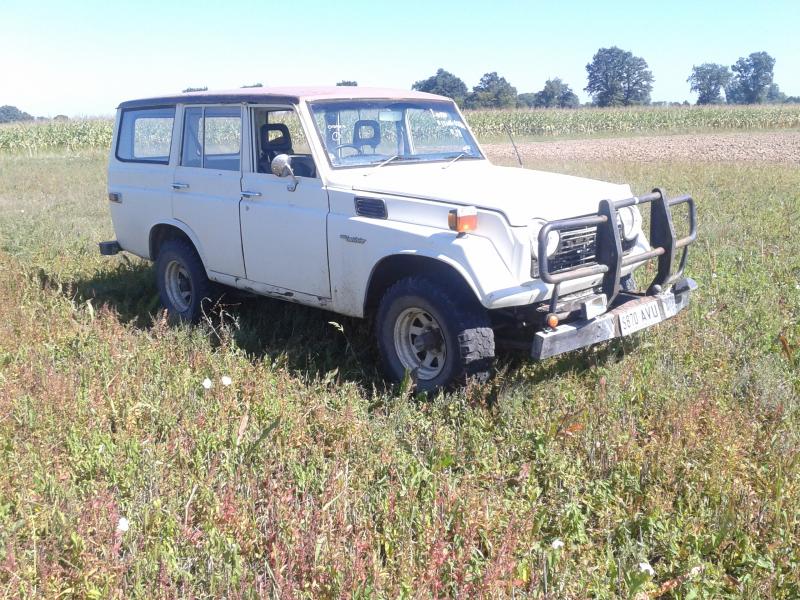

new pics
in the country

wednesday removed the bush bar, today removed the grill for cleaning and paint, and tryed the chrome bumper. Not too bad IMO.
