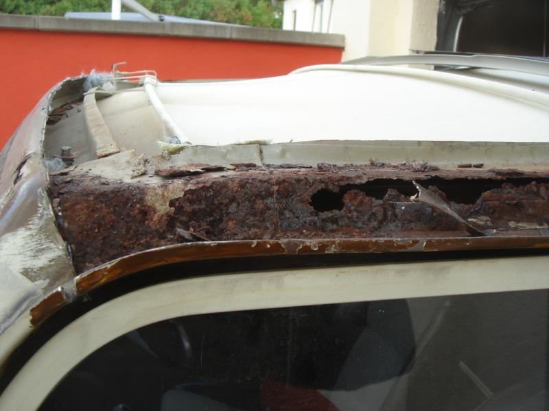

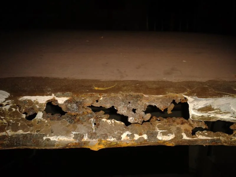

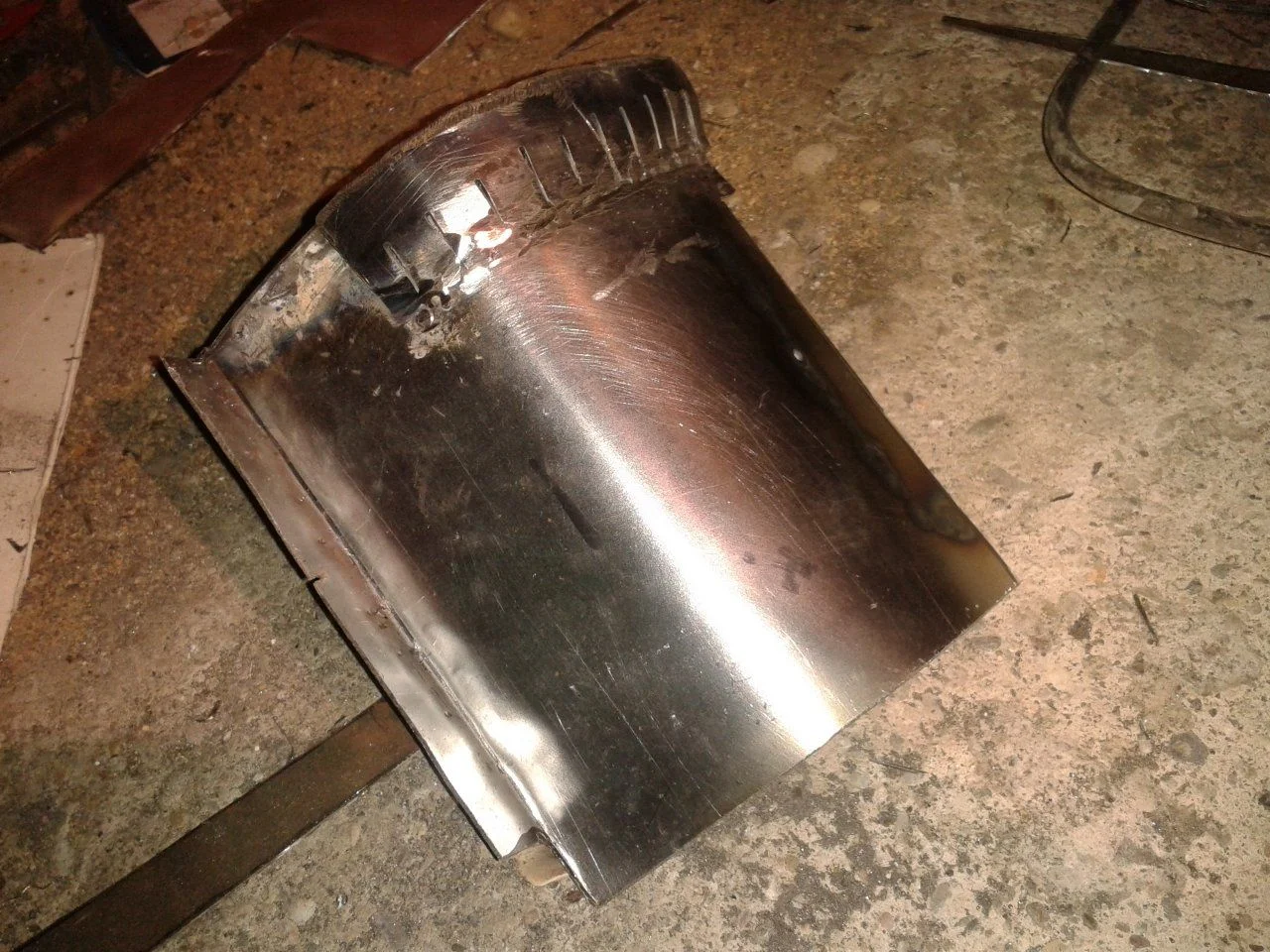

what I am dealing with. Rust, I cut patts of rotten metal and keeped elements to still have the curve of the roof. I will patch parts, then cut parts especially on the B pillar, then patch ...
Do you think I have to cut wider? I left solid metal even with surface rust

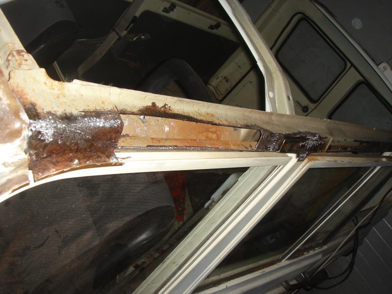

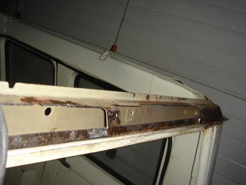

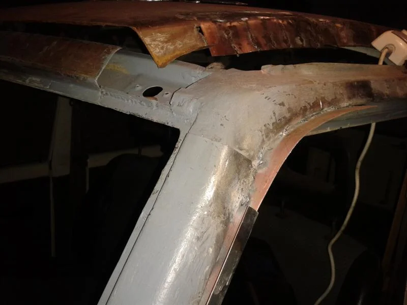

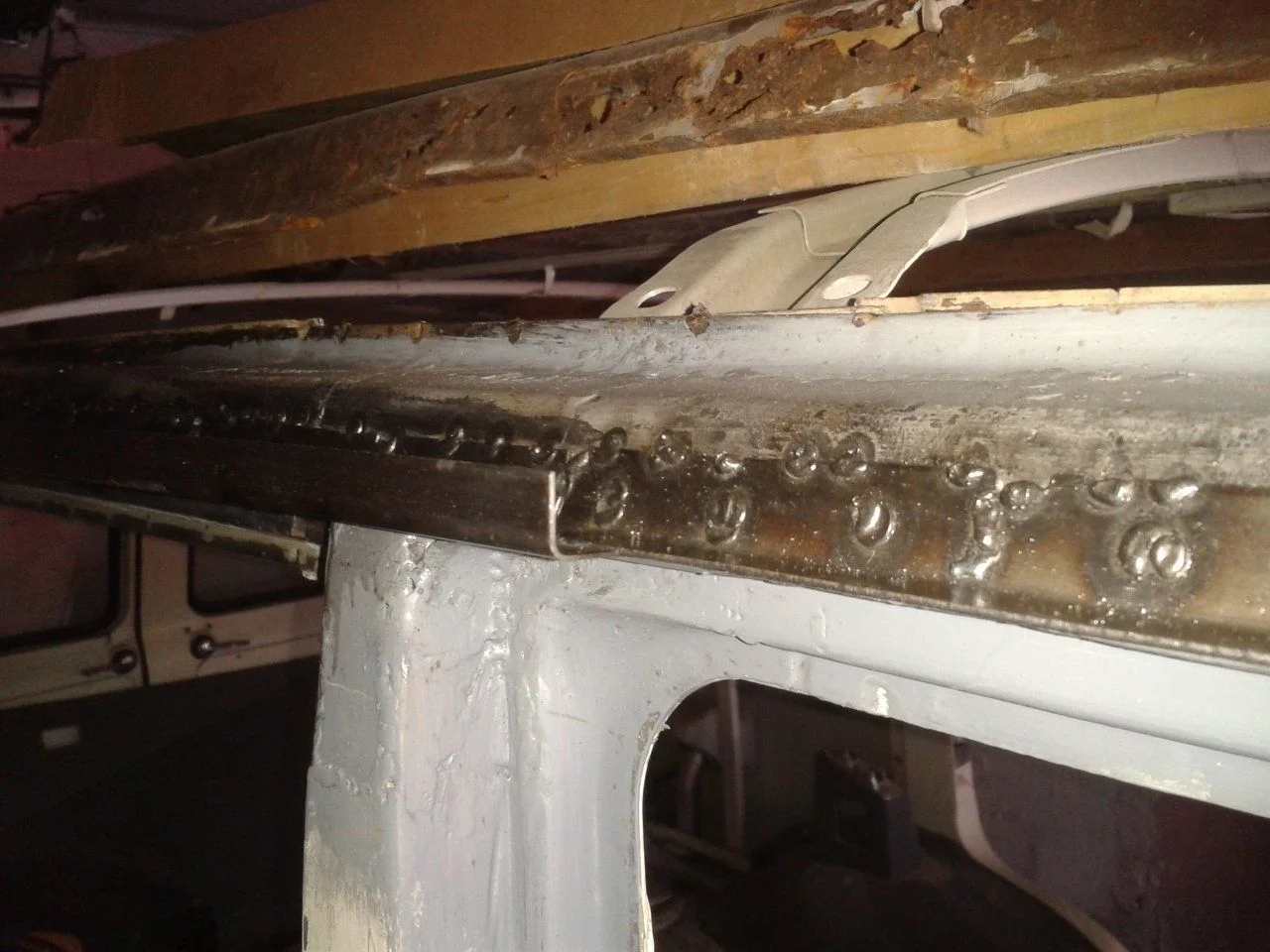

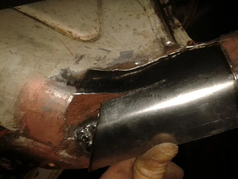

Rust to the A pillar, on picture one we can see the starting point. under the crack, much epoxy resin I guess, and a hole on ther skin and on the internal structure if pillar.
so I cut and weld, and grind, and made corrections.

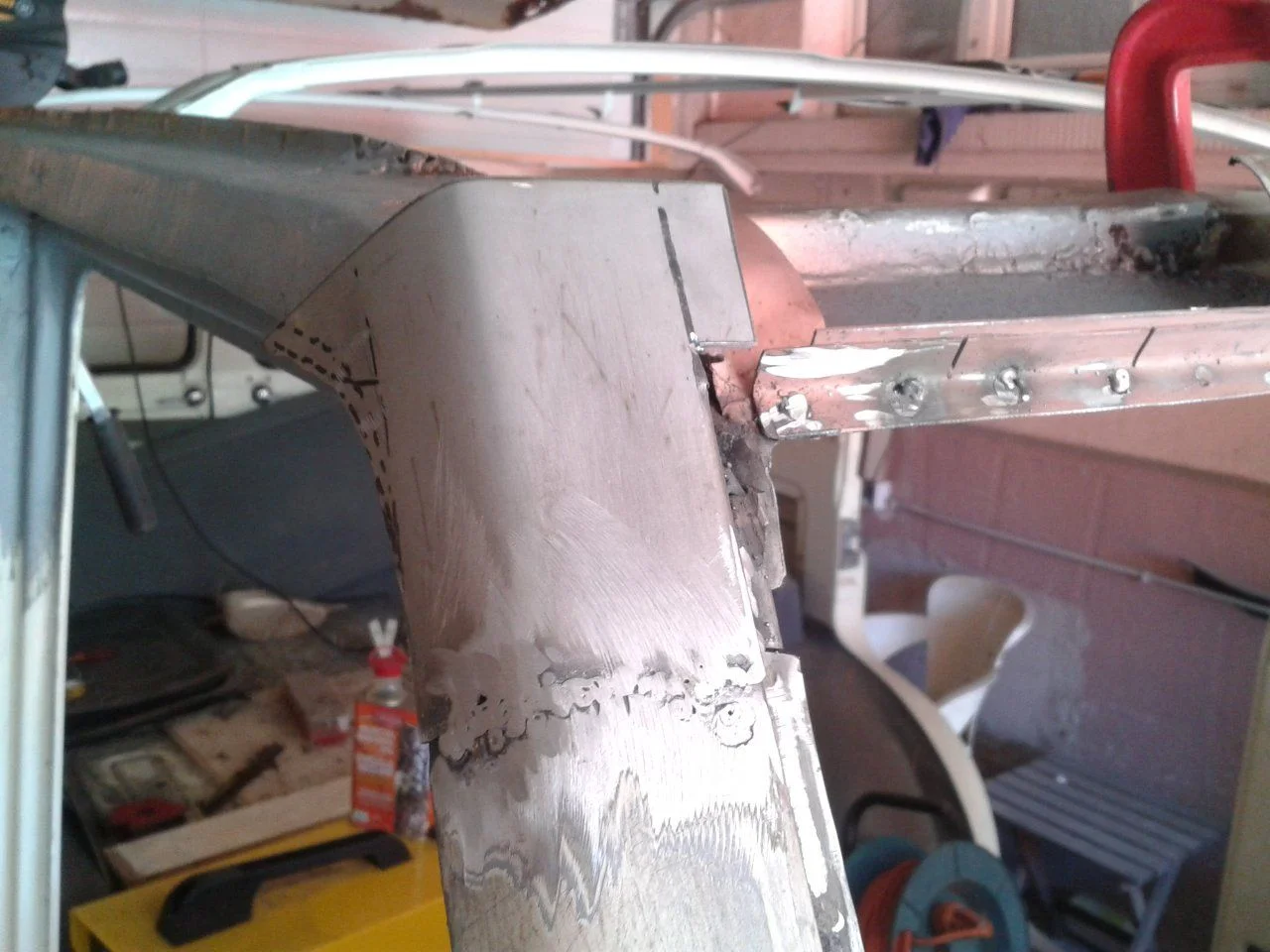

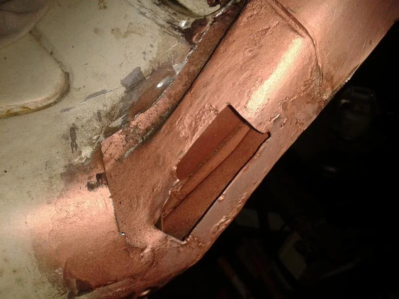

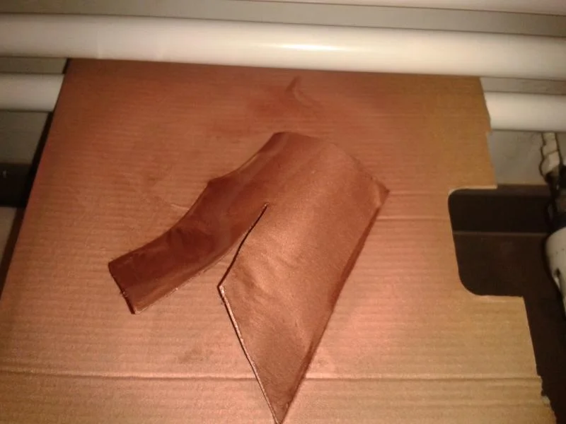

on following pictures, thee skin repair in progress, with sheet metal. I try to go to the more close to the original curves but I am not pro, so I do my best ant tomorow welding, grinding, welding.... tonight thne weld througf copper primer will dry.

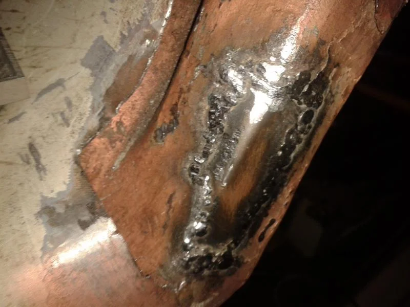

gone to the shop today and asked the seller something to weld through, He said yes with copper, and it was done, UPOL product, no more informations

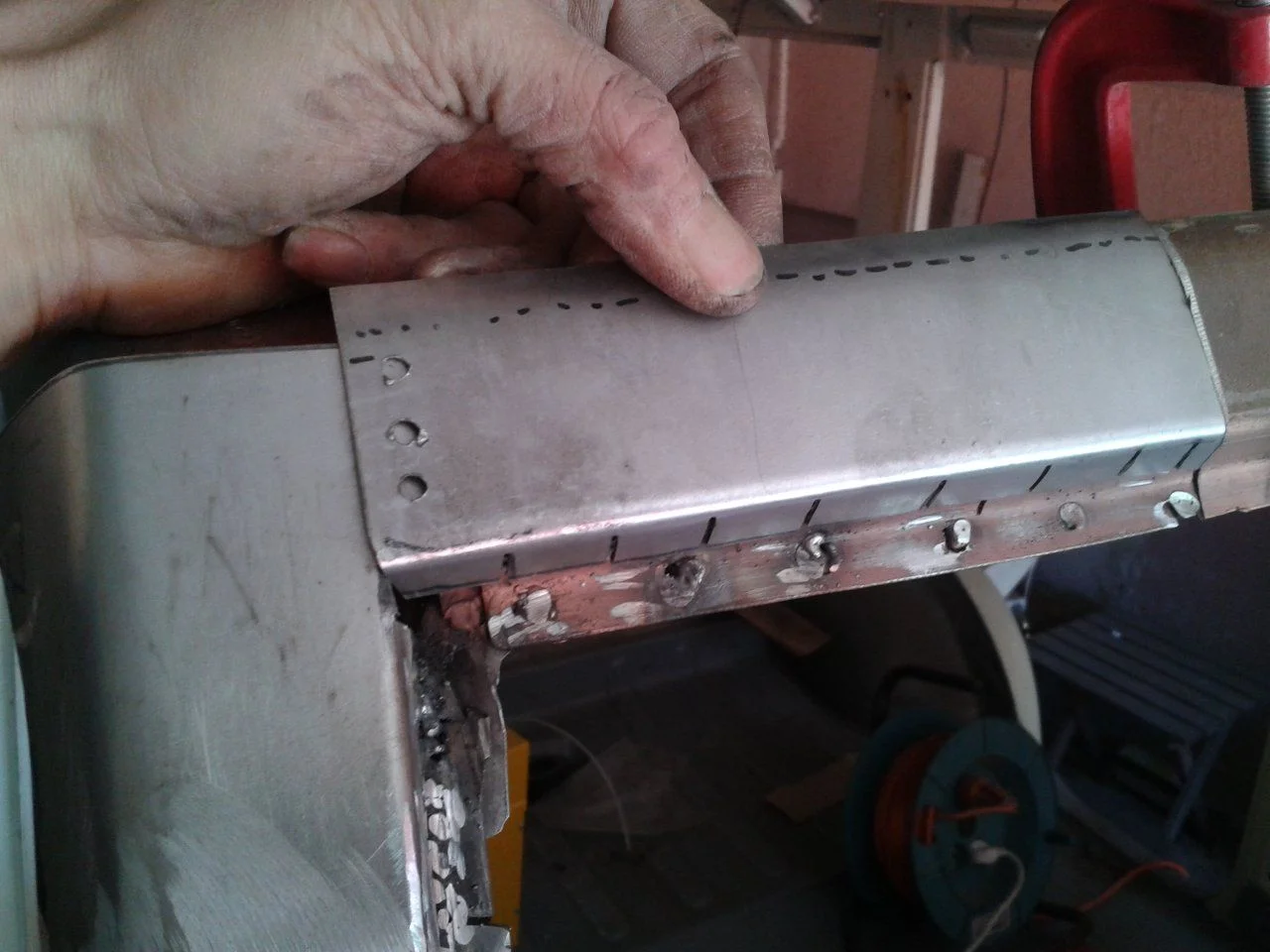

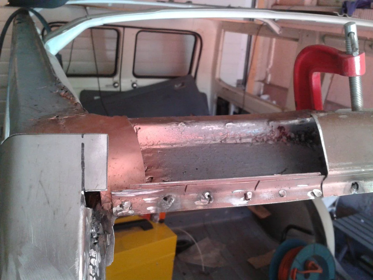

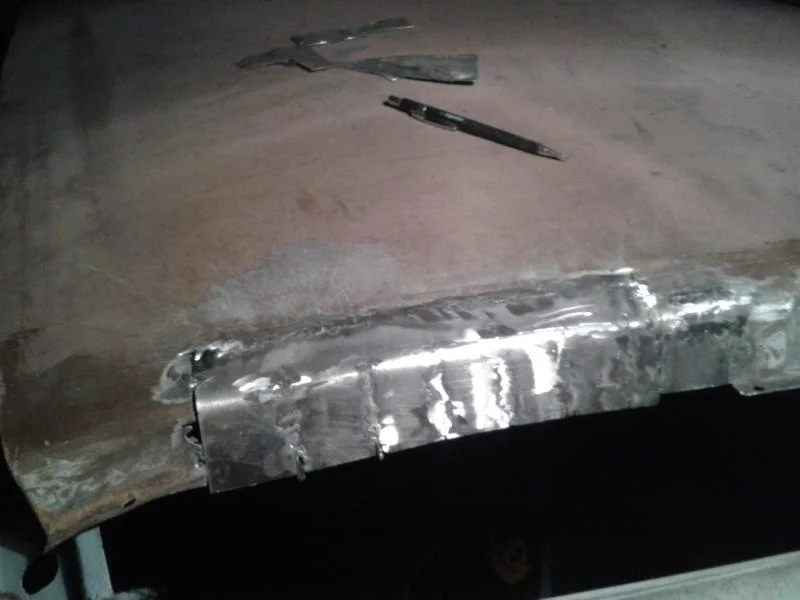

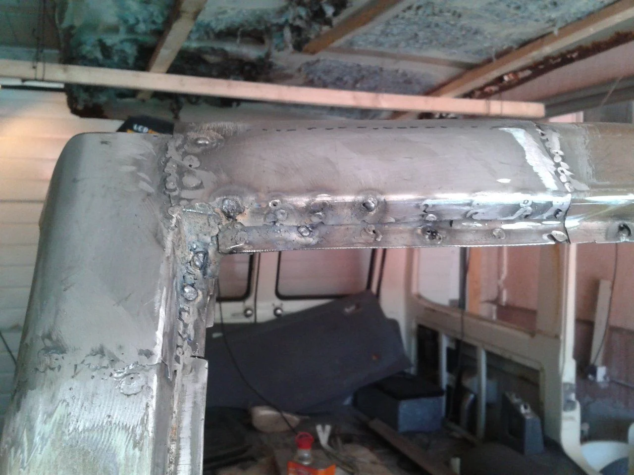

Some progress, Had to imagine how to make new gutters, so I bought 15x15 mm corners profile, welded it to shhet metal, and welded it to A pillar. some pics of roof repair trial, I am not happy with it, cause it will need too much bondo, so I plan to redo it. last picture is the left rear roof to fix.Amazing hoh the roof is shot and down is in good state.

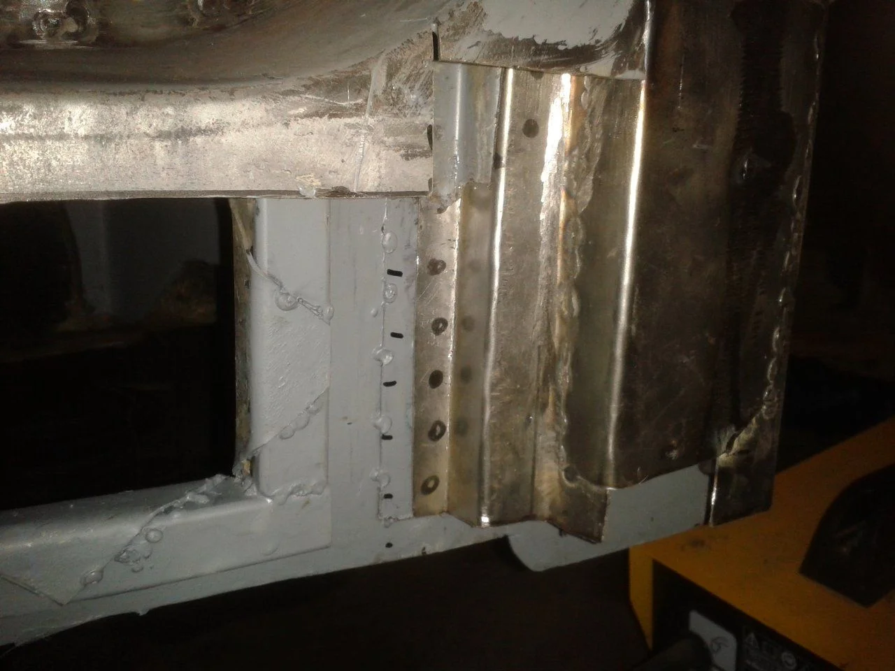

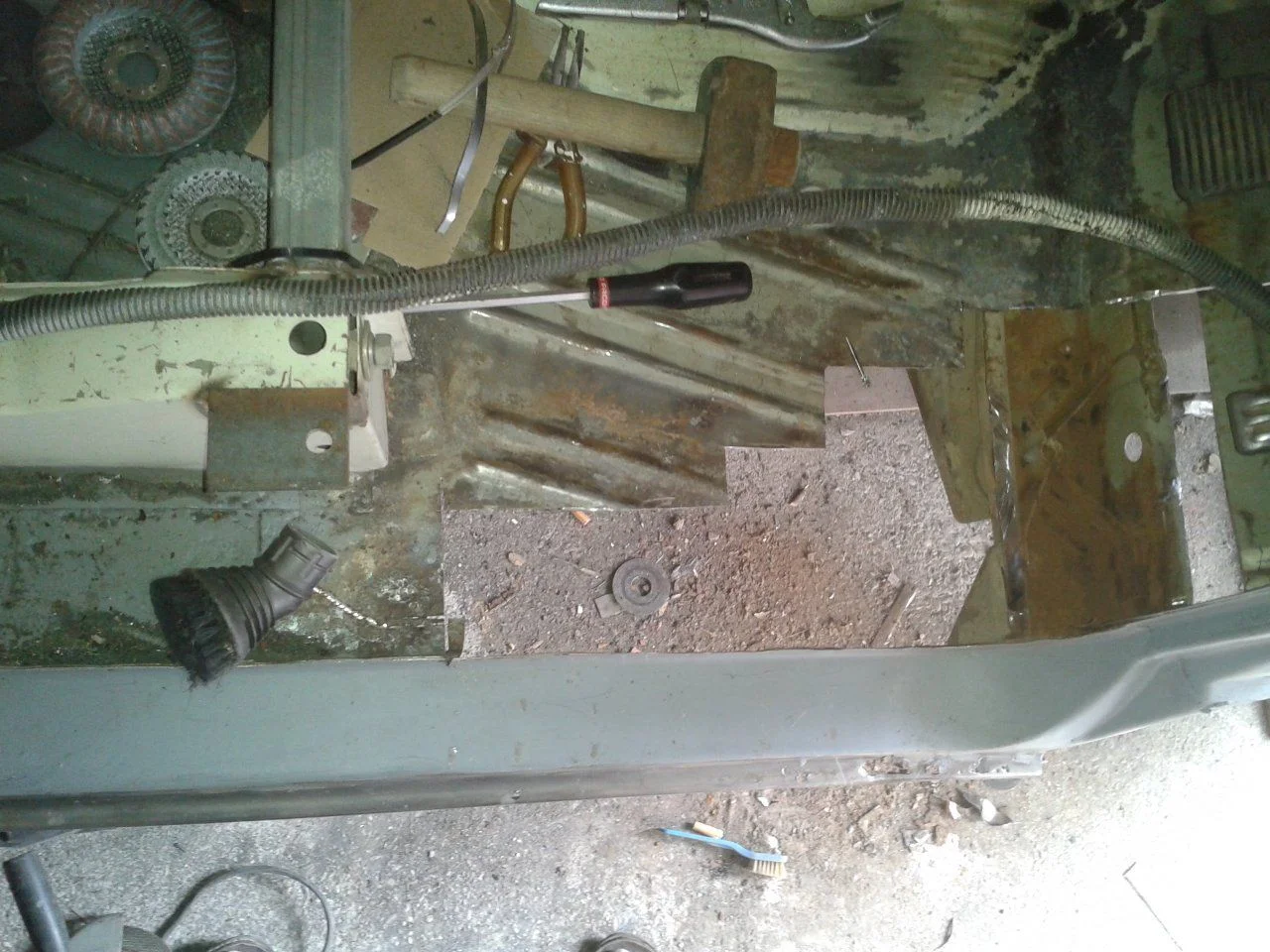

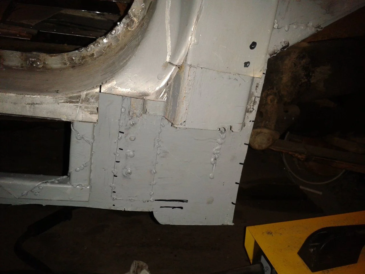

some more work, quite finished gutters repro, wider and deeper, and some pictures of the rocker puzzle, with some aussie dirt, and picture of the floor . The body support is in good shape, ant it is amazing the quantity of dirt I foud in it, treated with phosphoric acid ...

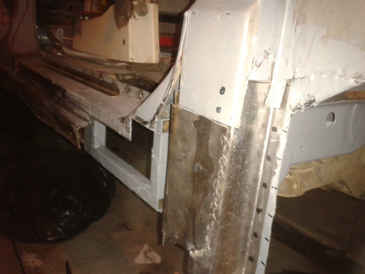

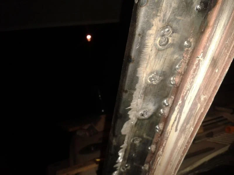

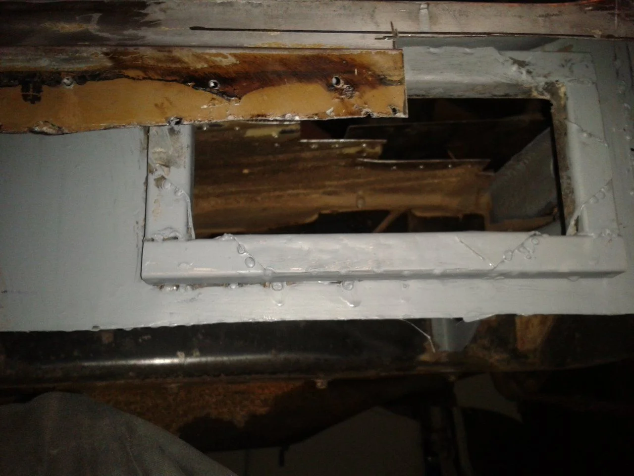

today I build the internal structure of the rocker, with a door to access to the insideso I can paint after the welding. made a frame welded to the inside to keep the strenght.. then prepared the A pillar to paint and weld tomorow...

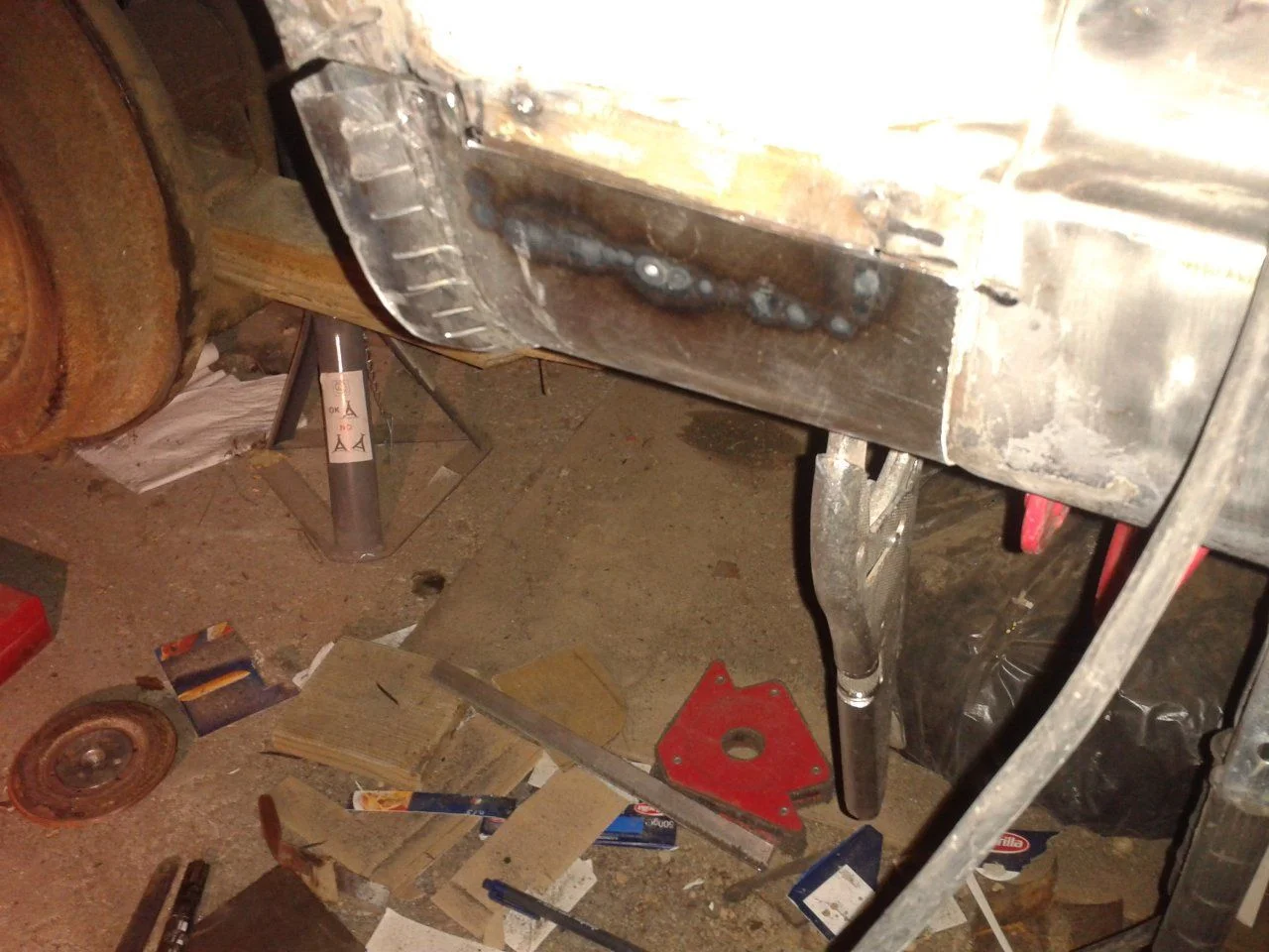

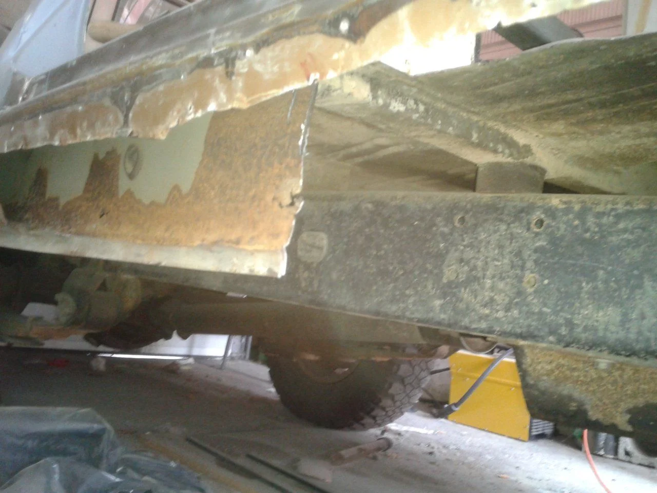

Rear driver side rocker work, The lip gave me a quite interesting challenge, tomorrow filling the holes, smoothing all, inside paint and some weld if possible.
