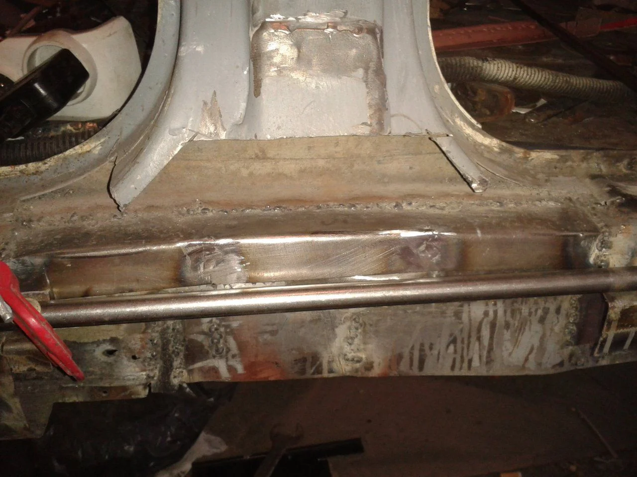

Today's work ,rocker profile fab, to the B pillar
