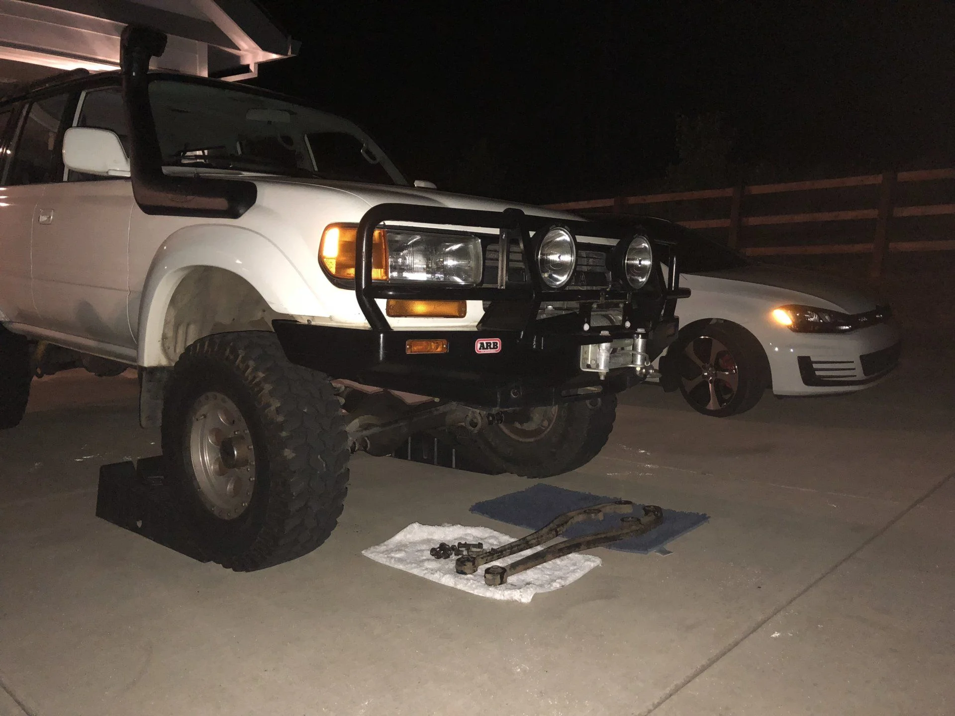

Didya have both control arms off at the same time?! Nice looking truck.
A few more pics, the one with the fog lights up high was the first day she came home... fixed that bad idea right away as the previous owner had them rubbing on the hood...
I did! It was not that bad of a project, and it made such a difference in the drivability of the rig

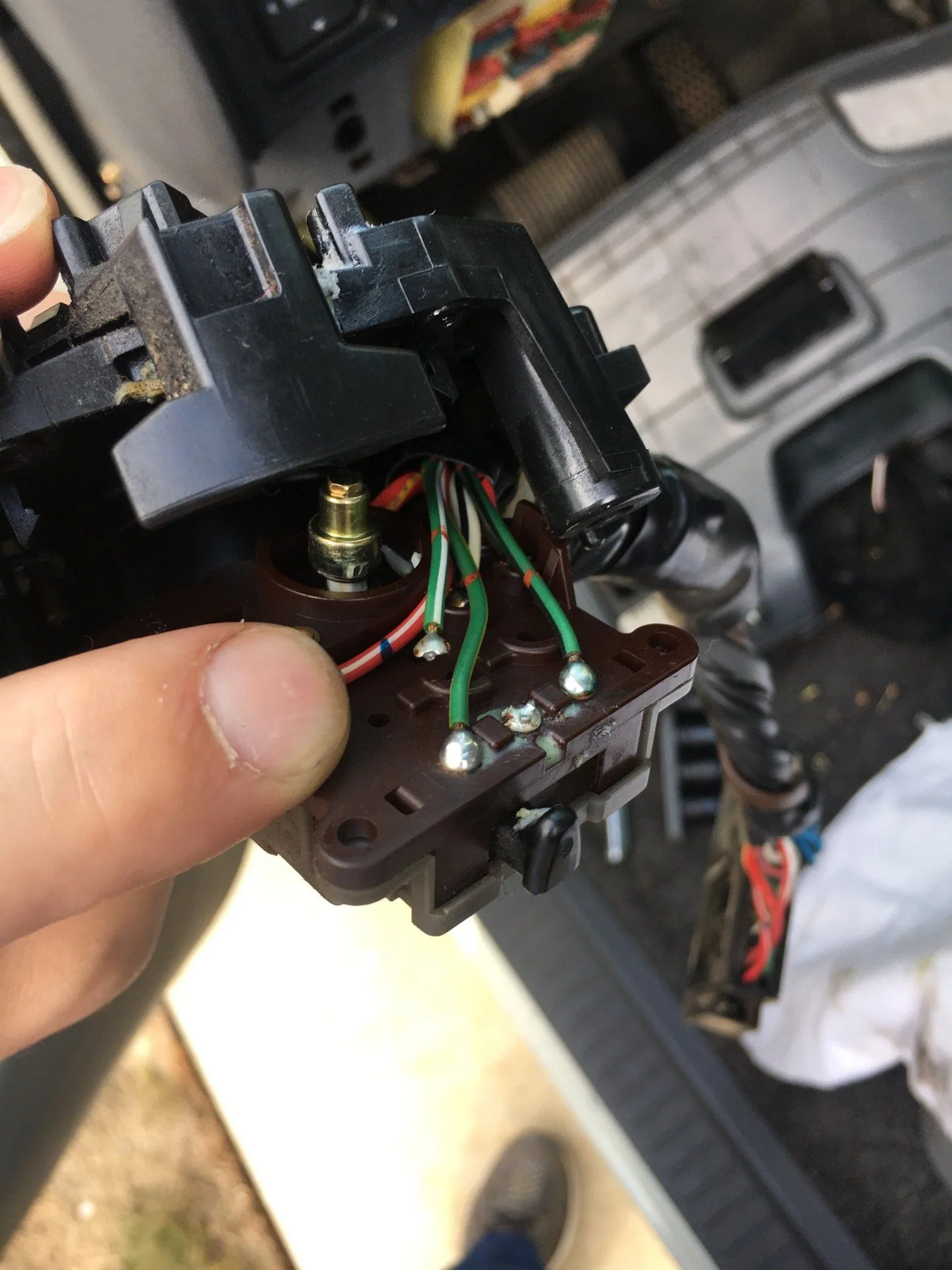

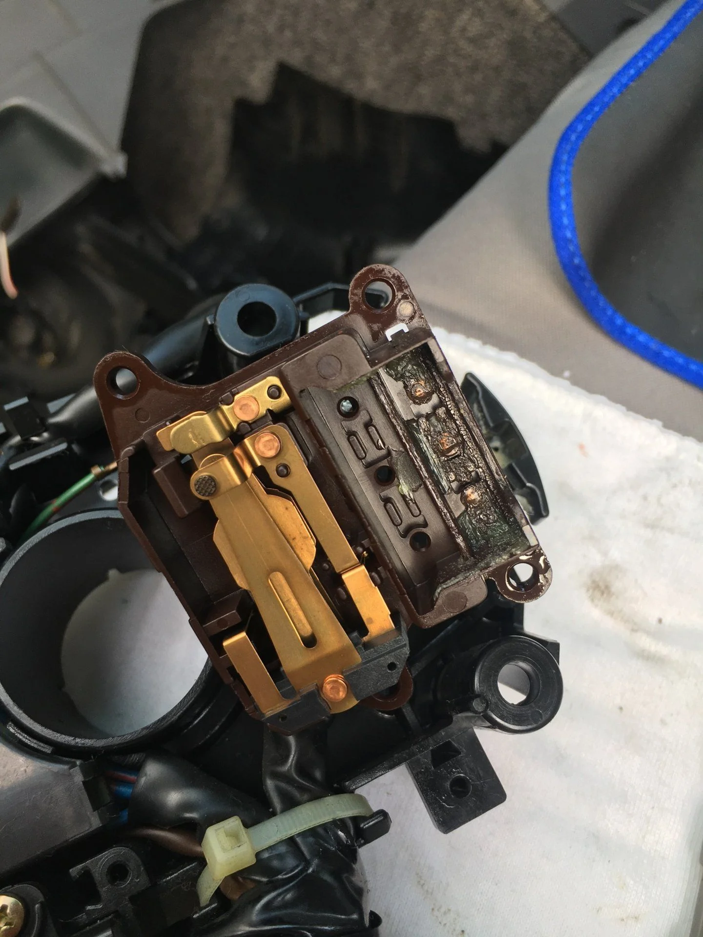

About a week after it came home the turn signals stopped working, took it apart and found a solder point had come off. Cleaned up the contacts while I was at it and fixed the bad solder point. Back to having turn signals for a whole lot less than a new switch!!
