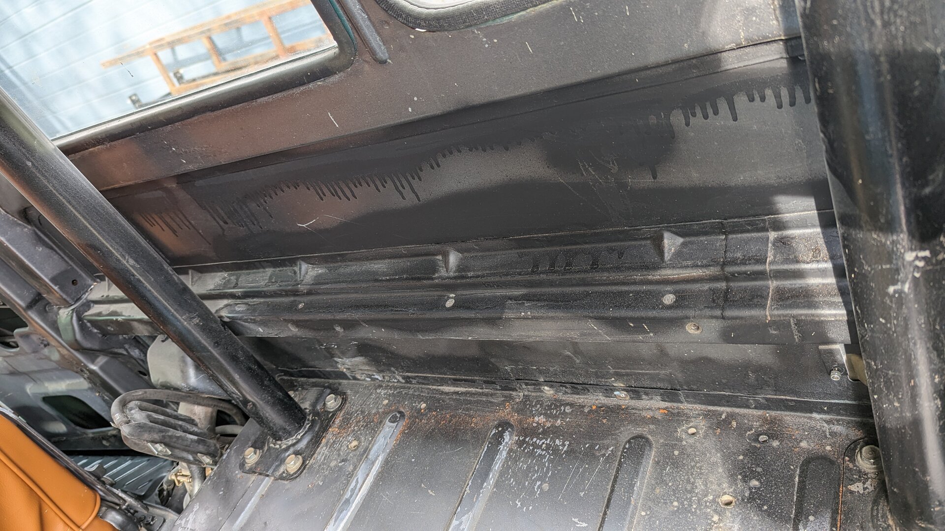

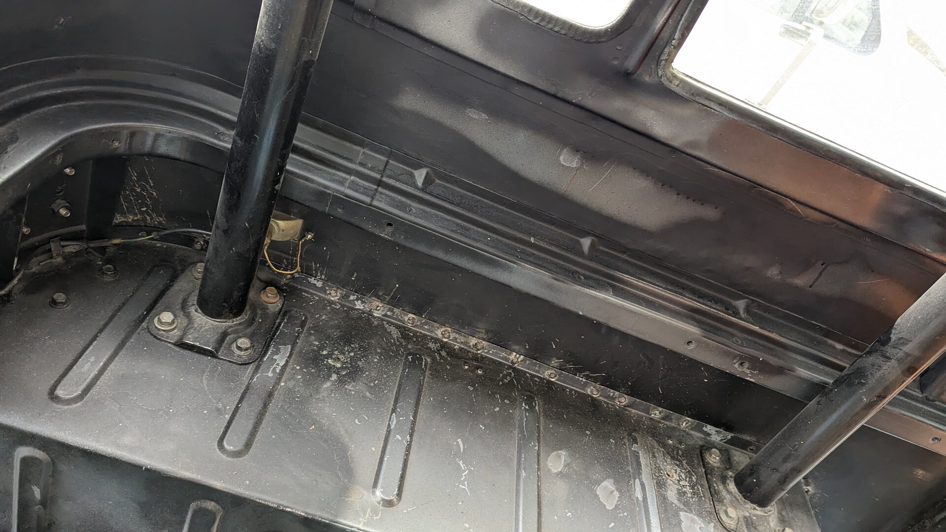

I'm planning to paint the rig this summer and am looking at taking the top off to begin work on the gutter and the sides and any more rust that I find.
I did a look around and it seems like I'm missing all of my screws that hold the hardtop sides to the tub in the back. Aren't there supposed to be screws along here? I've got nothing but empty holes.
Yeah you're missing the bolts. There's some places that sell replacement bolts for the hard top at a reasonable price. Shouldn't be too big of a problem.
I figured as much. I've done 70 mph plus in this thing without those bolts. Not the safest thing I've ever done... I guess the ambulance doors keep the backside of the hardtop locked down, but still.

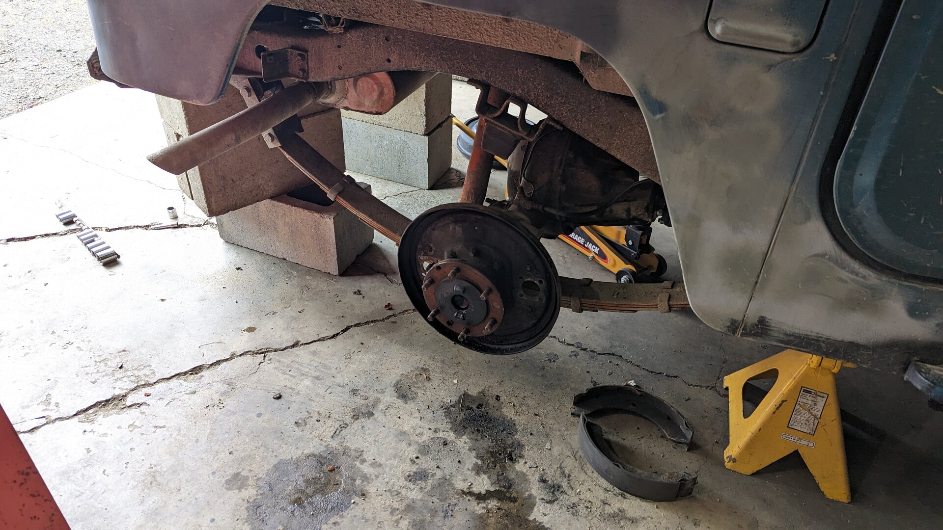

Took the 40 up to Murphy Dome North-West of Fairbanks AK the other day. Pretty neat spot and on the way back home my brakes started to seize up. Made it home but 2 of the 4 wheels brakes were hot to the touch. My brake lights were constantly on and the brake pedal wouldn't come all the way back to it's normal position. I took the fuse out to save the battery over night and the next day began the process of pulling the brake cylinders off.
Pulled them off and cleaned them up. One wheel definitely was locked up and the cylinder was pretty grimy on the inside. After cleaning all 4 rear cylinders I ordered some rebuild kits for them.

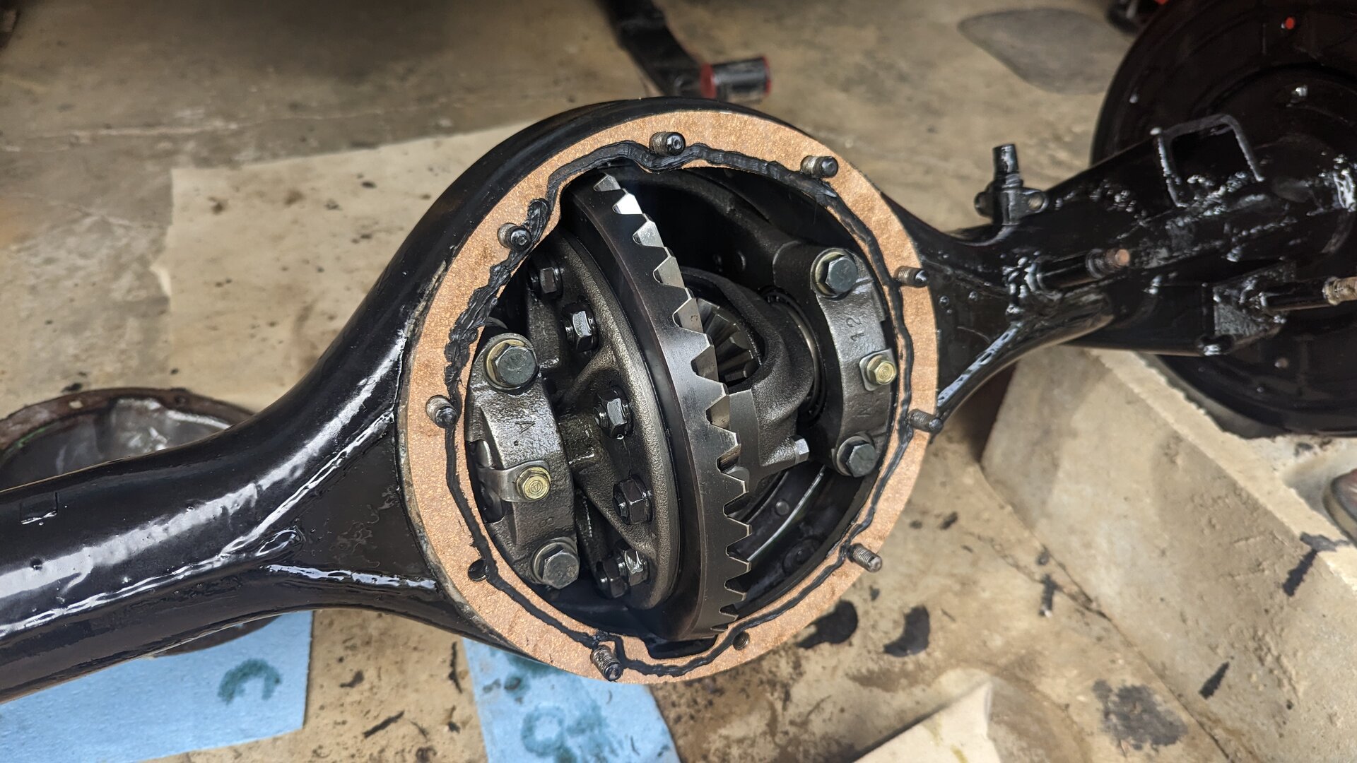

I replaced the gaskets on my differential with new ones that came in the mail today. This started as a quick job, but quickly morphed into an hours long project. Finally got it done tho. Put a small bead of black RTV on each side of each gasket to hopefully seal better plus be easier to remove for the next guy.
At first I thought this would be a simple matter of removing both "covers" and throwing on the new gaskets. I didn't realize that I would have to pull the axles themselves. That's why it turned into a larger project than what I had expected. This was the first time I had ever opened up a differential or dealt with axles or C clips or anything like that. New experience and it all went back together👌
