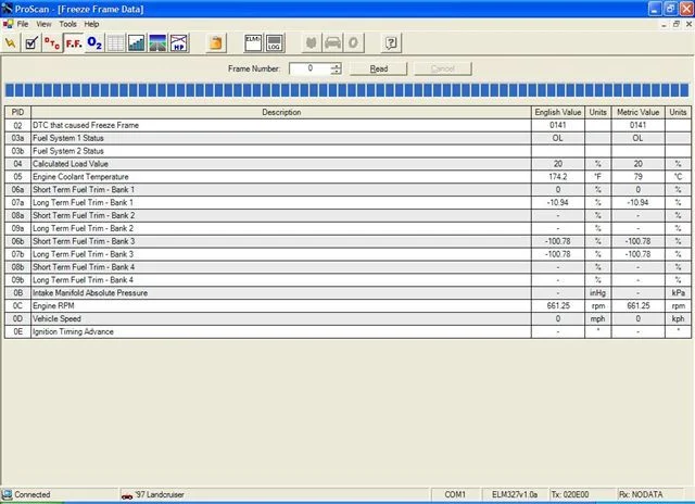

My universals did not work as well as planned-they bolted in (screwed in ) to an adapter plate that then bolted to the two-hole flange. It looked like they would work.
Worked for around 200 miles then set of code PO420 again. Its time to call C-dan for the real thing.

I've seen these threads here and plenty of other places. Not comparing exactly what Scott M did/bought, I can't comment on his readings. I can say that anyone using a supercharger (you too Dan!) should consider a different O2 sensor. What affects/effects O2 performance is deposits/contamination on the tip, or too much/little exposed surface area (wrong sampling rate) so the computer gets a bad reading.
