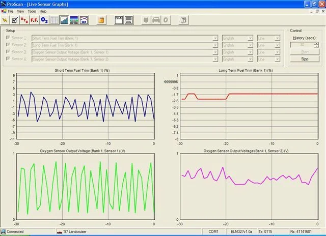

Of course. And not a bad price. I've returned one Bosch to Autozone, will attempt to return the other to the Autozone it came from, so no big $ lost. The signals from both sensors seem much stronger, greater amplitude. #2 was so active at first, I thought my cat had failed, what have I done?! It seems to have settled a bit. The heaters are apparently working now. My OBDII scanner now shows many self-tests now complete, that didn't before, like the O2 sensor self-test. Still haven't seen that catalyst test complete, wonder what that will take? The new ProScan software I'm using has O2 testing, it just locked up the program before, now it runs nicely.

mind telling the uninformed among us what these wavesets are and how to interpret them? :)

Hell if I know, that's why I post them here:D Everything I know about this I learned here: https://forum.ih8mud.com/showthread.php?t=75975&highlight=cat The short-term fuel trim is looking at O2 sensor #1, trying to keep it at some desireable amount of O2 for efficiency and cat health. I think long-term fuel trim is adjusted based on a pre-programmed map, maybe some other sensors. And I think O2 sensor #2 just keeps track of how well the cat is working. I do know they should be wiggling, and if #2 wiggles too much the cat isn't doing it's job.
