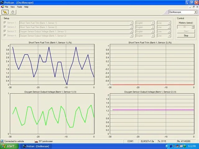

Hmm, shoulda started on this thread instead of starting a new one. I had the same luck with that website my brother had, will try it again later when I have more time to wait. Here's my before data, what other data would be helpful? I can graph most anything. Mileage will be difficult, we don't drive the 80 much any more, I ride to work, which I'm about to do.

Odd, but O2 sensor #2 seems to be working now. Either it's faililng intermittently, or it only works when the vehicle is up to temp? The code seemed to imply it was the O2 heater failing, so perhaps it's a temp thing. This was after my wife drove it around a bit, last time was from a cold garage with some time to heat up. This time coolant temp was steady around 190+F.
Here's a little more active sensor shot, hope my cat's ok! The second one is idling at a stop sign, then pulling away. The top-right graph is changed to Long Term Fuel Trim, never saw any movement on Short Term Fuel Trim (Sensor 2).
