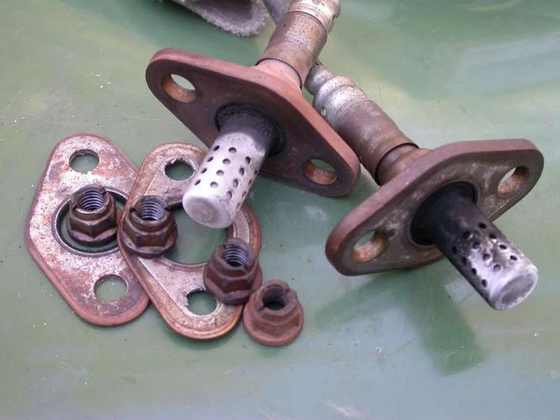

I need some imput here fellas. I replaced both O2's from Cdan. The nuts were so worn that they had shrunk to a size 8mm from 10mm? Tons of PB blaster or whatev but they were a SOB so I Ended up having to cut the pipes out to get at them.
My mileage is worse now. But got a decent 11mpg on the tank before this one...hmmm. I have tried taking the neg. batt cable off for a minute or two to allow it to reset with no positive results.

Prior to replacing my O2 sensors, I went out and bought the $50 Craftsman damaged nut extractor set. The nuts had reduced in size enough I was pretty sure the listed size extractor would not fit. It turns out the front and back sensors took two different size extractors, neither of which were the size listed as the correct size on the back of the box. I think I hit the nuts with PB Blaster a day prior, but I doubt that made any difference. With the extractors I had all 4 nuts off in a couple minutes (in conjunction with a flex head ratchet). I would not think of doing this job without them (or a similar tool). It keeps the simple job, simple. YRMV

I cut it out because I was only able to get one free and I have lived in Kansas prior to living in Denver and the humidity=rust, like Georgia, made it nearly impossible to free the other 3 while still on the truck. Yes, many have done so, you are right. But keep in mind most have much newer trucks than mine, I think mine was to the point of no return.
