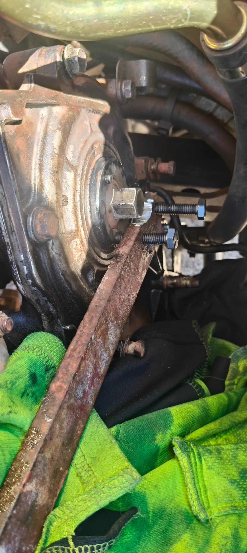

Need to get that off, how to do so

I did try use the puller but it seems really stuck on there, just wanted to get some other peoples opinions
doesnt that centre ring bit with the guide and the outer sleeve part of the pulley come off?
it did have a bit of play in it after trying to use the puller the first time
Yes, a puller works great after the crankshaft/harmonic balancer bolt has been removed. Is the bolt still there?
Yeah but it's loosened off, I've been using the base of the puller off that, should the base go inside the crank bolt?
Looking at your picture, there is a large hexagonal piece(30mm) in the center of the harmonic balancer that looks like a bolt head. That bolt must be removed. Usually requires two levers about 1.5 meters in length, one attached to the harmonic balancer the other to the bolt, pushed in opposite directions to loosen enough to remove.
Yes, you have to remove the harmonic balancer retaining bolt. The puller is designed to fit into the chamfer in the threaded hole; you're not going to damage anything.

Once the bolt is off, the balancer should just slide right off the crank. The bolt is torqued to over 300 ft./lbs. It's going to be tough to remove. Place a long 3/4" breaker bar and socket on it with a ratchet strap holding it tight against the right side frame rail. Remove the ignition coil wire and turn the key to engage (bump) the starter. Starter should break it loose. It's scary, but I've done it this way with great success. If this method doesn't appeal to you, an alternative method is to remove the flex plate inspection cover and fit a ratchet and socket onto one of the flex plate bolts. Turn the flex plate by hand until the socket jams against the bell housing. Then use a 3/4" breaker bar to break the balancer bolt loose.

Remove the entire bolt from pulley / spray with PB blaster or Seafoam deep creep etc, hit center of pulley with dead blow a couple times / respray with penetrant put retainer bolt back in impact the pulley back on with impact gun - impact it back off tap with dead blow again. See if you get some movement out of the pulley rock it back and forth 3 & 9 o’clock and 6 & 12 o’clock position that’s usually how I get stubborn ones off.
