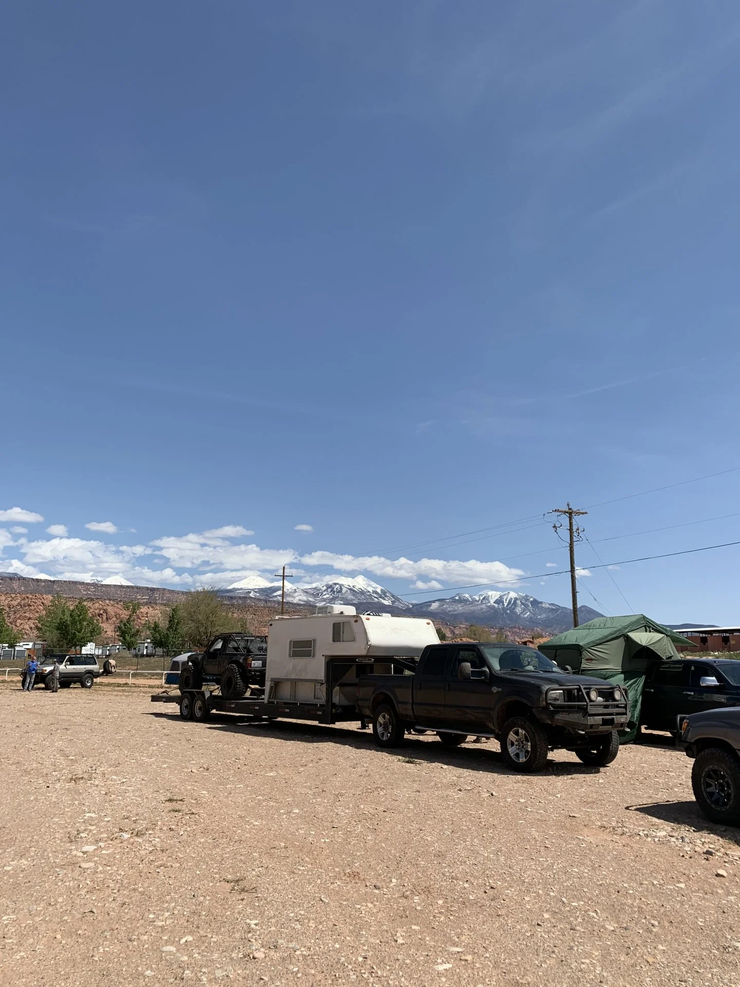

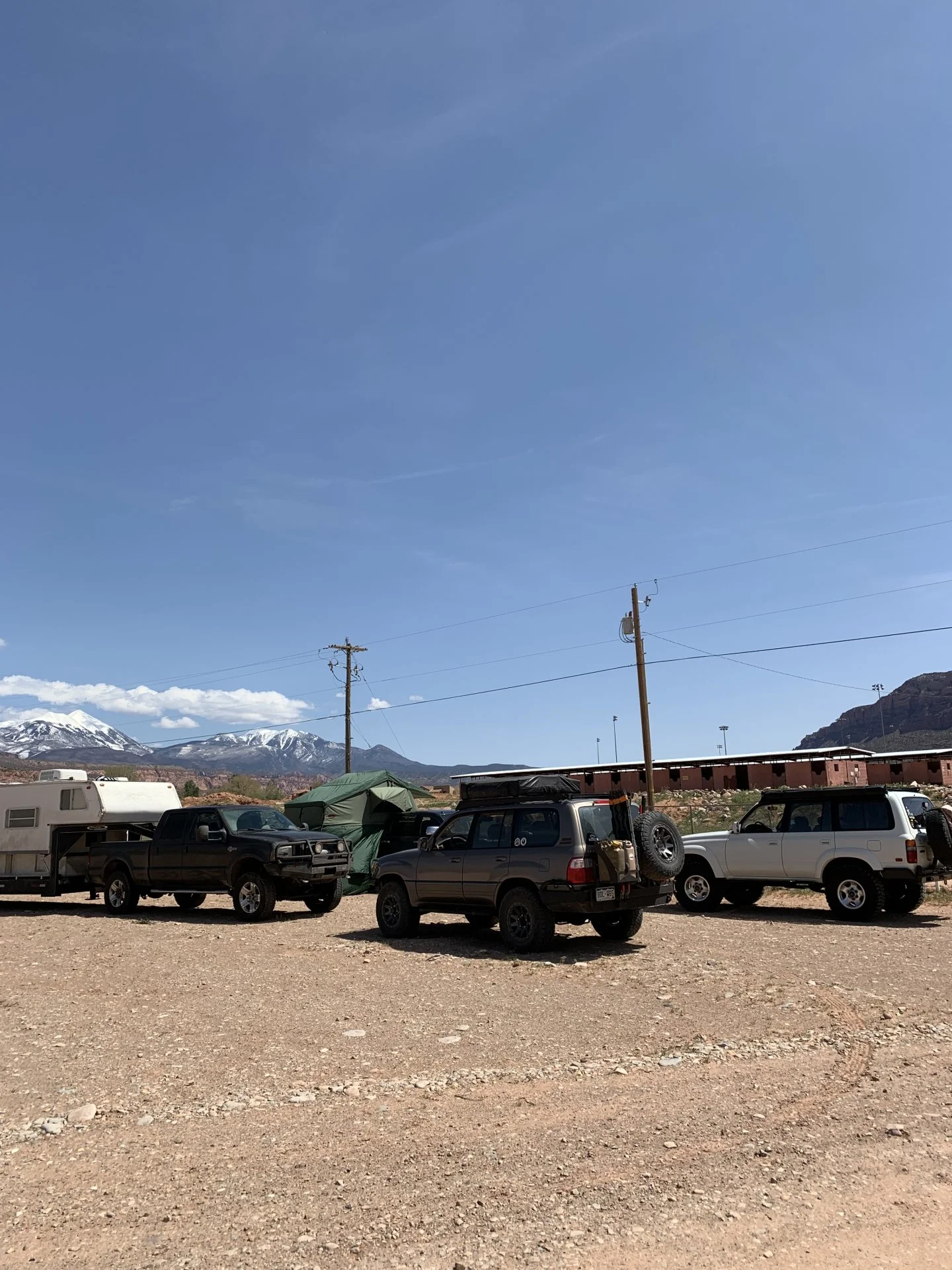

The electrical issue was not the only incident of the trip. Had a few more but I still made it to moab Utah at noon today.
have a great time Del, hope the weather is pleasant for the adventure...
