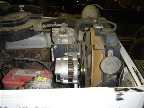

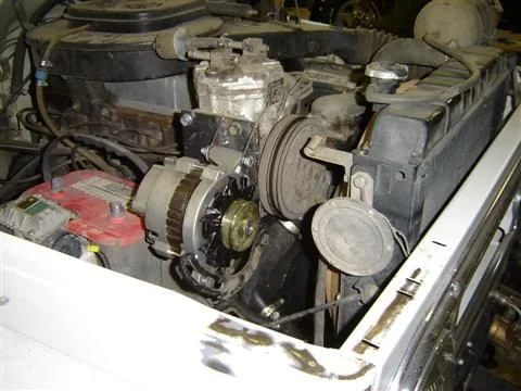

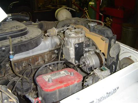

Here's mine; not perfect, but workable... used two pieces of scrap angle iron. Had to spend some time w/ the grinder to clear the spark plug socket and the water hose.
top/front view...
botttom view...
installed...
Never mind the bottle. It's just there to... show scale, yeah.
But the mount does make a handy flat surface for frosty beverages during the many months (ok, years) I spent working on the thing.
Oh, btw the alternator mount below is for a GM 17-SI. In hind sight, I'd have pushed the mounting hole a little further down to get better swing on the belt tensioner. HTH. -Ed '70FJ40

Mine is very similar to pghfj40 except that I added a mounting plate on the side of the York for dual alternators. I even had to notch for the water hose as he did. The mounting plate on the side has two sets of mounting tabs. One alternator is the stock alternator for charging purposes and the second is wired up as an on-board welder.
The welding alternator is aligned so that it runs off the second pulley of the York.

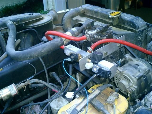

If height is an issue you can mount the York horizontally. It works fine. This is from the "technical links"
Yea, tried to find kccruisers but the link is no good. Are they out of biz?
BTW, thanks for the pics. CruisinGA I like the intake for your compressor. I plan on taking fresh air from the same location.
Pin-Head, I saw that setup in the links. Is that yours? I was concerned about laying it on its side. What hapens to the oil that has to be added.
