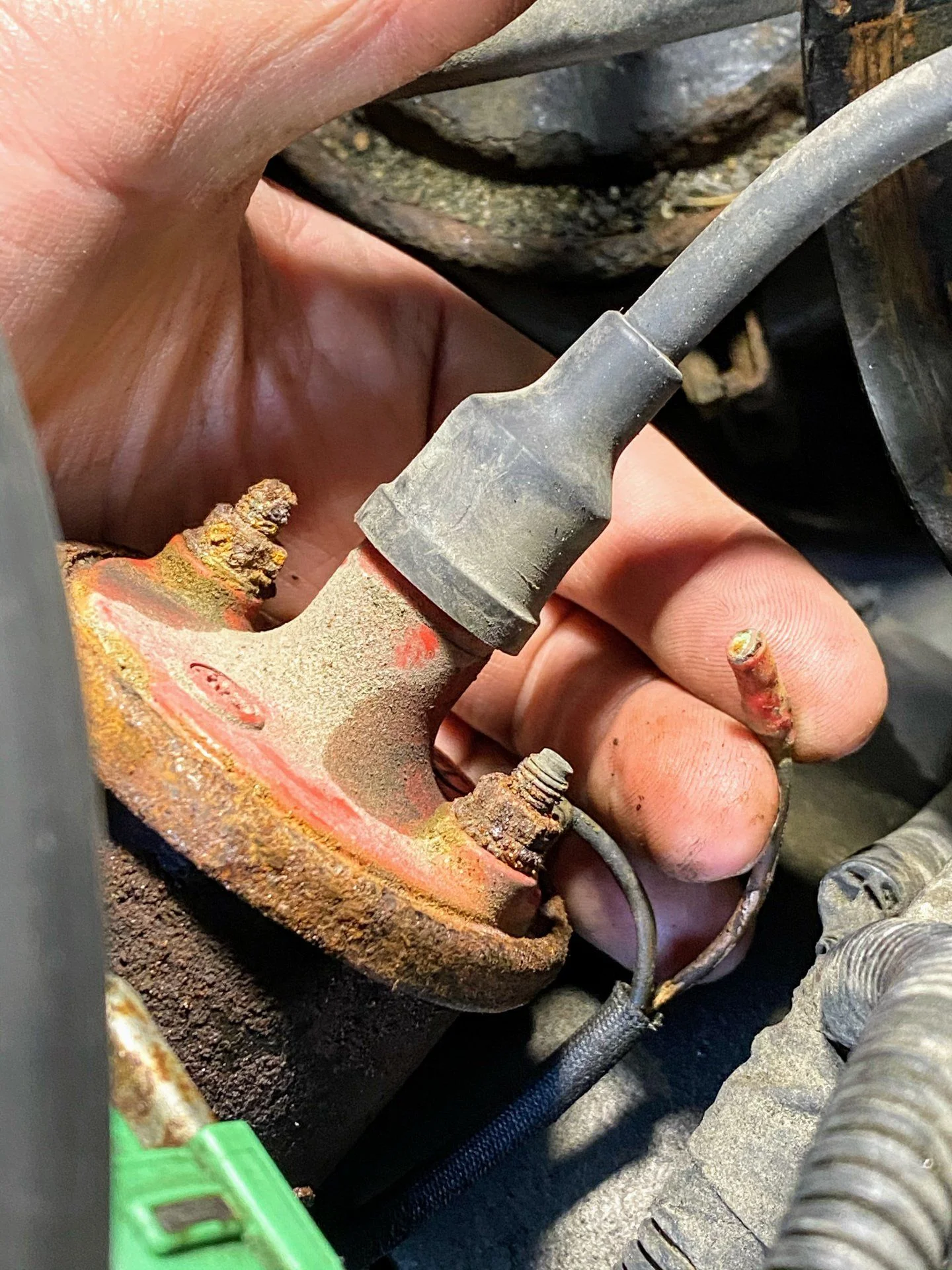

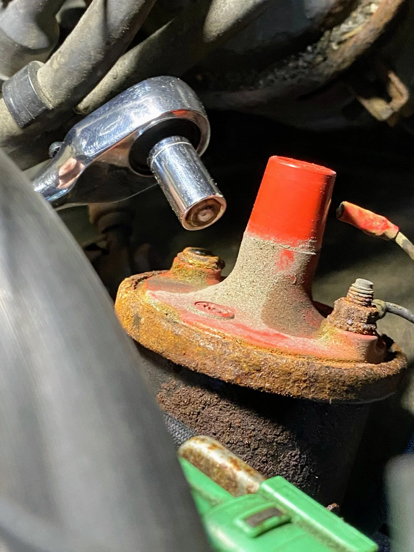

I got it into the driveway and started the troubleshooting. Battery read 1.95V so that was my first task. I got it up to cranking voltage and smelled a little gas but it refused to spark. My timing light didn’t flash so I started looking closely at the coil and found this:
...That would do it! No dice trying to re-attach anything, either:

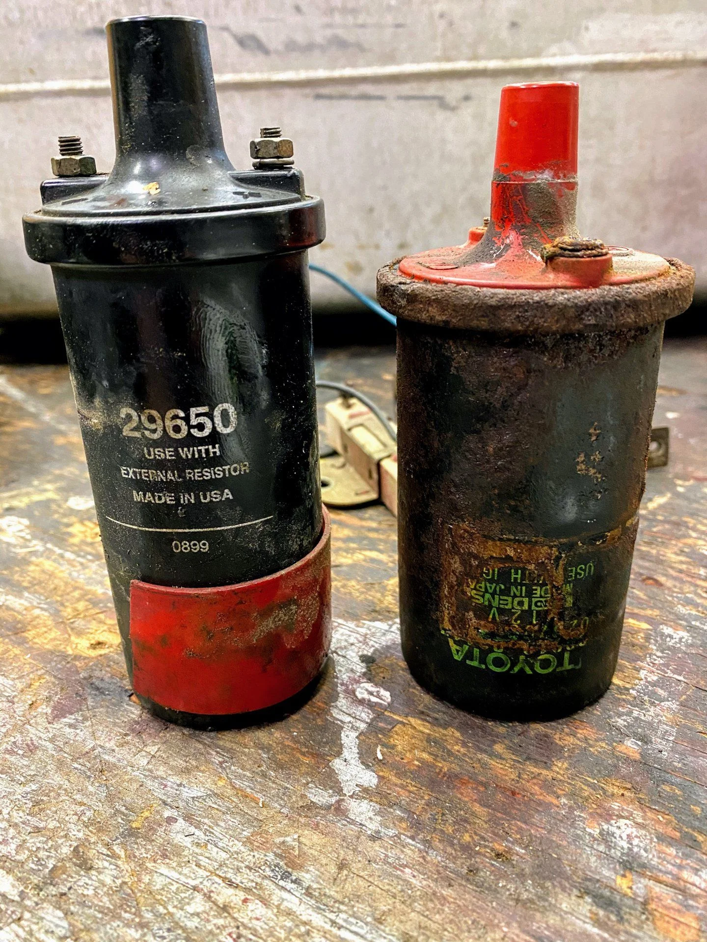

I dug around in the random parts totes for my FJ40 and found a spare coil, but it’s a lot different than what came in the FJ62. It’s a lot bigger and a lot less weight:
I figured that was my best easy shot so I hooked it up and...IT LIVES!

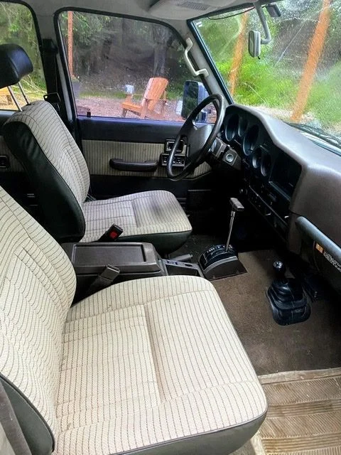

I figured that, since I’m going to keep it intact as a vehicle for a while, I might as well enjoy it. I vacuumed out the interior, my wife wiped it down, and it came out really nice:

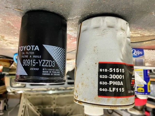

I also changed the oil. Here’s a comparison between the old and new; is this really the best new Toyota filter for these?
I’m actually a little concerned that it doesn‘t seem to cover the whole sealing surface on the filter mount:

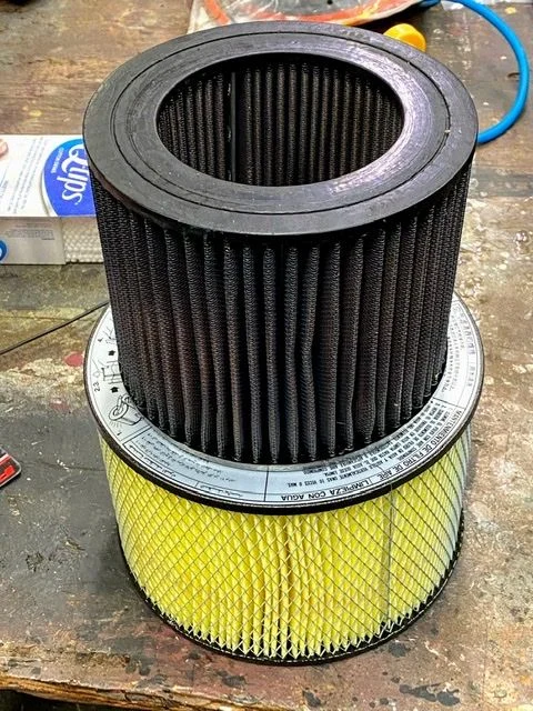

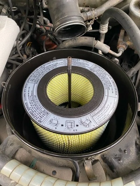

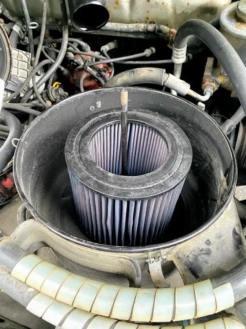

It came with a K&N air filter installed. It gives off a ‘throwing a hot dog down a hallway’ vibe in the air cleaner assembly...

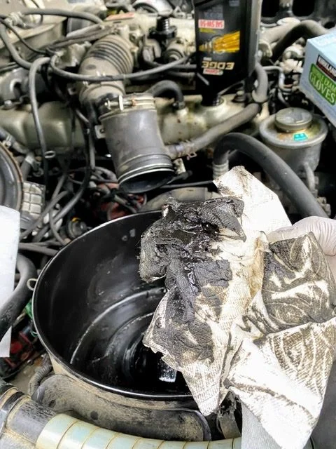

The air cleaner interior was NASTY. This crap goes up into the tubes:
Here’s the K&N compared to a washable, non-oiled, Toyota filter # 17801-61030 :
Much better:

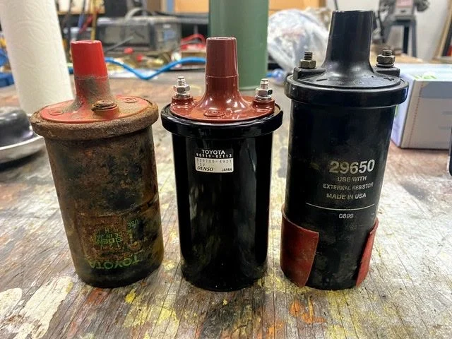

Today’s project was to put the ignition back together properly. I have a new OEM coil and needed to do some soldering to get it hooked up to the ignitor.
Left to right, old coil, new coil, ‘76 coil I’d been using:
Something that doesn’t come across in any photo is mass. The OEM coil is HEAVY compared to the aftermarket ‘76 one; that’s because the OEM is oil filled for cooling/reliability. I’m guessing the dead one is original so 32 years and 189,000 miles seems like a pretty good run.

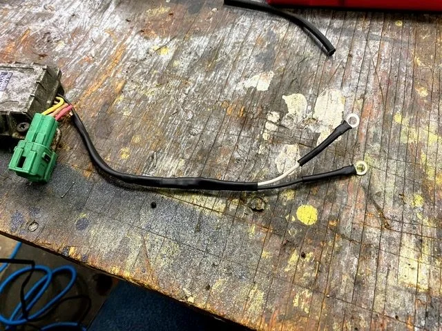

The old wires from the ignitor to the coil broke off so I soldered in some extensions with GXL wire. I used heat shrink tubing to stress-relief the joint; I also used it, several layers deep, to replace the factory abrasion-resistant loom that wouldn’t fit over the soldered joints:
All done and ready to go back in the truck, which I did shortly after assembling all this together:

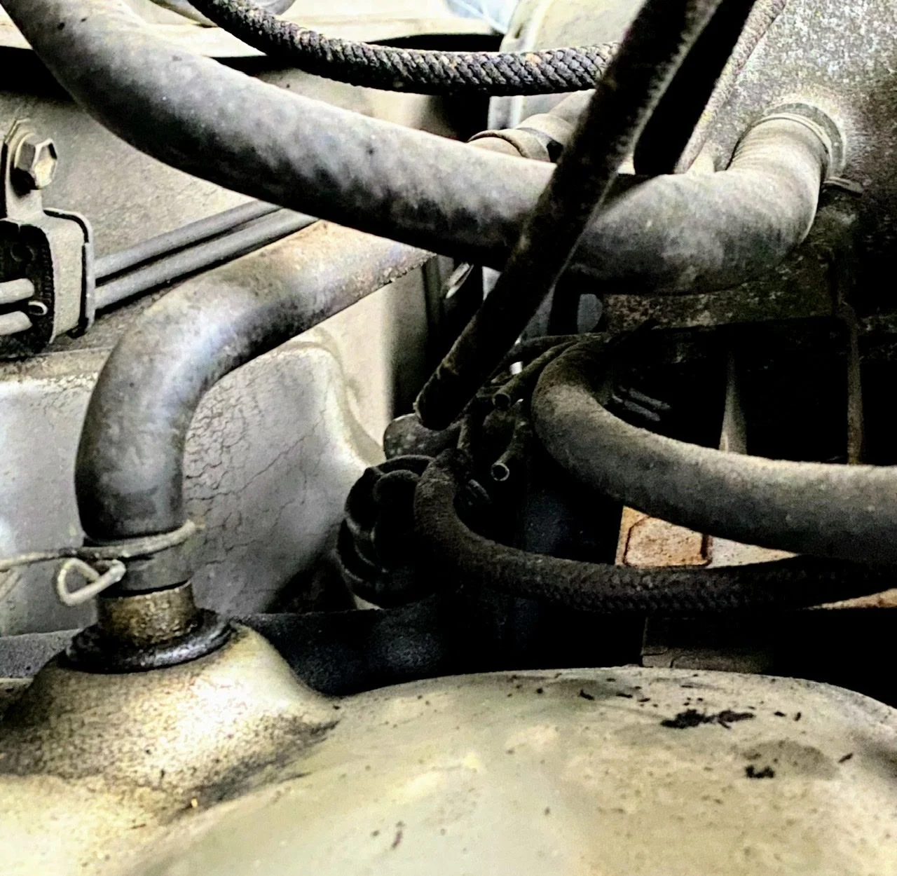

I took a look at the vacuum lines and they’re going to be a small nightmare. A lot of them were replaced with braided stuff that ALL looks like this:
How the truck ran well like that, I do not know. It’s made worse by the fact that several hard lines seem to have been missing lines for a while; some have clean metal and some are a bit corroded around the tip:
I think that a FULL vacuum line replacement is in order, and with how bad they are I’m not going to start the engine again until I get that dealt with.

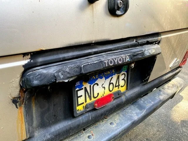

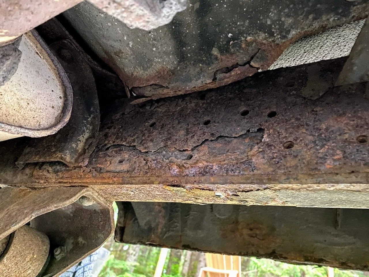

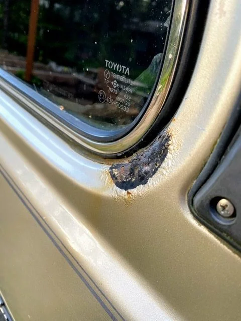

I suspect this is going to continue until I post cancer pictures, so here are a few:
Driver’s door handle. There’s a big rusty hole behind it:
Back hatch:
Bubbles around most of the windows:
And, of course, we can’t forget the frame:

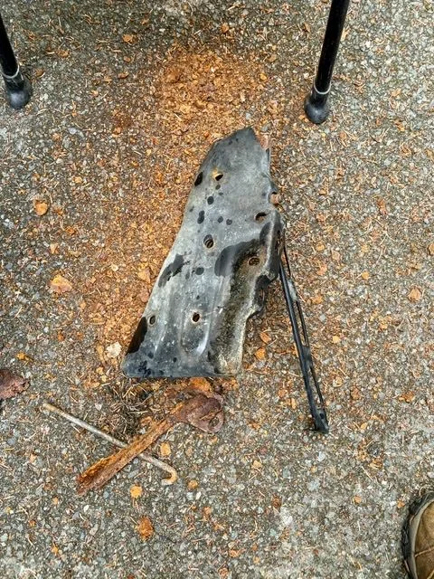

I will do one bit of rust repair, though. While we were working today I noticed the battery tray was iffy. Got looking closer and, well, see for yourself:
What’s my best affordable option for a battery tray replacement? I don’t want to shell out a ton of money for a part I don’t plan to use for a lifetime.

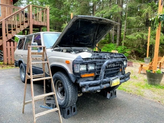

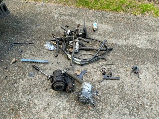

Wrenching update: started on the vacuum line replacement tonight. You know how it is, though, you need access so you remove one piece, then another, then another, and before you realize it there’s a pile of parts in front of the truck:
I’ve barely started on the vacuum lines themselves and, in fact, I think I’ve created an even bigger vacuum leak...

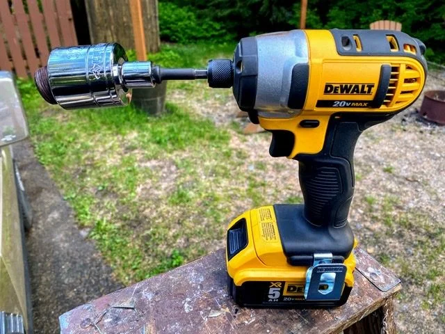

The old EGR bung was a royal PITA to get out. I had my breaker bar on it with as much weight as I could (I still have a messed up wrist from an injury in the garage a couple weeks ago) and it just was not moving. I don’t have any air tools and for a while there I was thinking I’d have to pay somebody to come over and deal with it - but then I had an idea:
If it’s stupid and it works, it isn’t stupid! I just had to hold it on there for a couple minutes (and take a break when the motor got hot). Not a trick I plan to use often, but it’s sure nice to have the option available!
My wife worked on scraping off whatever incredible adhesive was used to seal the intake side of the EGR (she gave up after an hour, I still have to finish that tomorrow) while I cleared up the other side of the engine. The A/C was already disconnected so I took the liberty of removing the compressor. Please tell me the bolts from the compressor mount into the engine mount aren’t needed wihen the compressor is removed! (Also, the copious amounts of oil on the engine are from mangling the 7 year old oil filter off)
