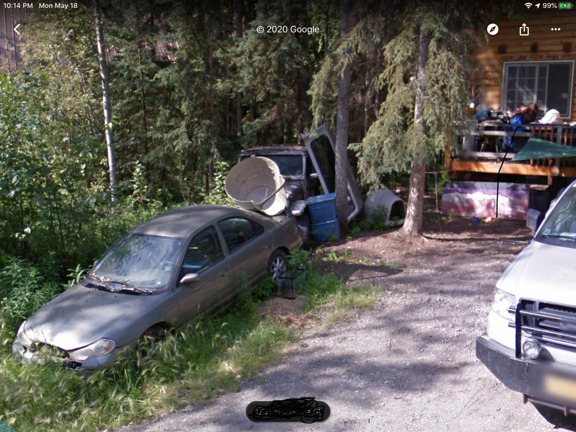

Parked but never forgotten, it sat like this at my friend’s place for nearly a decade:
(taken from Google Maps - at one point I could find it in 3 different places on Google Maps, broken down in all three)

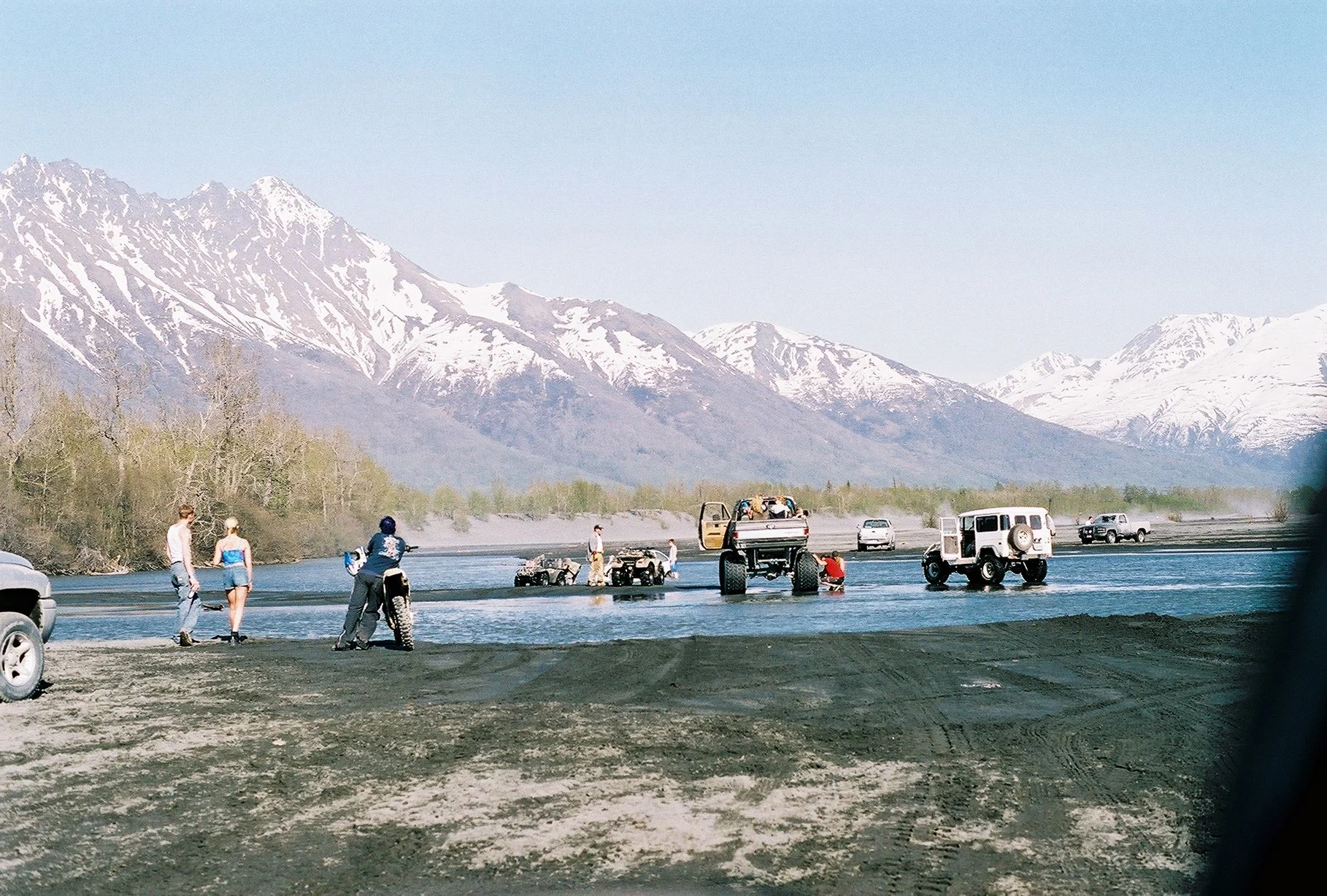

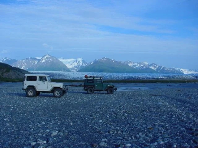

Here is 2002 (ish) with @green73 near the Knik Glacier:
That was a great weekend! You may recognize the river between us and the glacier from Mark Whatley’s ‘rescue’ story and his avatar. We did not make any attempts to cross. That does not mean we avoided water crossings:
By the way, that Knik silt DESTROYS anything mechanical it gets into. Keep your fluids fresh! I once had the Anchorage Hummer dealer admit to me that, when the service department was slow, they would schedule a weekend ‘wheeling trip for the owner’s club out to Knik because they knew they’d have a full shop for the next couple weeks.

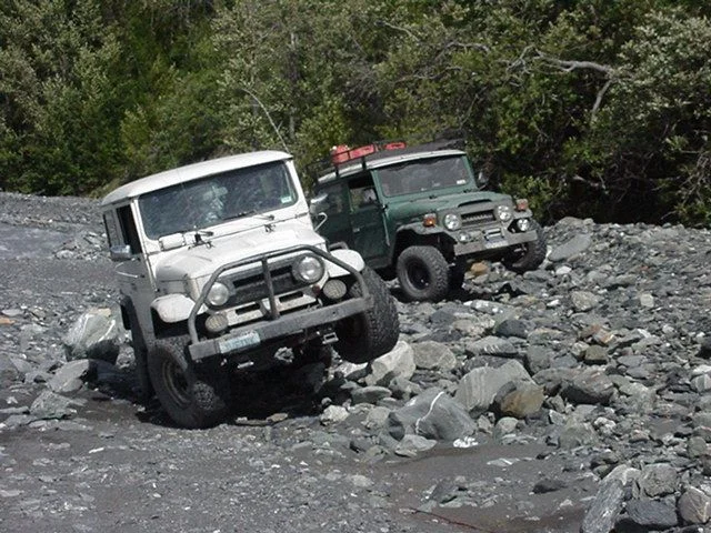

Of course, being young and seeing all that rock crawler stuff on the early internet, we had to do some posing:
Funny how memory is, though, because until I started digging up the photos of this trip to post here I had totally forgotten that my non-clutch’d fan took out my radiator on the last water crossing before pavement. I got dragged home on a strap. That will be a theme here for a while.

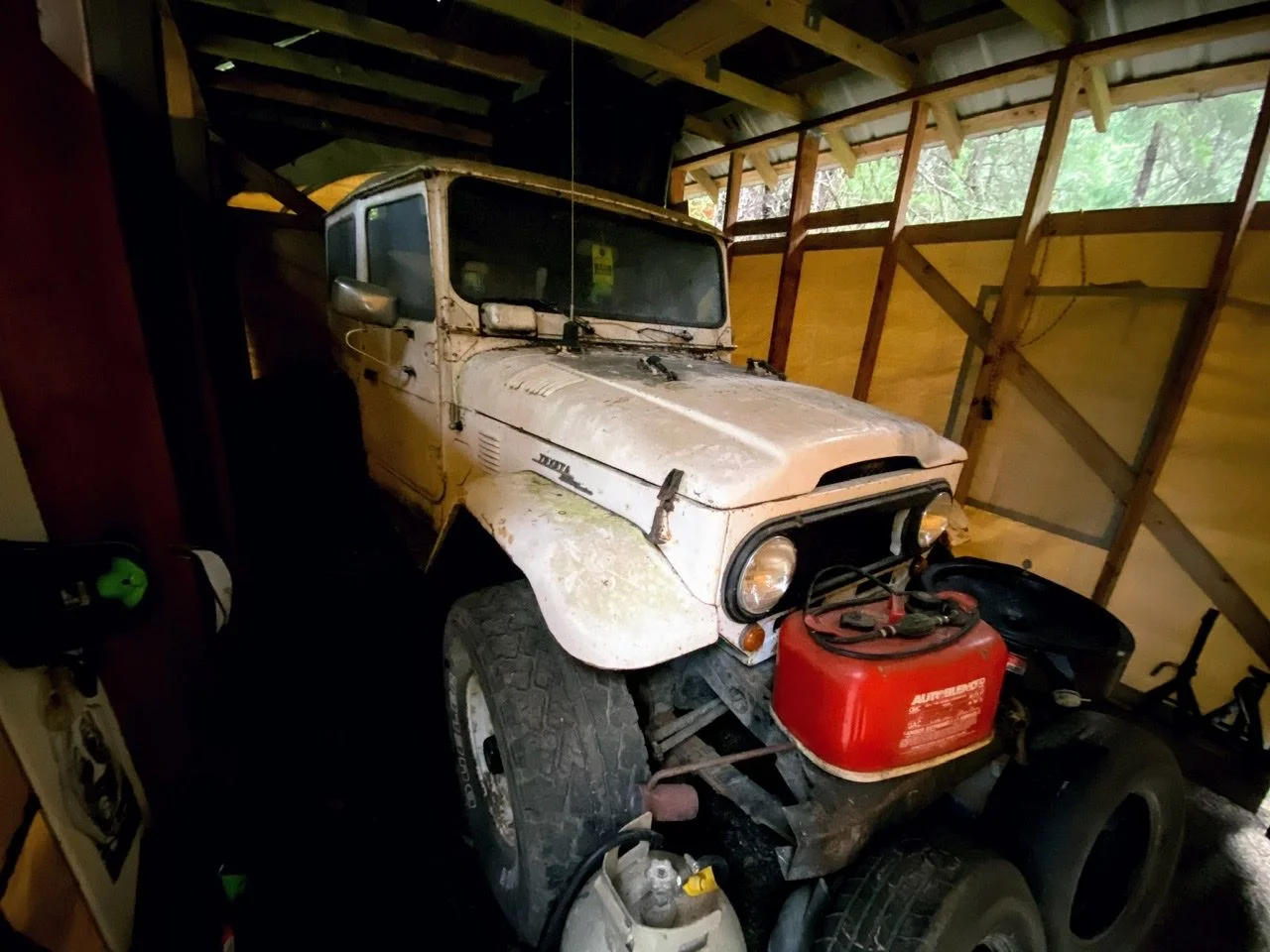

Cleared out the shed, put it up on wood blocks to keep things off the dirt, and here is how it has sat for the last 4 years:

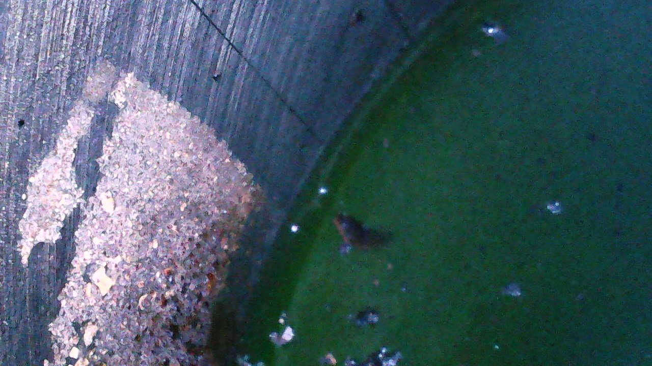

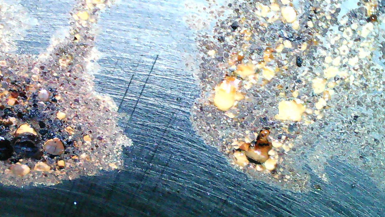

Sunday I went into the shed with the intention of pouring Marvel Mystery Oil into the cylinders to lube the piston rings before I drag it inside and start work. I have a $25 wifi borescope so I figured I would look in each cylinder first. Well, this is #1:
Well, crap.
That engine has less than 5,000 miles on it 😢

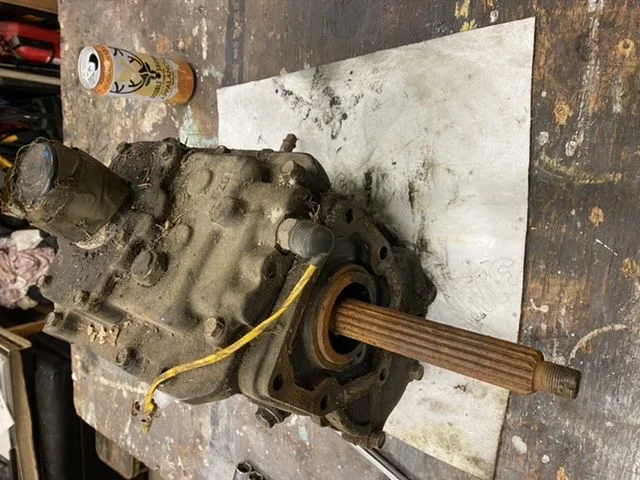

I’ve had this H42 laying around, I’m not sure where it came from, but I *think* it came out of an FJ55.
Does that output shaft look okay? I think I may have bought it attached to a 4 speed case (which I had planned to replace my noisy one with) so the rusty shaft is probably my fault. The reason I think it came from an FJ55 is that the parking brake was wrong for a ‘40, which precluded me swapping the whole thing over assembled as one unit.

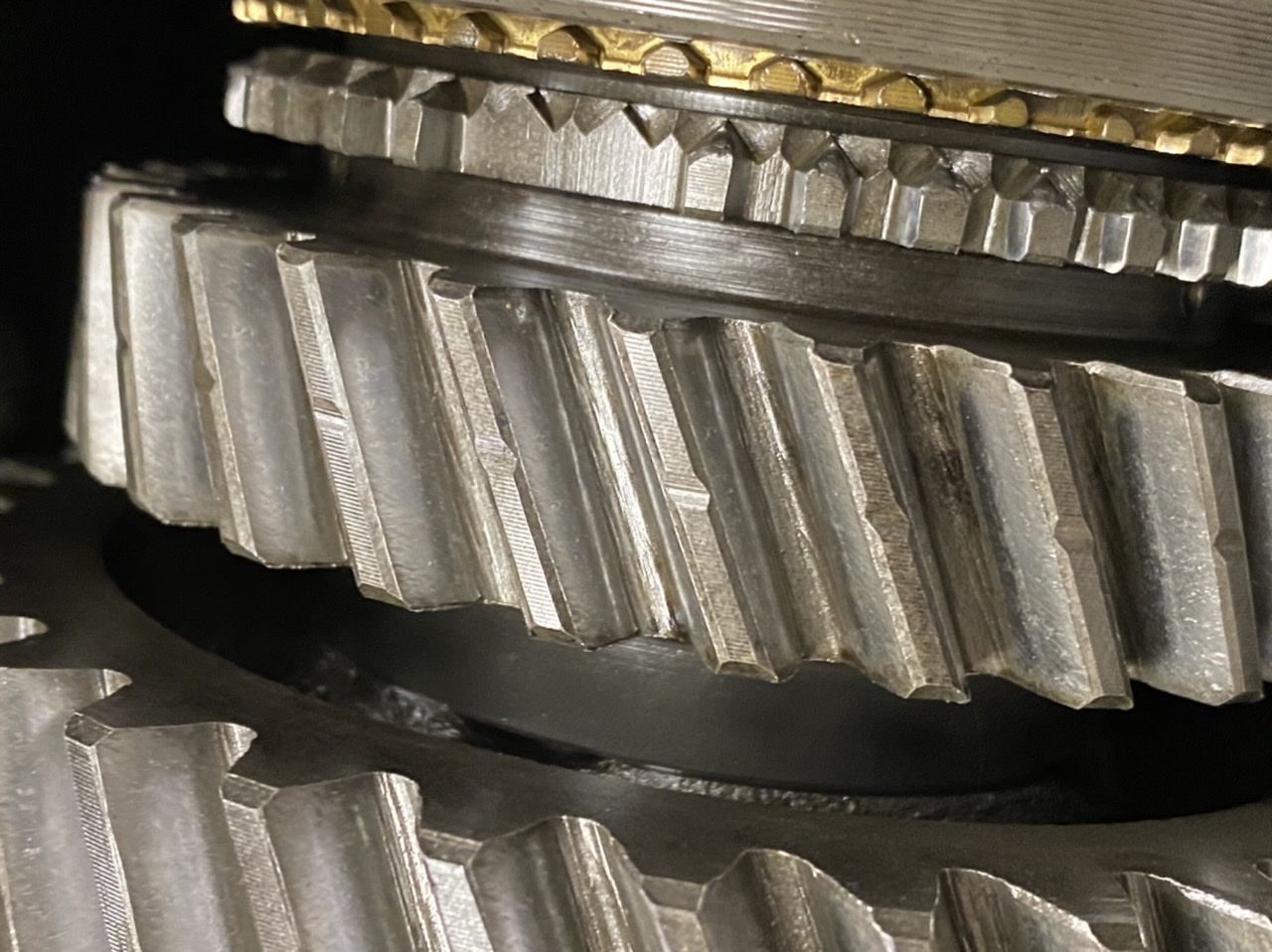

I popped the top and all the synchros look good.
What causes this wear on the teeth? I saw it on what I *think* are 3rd and 1st: (I just noticed the missing teeth, is that also okay?)

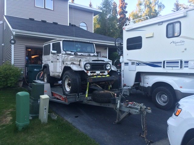

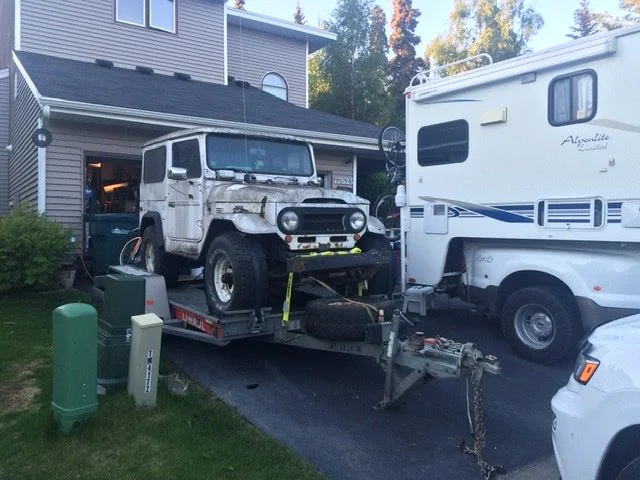

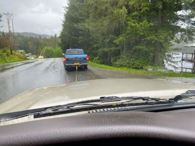

Well, I got dragged home with a strap today...
But wait! Why would I need to be towed home if my ‘cruiser is already in the shed?

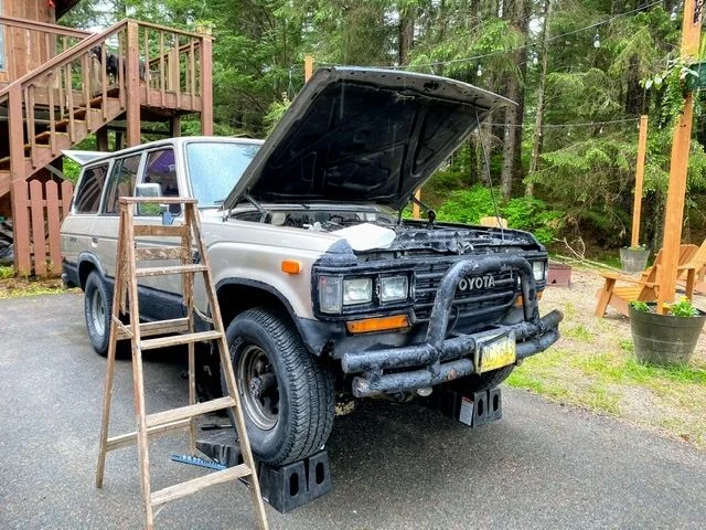

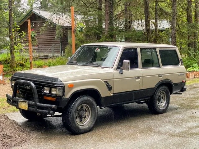

It’s the old bait and switch! I bought a parts truck, this is now an FJ62 thread for a while:
This is a 1988 FJ62 I picked up from the brother-in-law of another ‘mudder. He said it ran great until a few weeks ago when it just died. Nothing happens when you turn the key; he thinks it’s the ignition control module. I’m not so sure about that, when you turn the key *nothing* happens. I think it’s probably something related to these wires hanging off the battery negative post:

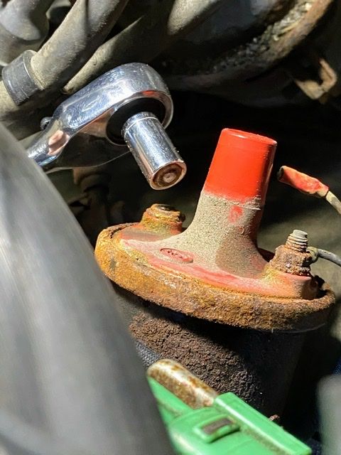

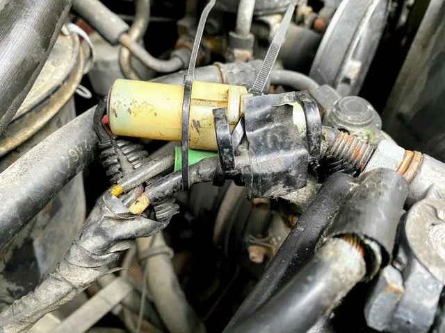

It briefly stopped raining today so I played a bit with the parts truck. Battery read 1.95 volts this morning so I put on a charger and had it cranking by lunch. It was great to hear it crank since that means it isn’t seized!
Unfortunately it didn’t start. I smelled a little gas (probably have a vacuum leak to deal with) so my thought was spark. Timing light didn’t flash off the coil so I got looking closely and found this:
That would definitely prevent it from sparking!

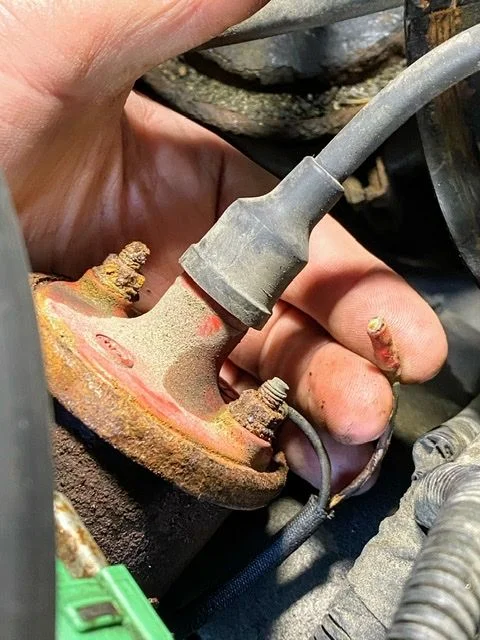

I tried taking off the nut to get an ohms reading on that nasty post and this was the result:
New coil is in order! I have a spare from my ‘76 2F before I converted to HEI but it reads 2.4 ohms and was originally for a points ignition so I’m thinking I’ll just order a new coil and be sure that’s not my problem. But if the 2F coil would get the 3FE running and not damage anything, I’d be willing to give it a shot. Anybody know if that’s okay?

It's my experience that borescopes make things look MUCH worse than it really is. BTW, that first picture looks a lot like one of my kidney stones after lithotripsy.

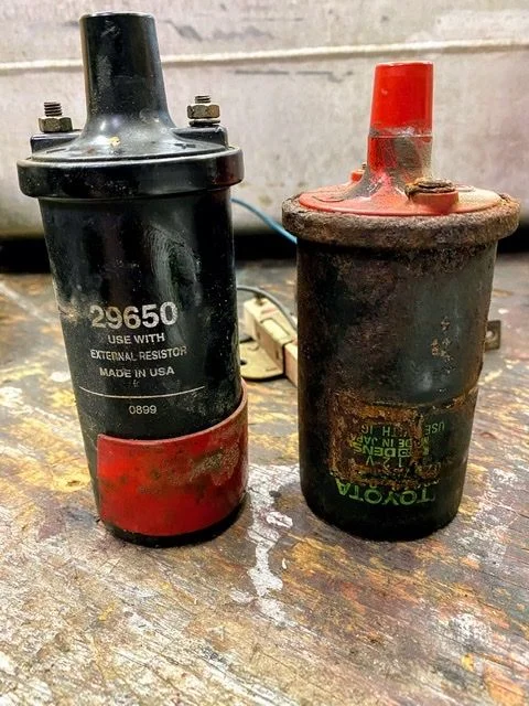

It was the coil. I swapped my 2F coil on for a test and it fired right up. No funny noises, transmission shifts great, no obvious exhaust leaks. I took it for a spin to get everything up to temp and the check engine light didn’t come on so I’ll count this as a major win. It idles a bit high but that would probably resolve itself with a tune-up.
For reference, this is the 2F coil vs the dead 3FE coil:
I have a new OEM coil on order, as well as a bunch of tune-up parts. The windshield sticker says the oil was last changed 3,000 miles ago - in 2013.

Good news is, with a running ‘62 I can still drag my ‘40 into the shop and get started on it. I have a *lot* of stuff other than the engine that needs addressing!
I’ve been enjoying the FJ62 enough that I’m going to keep it intact a while. I’ve decided to make that it’s own thread so I can separate out the ‘62 work from what will possibly end up a frame-off on my ‘40. You can find that thread here: FJ62 Hospice Care
