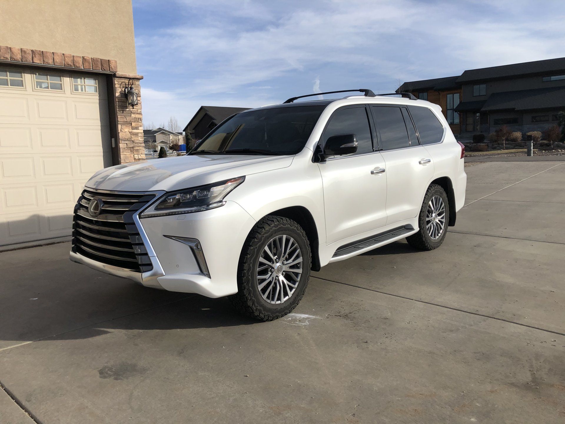

2015 LX570 BFGATKO2 285/55/20. I have over 20,000 miles on them now with no measurable wear. ride great, no rubbing not even close! Only problem is that 285 cost about $100 apiece more than the 275 so if I did it over again I probably would go for the 275 I just liked the fact that the 285 had almost a 1 inch wider treadwidth which I thought was odd!

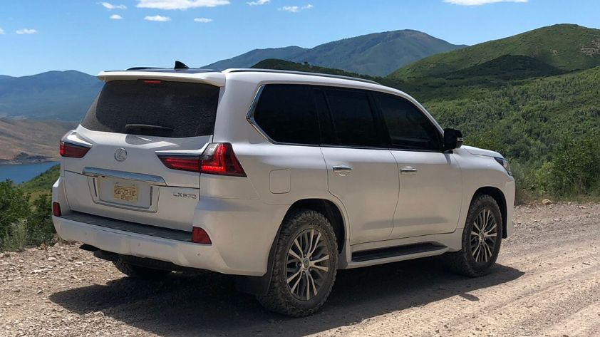

275/60r20 no rubbing whatsoever even with light off-road mountain trails. I think the offset with these 20’s is +55 though, anyone chime in if I’m wrong

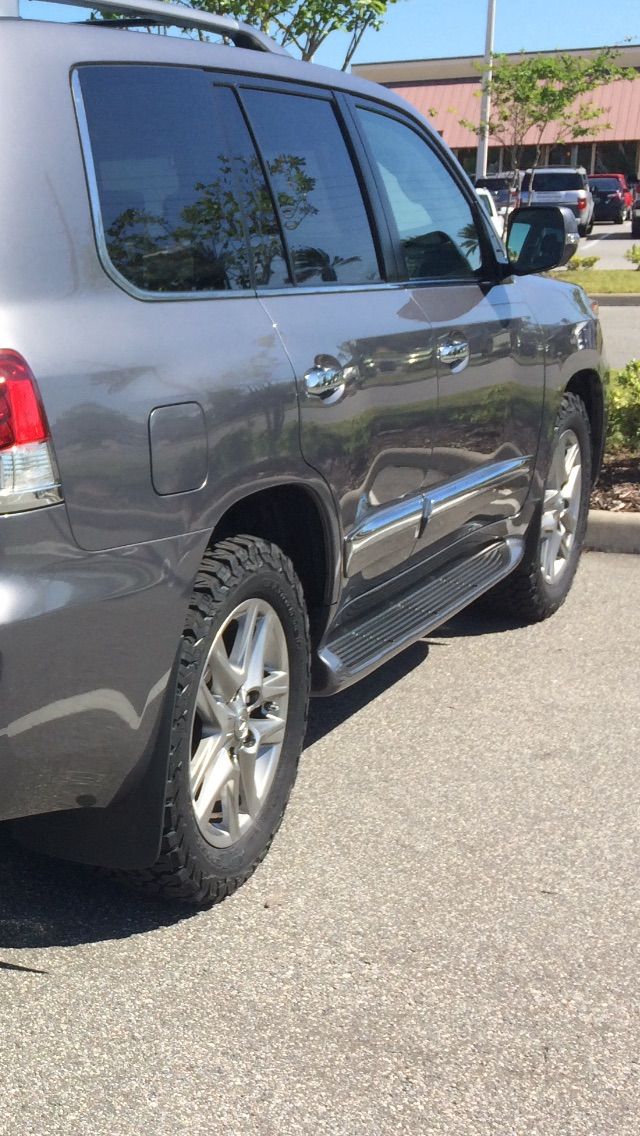

275/60/20's here as well. 8,000+ miles and no issues.

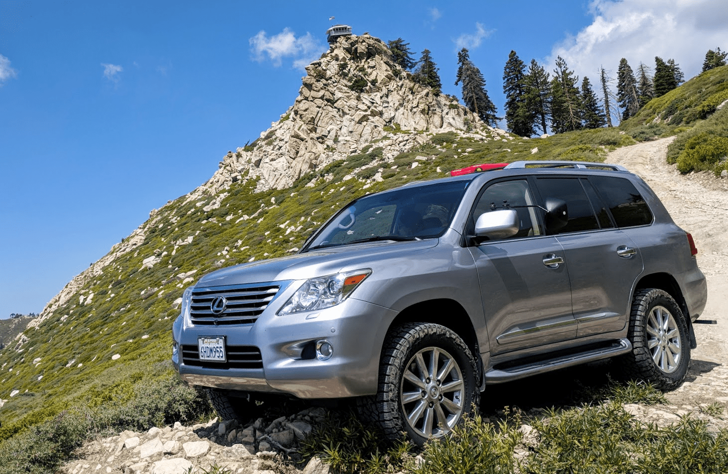

Personally, I'd recommend even larger in height and width. The LX with AHC handles big tires incredibly well, while maintaining quiet comfort and performance. With better clearance without KDSS to go larger tires than an LC. I'm on 33x12.5s (305/60r20) now. Very tempted to go full 35x12.5 tire.
