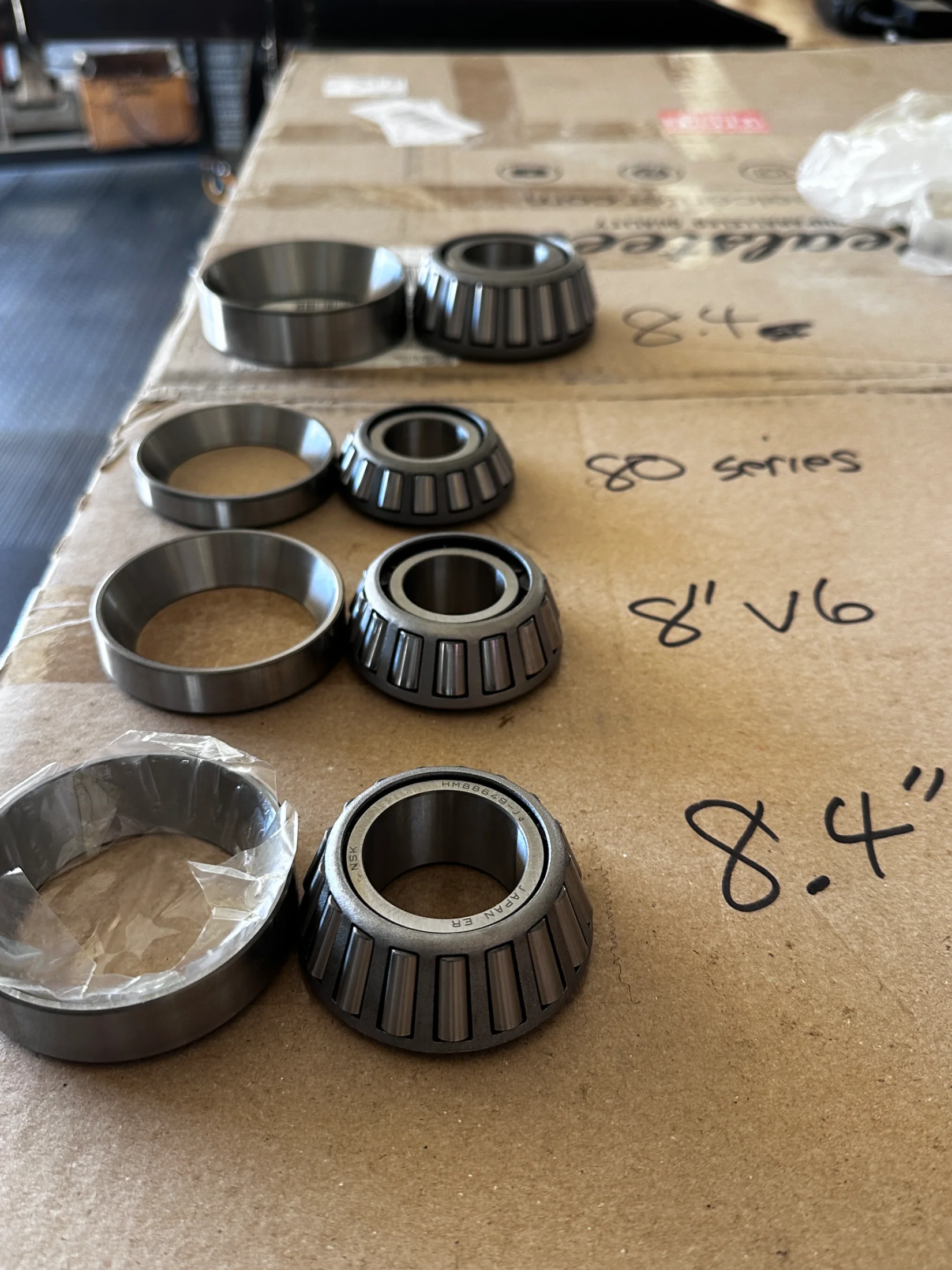

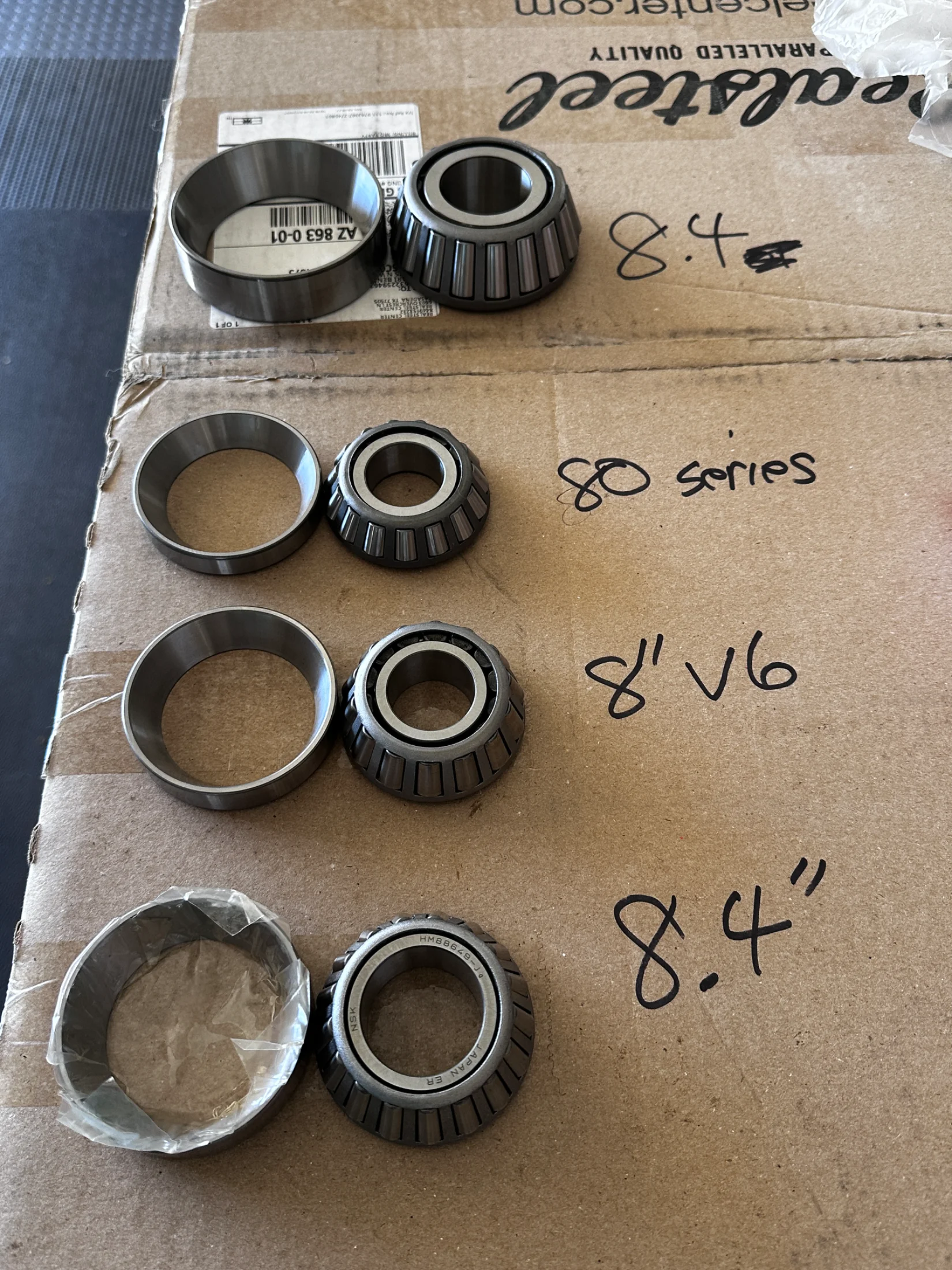

And tidbit #2...Landcruisers FJ80's and 60's :) .....really need Genuine factory bearing part numbers. I lost 1000's of dollars on a few old landcruiser installs due to mostly pinion bearings (aftermarket bearing kits) that the tapered rollers were way off and too steep of an angle. They would loosen up in 1 years time. Live and learn :)
