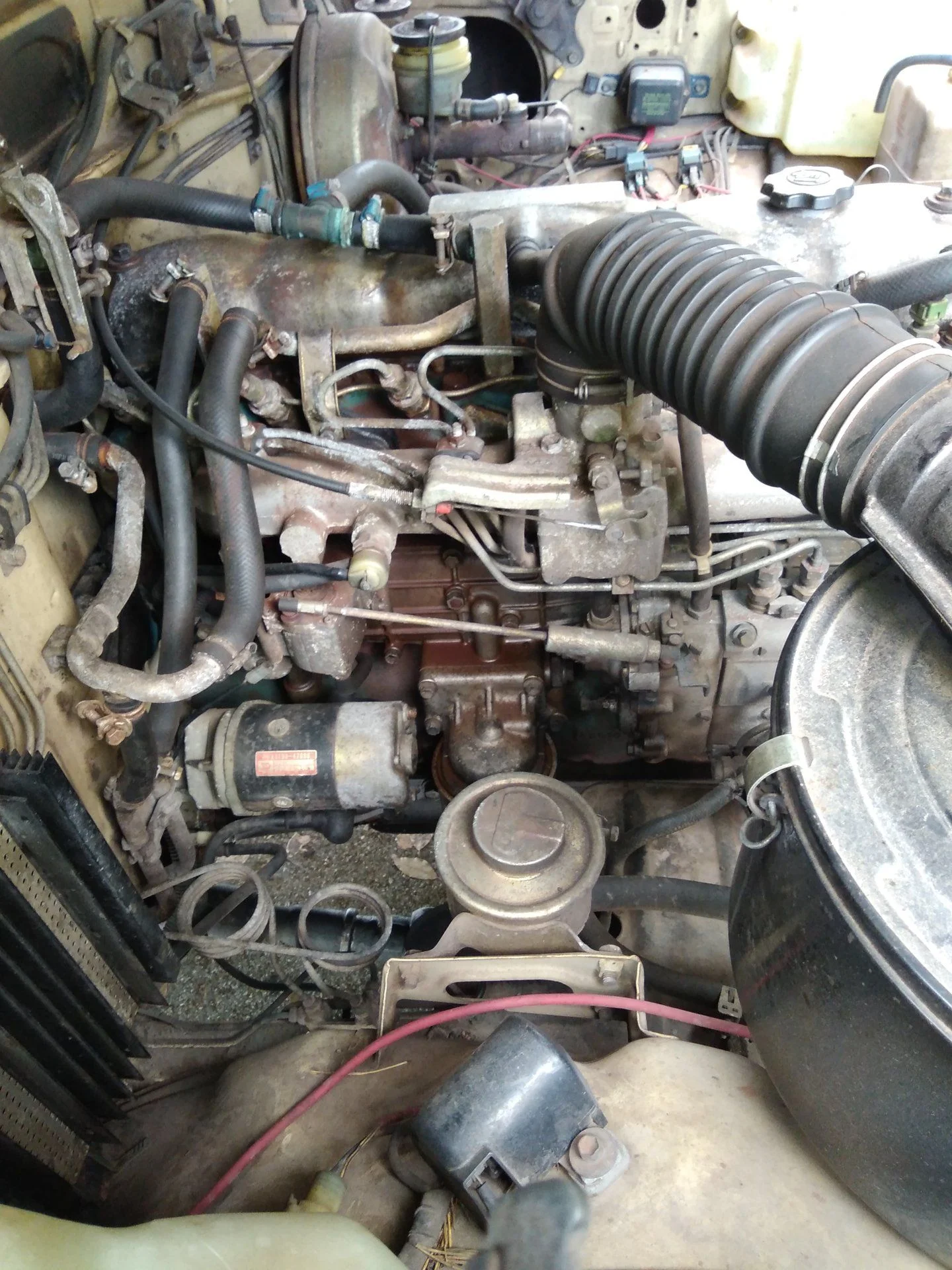

i changed the motor oil today. took some pics. i noticed i have the stock pump primer. what you guys think i could spray in the ingine bay to stop parts from rusting and the dry look.
I use rust prevention spray to keep the engine from drying out. Usually Krown, but I don't think it exists in EU...
I'm sure you have something like it...
