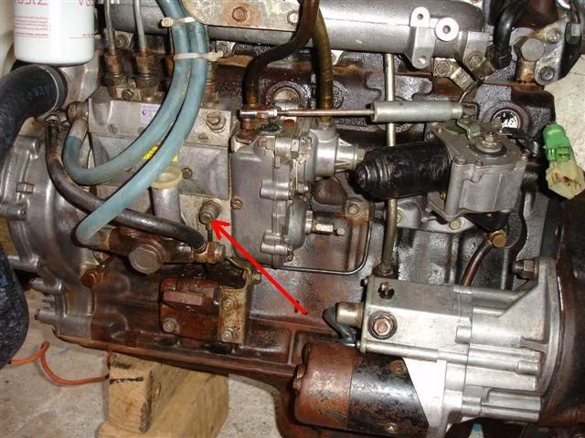

My Owners Manual said the same thing about the injector pump on my 1979 B - engine. But in fact my injector pump is pressure-fed with oil from the engine itself so it doesn't need its oil to be separately changed.
I suspect the same applies to you.
Here's the oil feed on my engine (red arrow):
See if you can spot the same thing on yours.

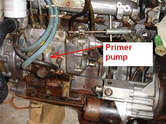

Some models have them on the top of the fuel filter but I think yours should be mounted on the engine-operated fuel pump which hangs off the side of your injector pump.

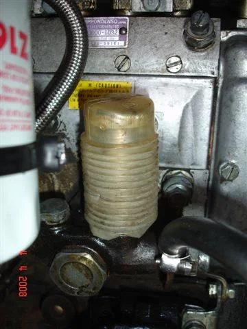

Similar to this setup on my B engine:
If it look like this one, you unscrew the white nylon plunger until it pops up.
When it has "popped up" you can push it up and down to suck fuel from your tank and move it towards your fuel filter and beyond.
When you've finished using it, you push it down and screw it clockwise to "seal it" again.
This is the factory-original type pump and they are prone to leaking.

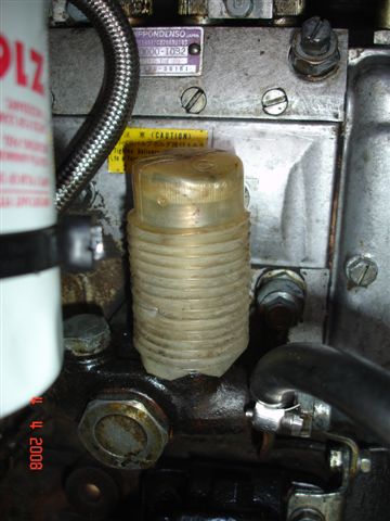

If it still has the ex-factory concertina-plastic cover it'll look like this:
(You lift off that cover to gain access of course.)

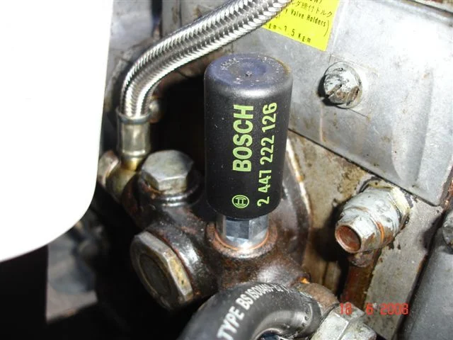

By the way ....These Bosch units are cheaper and better and require no "screwing-down-to-stow":
So if yours drips diesel when you operate it, I'd replace it with a Bosch unit if I was you.

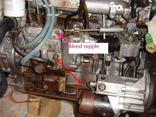

Similar problem here where is the bleed for the injection pump. I have a b diesel
Hi Roma
I'm at "work" so I have got to use a computer and programs I'm not familiar with. But here goes with putting "pink words and a pink arrow" on an image I used earlier in this thread to show you what to look for:
:beer:
PS. It uses a 10mm spanner ..... same as the bleed nipple on your fuel filter.
