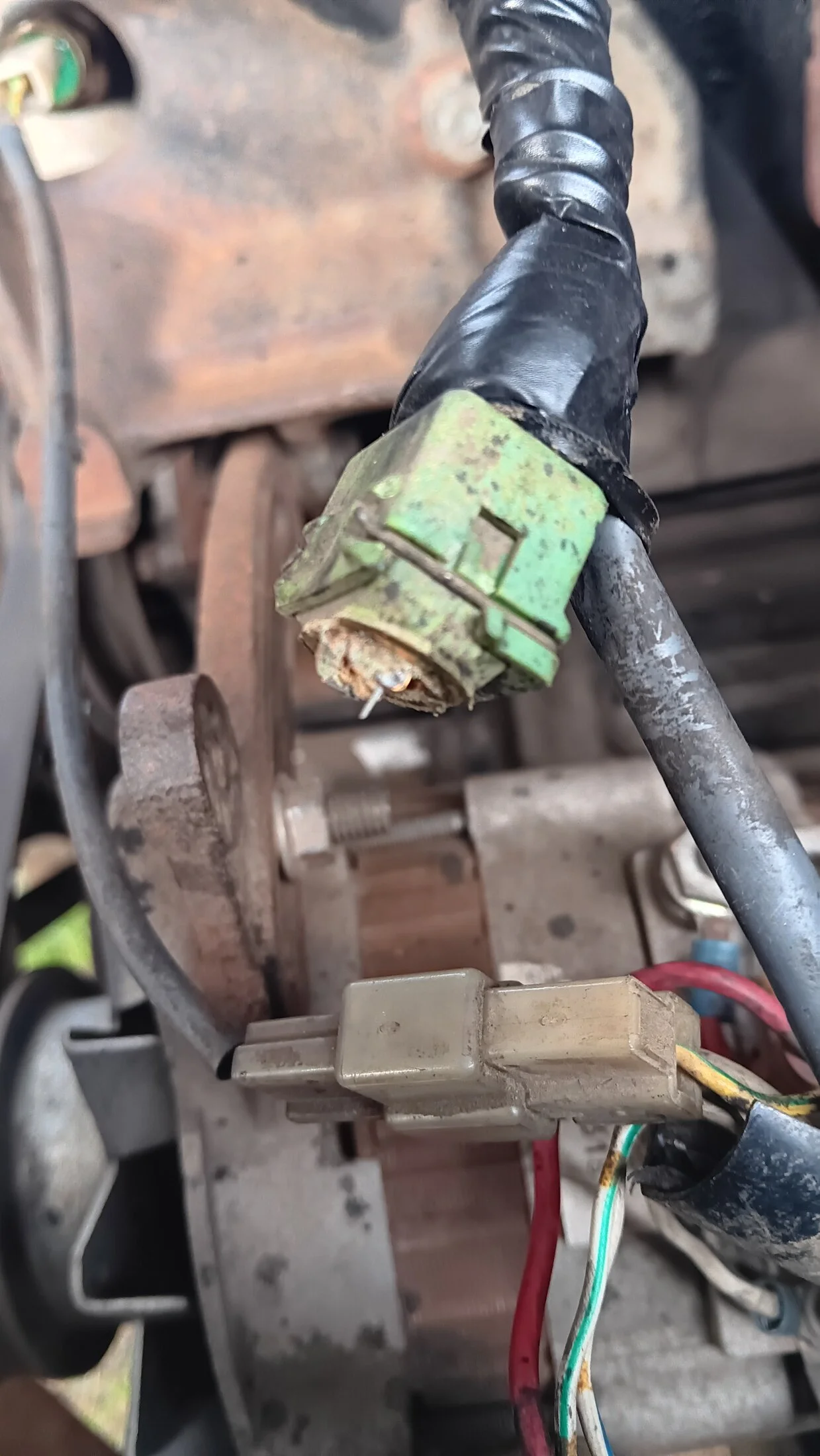

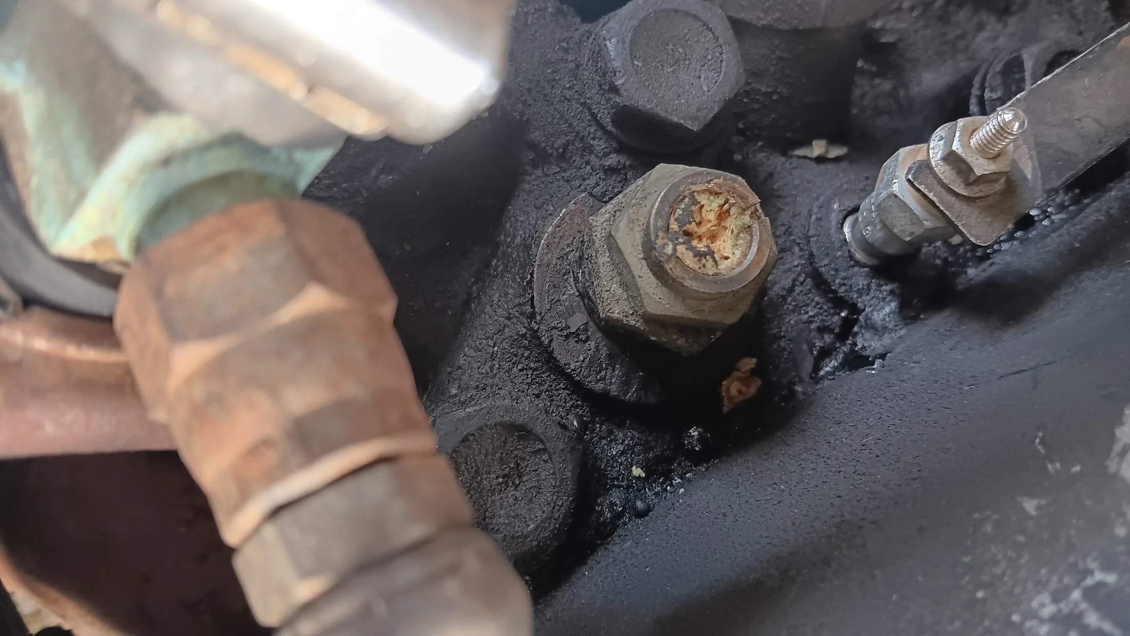

soo,cause im a dumbass,by accident while changing and checking cooling/heater hoses,while on my bull bar and half on the engine etc...i put my hand on this this and snapped it..
i think someone said its a coolant gauge or something(help me out with the real name as i don`t know)i think there pricey but eh.
it still runs,still getting hot.
I haven`t had time on it as i have been working alot so i`ll get there eventually.
This is the coolant temperature sensor for Superglow. If you've got a Wilson Switch then no big deal, its no longer needed.
