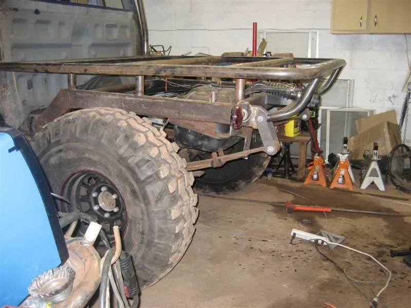

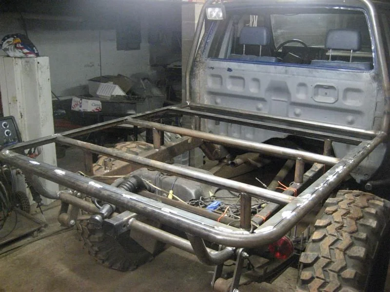

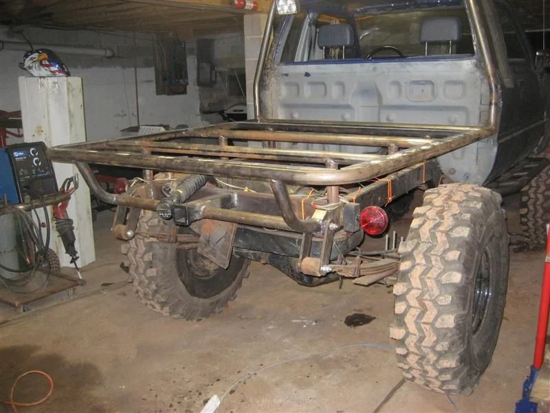

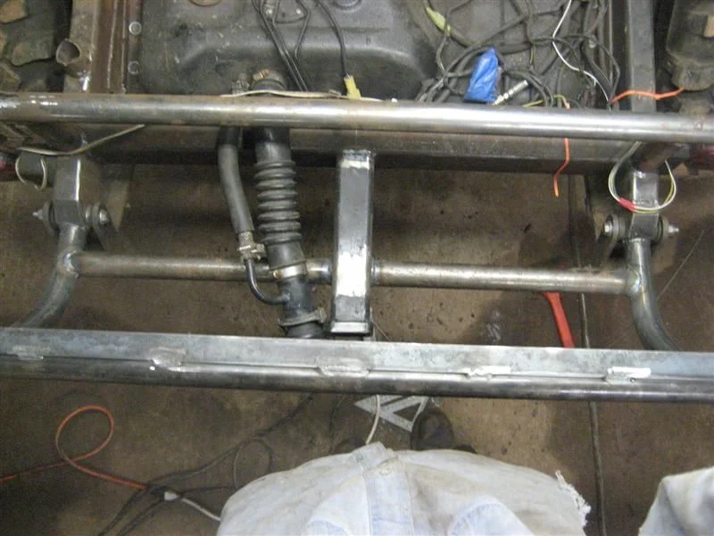

Added a little bit of tube to the rear of the flat bed to add some strength and a little bit of style. I plan to do a roll pan of sorts maybe with some dimple's thrown in for good measure, and then recess the license plate into it. I'm hoping/planning to put the gas filler behind the license plate and make the license plate flip down to access the gas filler.
I also added a hitch reciever and braced it off to the sides. Don't really plan to tow anything with this, but it will be used as a recovery point.
In the mean time, here are some pics.

cool truck man!! nice work on the frame , pipes , axles and stuff..
but dude! the sheetmetal-work in the floor does not match your other work;p... why didn't you cut out ALL the rust, instead of cutting and welding right through it?
:cheers:
I did cut out all the rust :confused:
Bending tube from scratch is easy, cutting/fitting sheetmetal to fit a hole in the floor that is a pretty complex shape is not so easy. Once I paint/herculine the interior it will be a lot less noticeable I think.
Ok... sorry... no hard feelings...:) in the picture it looks like there is a big patch of very rusty metal between the bodymount-hole and the piece you replaced :whoops:
Oh, I see what you're talking about. I think that's just the camera/lighting.

Verrrry nice design to the bed base. Quite inventive. Look forward to how you finish the bed off.
