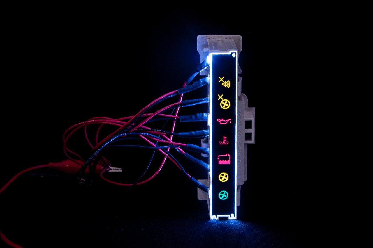

I have a buzzer and LED wired into a switch in the sensor tube in the lower hose, I would have prefered that particular switch in the top hose, being nearer the hottest area of the engine, no room though.
It triggers the 'thermometer' flashing LED in my dash module.
