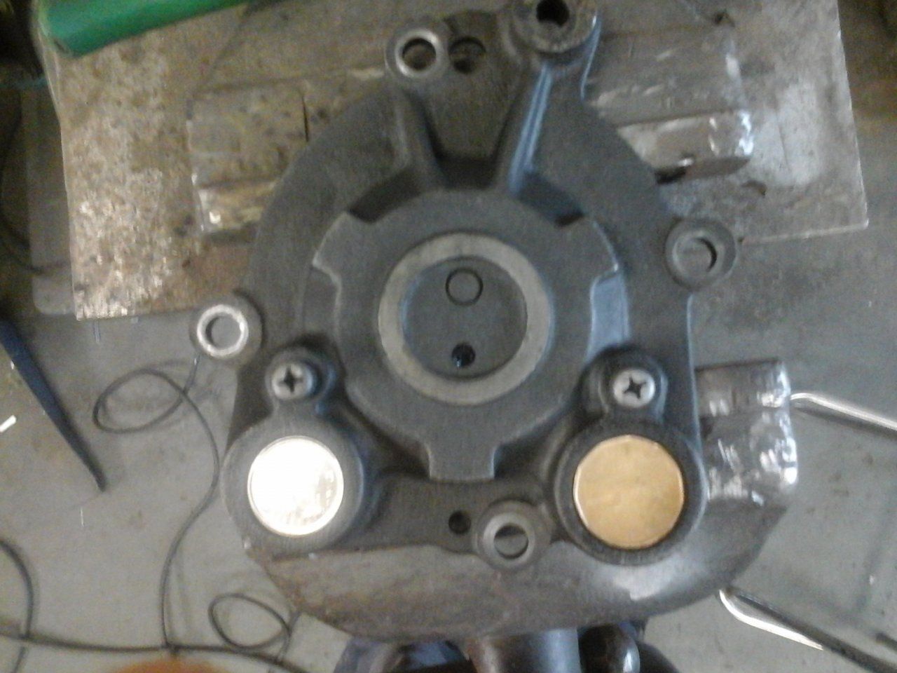

So just wanted to put this out here, if you plan on using your old smog pump for a pulley you should put a grease nipple on the back, right where the old hoses coneckted there was two Phipps head screws, take them out drill and tap screw in nips and grease the thing well.
This will make your old pump now a pulley last a lot longer.
