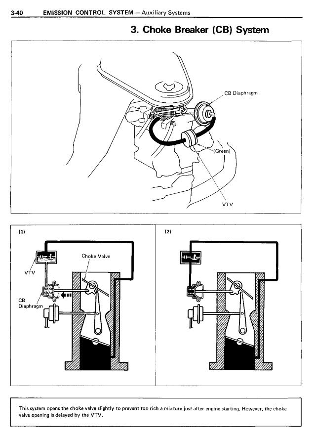

(Dwg attached for others to reference)
The CB has the VTV (delay valve) in the circuit. So if the engine is just started, the CB has not yet gotten enough vacuum to open. If this is a concern, the VTV can be deleted like a non-USA carb so the CB will break open the choke immediately upon startup.

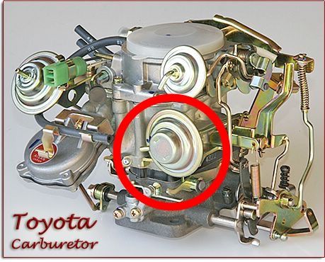

am i right in thinking that the desmogged carb you did does not have a choke opener?
If you have a larger vacuum actuator below the smaller choke breaker actuator, then you've got a Choke Opener. Some carbs I've seen (and a spare I have) don't have it.
Red circle around choke opener actuator below.
no tengo.
suppose the issue could just be that. no choke opener + full choke on a hot engine = engine dies. makes sense right?
Jim are you able to run full choke on a hot engine on your desmogged carbs when you test them?
The CB breaks opens the choke far enough that the choke will not drown the engine, even if pulled all the way on a warm, idling engine.
The somewhat redundant CO opens the choke blade so far that the choke cannot drown the engine even if pulled while driving on the highway.
Since you are not so stupid as to inadvertently apply full choke while driving on the highway, the CO and it's controls go away during a desmog. The CB is retained as a convenience feature.
