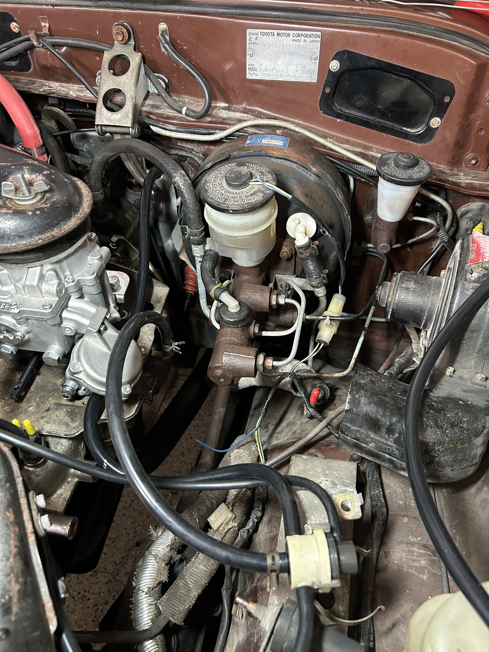

I started on plumbing this weekend. We do not have smog stuff here in Minnesota and the PO started to desmog and had plans for installing a Weber. Here is where I'm at...

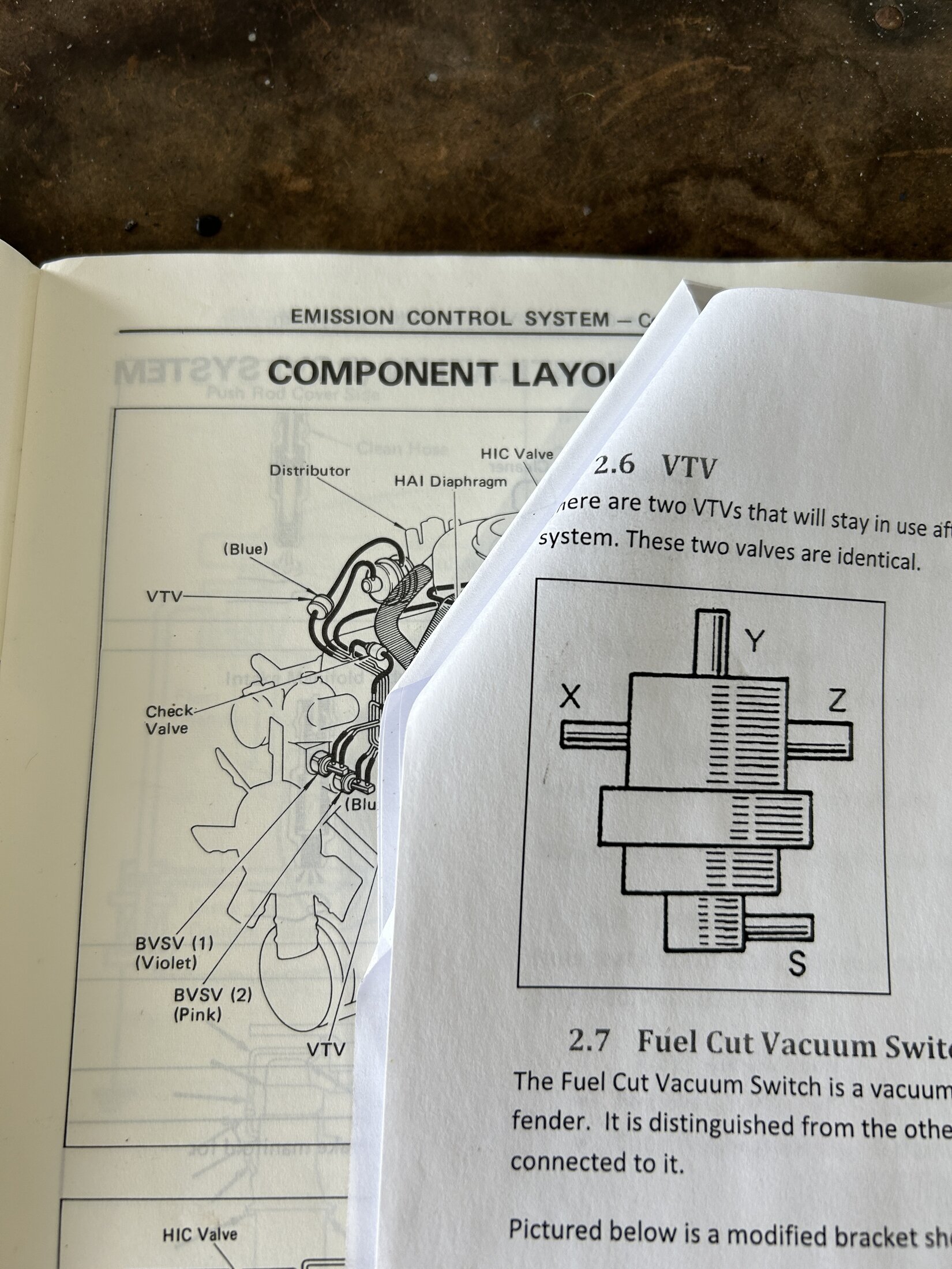

I've been reading the how to desmog file and printed it out. I've been checking off stuff as I go.
The carb is from City Racer part number 21100-61012. It only has the timing advance? Run this to the distributor and plug the other port?

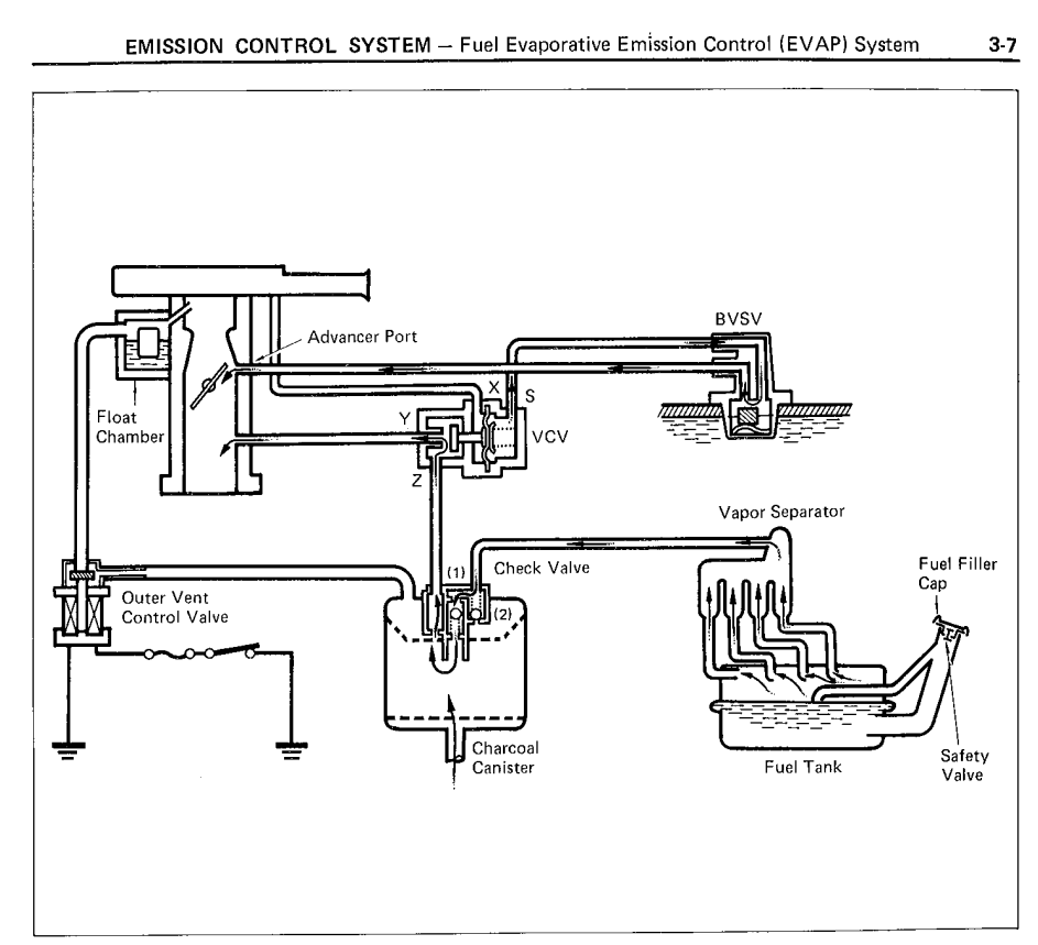

I do not plan on running the HAC. I am going by the directions and incorporating the two VCV's. I have the one under the air cleaner and mounting the other on the drivers side fender. I do have the 3 port gas filter and running one line to the VCV under the air cleaner. I have the other 2 plugged. I also have the BVSV #1 installed.
The drivers side is what Id like to learn more about. I figured out the Line (y) to carb insulator (unchanged).
One hard line under the brake booster with a 90? The remaining flexible lines were for the original carb? I have the emissions manual but not in front of me.
Yes; plumb the inner vacuum advance port to ported vacuum at the base of the carb.
If you're not going to run the High Altitude Compensation system, then yeah, just plug that outer port on the advance mechanism.

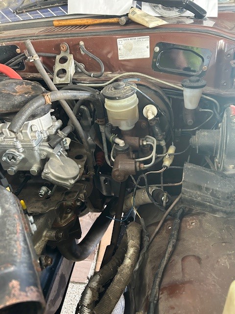

Red plug on the “to tank”
Hooked up brake booster hose to manifold and plugged the small nipple
looking up what the lonely blue wire is
