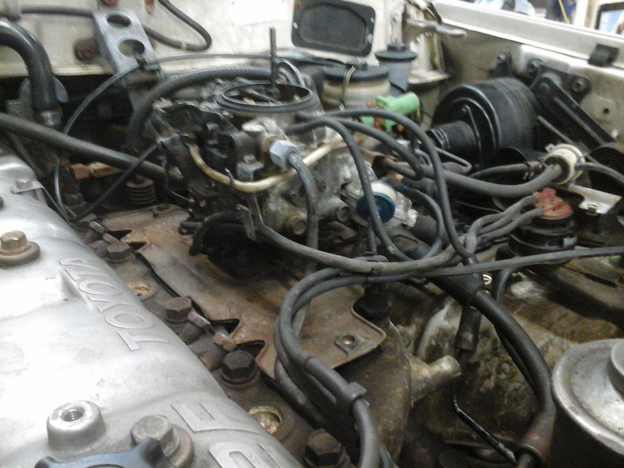

Here are some pics...

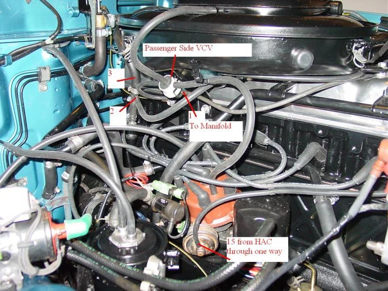

So my question is this. I have a bad VCV valve (passenger side) and while looking for a replacement I was wondering if I could just go straight from the dizzy breather to the vacuum intake on top of the air cleaner on the passenger side. Why the need for a valve to open the dizzy to vacuum when the truck starts, but not have it open to air when sitting?
Also... Per the earlier posts (943/944), where are the gas fumes coming from? How do they get into the dizzy to cause the pop?
Any help or explanation would be helpful.
Thanks!
Okay... Just answered my own question with a search for VCV. JimC states that the fumes come from boiled gas from the carb filling the air cleaner and the VCV keeps them from going into the dizzy and then being ignited by the spark.
So if a VCV fails, I thought it fails closed... If so, then how are gas fumes getting into my dizzy to make the pop?

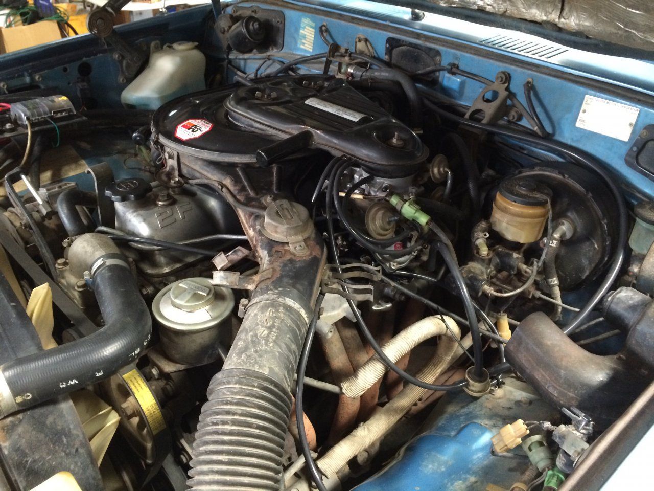

My engine at the moment:
If everything is hooked up correctly (it sounds like it is) and the tank is still getting a lot of pressure/vacuum, then it is time to try swapping the hoses on the canister.
