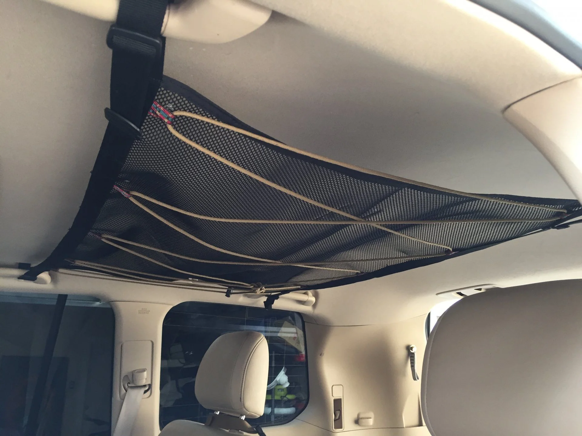

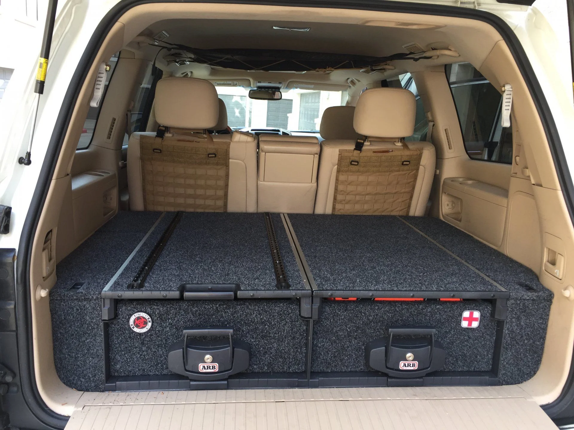

knocked out just a few things this weekend:
  • Attic from Blue Ridge
  • Mole panel for the 2nd row seat back from Blue Ridge - really nicely done

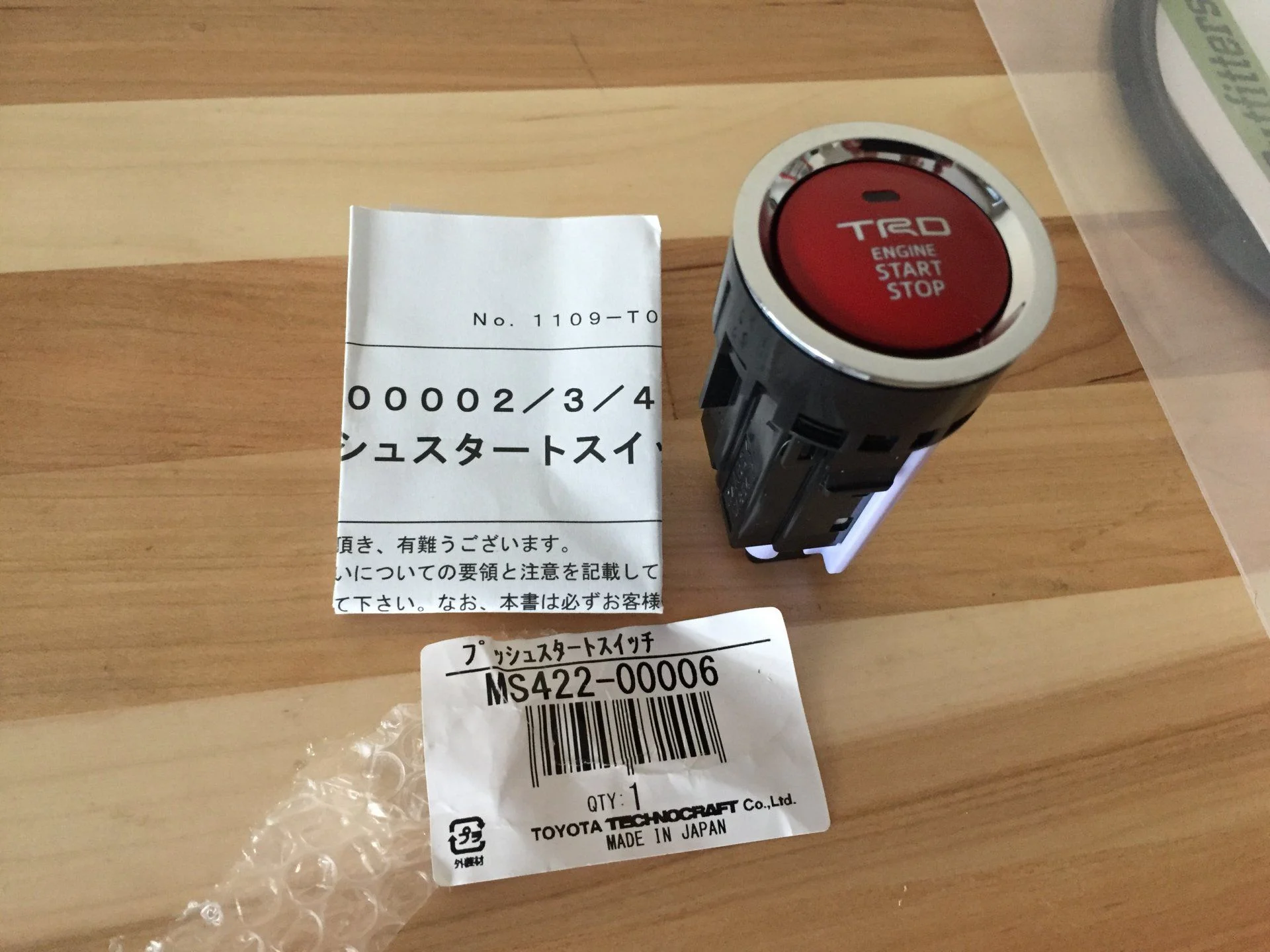

  • Hoping to get the starter button upgraded to the TRD one - I know it's at least 15hp......thanks @beno - he's got the lead on these for anyone interested...... the ebay ones i found were frauds.

Since you just put them in, how much can the second row seats recline with the drawers there? Or how many clicks can they recline?
I like the attic, been thinking about it for a while, I just grew up with the "don't ever touch a headliner!, they aren't designed to be touched!" So I've got to come to terms with that in my own mind.
the seats go all the way backwithout hitting - when in full recline they hold the Molle panel nicely
I'm in exactly the same court on the headliner - my dad beat me within an inch of my life once for playing tic tac toe on the roof of his old merc... but this is a really nice option for blankets or light stuff that I need to run to the boat that I don't want the 110lb german shepard making his dog bed....

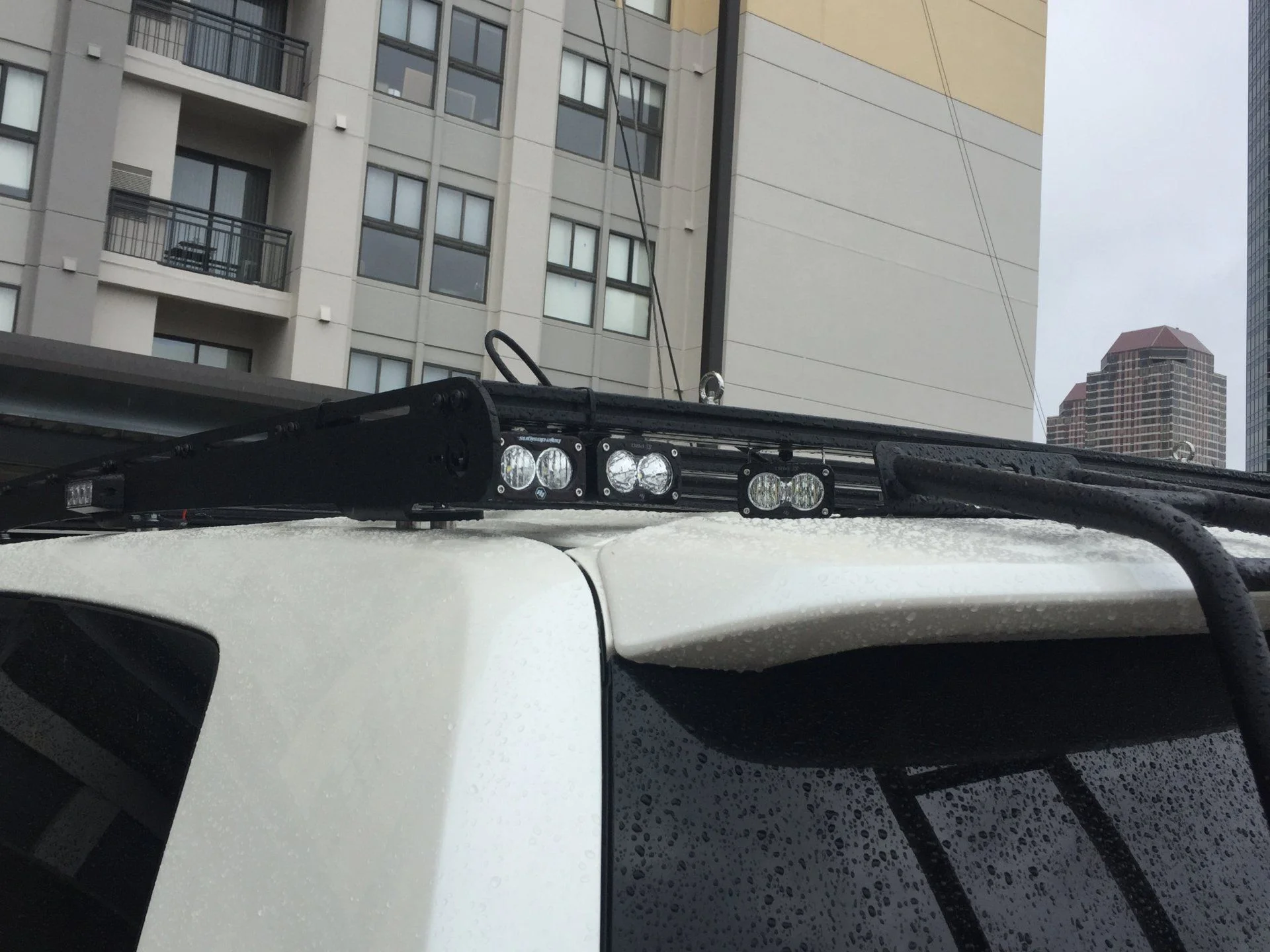

I added some Kawell flood lights to the side of the Prinsu Rack - their 18 watt, priced right and fairly flush, and Cheap ! And then added 3 sets of Baja Design S2's to the rear of the rig - not cheap...... 2 sets of floods - one straigh back and a set at 30 degrees - and one set of their new S2 Racer spots..... they're crazy bright for their size !
Waiting for a few parts to tackle the wiring .....
