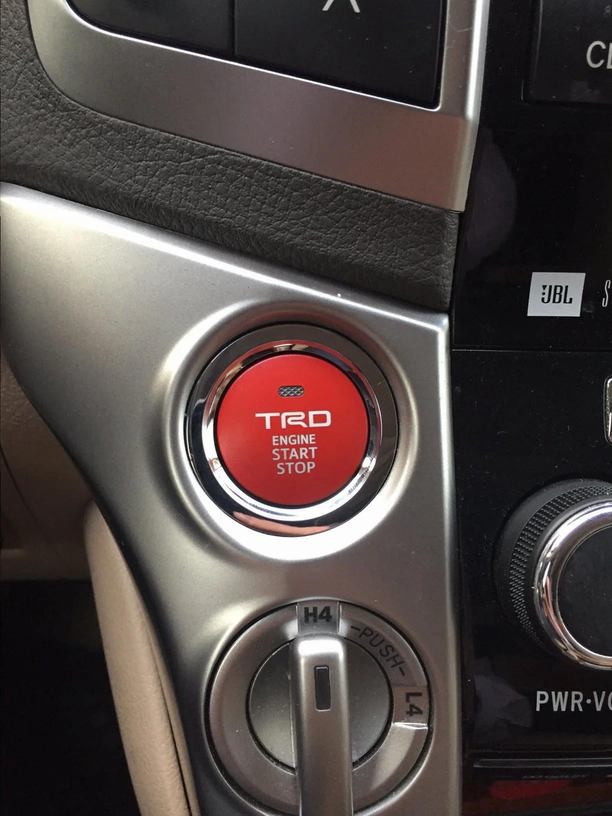

I added the TRD starter button while i waited with some guidance.... I'm sure it adds at least 20HP....

trd start button looks cool. what did it cost and was the install as easy as plugging it in?
I gained at least 20hp, if not 30hp from my TRD start button and TRD shift knob. Both can be found on Ebay, and it's a very easy plug-n-play 10 minute install. Here is one of several vendors selling the start button - I "offered" $100 for mine and it was accepted:

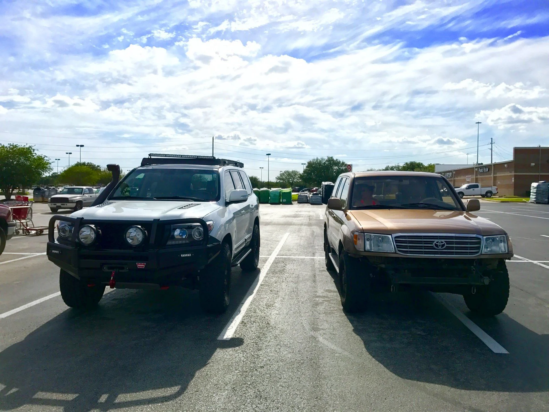

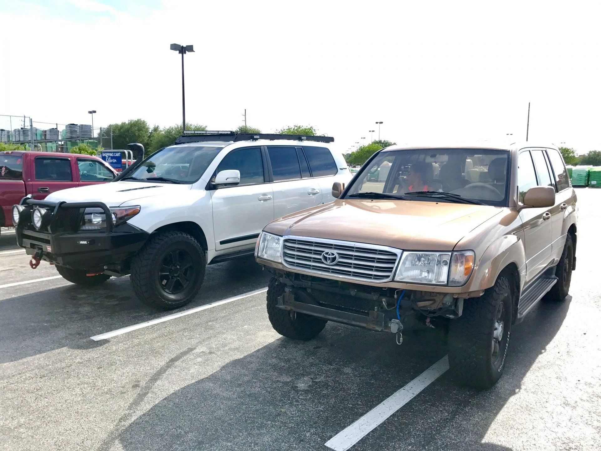

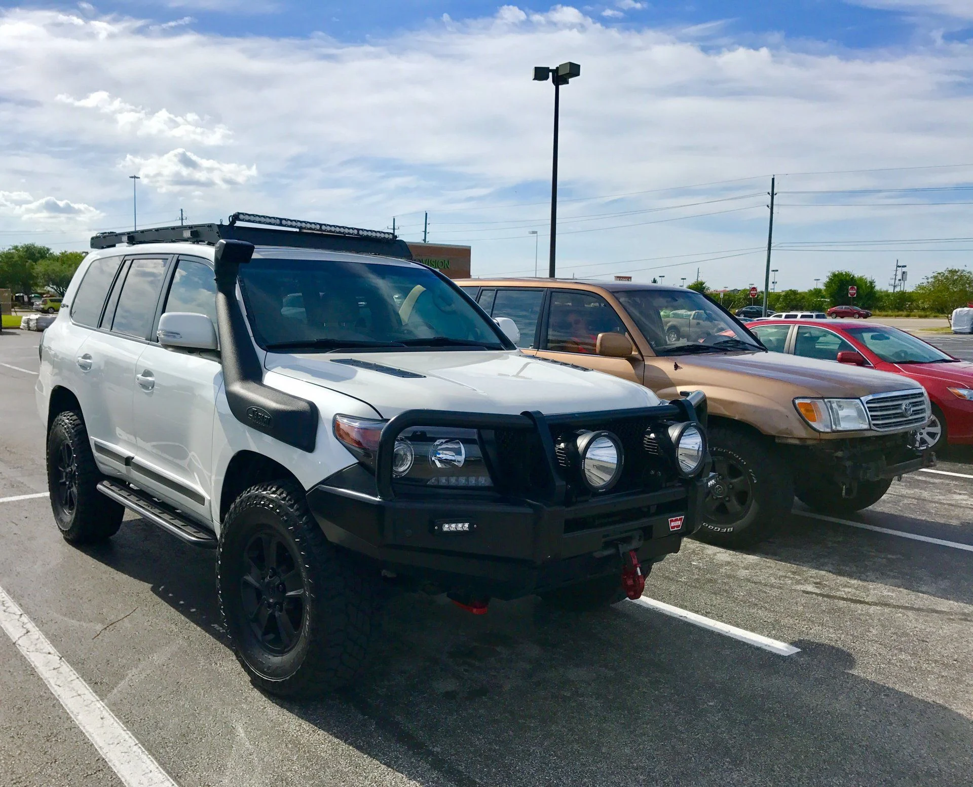

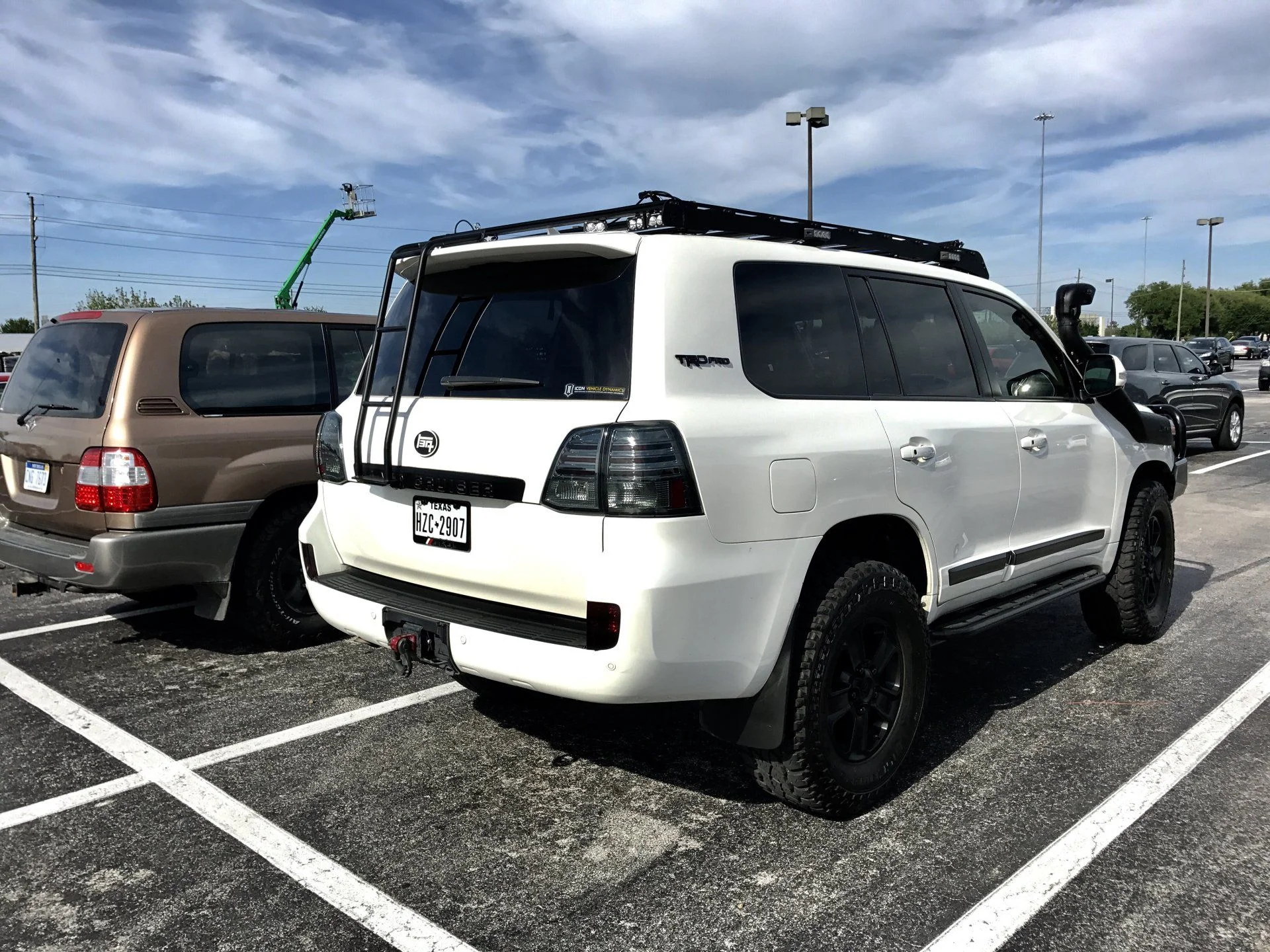

Crazy story. Was at a lowes near Katy TX today and pulled up next to a drop dead gorgeous 200. Took some pics of my 100 posing next to it. Jumped on here and accidentally found your build thread. Awesome to see (stalk) this truck in person. Wish I could have met you...thanks to you, my wife now wants a 200.
Sorry to miss you
You still in Houston ?
Your wife is right ! My gf is already supporting my idea Iof another fast car so she can steal the lc'er.....
Happy to let you / her drive the rig if you're around
E
Gotta say...you do drive the best looking white 200 I've seen.
View attachment 1440503 View attachment 1440504 View attachment 1440505
I love that in these three pics you took, your wife is staring at RS6tofj80's truck in awe. :p

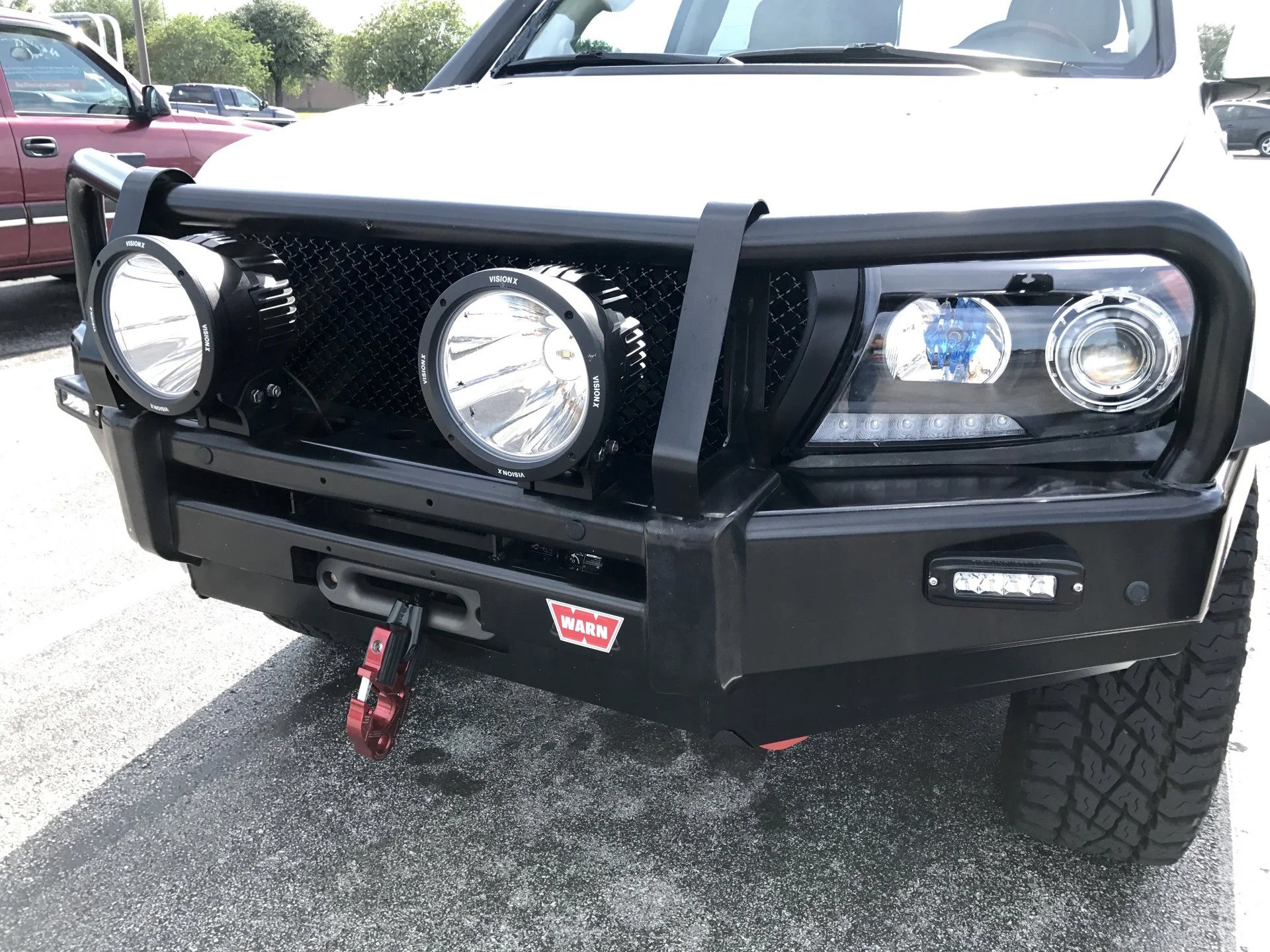

Those Vision-X's look like they would burn a serious hole through something at close range. They poke out of that bar a fair way too!

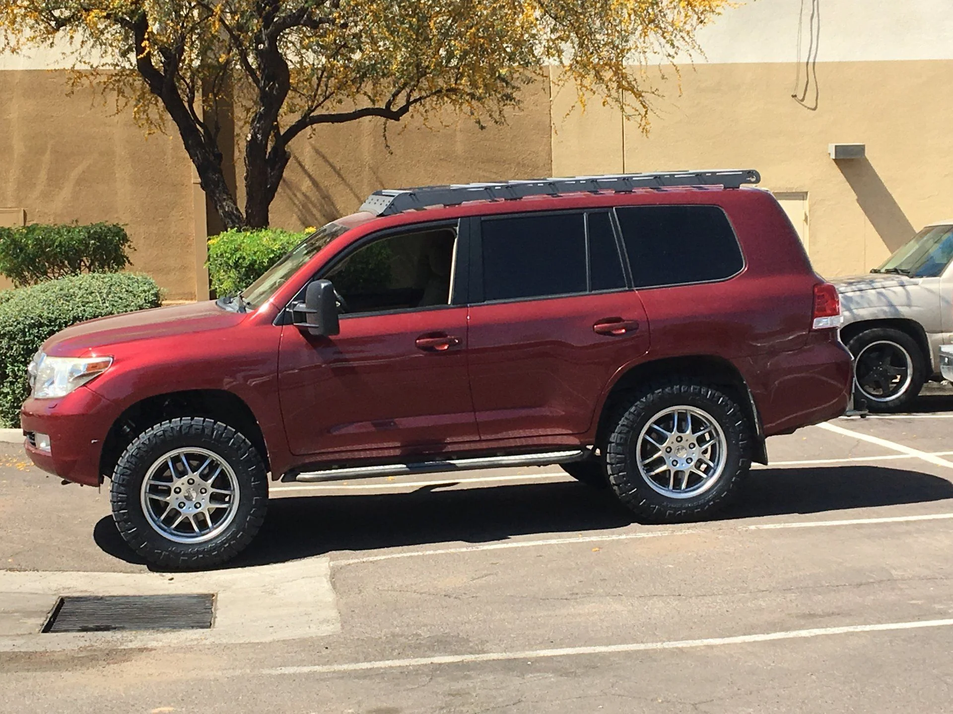

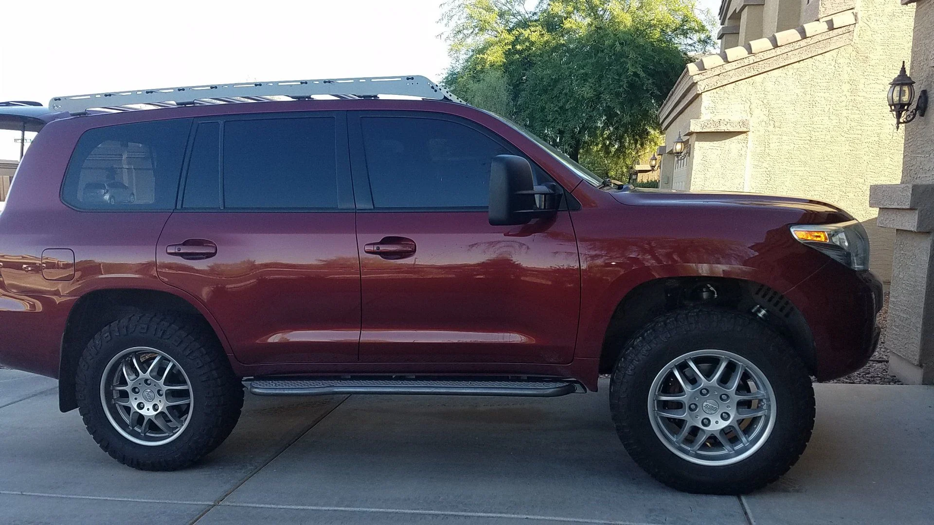

haha - been travelling too damn much but have decided I don't want to run spacers after snapping a stud in the front - might of been a fluke but....
trying to get my hands on some Volks with the right offset - will have to run a bit narower tread I think....doing a test fit of a 20x9 Et 55 next week ....
E
20x9 Et 50 fits pretty nicely.......5 mil shouldn't make that much difference.

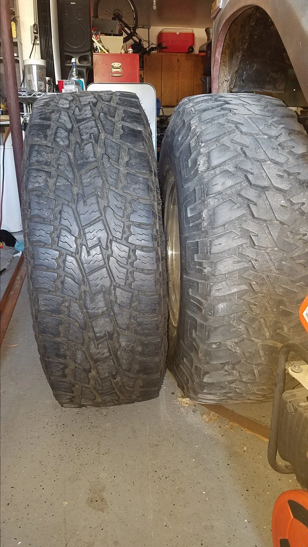

35/11.50 r20.
I have a spare 295/65r20 that is as tall at my 37s I've been wanting to test fit.
I used the SPC upper arm adjustability to push the wheels forward. I think I could clear the bigger tire, I've got an inch clearance from the body mount now.

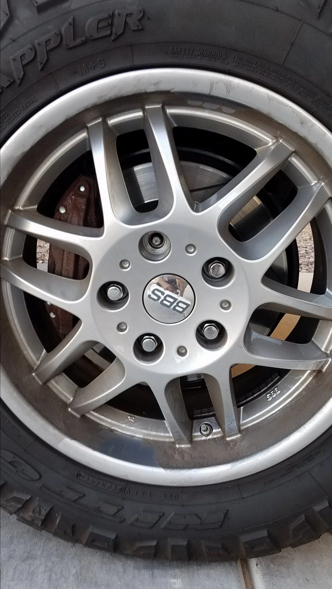

Played with mounting the spare tonight.
Used a nylon strap to measure the circumference before mounting.
295/65 and 35/11.50 measured 110.5 and 110.25 respectively. True 35" tires. Second pic 295/65 next to 37x12.50r17 then this happened. Lugnut galled....tightened with regular ratchet just for the pics, then wouldn't come off. Snapped the lug and put regular wheel back on grrrr...
