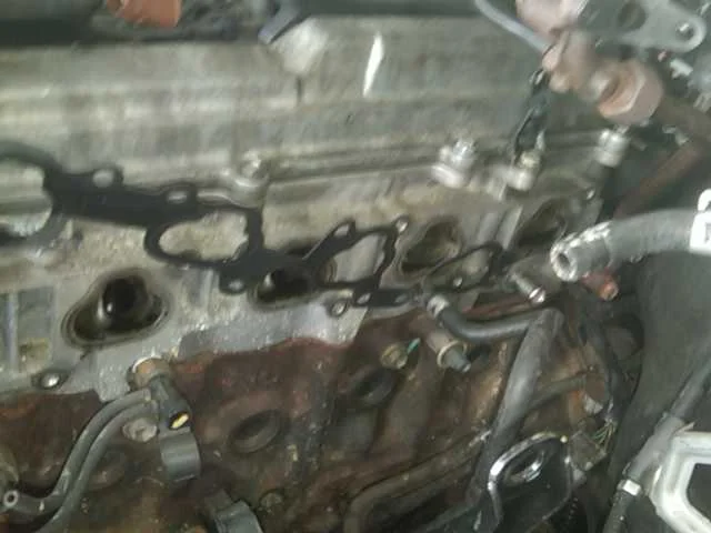

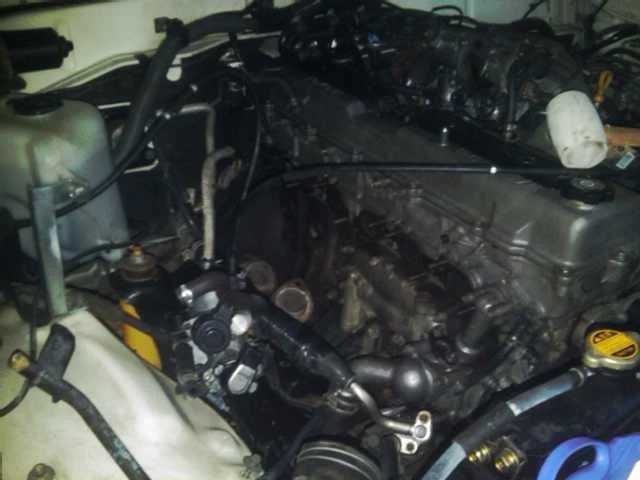

Looks like your PHH still has the factory cotter-pin style clamp on it. Post #8 second pic.. Did they change out all the rubber hoses while the engine was out???
Rubber was replaced about 30,000 miles ago.....

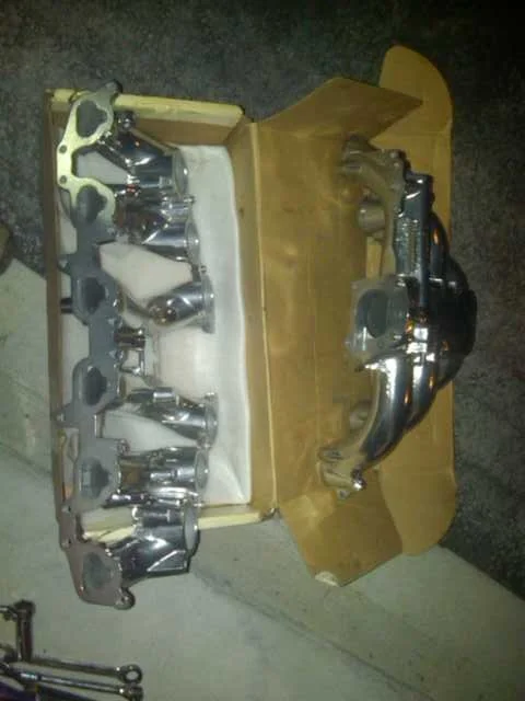

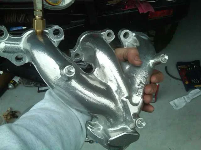

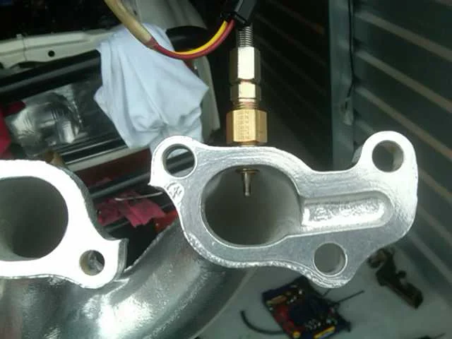

I got a bit carried away and pulled the the exhaust manifiolds, intake manifolds and airbox to have the aluminum ceramic coated.
Airbox was powdered black on top to keep the stock appearance.
This should keep the intake air temp cooler than without. How much, I don't know but I'll post up when I get it installed Thursday. I do know that when wheeling the intake air temp skyrockets up to 150-160F range.

2) I was told by 80 owners that have done the SC in the past that before you put a SC on a higher mileage engine make sure to replace; the HG (if original) or unsure when/if it was ever done, compression check, replace fuel filter, fuel injector cleaning, flush cooling system & replace thermostat, blue or black hub fan clutch, replace any leaky oil seals and ensure that your transmission is up for the additional performance with a flush of fluid an cleaning the filter. Since I was already "in there", I also choose to replace the fuel pressure regulator, vacuum hoses that weren't affected by SC install. PHH on the driver side was also replaced on the driver side (newer but compressed from clamp hose and didn't want to use them again)
I also had intake plenums dipped to remove carbon and aluminum ceramic coated along with the exhaust manifolds and the stock airbox. The airbox was then powder coated black on top of the aluminum. These last few items were personal choice and not recommended by anyone in the cruiser world i.e Mud but the folks that do alot of NASCAR work here in the area recommended the coatings to keep the underhood heatdown and keep the intake air colder.
X2 - damn shame to have the engine out and not do the PHH.

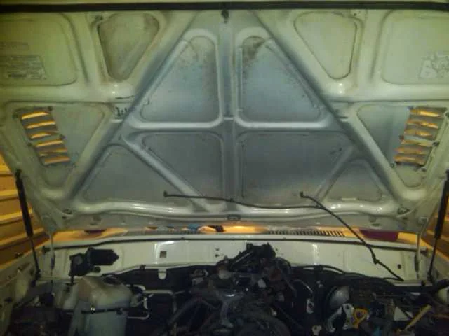

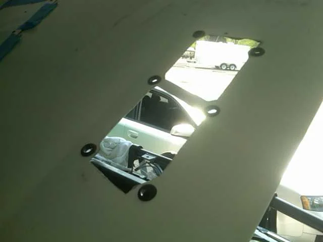

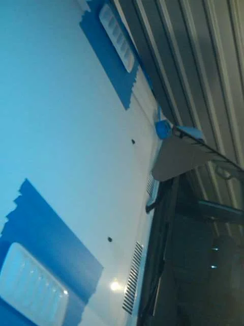

Sam, I can't remember if you told me or not, but what are those vents off of??

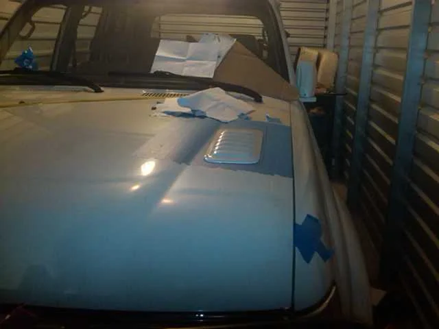

They are off a 1998 Jeep Grand Cherokee 5.9L Limited, like the one that I used to have. The Jeep white paint is a pretty close match to the 80 too. Saves me from having to paint them.

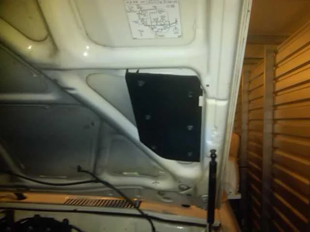

They have trays for underneath that I trimmed to fit but I will only install those for winter.
They let out alot of heat from the tightly stuffed 360 cu. in. in the Jeep. I'm sure they will do the same on the 80.

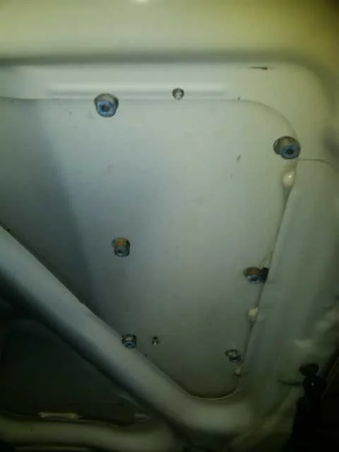

Here's a pic of the vent trays mounted for winter, the summer mounts and a close up of the six holes drilled for mounting.
Anyone who does this in the future, don't bother with drilling holes for the two little alignment tabs on the vents. Just break them off if they don't snap off on their own as they are very fragile.
Use a step drill on both sides and use rubber grommets.
those intakes and manifolds look great if you don't mind me asking how much did that cost to get coated?
