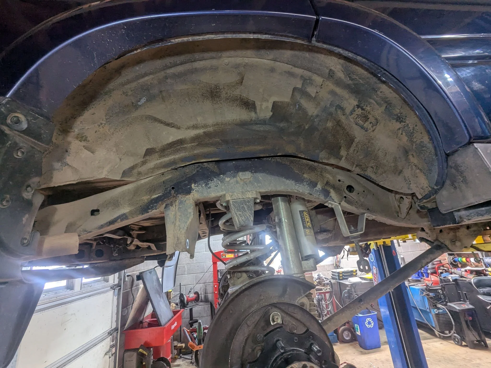

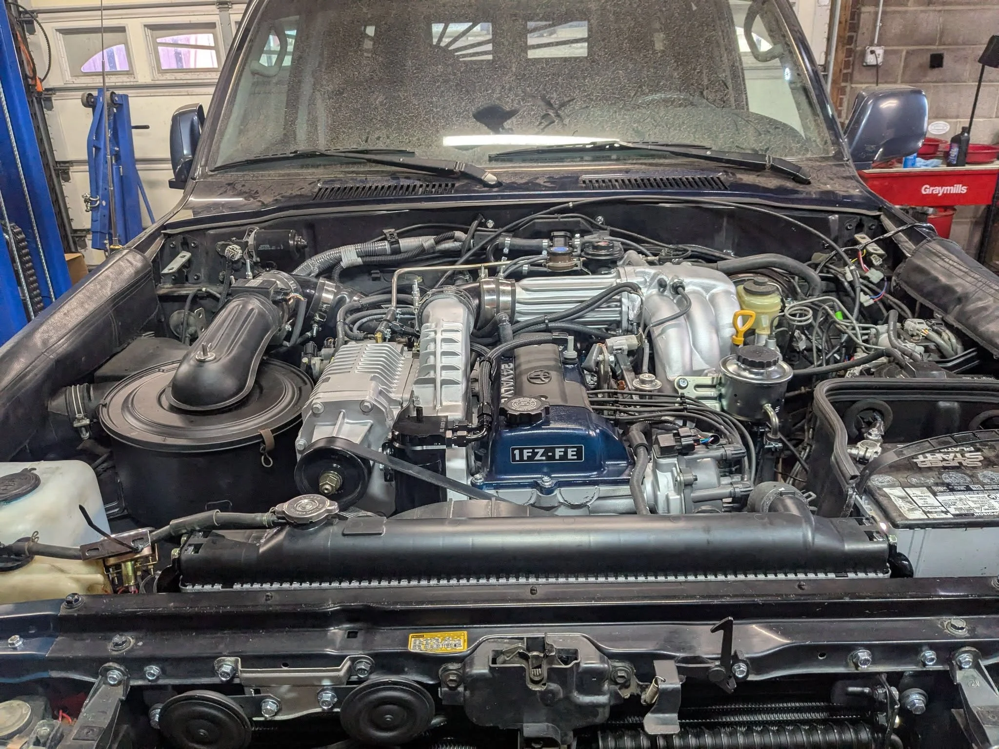

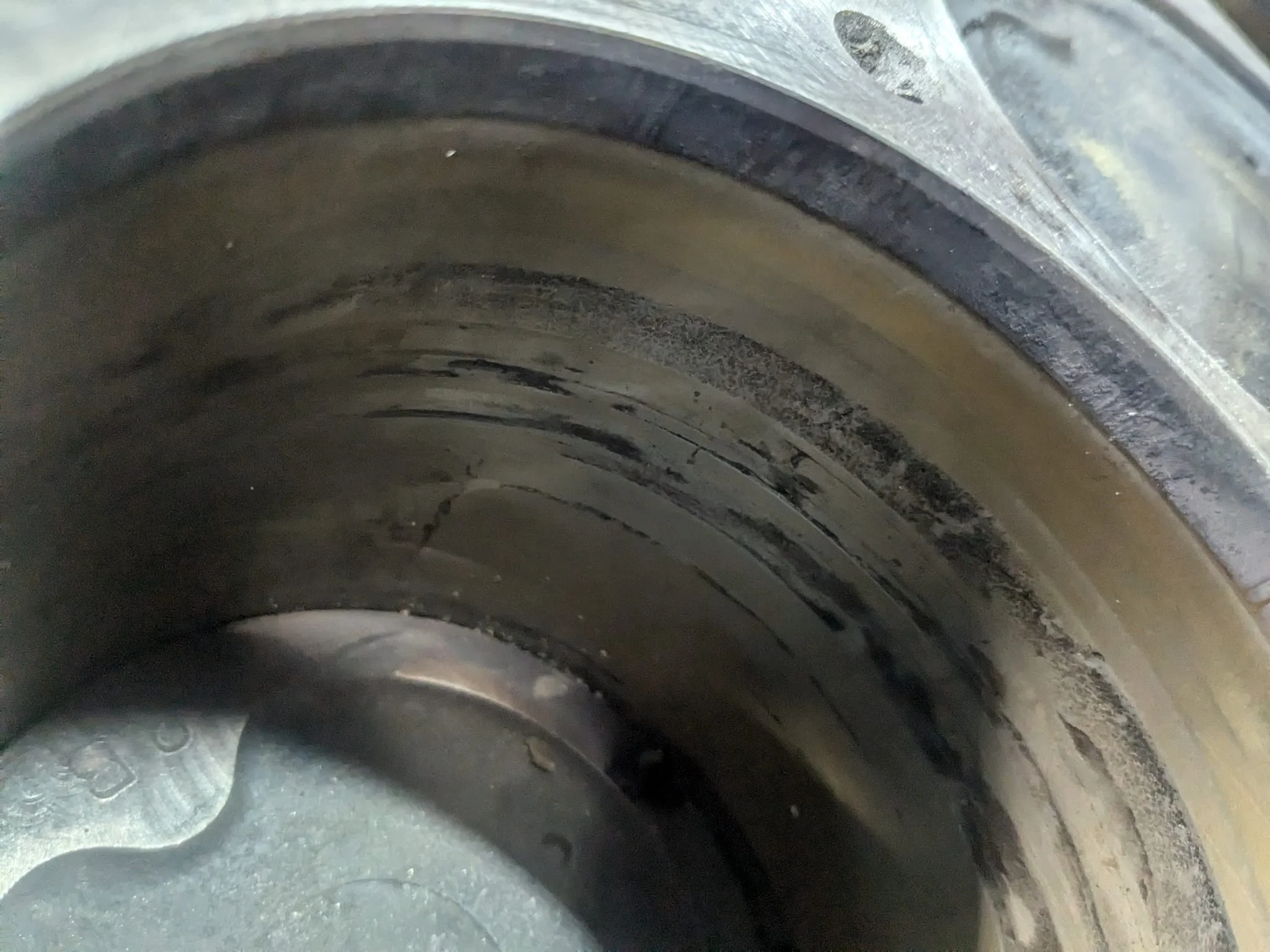

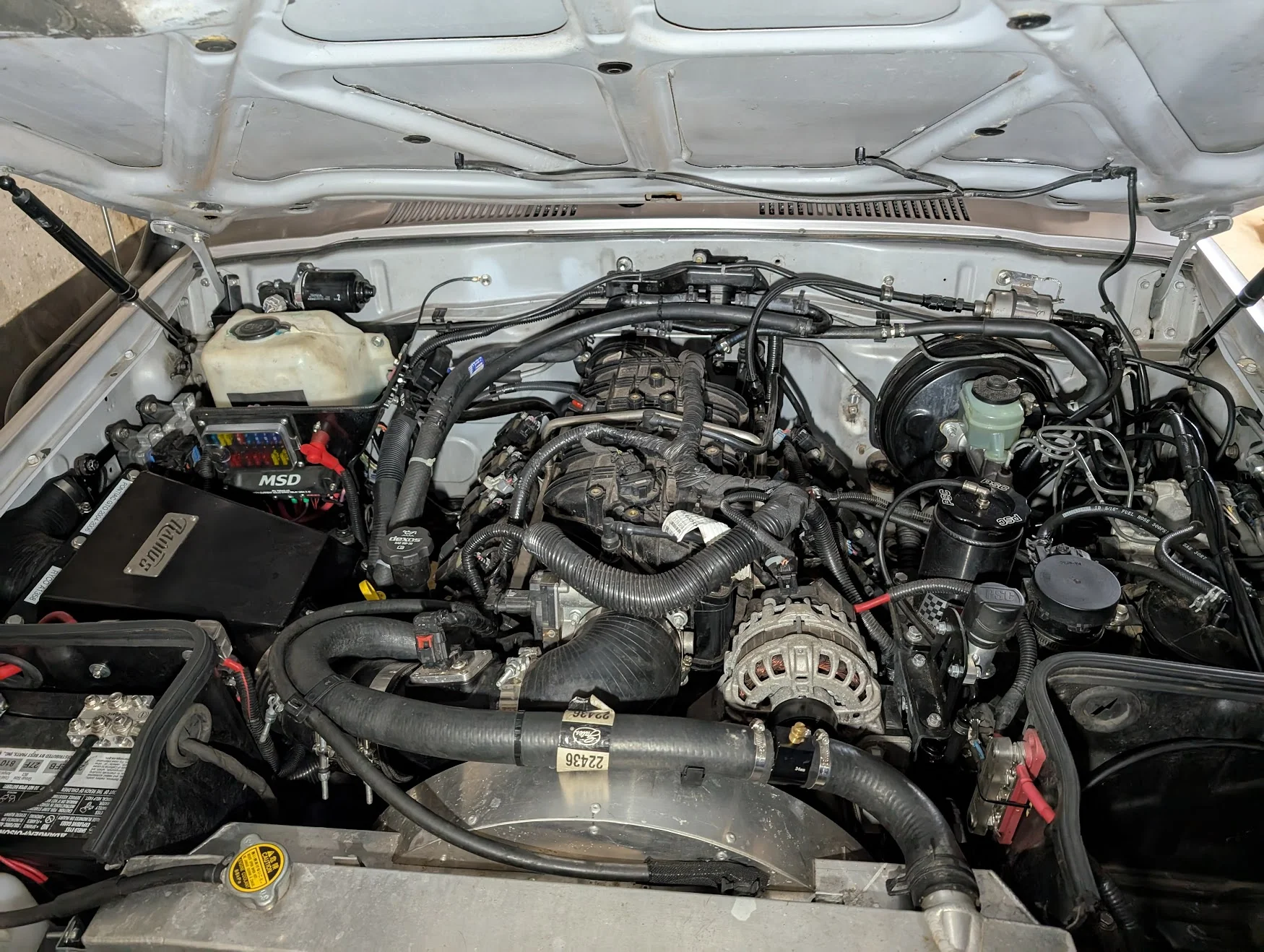

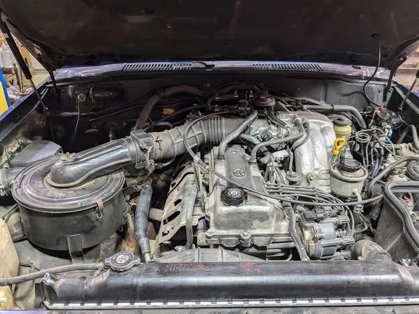

Had a customer come in In DEC to have 1 of the new Super charger kits installed. We decided to do a head and gasket while there. Boy what a shock we got when we pulled the head.

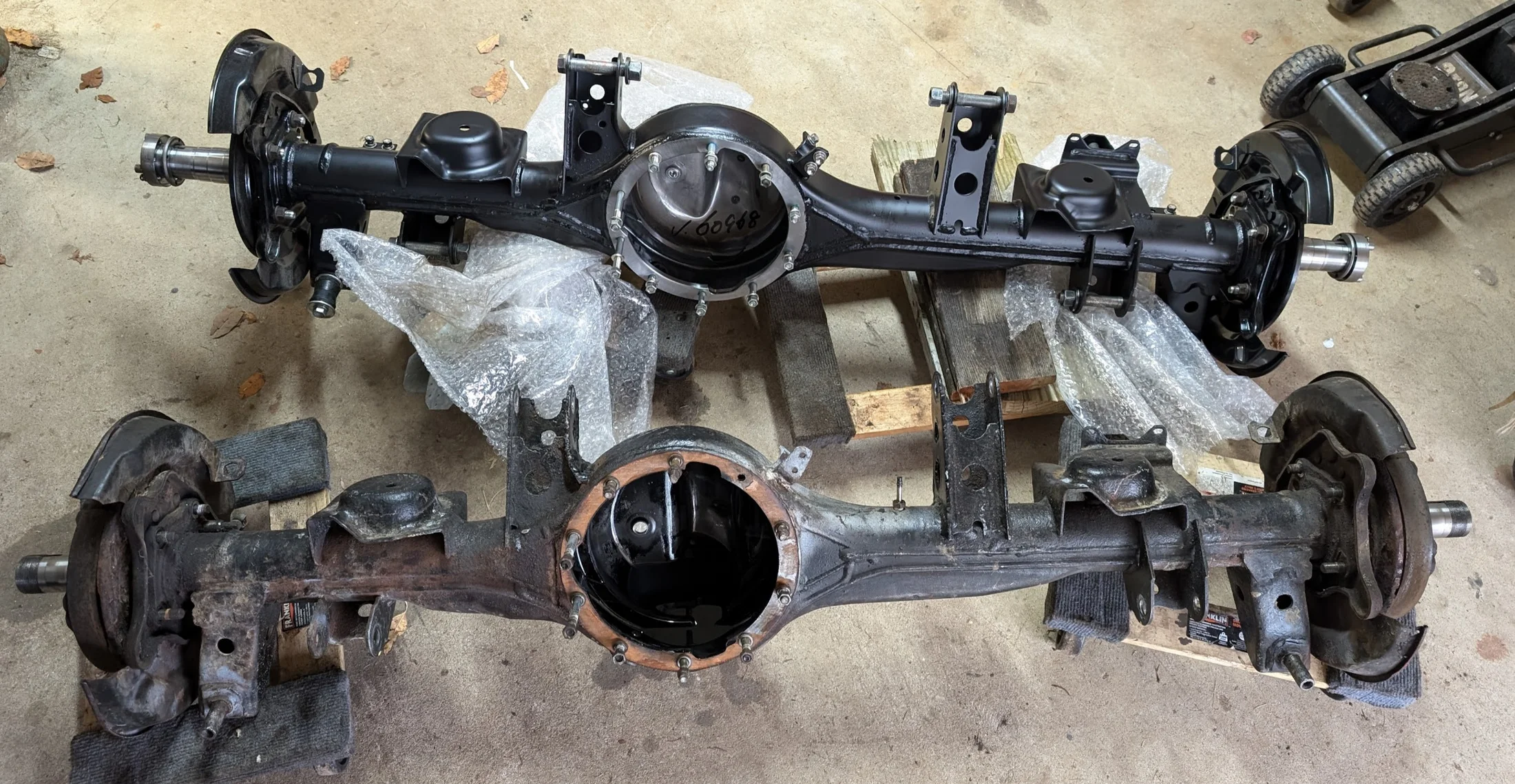

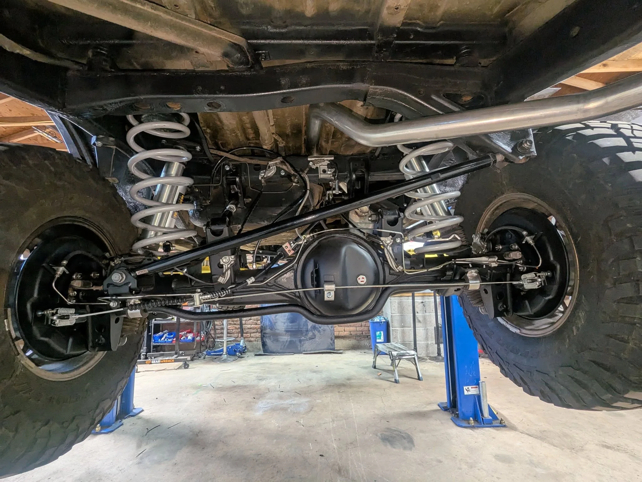

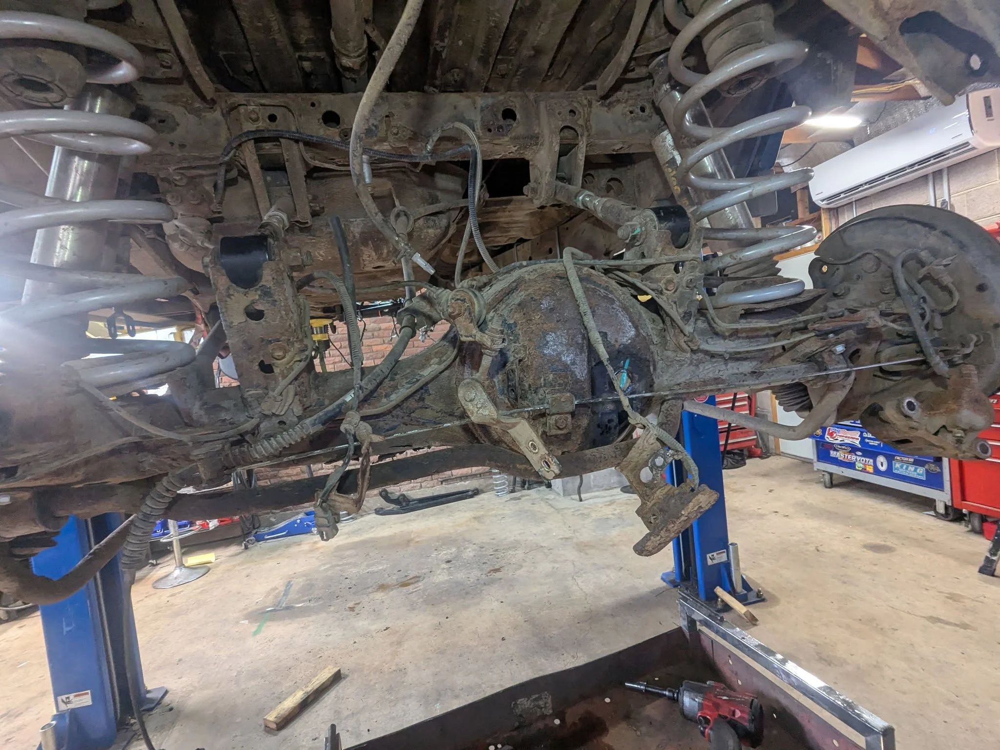

The PO over heated it real bad and from the look of everything heat seized #6. So it turned into an engine as well. Customer said Lets do a semi restores on the axles and chassis . This beautiful 80 Has a lot of chassis rust. Long story short He has recently has new gears (nitro crap) and arb lockers done by a different shop. When we pulled the air tub for the frt locker a bunch of gear oil came out. . So we pulled the 3rd to inspect it . We found it covered in metal shavings. Even after they did the required 500 mile lube change and a 2000 mile lube change. The cause was a combination of low quality gears and a missed set up. We pulled apart both the frt and rear and rebuilt the almost new lockers and replaced the gears with a fresh set of 488s by revolution.

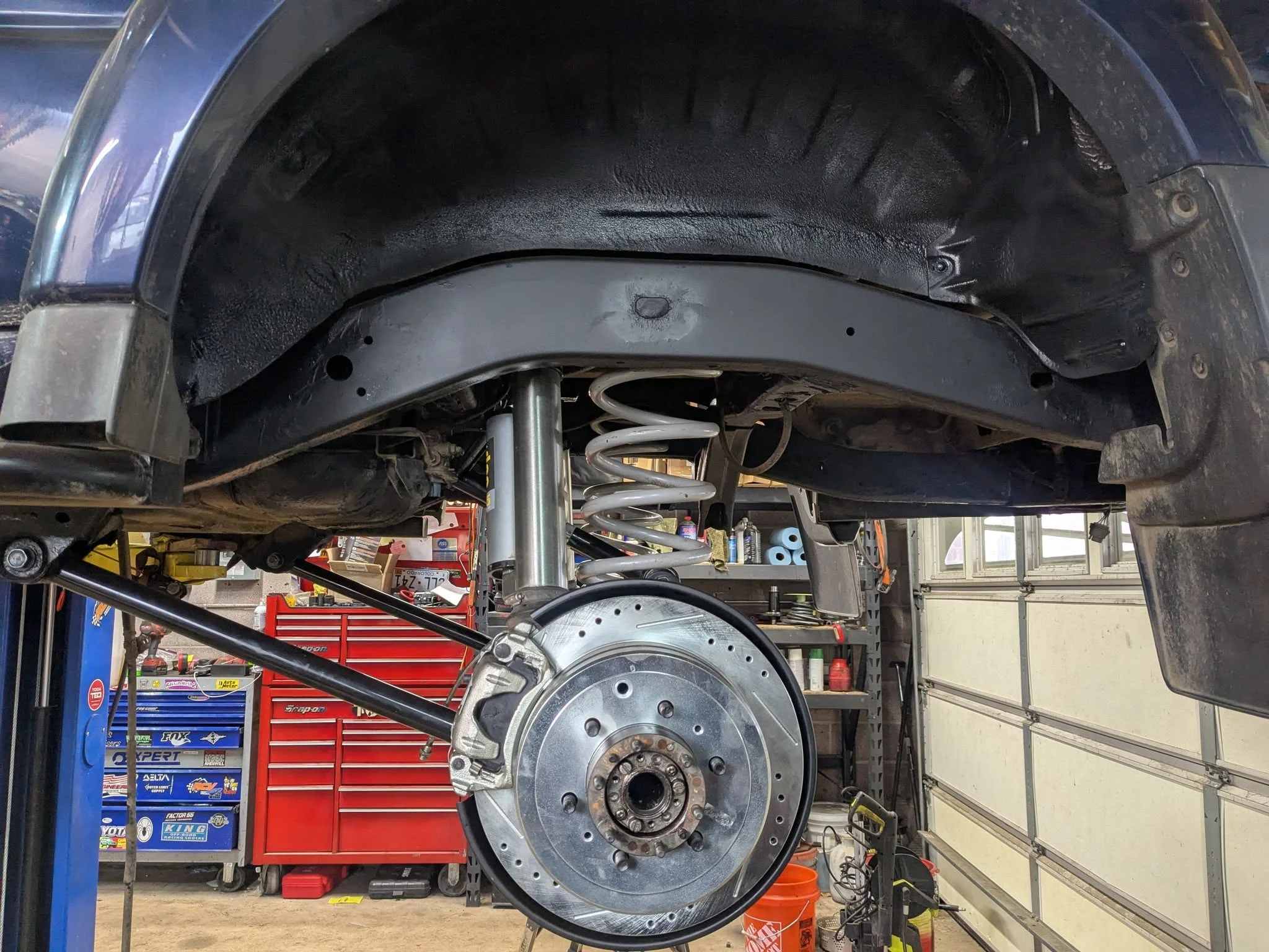

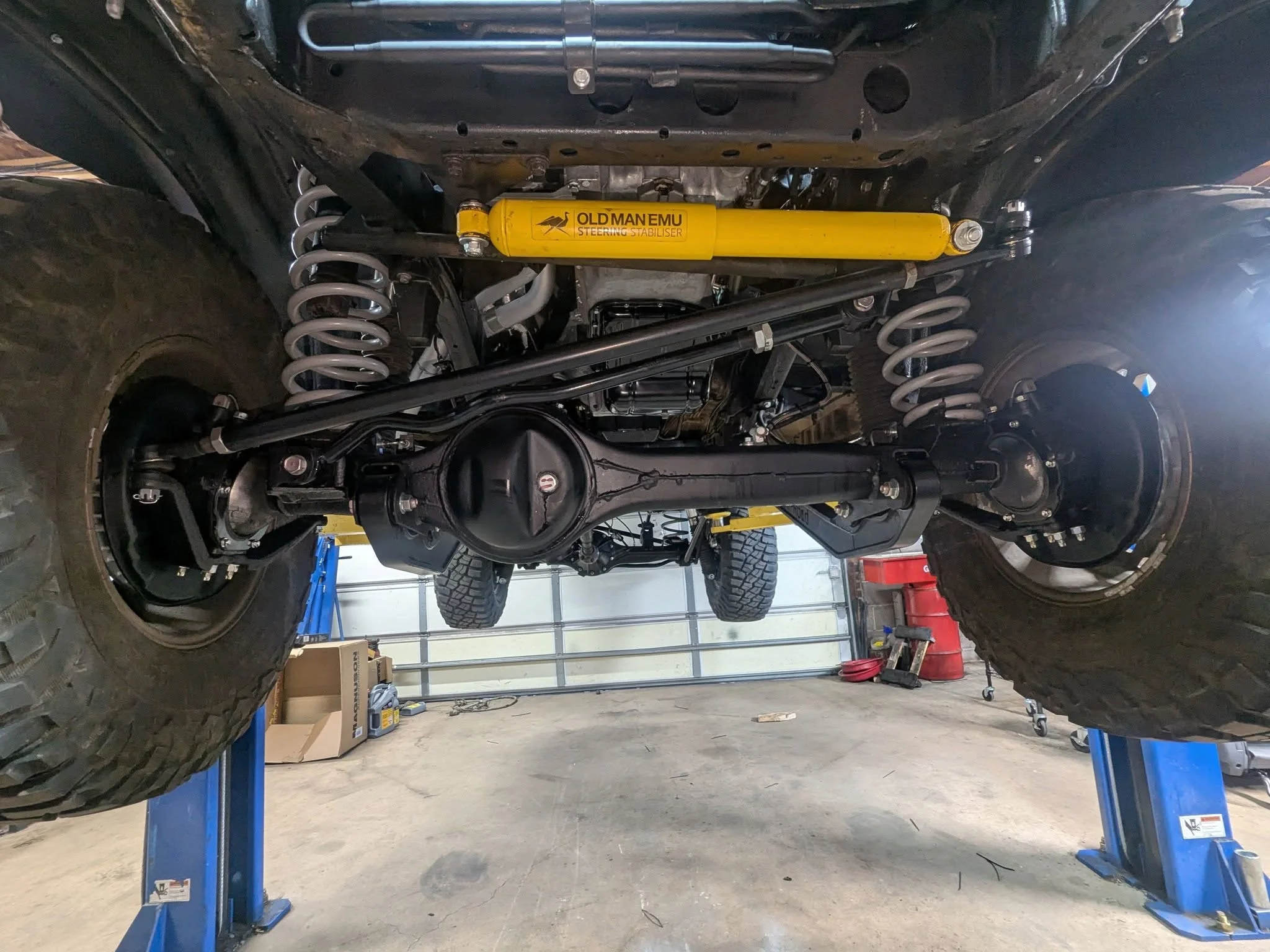

This was a fun job working with a customer that wanted it right . Every thing on the engine was brand new from Toyota every nut and bolt . I mean everything . We custom made stainless steel brake lines and restored both the frt and rear axle housing. We also treated the under body surface rust the best we could without a body off restore.
We delivered this back to our customer the beginning of march (Yes 12 week turn around time ). He just left the shop after we did his 500 mile engine oil and gear lube change . Along with a Tom woods dble cardon frt drive shaft . Can't wait to get the owners feed back now that the everything is broken in and he can let it rip .

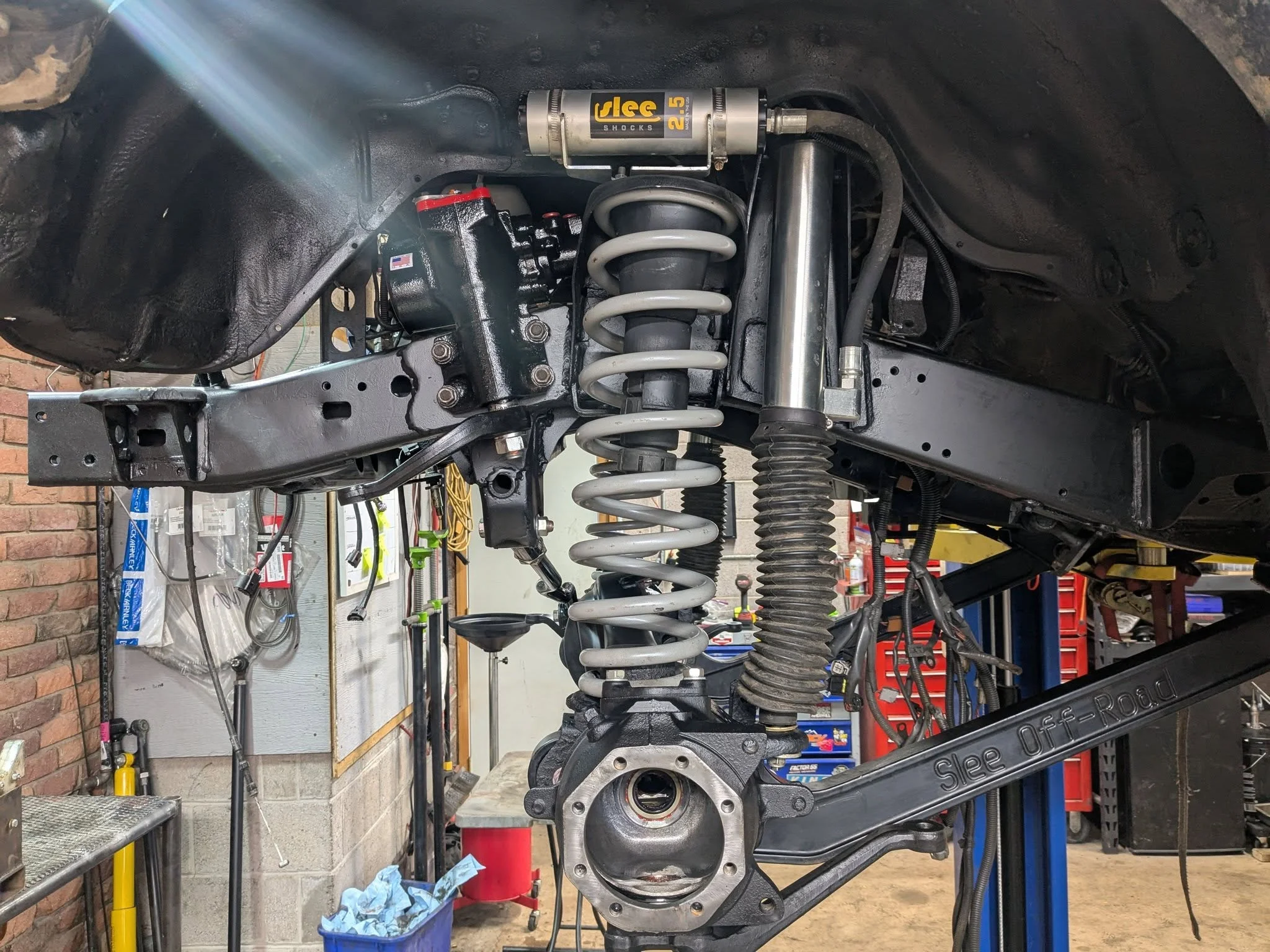

We also found a crack in the track bar mount . We installed 1 of our frame plate kits and of course a 105 redhead steering box
These are a few of 100s of pictures. Sadly my photographic skills do not match my restoration skills. We will have our SC catch can kits available in a week or so

My original rear housing and frame matched his.

- Sometimes the surface appearance of a truck (clean interior with very low wear, no leaks, low miles (100k), no body rust, bone stock), and an apparently friendly midwestern, retiree seller who insists he's had no major problems with the truck in the 20+ years he's owed it is all just an illusion (see photos above of the cylinders)

Thank you Wade for the nice write up.. Land Cruisers are a passion for me, even more so the 80 series. I am glad we connected . I didn't realize how much I missed doing custom and restoration work. Even know working with a customer who spends way too much time on MUD can be a pain in the ass haha.. I enjoyed helping you understand the "whys" of what we did and the reasons I use the parts I do.. Don't feel too bad about what the PO did . I was just as shocked as you when I pulled the head and found the bad cyls.
I am glad you discovered it had a head gasket done @ such low mileage and decided to re do it from the start. What a mess it would have been if not. I'm looking forward to the show in May. Because my pictures do not do your rig justice. Plus it lets me drive it again !!!!!!!!!!!!!!!!!!!!!.
