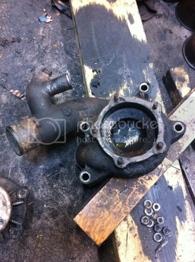

The timer stayed in my H. I don't have the 2H FSM. Maybe it's different and the timer comes with it. On the H there are 4 bolts/nuts that you remove and the pump slides right out, no special tools required. There might be a bolt that holds the pump to a bracket and the block that's not obvious.

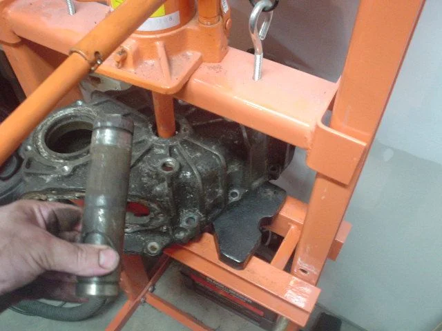

I got the pump out the back. It came out with the timer. There is a large o-ring that seals it to the front cover.

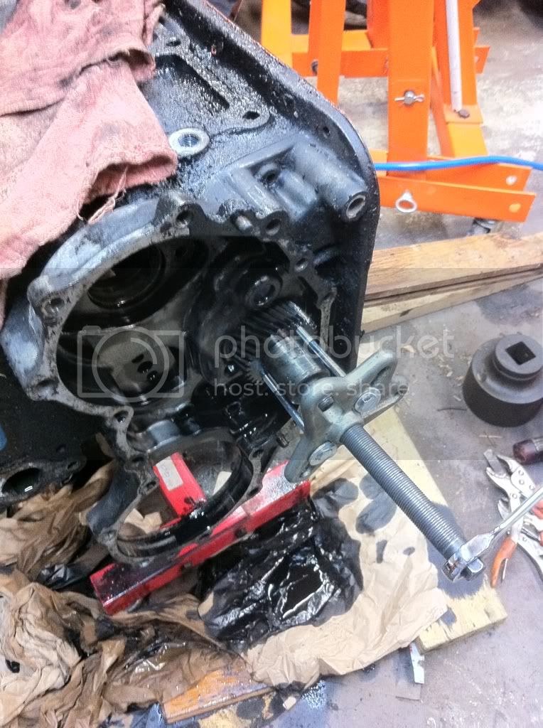

Now I am stuck at the crank gear. My puller is at work. Tomorrow I might be able to make it out to Harbor Freight to pick up a cheap kit. I use the $9.99 kit there at work and it works great.
For the love of God I finally got it. Three nights of messing with the crank gear and I finally got it. I am more familiar with these when they drive timing belts but the concept is the same. My 6x1.0 bolts were not long enough so I bought the longest ones I could find, 6x1.0x80. They were just long enough but I would like more. I also bought 100mm long all thread but I ended up stretching those.
Well after a lot of propane torch on the gear and brake clean on the crank to cool it I finally got it off. I cant explain how much torque and sweat I have put into this.

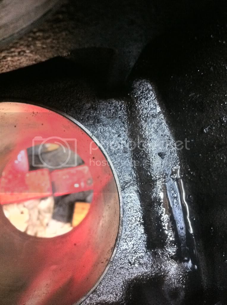

Once everything was out I realized how thin the liners actually are.

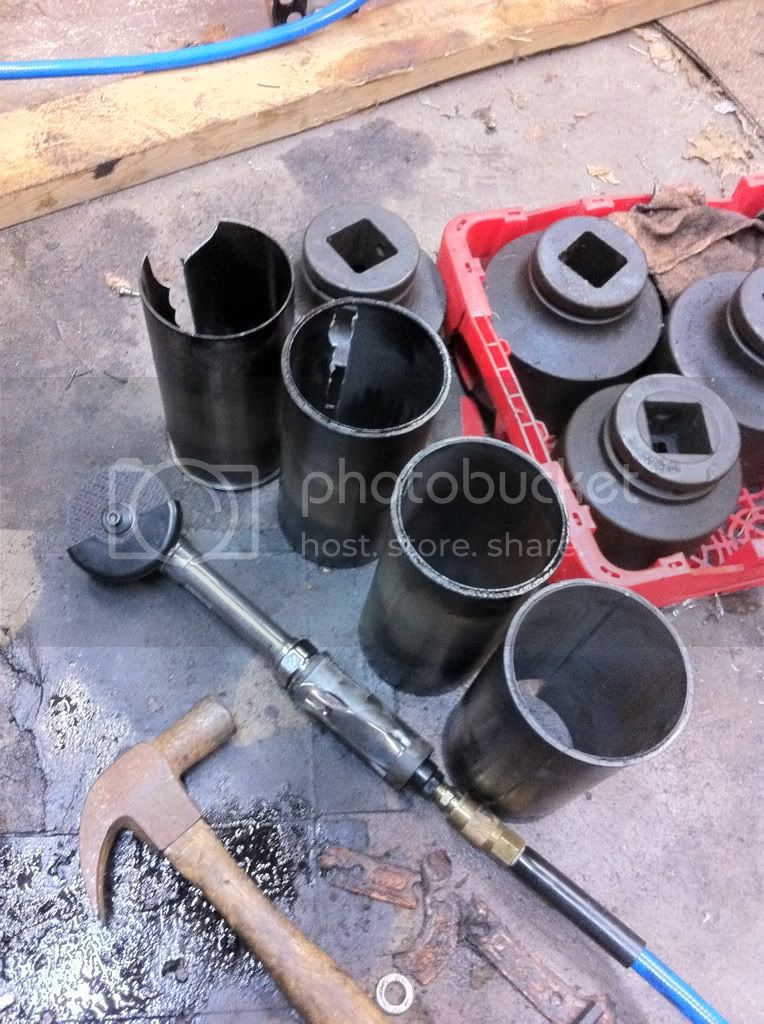

SO LETS GET THEM OUT!! I'm trying to save myself $600 in machine shop fees. I decided to try it like a wheel bearing and score and crack them. I used a rotary saw but I have a few ideas of how to do it better next time. I actually got fairly good at it by the 3rd cylinder. I was able to pop the last few out in just a couple of minutes. Hopefully with some dry ice I can get them in. Worst case I guess is I will have to take the block to work and use the press.

Trick is how to keep the ice in it while pulling in the liner , Upside down block , pulling the liners up while the cyl bottom is a 17mm aluminum seal and pull disc .. Theres my brain fart .
This is what your trying ?
Large redi-rod and pull the liners in using the oil pan deck to the top of the liner ? Got Air and & gun ? fill the liner with dry ice and water ..

Post pix of the destruction of liners ,,

Old liner OD measurement is toast marbles , since he zip cut and cracked them for removal .

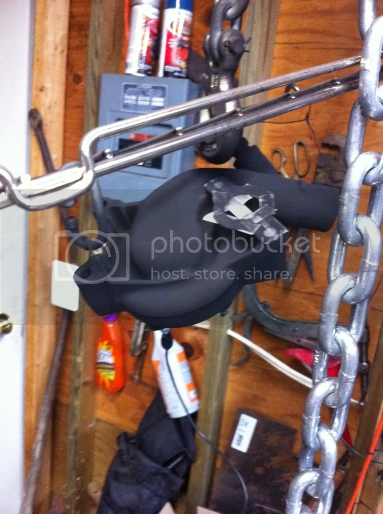

Now I can powder coat. I have been waiting 10 years for this.
I can turn this:
Into this:
Intake glass bead blasted:
Coated in "Blasted Aluminum silver"

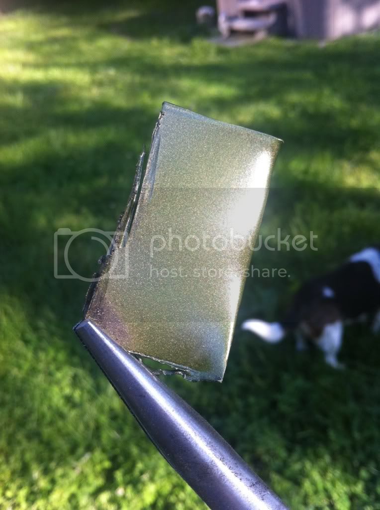

I decided I wasnt happy with my high temp painted injector lines. I decided to powder coat them eventhough they were cadmium plated from the factory. According to Eastwood you can mix their gold with translucent green and get a gold with a green shimmer that mimics the cad used on bolts and carbs. Well I ordered my powder from Powderbuythepound.com and tried it with theirs.
I did equal parts translucent candy green and gold. It was way too green.
It is the one on the left. However, in the sun it was more gold. The sample on the right is three to one gold to green.
Here is the three to one. It looks more gold as the camera would not pick up the subtle green.
I decided to just add more gold and shoot it. I couldnt get the color I wanted so I figured gold was fine. When it is in powder you can see the green in it.
