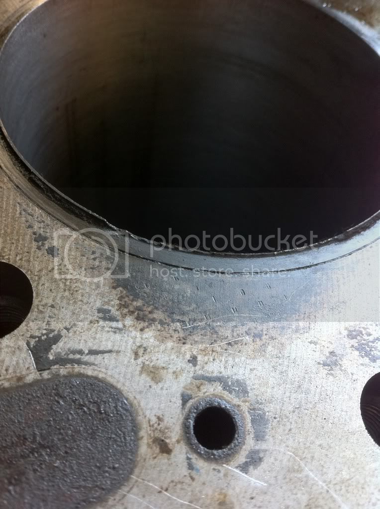

Today I was cleaning off the rest of the headgasket and found that my #1 liner is trashed. Some of the protrusion above the block by the precup is worn away. Its strange becuase its really jagged. I had thought of pulling the engine and doing liners but they are another $400, plus I called a machine shop and they want $500-600 to install them. I dont know what to do now. I have allready spent $1000 in parts. Now a full rebuild is going to be $2-3K. I'm just screwed at this point. I only drove the truck for two weeks before I diagnosed it. I dont know what to do now. Caveat emptor!!
I mean how does this happen? Did I do it with the head off and not notice it? I would think I would remember breaking off the ridge.
I took this pic with my Iphone, I think its the best one. While I was outside I noticed the marks in the precup area, I dont see that on any other cyclinder.
I'm surprised that the thickness of the "ridge" poking up from the liner, in the undestroyed regions - I thought it should be as thick as the liner itself???
Judging by the color of the steel and the carbon built up around it I doubt you cracked it off removing the head.
What does the block look like around the other precups? That area in your photos is very discolored.
The precups all have small cracks. All cylinders look the same.
I have a theory now. This cylinder is the one I had problems with. I had a problem with the ridge reamer and it cut the cyclinder a little. I honed it with a ball hone and it took the scratches out but I think I took too much metal off. I was pushing the cylinder wear limit anyway and I think the bore was a little egged. I think that part of the cylinder was worn and I blew through that ledge with the hone. If you look at the last pic you can see the ridge seems thicker on the left side of the pic and it tapers to where it cracked off.

Yes you have created a larger job. Just a WAG , overheated ,caused low comp on the cyl due to leaking gasket.
Either way , that liner protrusion is damage ,it sits on the inside of the headgasket's fire ring. It kinda looks like the precup was not held in place tight enough (pre-load) and it did the major movement damage.

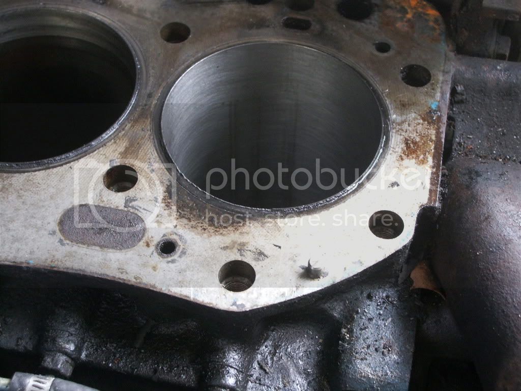

From what I can tell this was my low compression:
I swear that ridge was fine after I reamed it. I did that a few weeks ago while I was waiting for parts. I have sat in that engine bay and measured that bore so many times I swear I would have noticed that. I honed it last wednesday at night using a light and didnt notice it till today. I have this pic but I cant tell since the headgasket it still on. That flex hone is what I used. I just wanted to clean up the cylinder for the new rings to seat.

The head gasket is a major tell all.
Just looking at the now posted picture , #1 precup land area is not the same as the rest back till #4 .

I dont think that you did that with a ridge reamer. Having personally had to replace a liner on a V8 due to a bad reaming job (eccentric), I know it is true that a ridge reamer can do some damage but unless you spun the reamer at the top of the bore and didnt move it anywhere and then wedged the reamer out, I dont see how you couldve done that. Whats also interesting is how the liner itself is so much thicker than the bit that is sticking out.
Having personally seen his truck, I agree that the low compression in number 1 is the result of worn rings. The number one pistons ring lands were completely beaten open and way out of spec.
