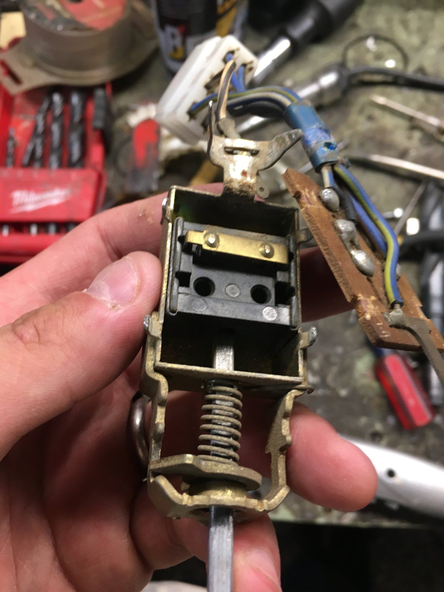

First: Figured out my wiper switch was shot. Only one speed worked, and the spray position was faulty as well. Decided to buy a new one, only to realize they are over $100 each. So, I decided to take mine apart and figure out what was going on with it. I started by cleaning all the contact points, and then sanded each contact with 2000 grit sand paper. I then dabbed each contact with dielectric grease. I'm pleased to say it works perfectly now.

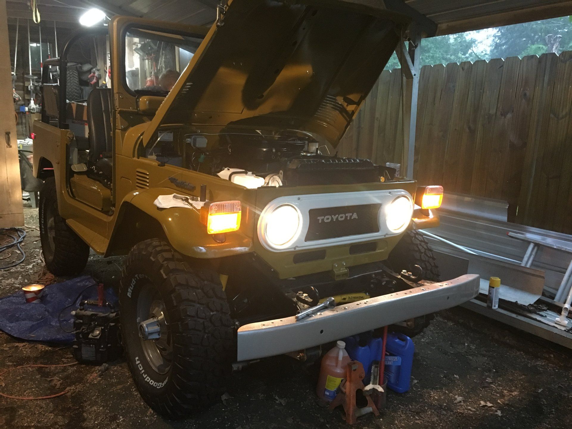

Found out my flasher relay was bad. I ordered a new one from the Toyota dealership. This is the updated part number. I mounted it right above the fuse panel in the driver's side foot well.
Hooked it up, and voila--now I have functioning turn signals.
Thus ends my electronic saga. All switches, relays, lights, etc. function. Woohoo.
Tomorrow, I try starting it up.
