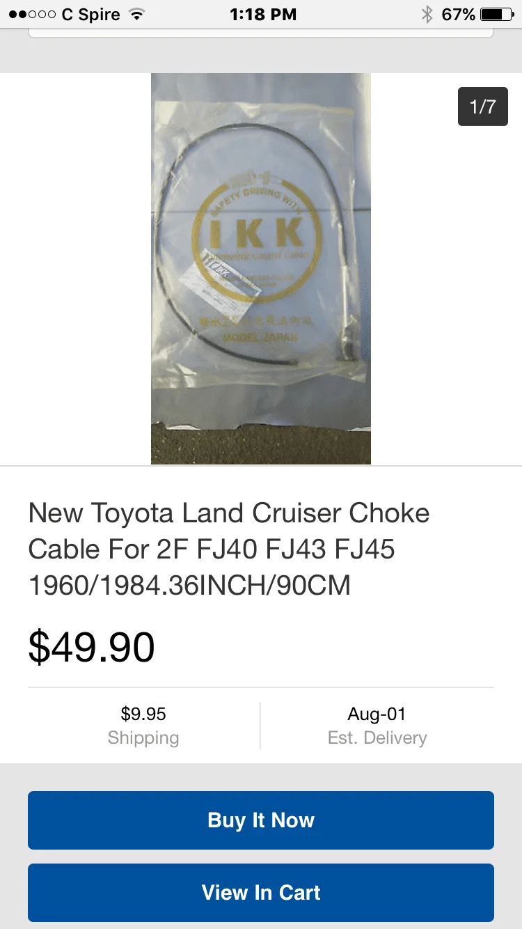

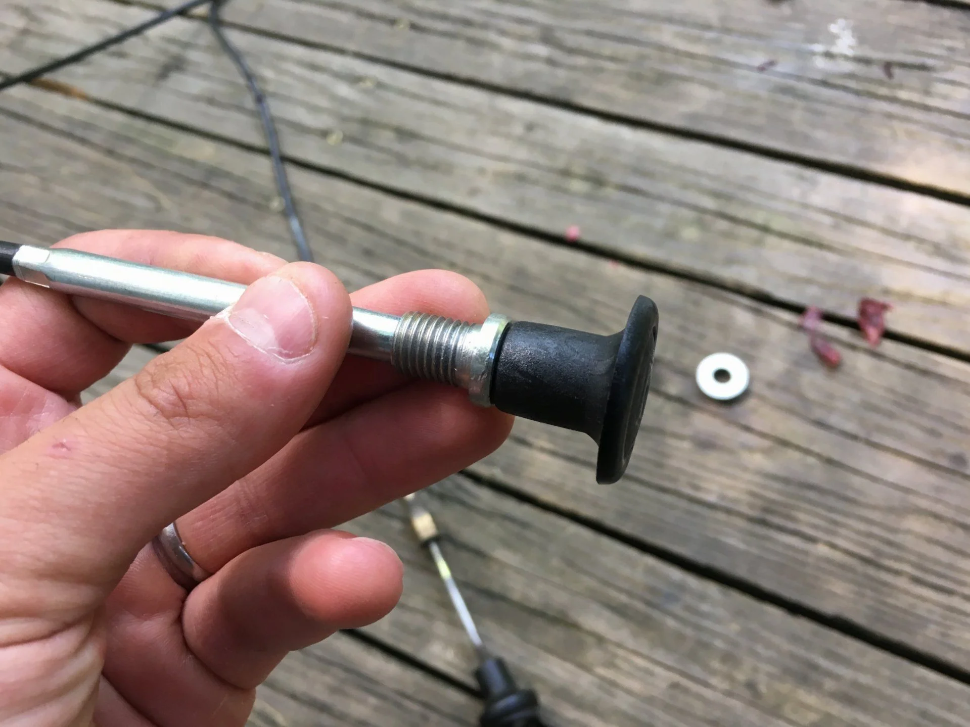

I started by purchasing this cable on eBay. Item # 142173196682
Of course, it had a chincy pull head on it that looks the mould was crafted by a 6 year old.

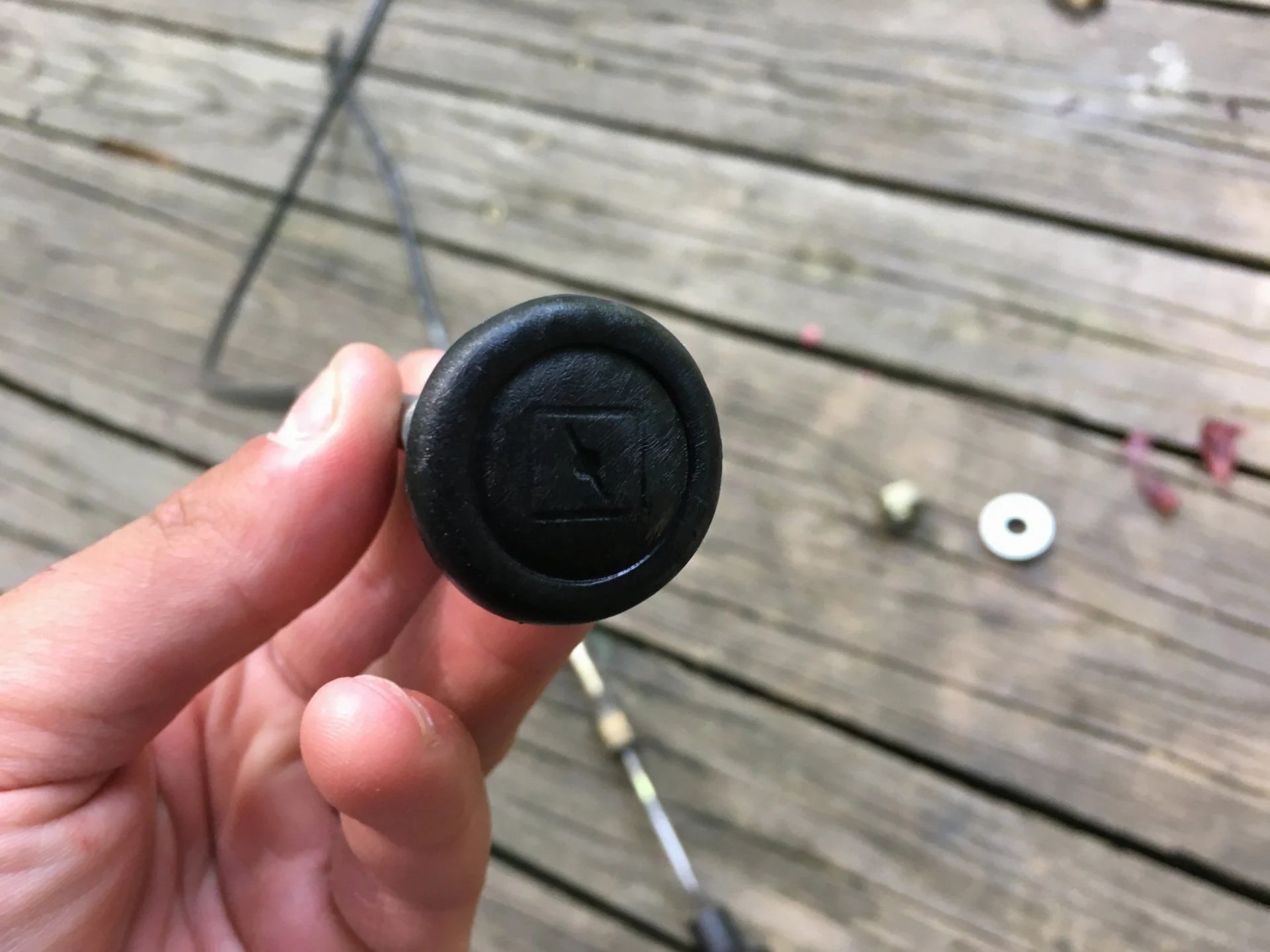

And it certainly did not look like my original pull knob

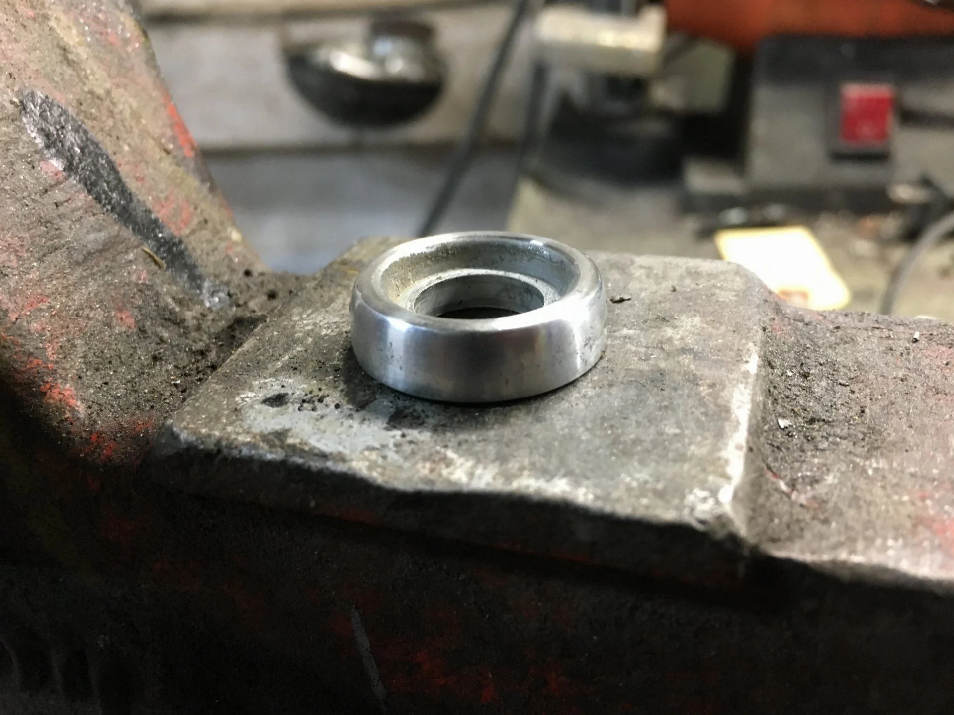

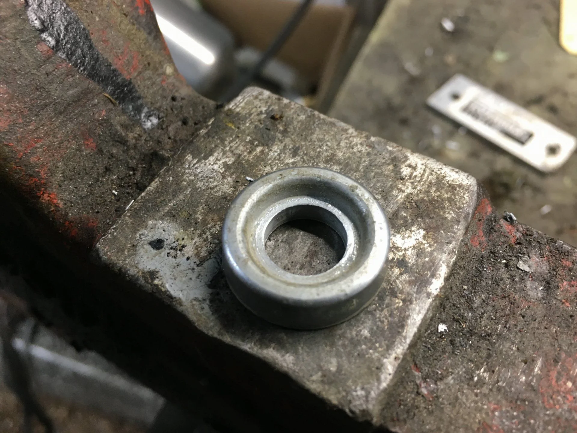

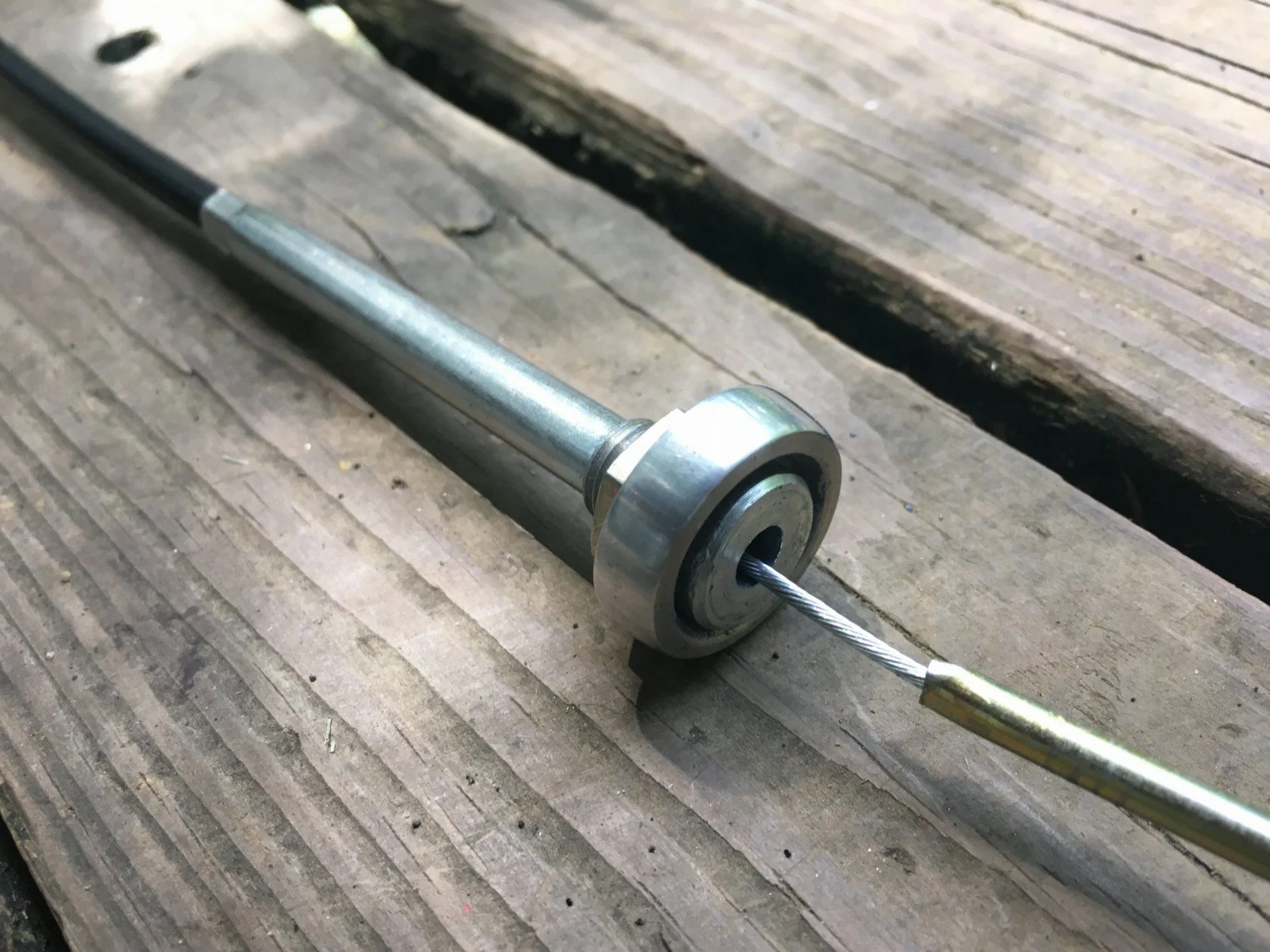

First, start by removing your escussion/beauty ring from your old choke cable, as the new choke cable did not come with one. Mine was in pretty bad shape; it was pitted, scratched, and corroded pretty nicely.

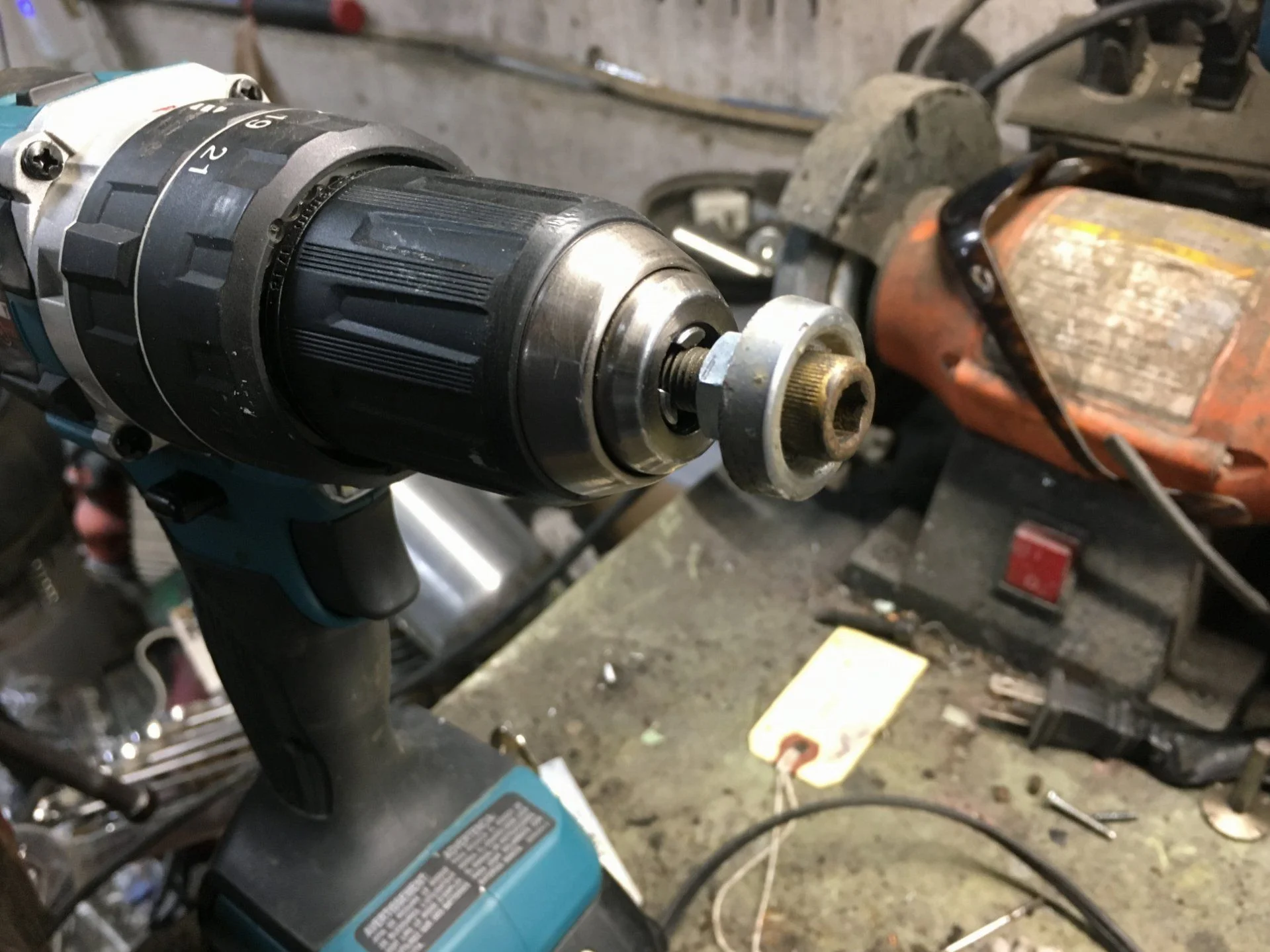

Before I installed it, I decided to shine it up with my redneck lathe. I used 320 grit sand paper, and worked my way up to 2000 wet.

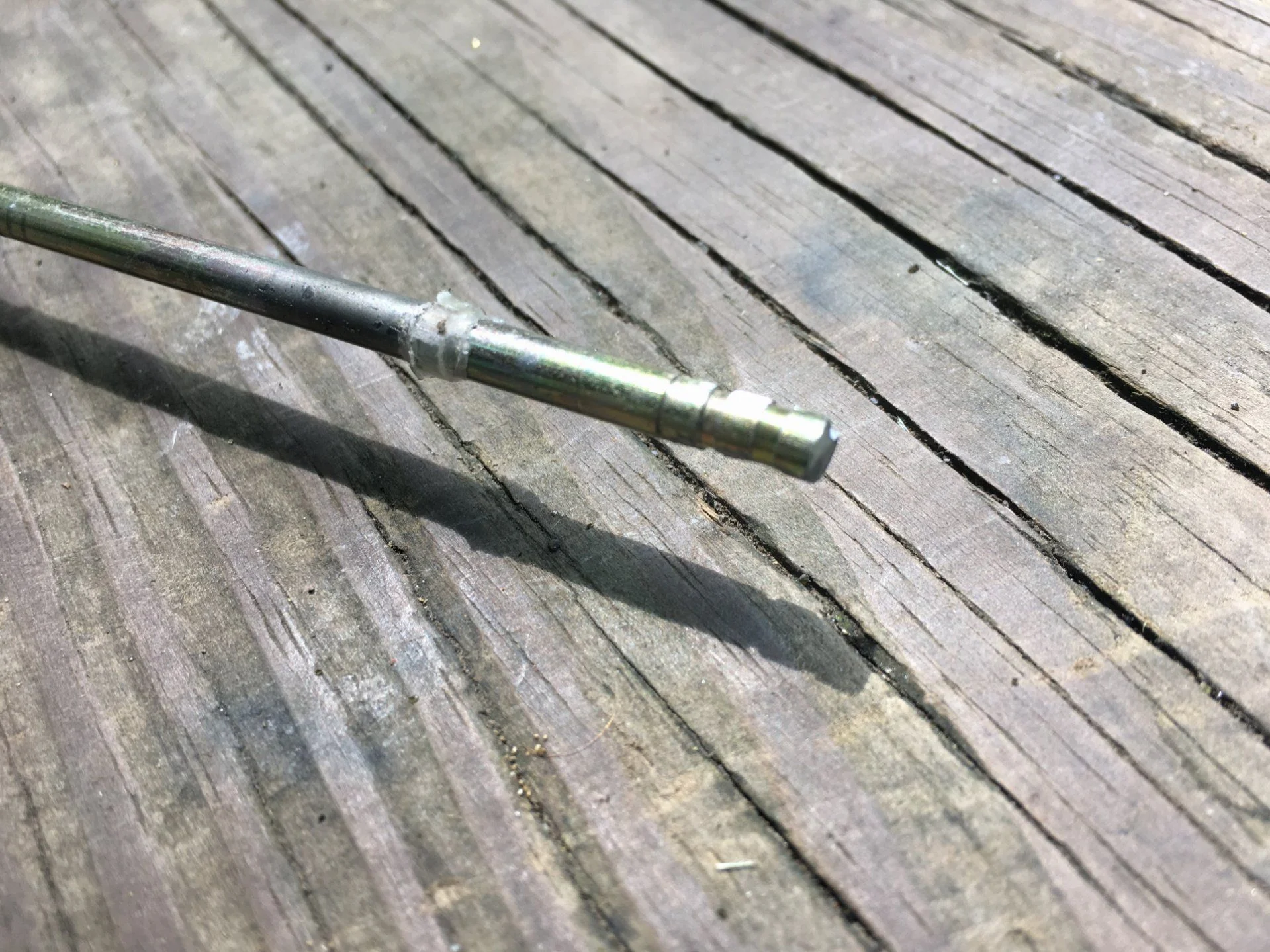

Forgot to mention: before you can install your beauty ring to the new choke cable, you have to remove the nut, and to remove the nut, you have to grind off just a tab bit of material off of the cable fitting on the end.
Next, with the help of my angle grinder, I ground off most of the head of the new choke cable until I made contact with the metal rod.
Then with some more careful cutting I removed the rest of the new plastic cable pull.

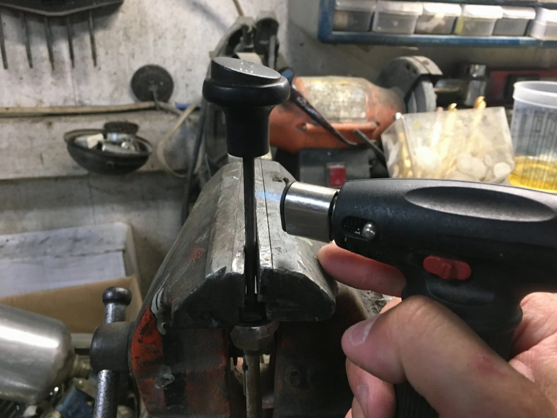

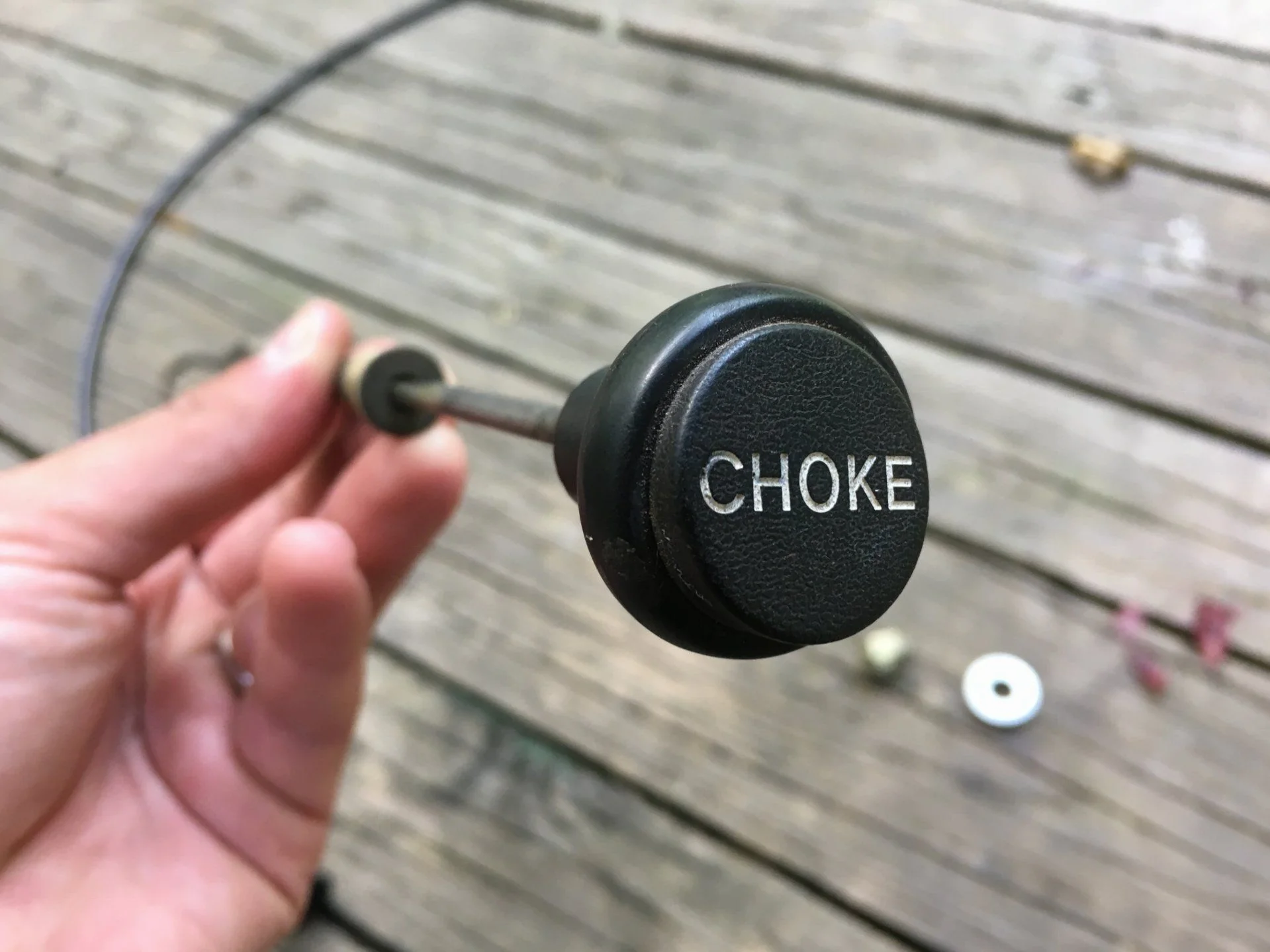

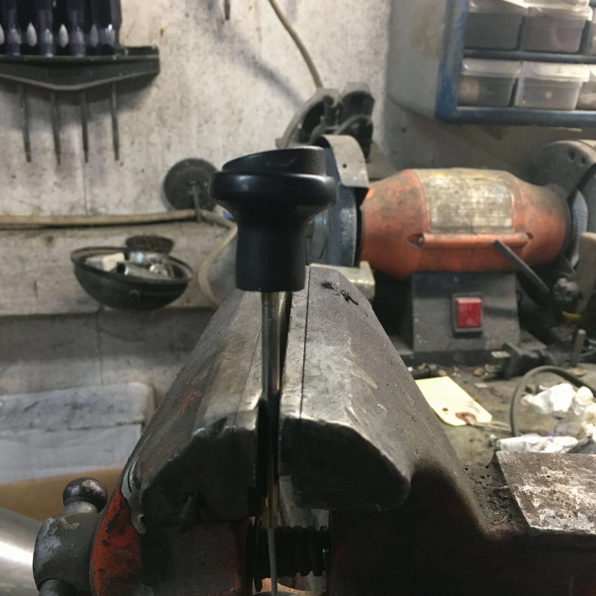

Next, I needed to remove the original pull knob without damaging it. I accomplished this by heating the rod with a torch until the adhesive/plastic got soft enough to remove the knob. Honestly, it took a lot more heat and time than I thought it would. Eventually I was able to pull it off without harming the knob whatsoever.

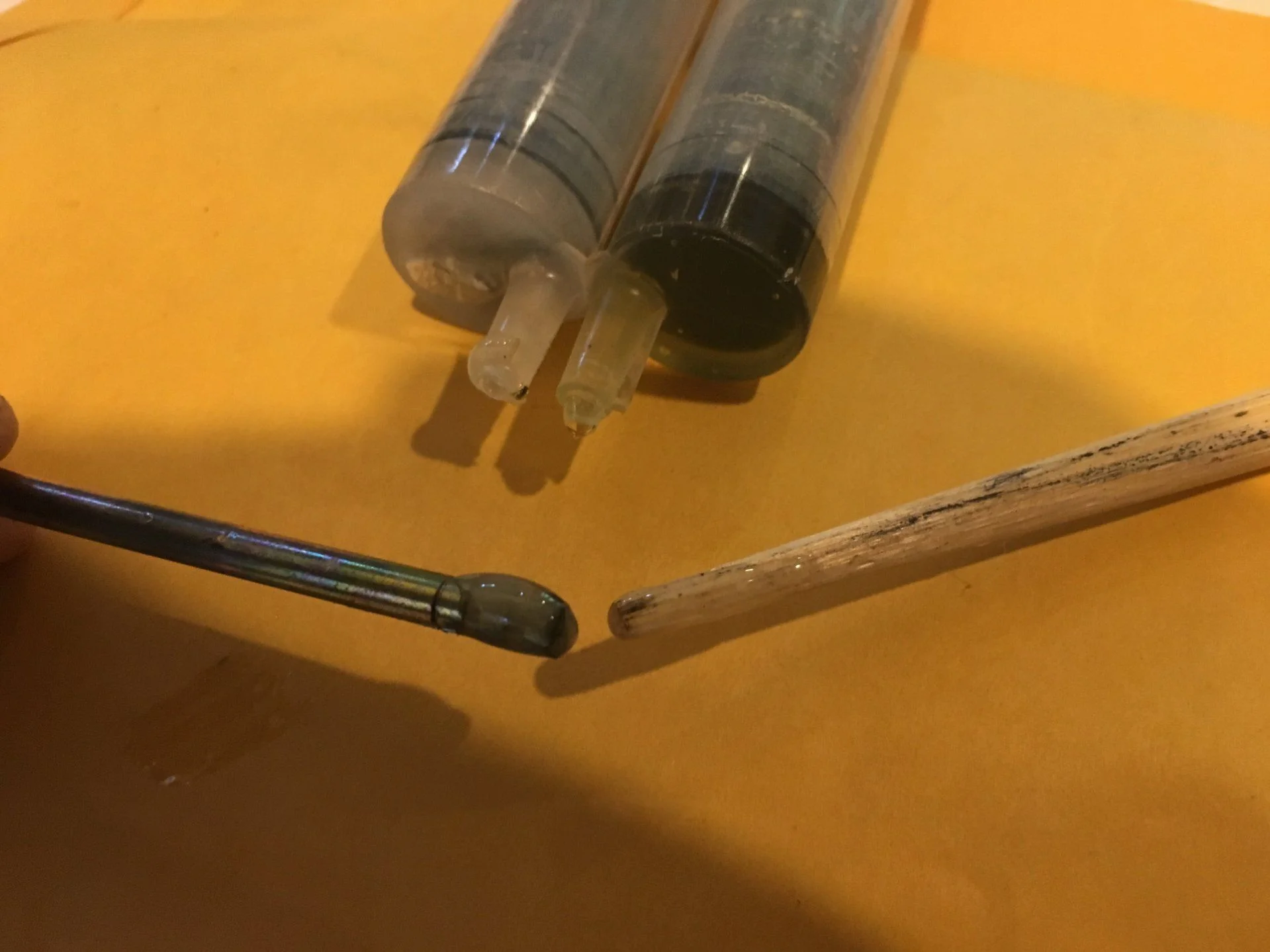

Then I mixed up my favorite epoxy and placed it on the rod of the new choke cable.
Then I simply pushed the knob down onto the epoxy coated rod until it was fully seated.

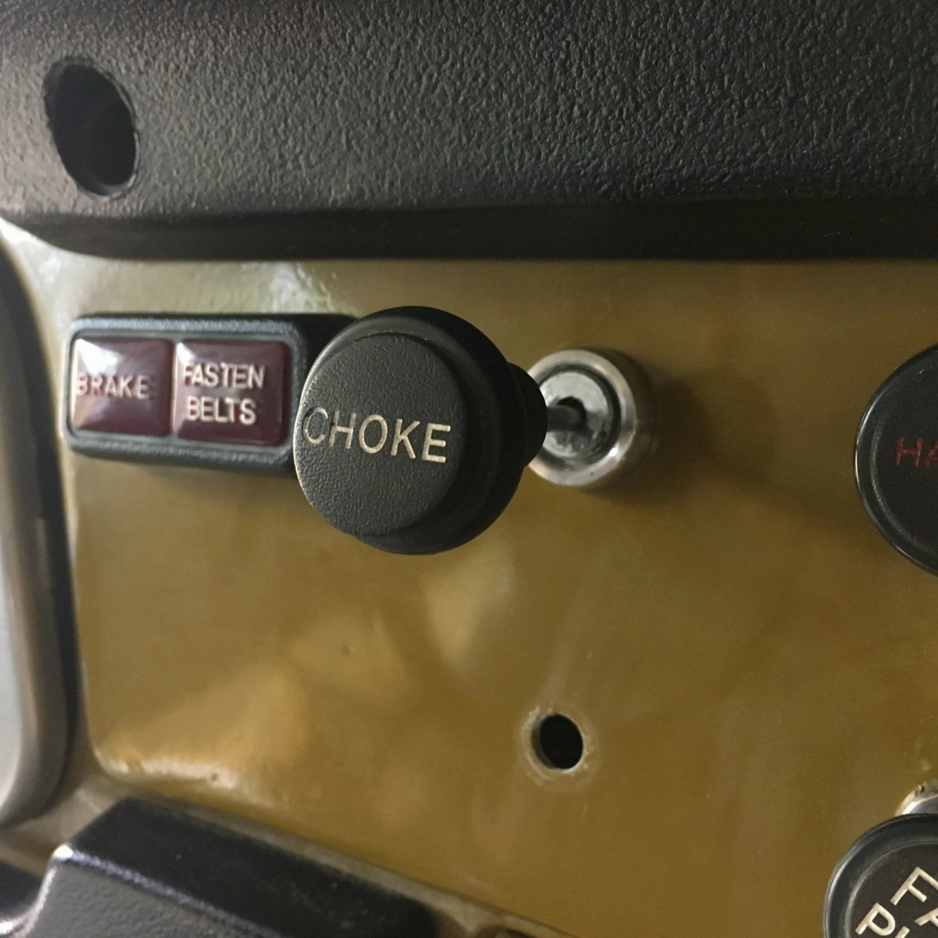

Finally I installed it into my dash.
Note: you will either have to modify the dash by opening the hole up a bit more (I would not reccomend this method), or you can use a file to grind a flat area down on the threads of the new choke cable, to allow it to fit inside of the dash (this is the method I chose to do).

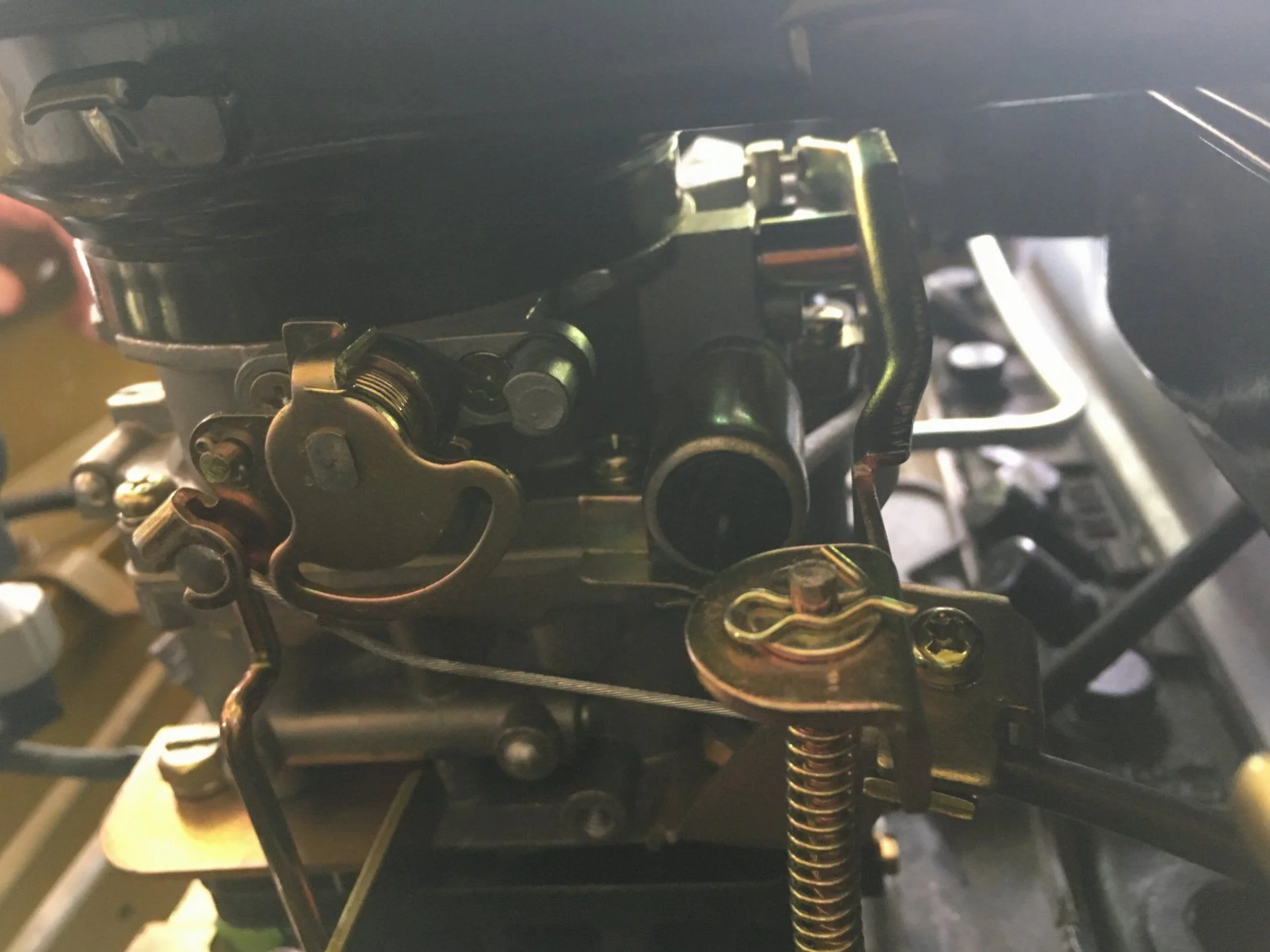

Don't forget to connect the other end to the carburetor!

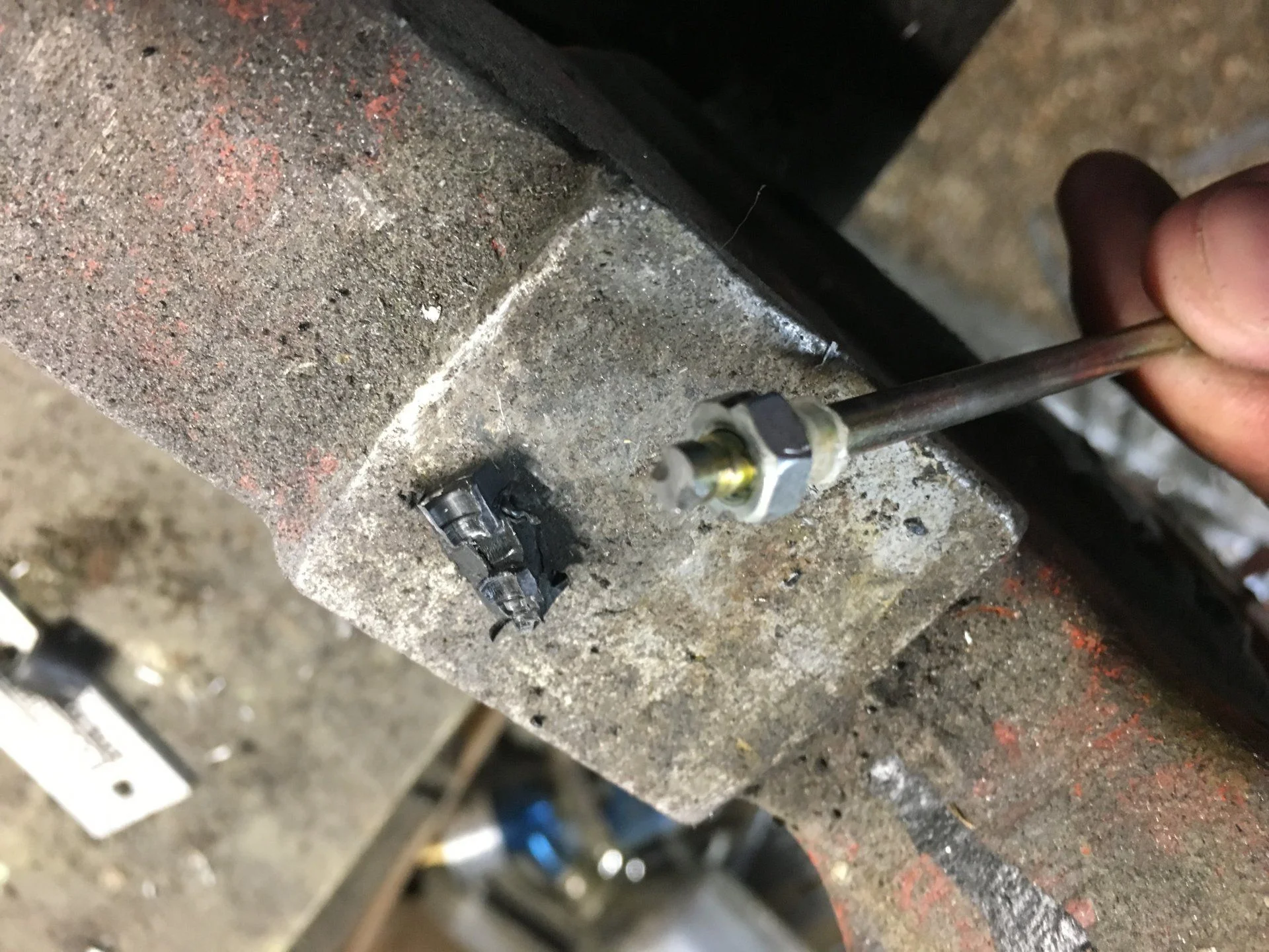

I'm just going to piggy back on this one since it is senseless to start another thread. I like the option above though. Another option is to use the stock pull shaft and the housing and just replace the sheath and cable.
You can buy a crimper or just epoxy the new sheath on.
To remove the old cable out of the stock shaft you heat it up with a torch. It's soldered in. Then I use a dremel and clean the end out. Cut the cable and sheath to proper lengths solder cable into shaft then epoxy new sheath on.
