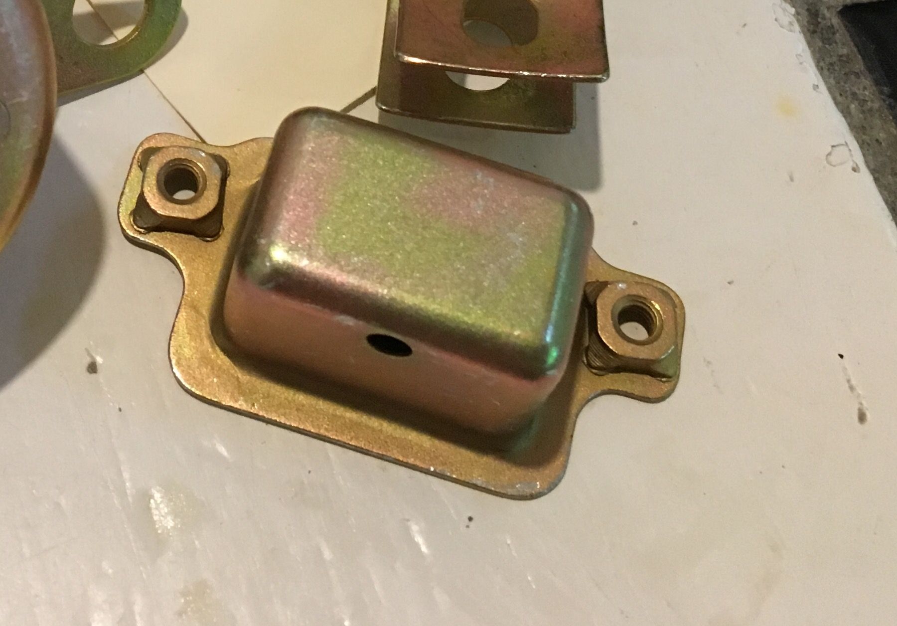

Can y'all help me. I can't remember where this part goes. I could have sworn it went inside of the air cleaner assembly, but I can't for the life of me find any holes to line up with those captured nuts.
img_0288-jpg.1494142
I believe inside cap of air cleaner housing, try and get you a pic of mine later
Thanks @tls3601 !
