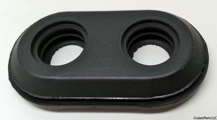

Assuming you mean this grommet:
90480-01167
Still available! This is what people use for the fuel grommet in the floor (either modify the grommet or cut the hole to the same size as the firewall grommet).
No. The small grommet where the heater pull cable goes through the firewall.

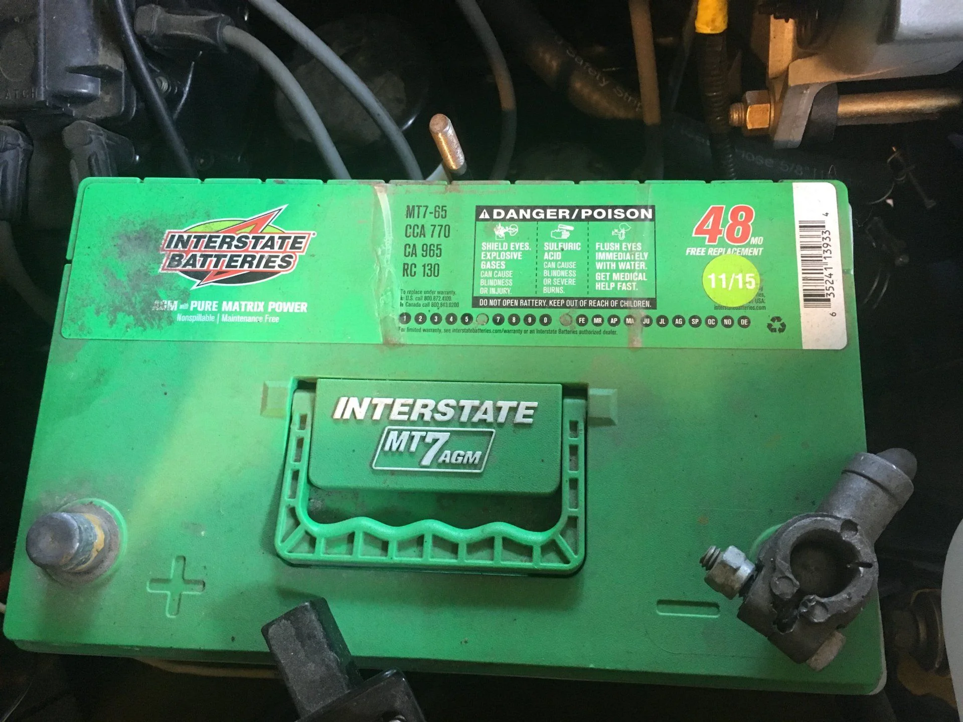

What group size battery is in there now?
No idea. I'm not close to it to find out either; I'll let you know when I can get to it.
The two correct batteries would be group 24 or group 27. Not the "F" suffix however.

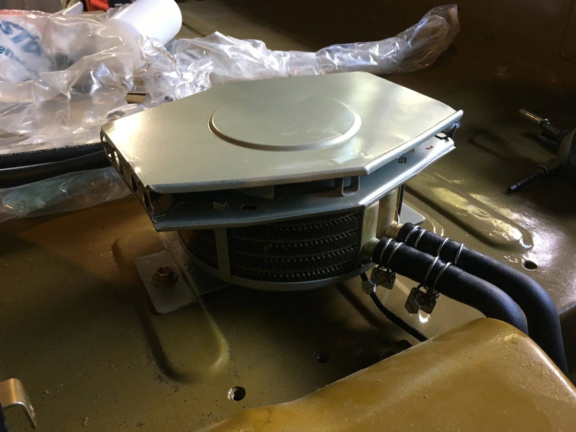

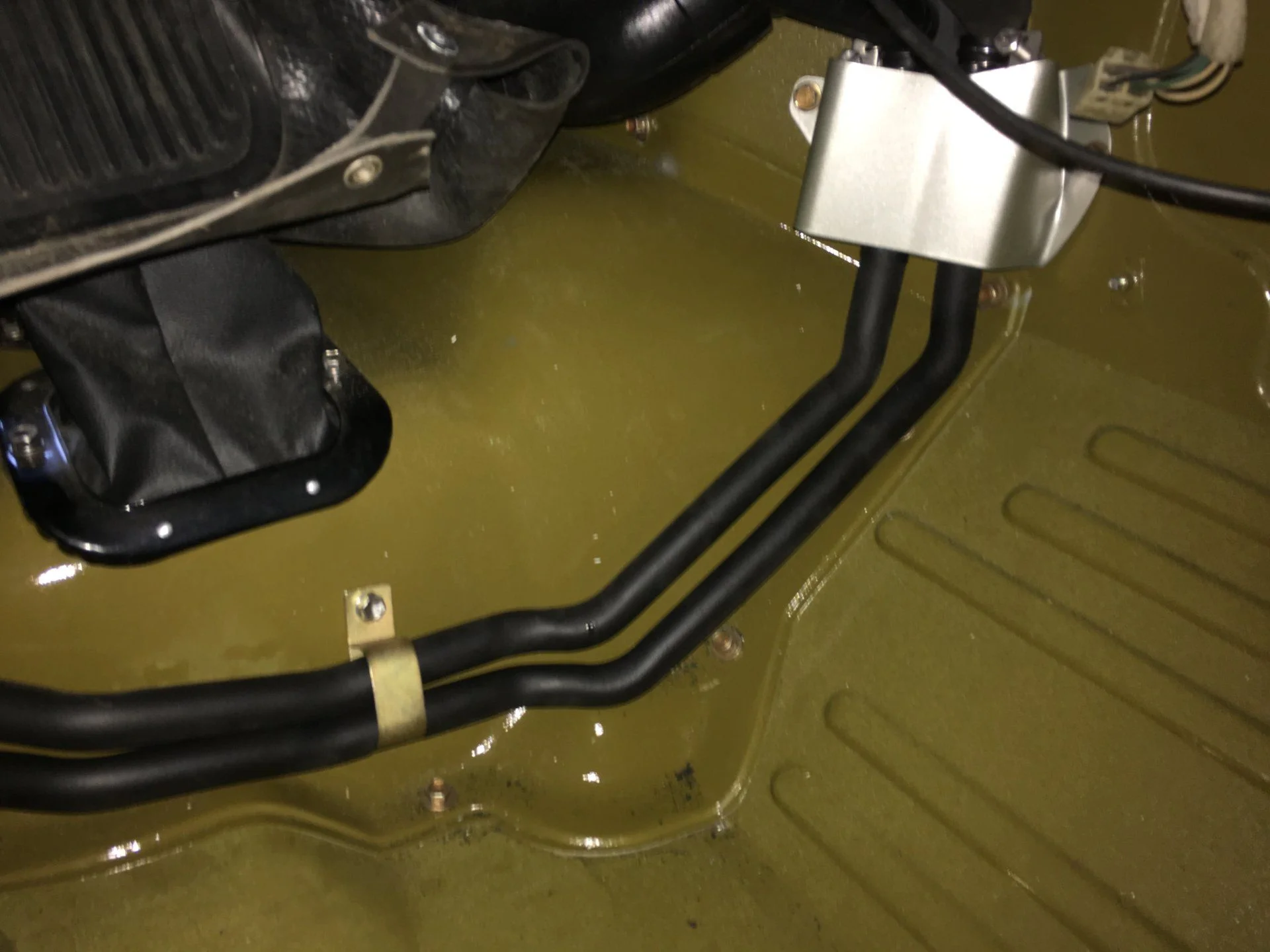

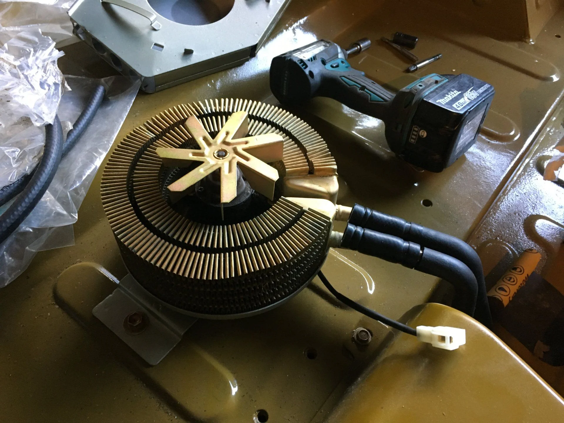

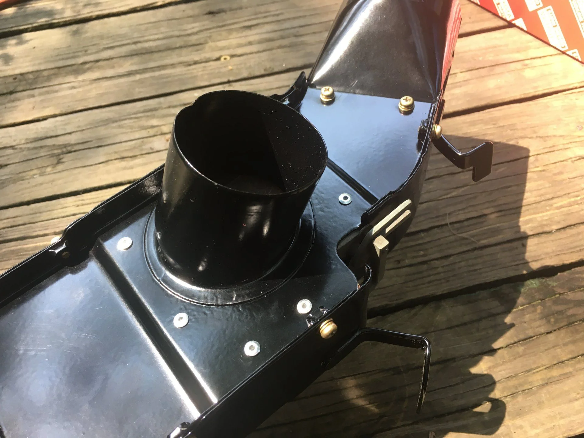

Rear heater assembly and installation.
img_0387-jpg.1498422
img_0389-jpg.1498423
img_0390-jpg.1498424
@cruiserdan , to answer your earlier question, this is the battery that I currently have. Very nice, but far too large for the OE tray. Any reccomendations?

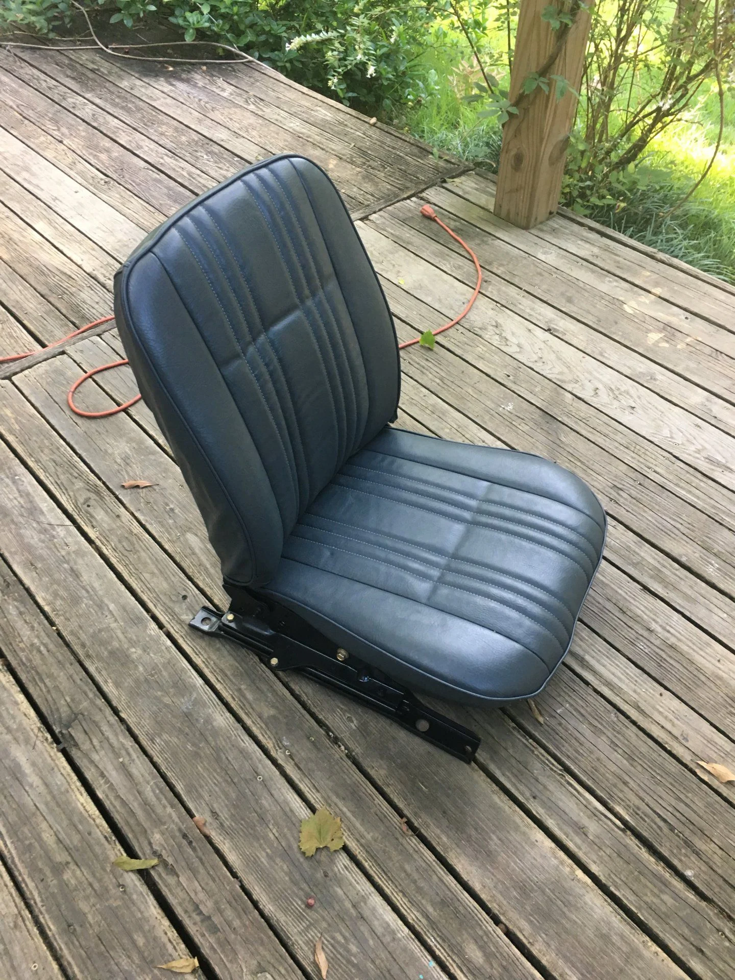

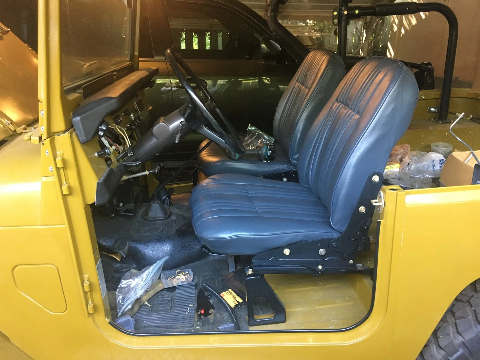

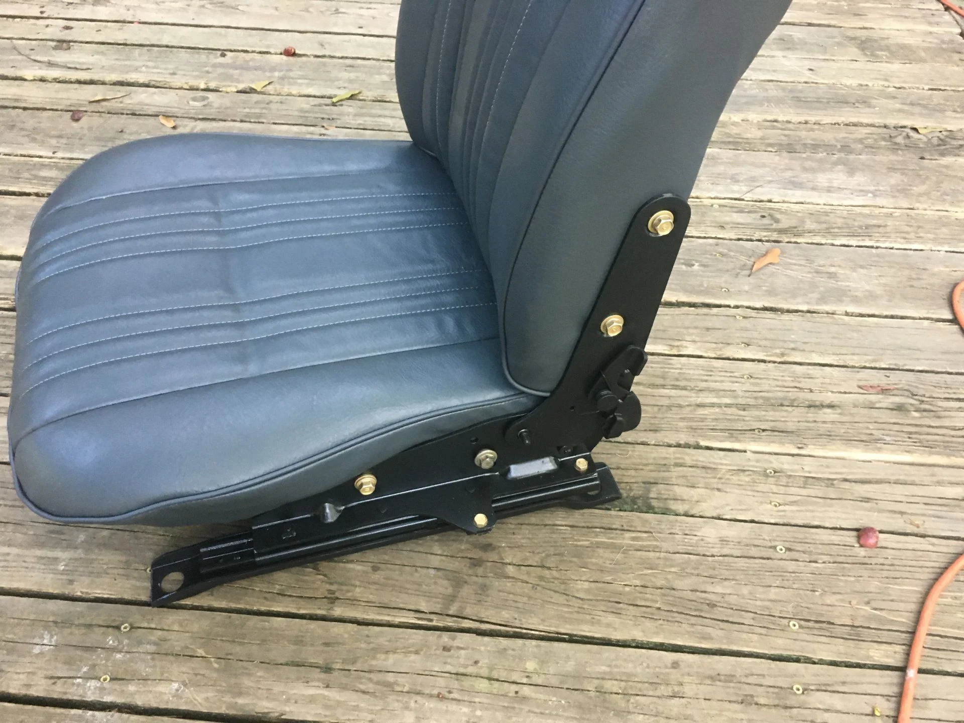

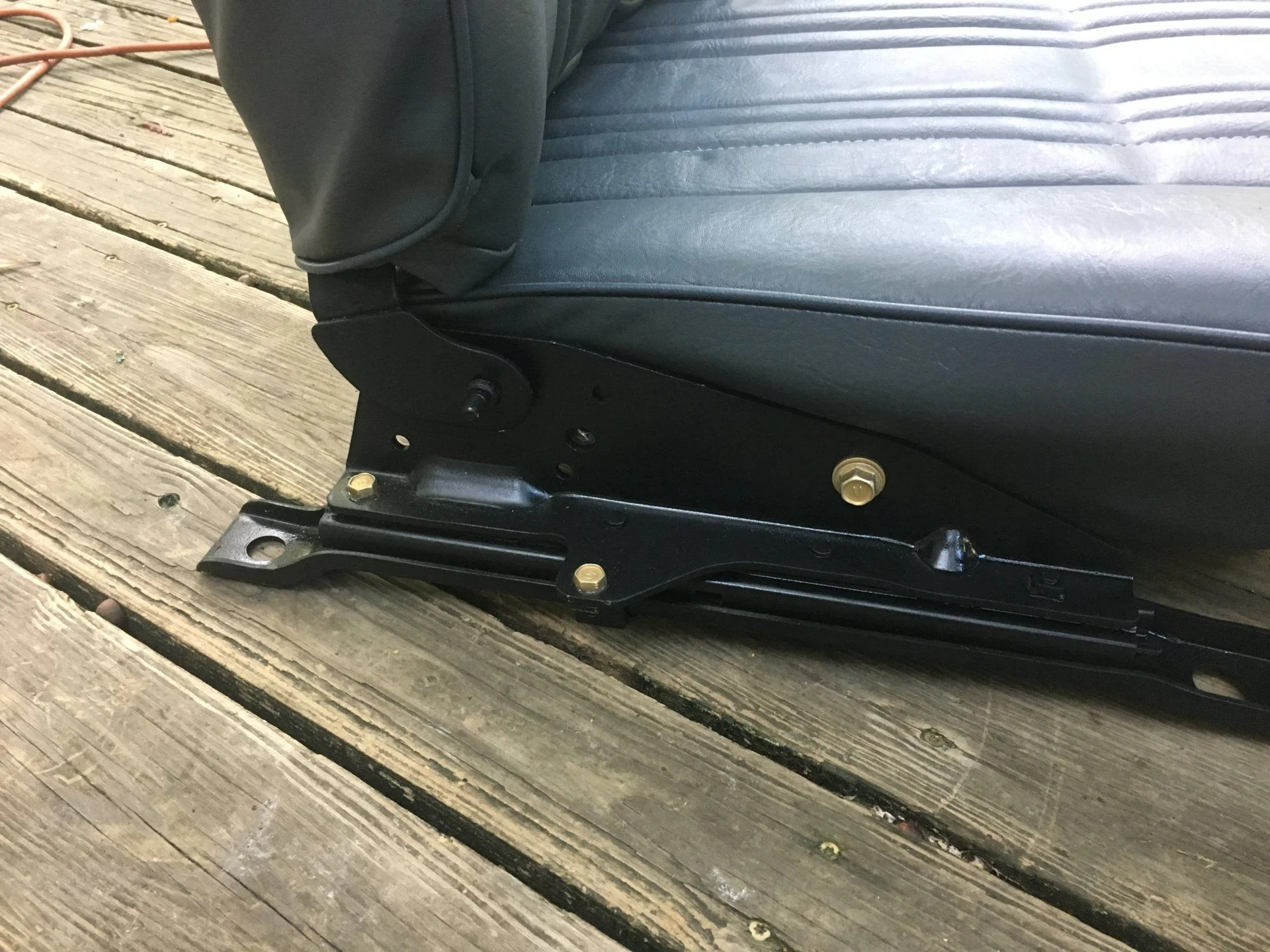

Seats are done; well, just about...still have a few pieces of hardware to install.
img_0422-jpg.1500441
img_0423-jpg.1500442
img_0424-jpg.1500443
img_0425-jpg.1500444
I have seats!!

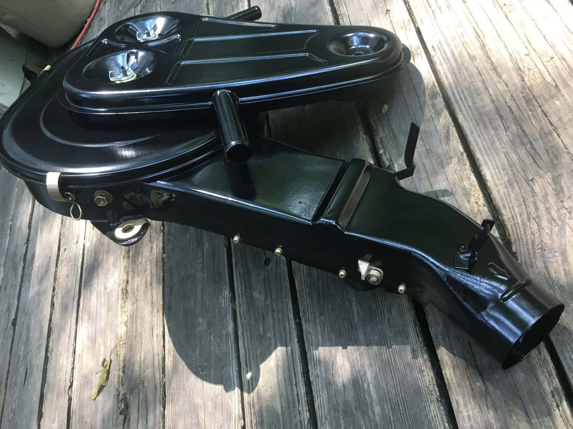

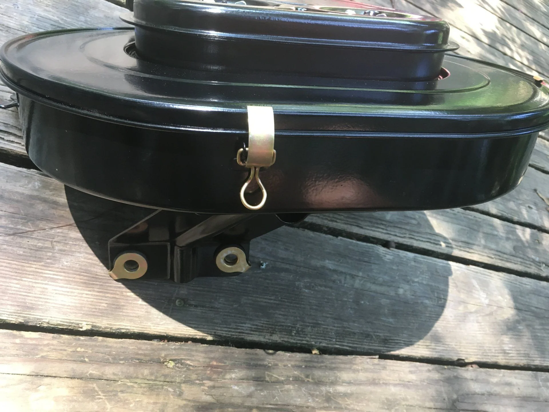

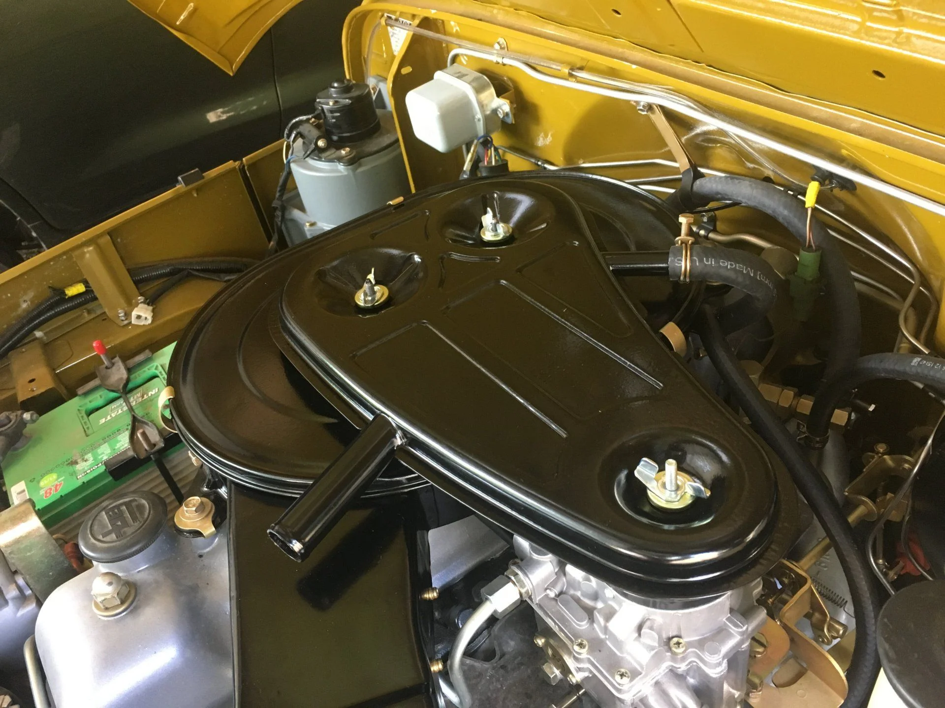

Finally got my air cleaner (the correct one) back from powdercoating and assembled.
img_0430-jpg.1500633
img_0431-jpg.1500634
img_0432-jpg.1500635
img_0433-jpg.1500636
img_0434-jpg.1500637

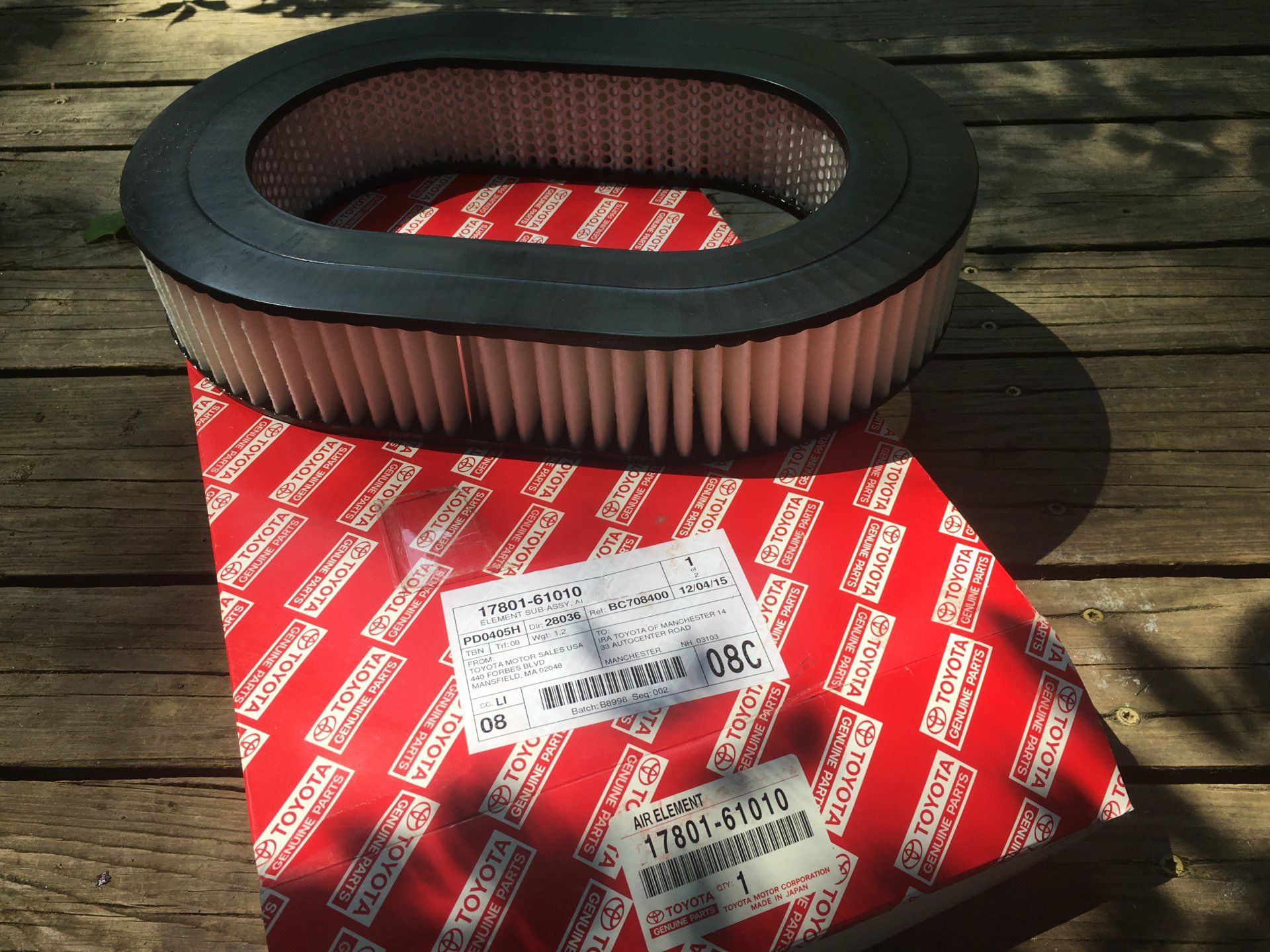

New filter.
img_0429-jpg.1500639

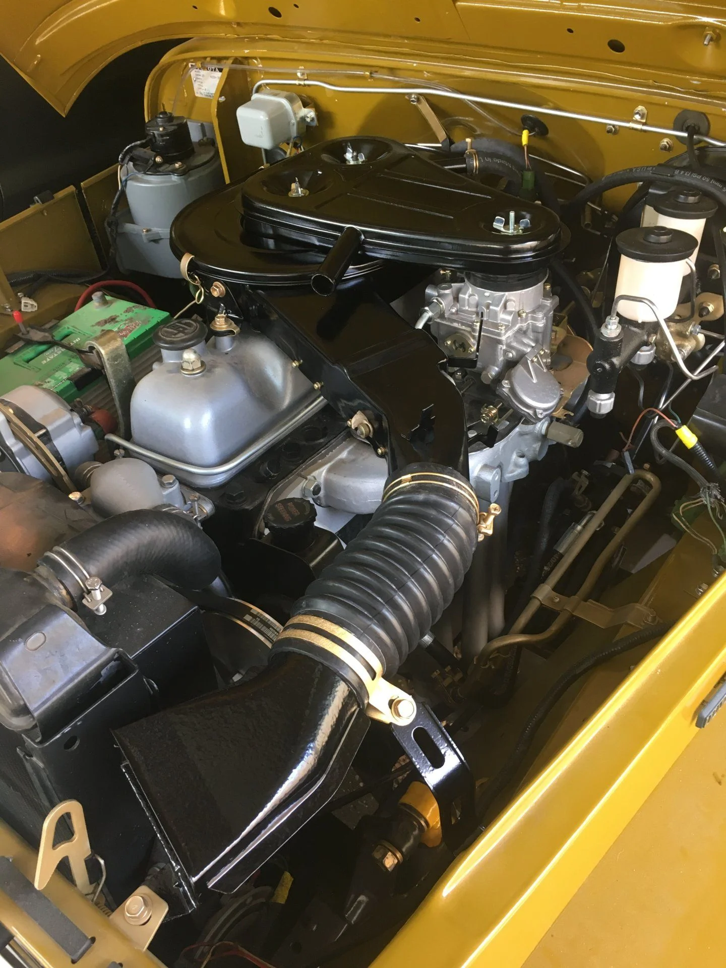

She's on. Everything PC'd and cad plated. Also added the hard to find rubber intake hose from CityRacer.

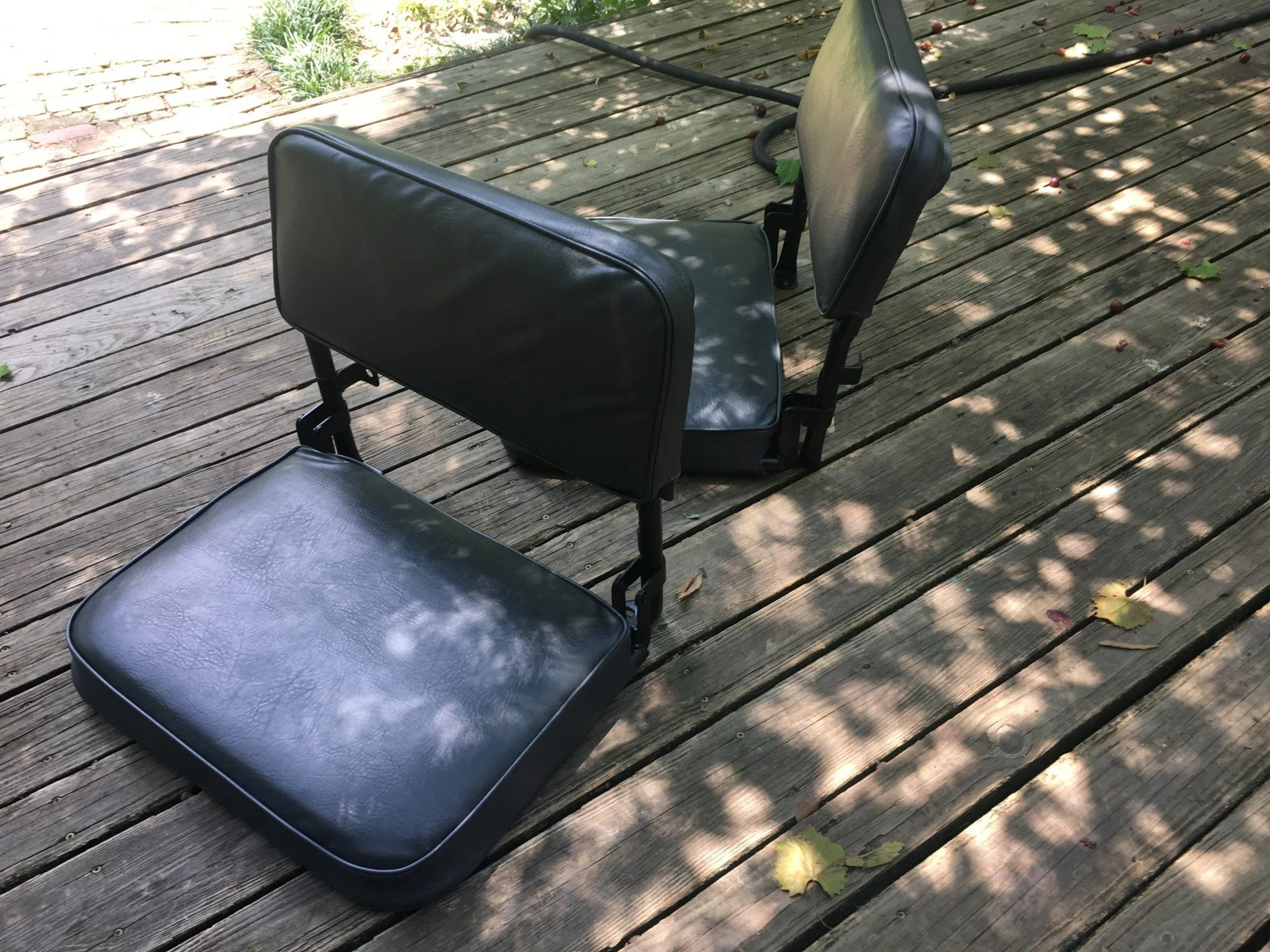

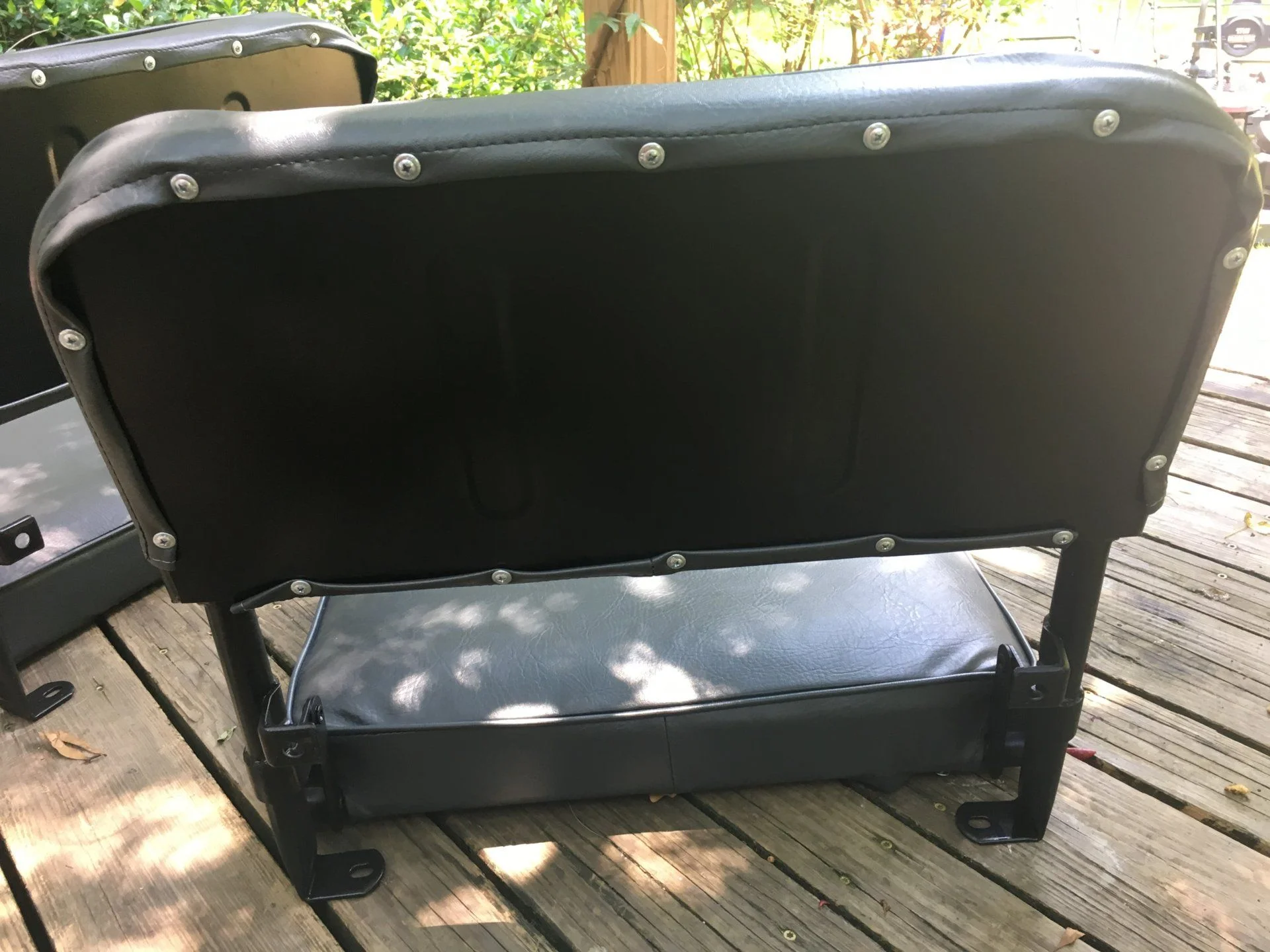

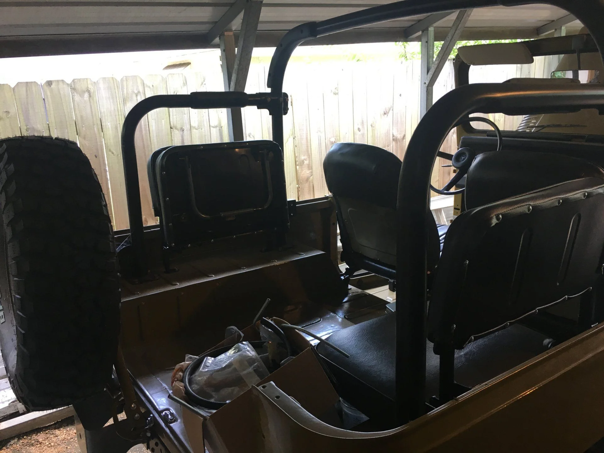

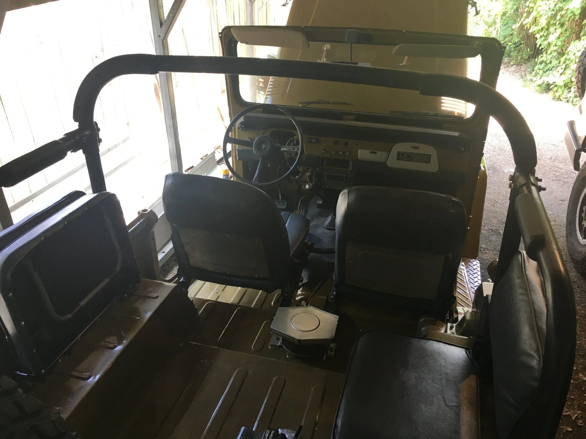

Jumpseats! They too are still missing some hardware, but for now, here they are.
img_0438-jpg.1500662
img_0439-jpg.1500664
img_0440-jpg.1500665
img_0441-jpg.1500666
img_0442-jpg.1500668

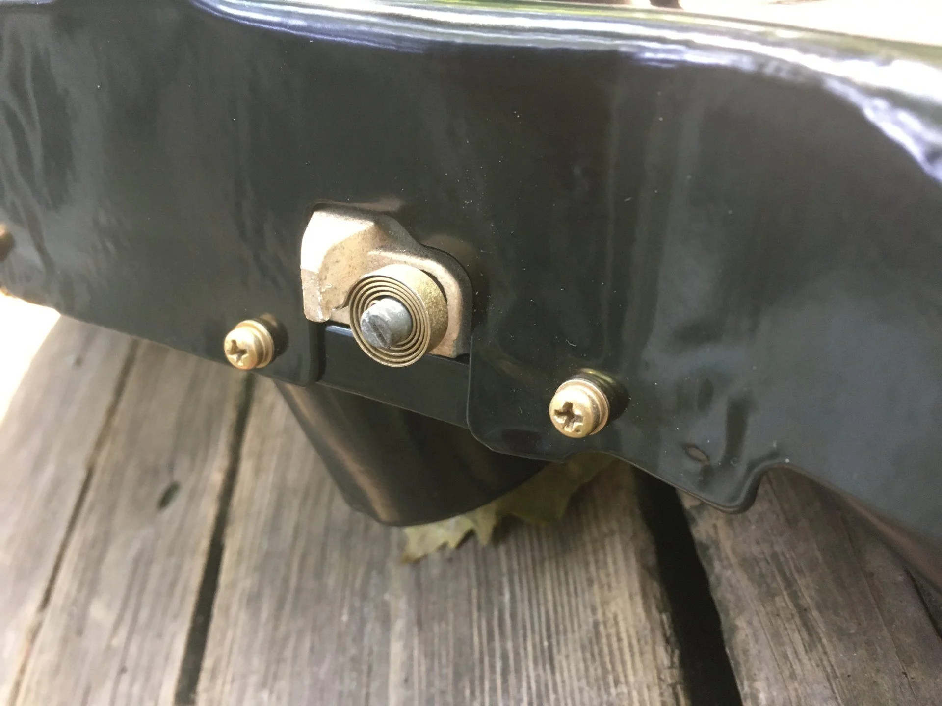

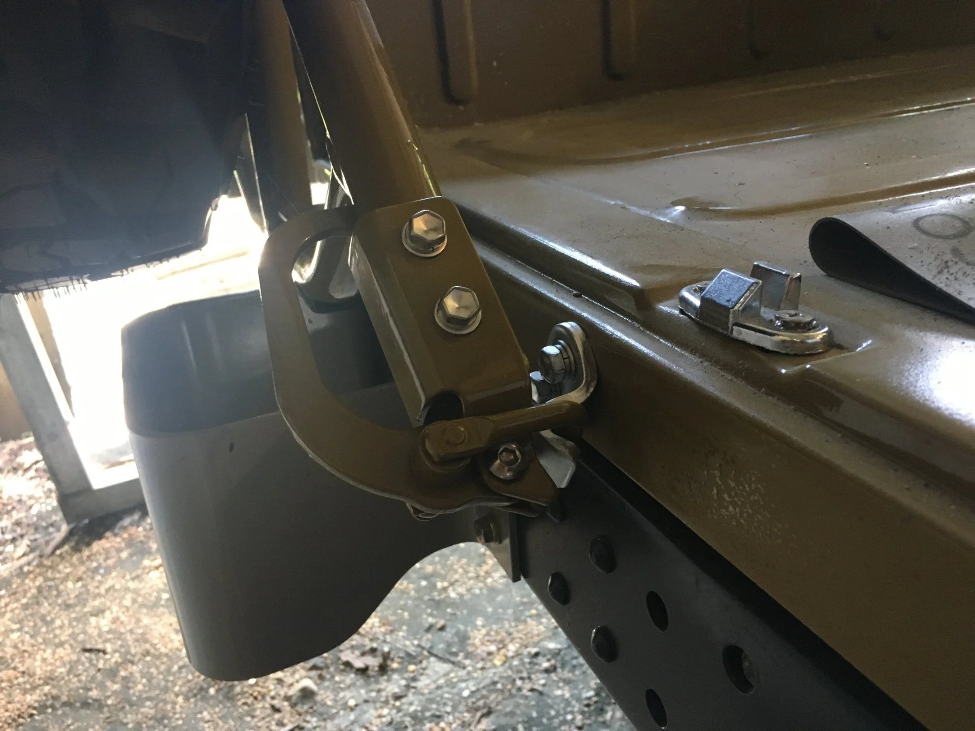

Finished tire carrier install.
img_0443-jpg.1500669

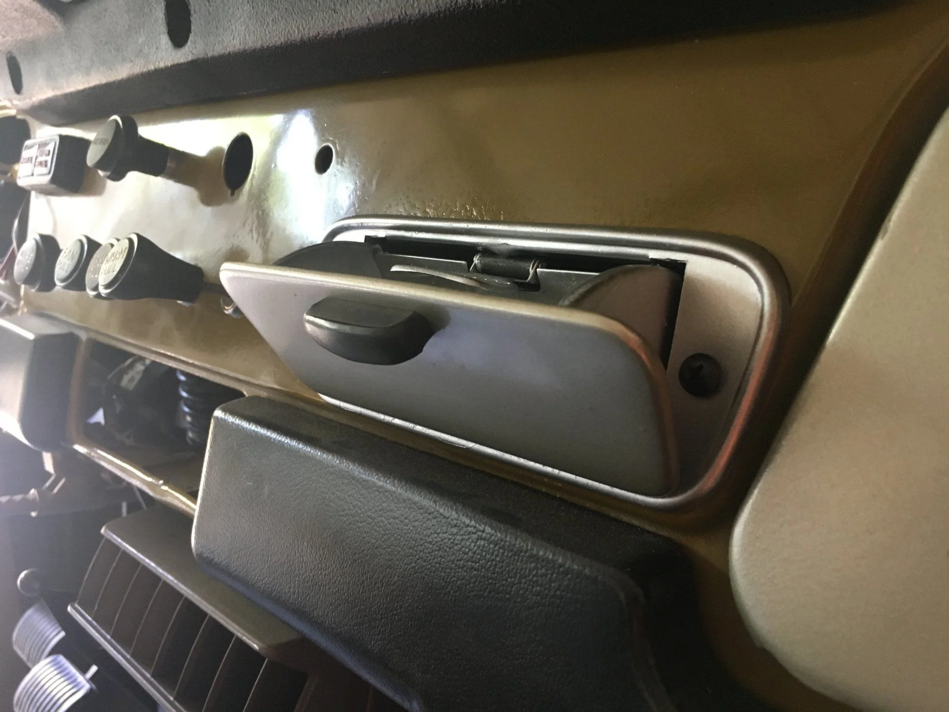

Also installed ashtray. (Note: those are not bubbles in the paint, just a spot that has not been wetsanded yet.)
img_0444-jpg.1500670

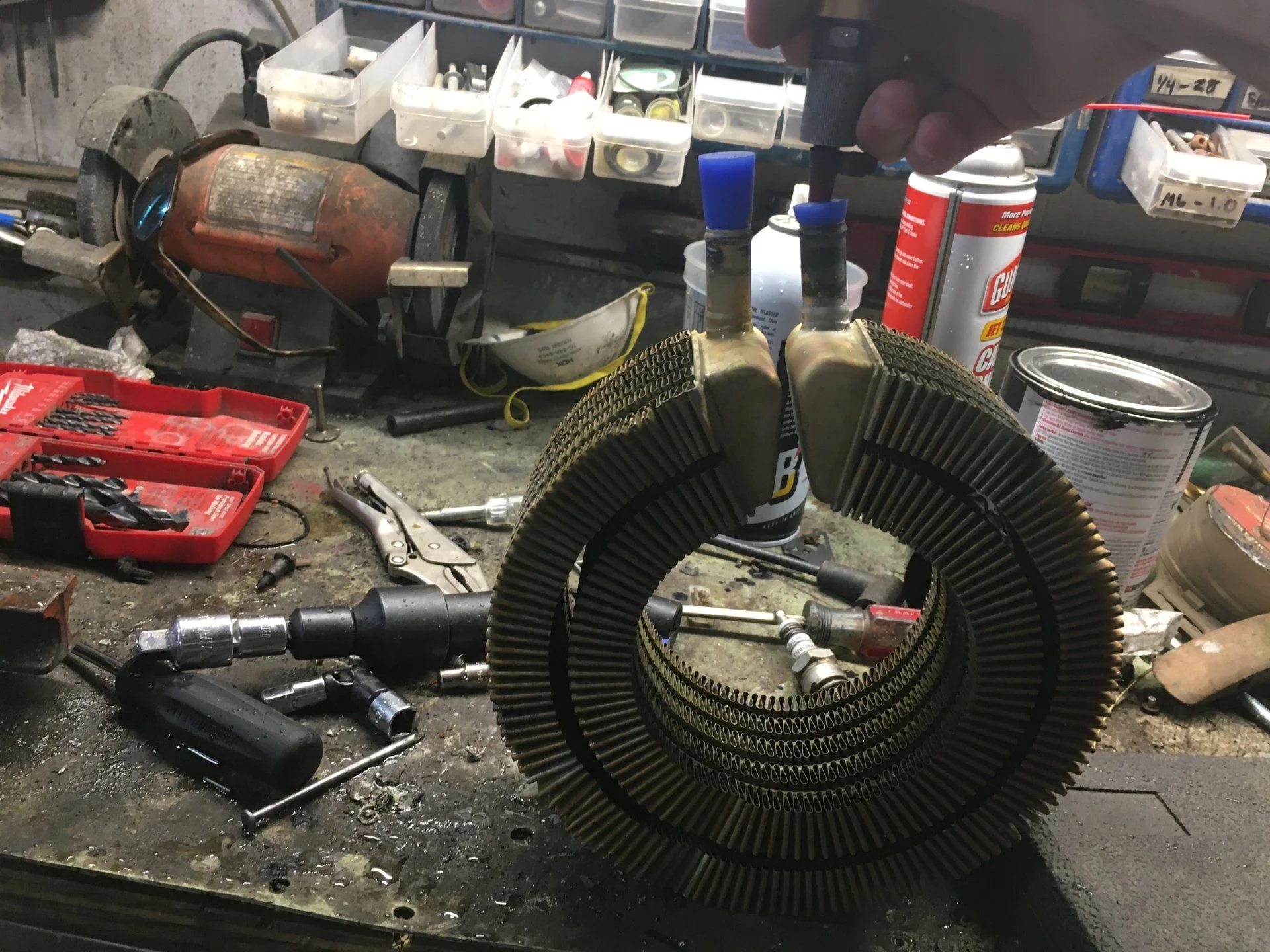

Bad news: added coolant this morning, and found that my rear heater core has a leak. It did not have a leak before, so the only thing I can figure is that sandblasting it may have eaten through a weakened area. Bummer.
Now I need to find a new core. Anyone have a core they would like to sell?
That was an expensive battery. Absorbed Glass Mat at around 275 bucks new.
Interstate MT7 65
Width ~7 3/16
Length ~11 13/16
height ~7 3/8
The factory battery was a group 27
Width ~6 13/16
Length ~12
Height ~9 (to the top of the posts)
Your tray (if it is correct) should be just over 12 inches long and a touch under 7 inches wide.
This suggests that your current battery is a bit too wide for the tray and tie bar, OK for length and perhaps a bit short for the tie bar to clamp it down properly.
In view of your theme I suggest using a Toyota Truestart OEM replacement battery. The correct part number is 00544-27060-675. Most dealers will not have one on the shelf as group 27s are not used in any current applications, unlike the group 27F which is otherwise identical but with reversed posts. However Interstate is the vendor and a dealer can get one in a couple days at most. The current published list price is $123.52, you may be able to do better than that if you have a good relationship with your local dealer.
Shipping a wet lead-acid battery from a place with "the best prices" is not practical due the the hazardous nature of the beast.
@MScruiser how good is your alignment where air cleaner housing meets top of carb? Mine is a 10/78 manu date and there is a tilt instead of it seating nice and flat all the way around. I have heard this is common with '78's especially those that were late in the year. Mark @65swb45 has seen this as well, and if so have a good fix without modifying the air cleaner housing? Super nice build btw
It appears to be perfectly aligned. That being said, I am using an aftermarket carb.
There are two brackets on the housing that are adjustable. I kept mine loose until the housing was mounted to the top of the carb, then torqued them down.
Did a leakdown test, and found 2 hairline cracks. Looks like it was damaged in the return trip from the platers. Luckily, I remembered I had some silver solder and some liquid flux. I tried repairing them, and it looks like it worked. Woohoo!
This is great! Thanks
@cruiserdan , are you saying that Interstate sells the Truestart? Am I reading that right?
Interstate makes Toyota's replacement batteries. Toyota-branded Interstates look different and have different ratings than regular Interstate batteries. They are only available through Toyota dealers.
