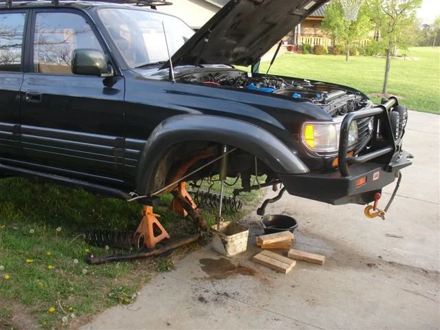

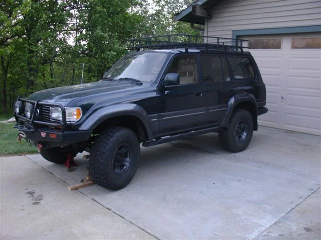

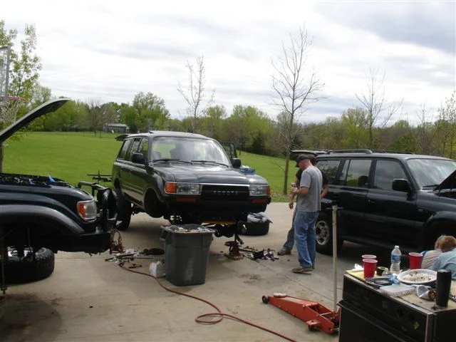

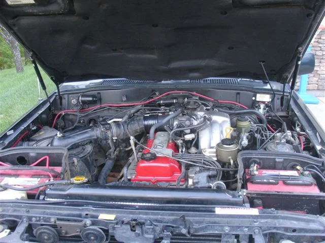

It is finally time for me to introduce myself and my new LX450. I bought this off of MUD from Addicted56, and had it shipped to the middle of the country. I drove it all of 10 miles before parking it and pulling out the front axle for a knuckle rebuild. My wife and I hosted a wrenching weekend for our local club, so my plan was to pull it out of the LX, sandblast and pait it before the weekend. Well, time ran out, so I rebuilt the axle first, then double wrapped everything then sandblasted and painted it up. Finally got everything back in this weekend, but ran in to a problem.
I think the power steering pump can't keep up with the big tires. I ran it a mile down the road taking lots of corners and turns and it just stopped working. The resevoir was HOT to the touch. I jacked up the car this morning and manually ran the wheels back and forth with no issues, so what else should I test before replacing the pump?? I know the prior owner rebuilt part of it, so I will see if he will post up here.
Here are some pics..
EDIT: The more I think about it, I wonder if there is something wrong with the gearbox... Now, I have not used a non-power steering rig with huge tires before, but it really felt like it hit a stop. I could turn left but not right at first. Reverse was the same.... With the powersteering fluid that hot, maybe it was working. Could it just be the gearbox? How can I test to see what the issue is?

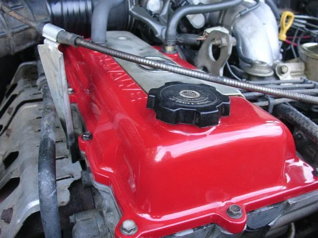

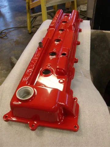

So, while the axle was out, figured it was a good time to attack the valve cover leak.
After I took off the cover, discovered the oil seals around the spark plug tubes were in pieces throughout the head!!!
Decided to clean it up and powdercoat it. Had a local shop coat it after I beadblasted and cleaned up the casting.
Blood Red powder that I bought from Powder by the Pound on Ebay.

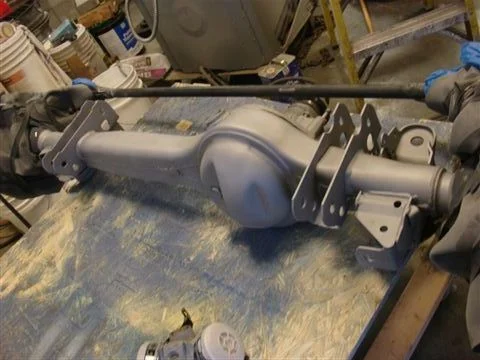

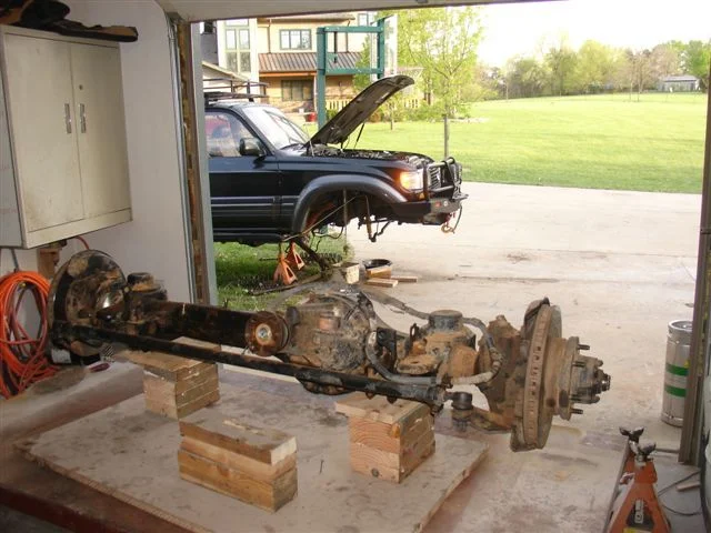

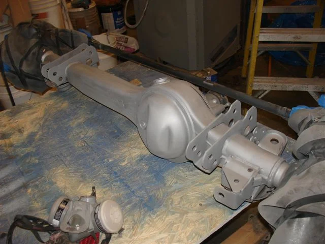

axles
We ended up doing three front axles over two days that weekend!
I am pretty tired of looking at axles!

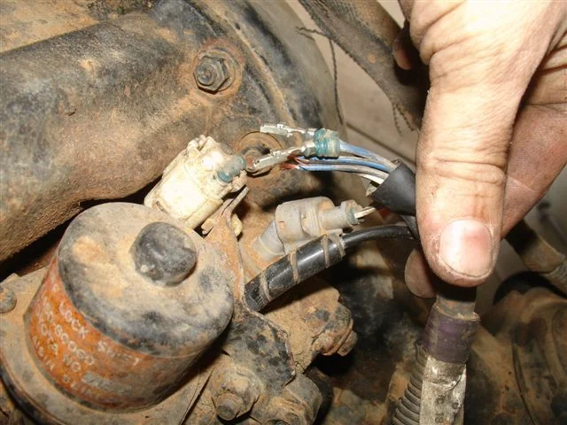

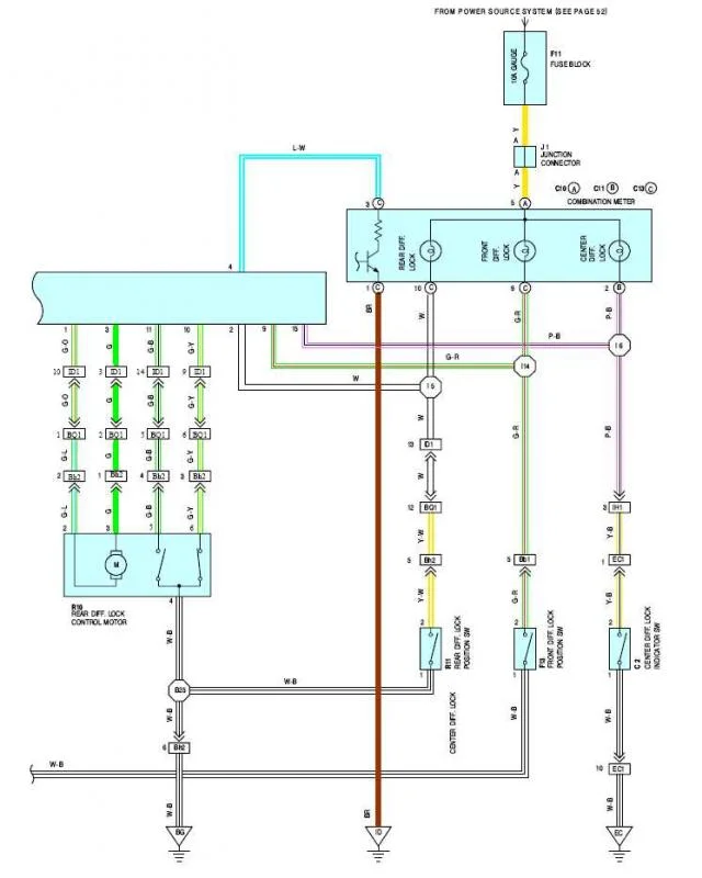

Here is the deal, taking the axle out, I disconnected everything except I could not disconnect the wiring harness to the locker, ( I said to myself .... "self, don't forget to work on that before you drop the axle")
Well, guess what, I forgot. So, I ruined the harness, and was left with a bunch of wires hanging out. We did not know what wires went where, so we looked at other 80's and the manual, and came up with our best guess. The wires on the harness going to the motor, were different colors than the other 80's and manual. The thought was that it may be a motor for a rear locker??? So, like I said, we made the best guess.
The dash does not show anything is locked currently, but since I rewired it I am not sure that it is working correctly. I will investigate

Ok, so it is on jack stands and the locker switch is off, and the front axle if locked. So, I likely did not wire it correctly. So several questions here. Does anyone have a 97 that can look at the color of the wires going into the connector at the locker? The 96 and 94 that we looked at have different colored wires.
If I remove the locker motor, how can I manually unlock it?

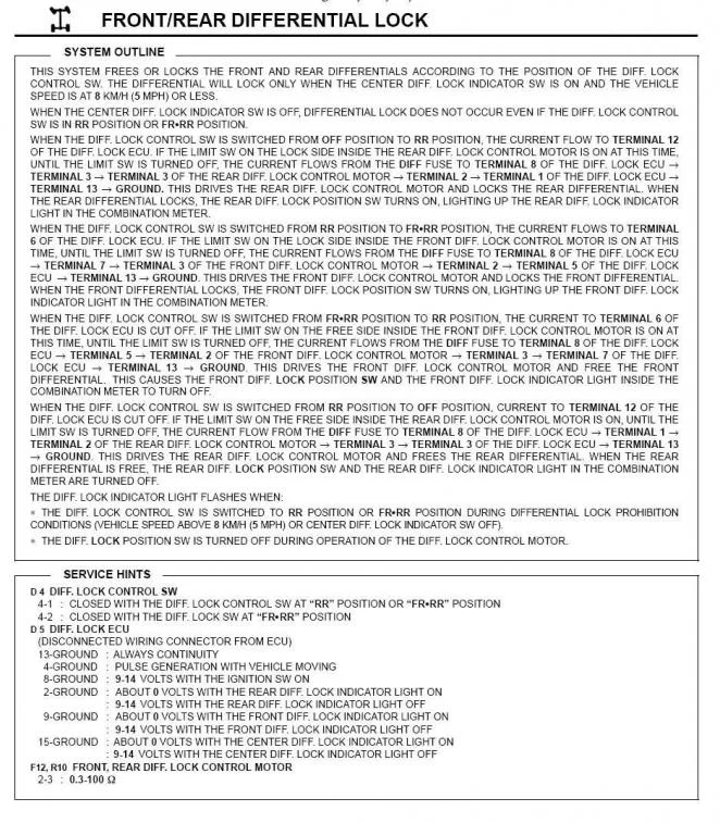

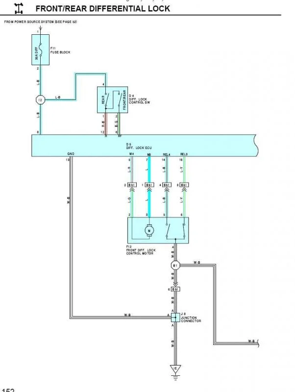

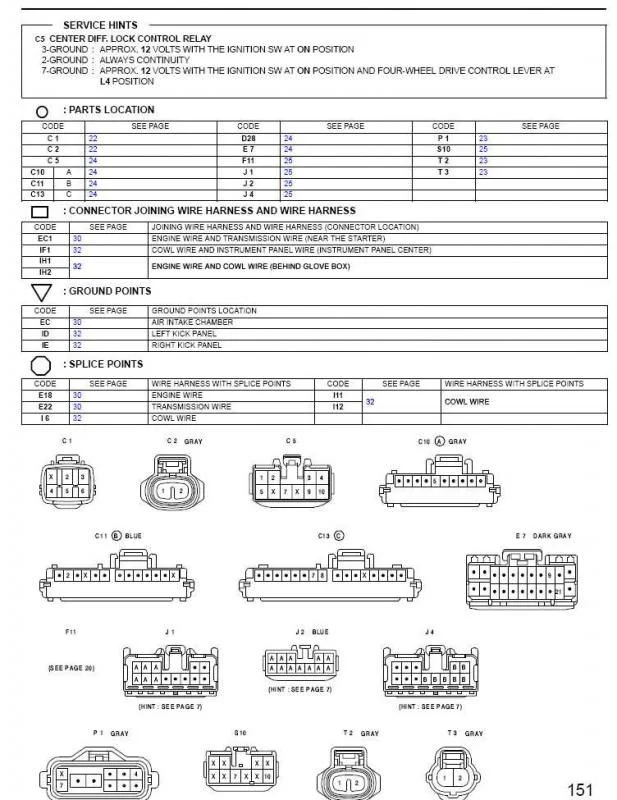

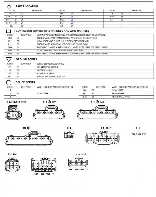

Are you working with the factory EWD book?
I want to say the socket locations of the wires by color code are in there, going from memory.
I have a '97 & your motor for the diff lock looks like mine (I don't think you can even interchange them - different paths of motion IIRC)
I'll see if I can post the wires & the locations (or snap a pic or 2) of that end of the harness - I might have buried the socket connection in tape as I was re-using an old harness for my locker swap, but LMK if you need help still with anything you haven't yet figured out on your own.
I printed off the above pages, and they are fuzzy on the color of the wires, so I will look at my 94' factory manual, to see if they are the same, and can fill in the blanks, until then, here are my wires that I can see and how we wired them up.
I also found the part number on the motor for reference: 41450-60060
coming from the passenger side fender connection of the harness
wiring harness to ecu
position 1: Dark Blue/black
position 2: Green/red
position 3: White/black
position 4: Dark Blue (heavy gauge)
position 5: Dark Blue/Red
position 6: Dark Blue/Yellow
Connect to harness going to front locker/sensor
position 5: Dark Blue/Green (note this is different from car harness color)
At motor here is how we wired it: (we did not use connector, just soldered them on, so the reference I am using is the position from the connector above)
Note: the Green/black going to sensor, and half of the white/black -- both going to the sensor were not cut, so those are factory original.
FROM --------------------------- TO on motor
position 1: Dark Blue/black -------------Yellow
position 2: Green/red --------------------- to sensor (looks like green/black)
position 3: White/black --------- (splits) to sensor and to Black wire at motor
position 4: Dark Blue (heavy gauge) -----Dark Green (heavy gauge)
position 5: Dark Blue/Green -------------- Green/red
position 6: Dark Blue/Yellow -------------- Lt. Green
So, every manual that I go do does not show these colors on the motor: lt. green, and yellow solid wires. Any ideas?
I may be getting ahead of myself here.... General question, is there a way to manually disengage the locker? I want to rule out any issues with my front diff.
I would think that i should be able to pull the wire harness off of my sensor at the front diff and check to see if it is closed.
Here is something on manually unlocking the diff. Not sure if the answer is in the thread or not.
Here are the pages as a pdf (now that I'm at work and have more Adobe capabilities).
