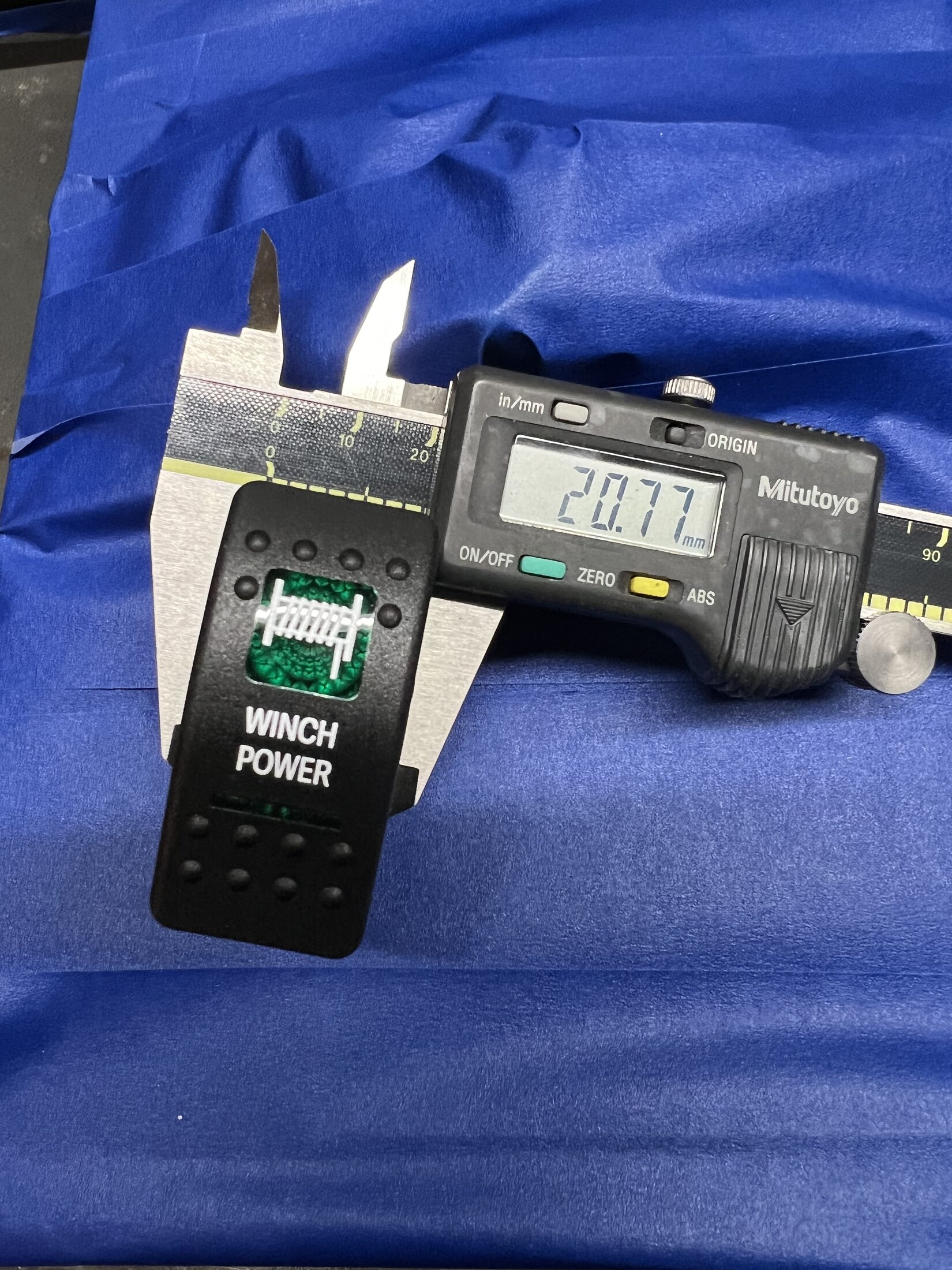

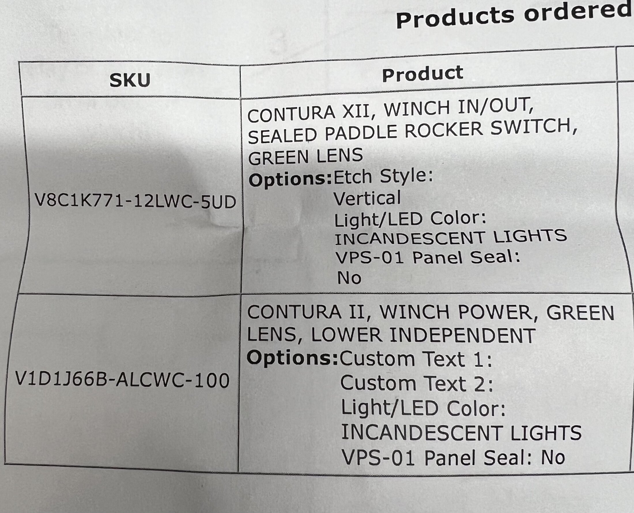

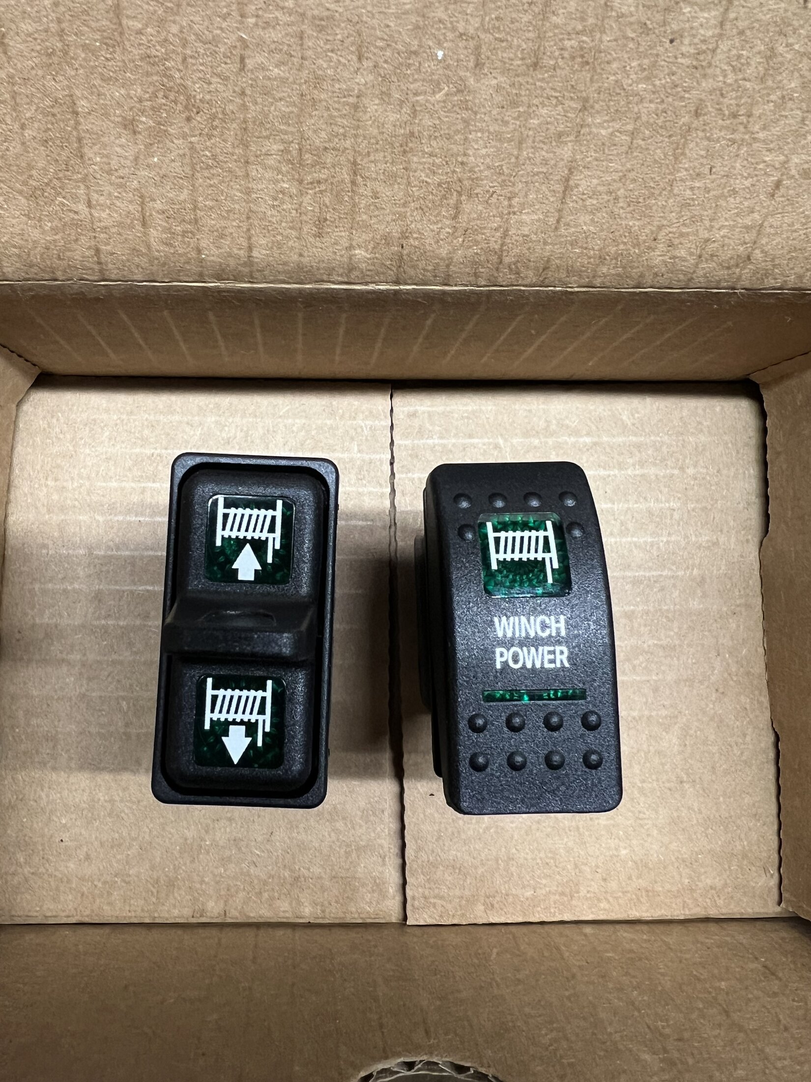

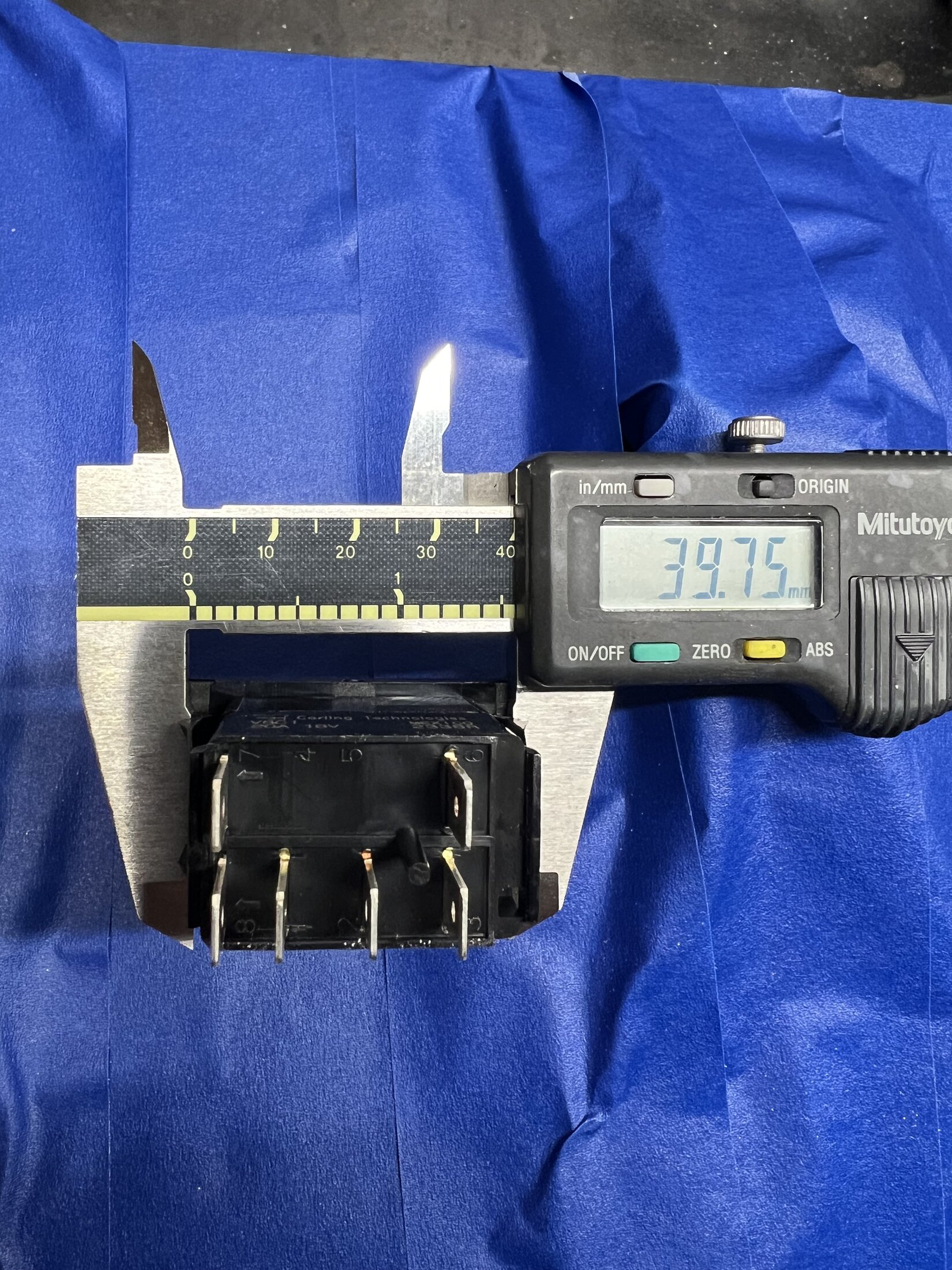

Unfortunately the Carling Contura II and XII that I ordered (from OTRATTW) do not fit the Delta console openings without modification. They're both a tad too wide.
I need to decide if I look for a drop in option, or start filing.

The AOB I posted is not a true Carling if I recall, just made similarly. These are the dimensions they posted for the switch I linked. See if the measurements work.
“It has a face surface size of 1.95'' x 0.96''(49.5mm x 24.5mm) and uses a standard din size mounting hole of 1.5'' x 0.8''(37.5mm x 21.2mm). This is the standard size of most switch holes in modern vehicles, however it is best to check your particular hole size if unsure.”
EDIT: I measured a generic fog light switch I have for the 80 and the switch body seems to measure about 36mm x 20.5mm so I would guess that the Delta console is setup likely for standard Toyota sizes and the carling style are just slightly larger.

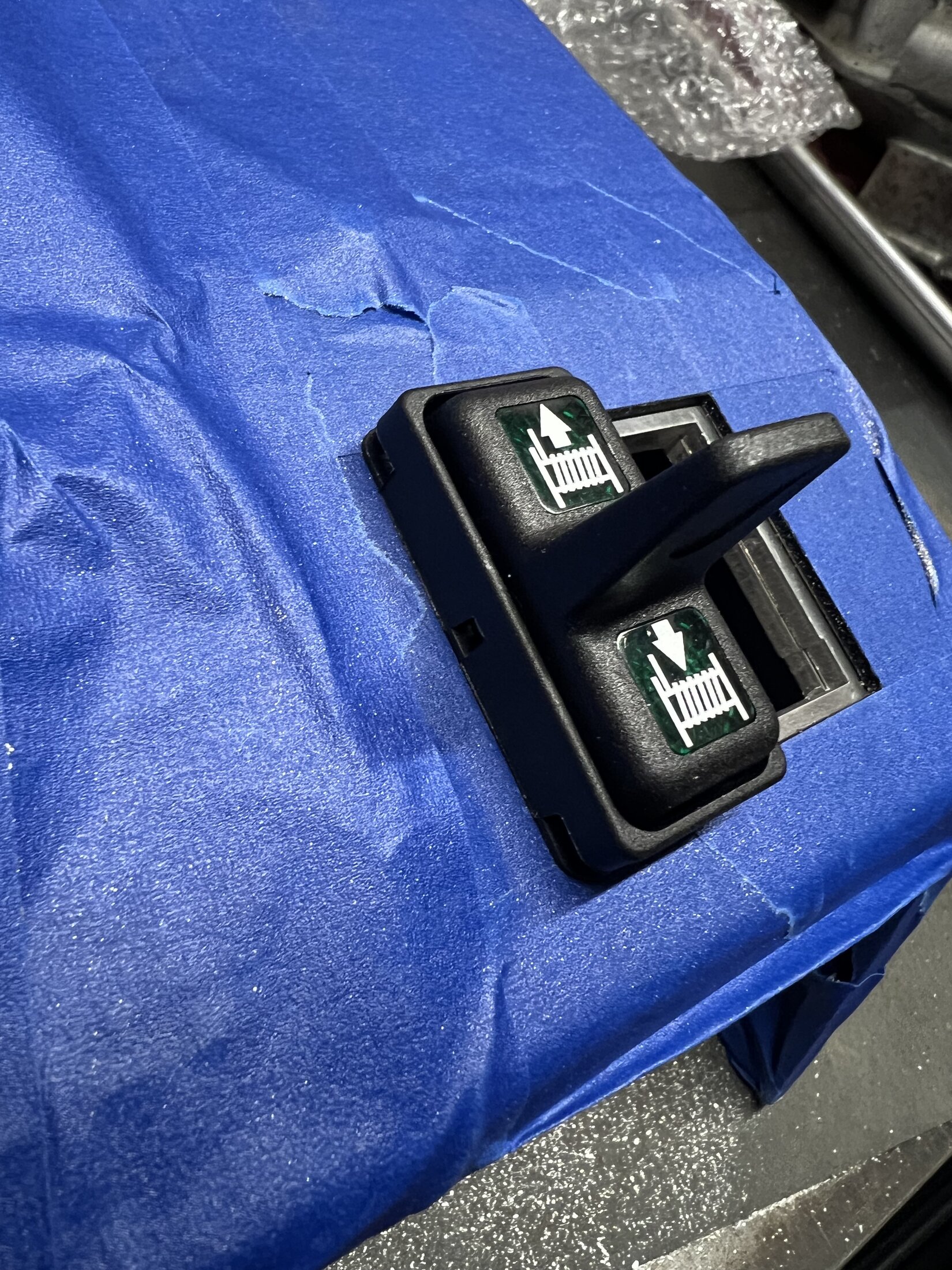

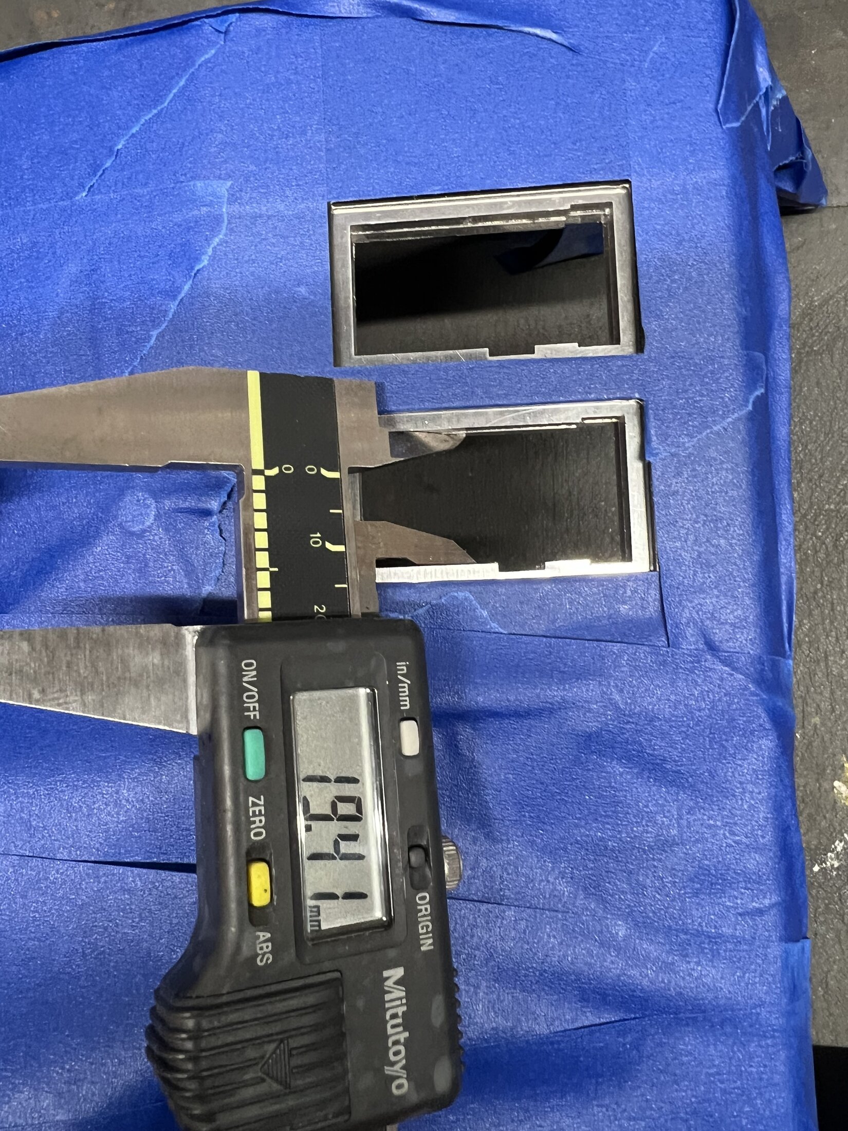

Delta got back to me (very quickly!) - they recommended that I file the nubs that are interfering, checking fitment periodically. The design is meant to fit a wide range of switches so the holes require fine tuning.

I taped everything off and took the file to the first hole. The part that needs adjustment is aluminum. I had to expand the width to the full extent of the nubs and the length about a millimeter on both directions. I'll tackle the second one this weekend. Filing it by hand is time consuming.
