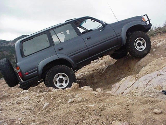

I was running Slee 4" front springs with a 1" spacer, and J spring rears with 1: spacer. 35" truxus. I made custom shock mounts in the rear to fit 14" bilsteins, and had 12" procomps up front. I had PLENTY of room for 35's and didn't rub. I had 3.5" of bumpstops on the rear mainly to keep the shock from bottoming out. Only slight rubbing in the rear on full stuff, as I hadn't done the panhards yet.
Here was a normal pic (sorta don't mind the mountain ;p ) that shows the ride height and clearance.
attachment.php
Flexxy :)
attachment.php
stuff and me trying to tip it..
