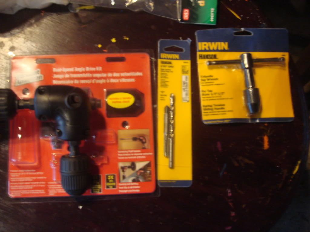

That hole is a machining/tooling port, should be a pressed in plug in that hole, they came that way from the factory in Japan....bit of an over(under?)sight on Mr. T's part. Those plugs can work loose and eventually pop out, causing catastrophic oil hemorrhaging. Relatively rare occurrence, but it's still a reality. Mine popped out years ago. I was lucky and caught it, you got lucky too.
The fix is to tap threads in the hole and screw in a plug with some locking sealant. Do some reading, it's well documented here.
Get some M8 x 1.25 x 8mm long and thread them in. Others have done this with 5/16 but personally I'm not a fan of mixed standards on my vehicles.. If you need some I can send them along as I have spares. Otherwise, use this McMaster pn.
