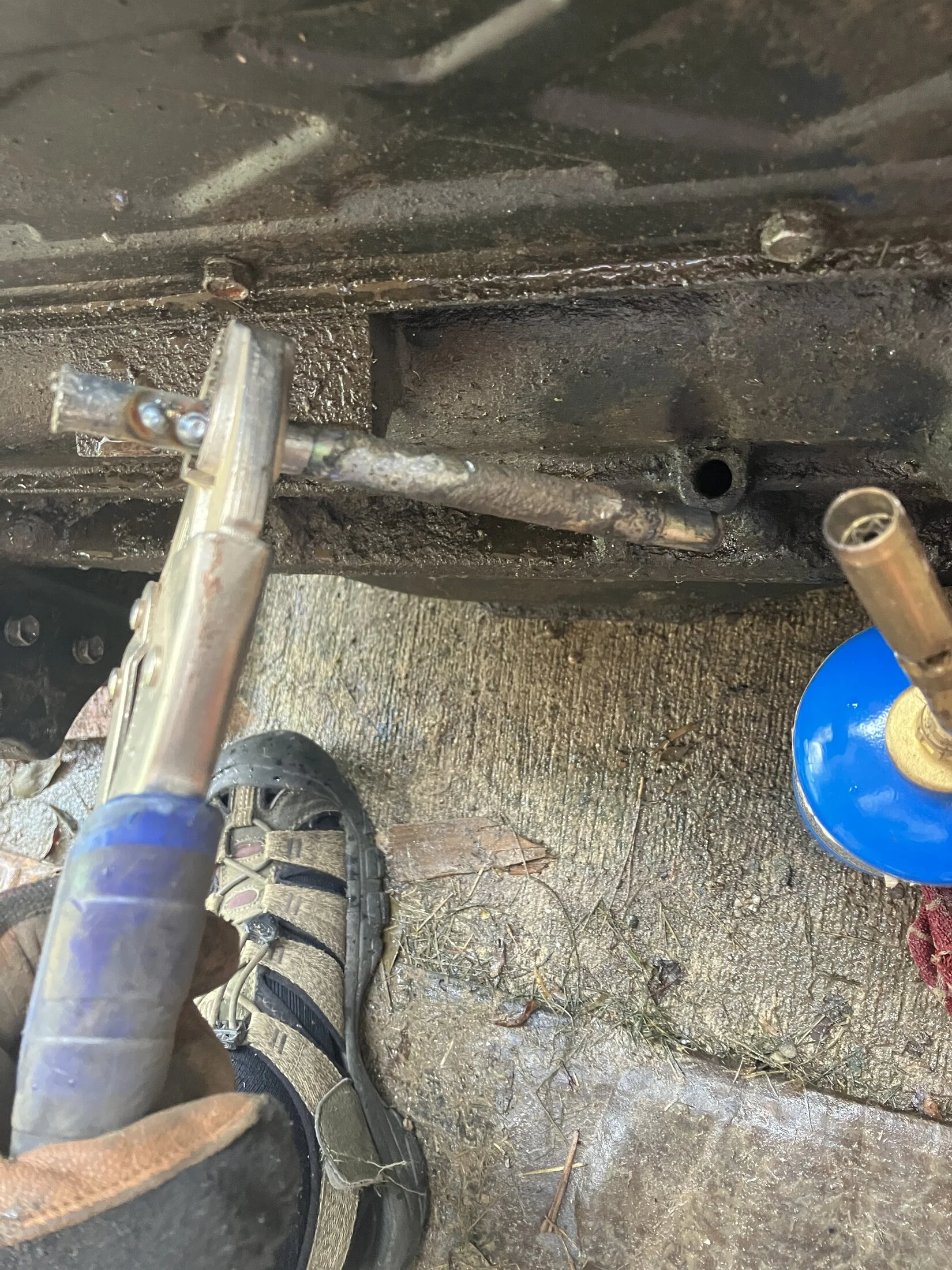

Since it is available from Toyota, I hit it harder, used heat on the insertion point and PB Blaster then welded a tack onto the post to give the vice grips a surface to grip beneath and then whacked from below. I’ll place this in the freezer and heat the insertion point and maybe a thin coat of JB Weld to reinsert in the newer engine. Have I mentioned I’m retired and cheap and there is NO cash flow?!

So glad I didn’t have to go that route. I used black fipg in a thin layer and tamped it back in with a soft piece of wood so as not to bend the flare end.
