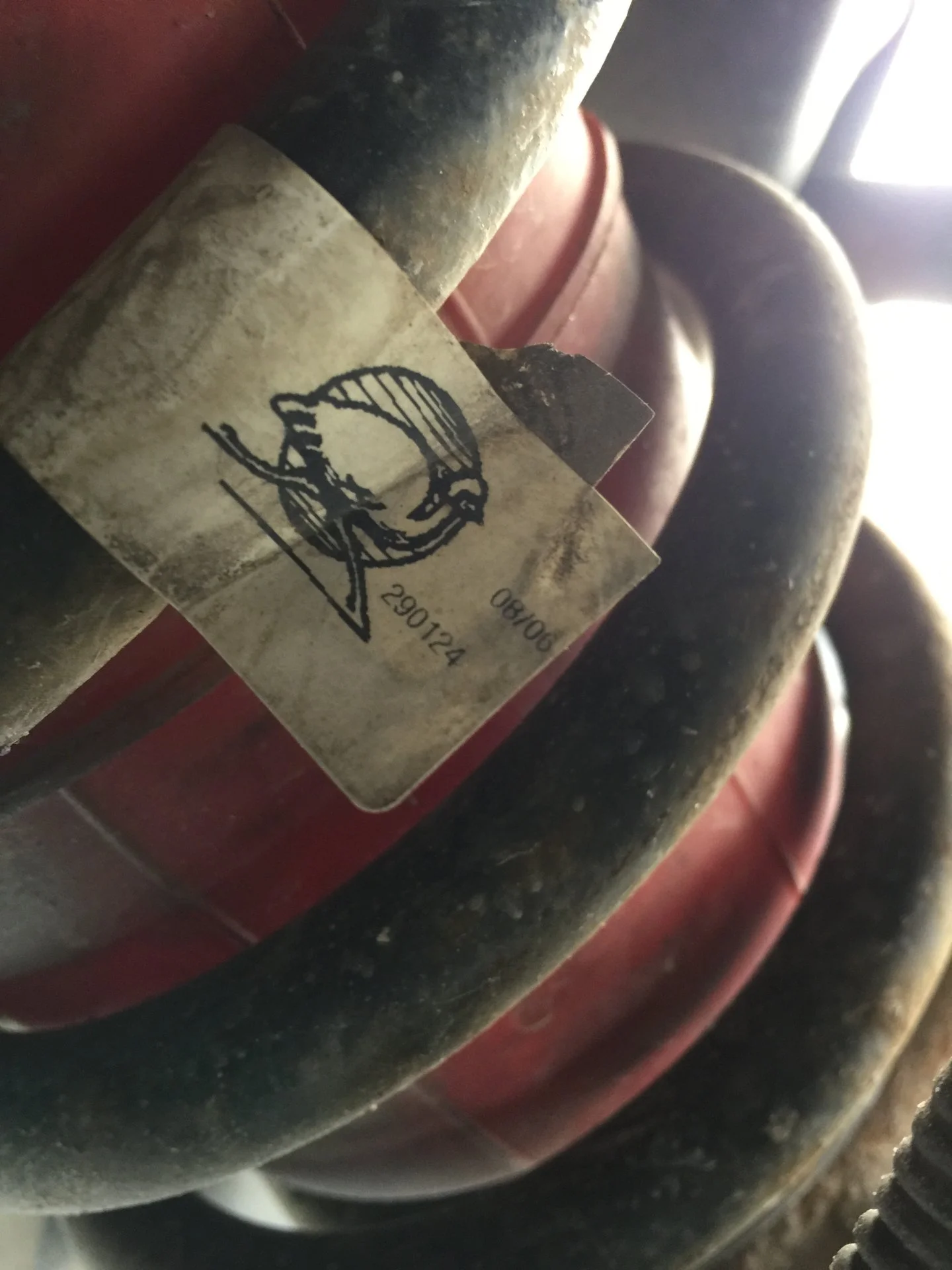

I have been trying to figure out what OME springs I have in the rear, but I haven't been able to track down this part number. Anyone on here know what springs I have?
Perhaps these-https://www.summitracing.com/parts/emu-2901
