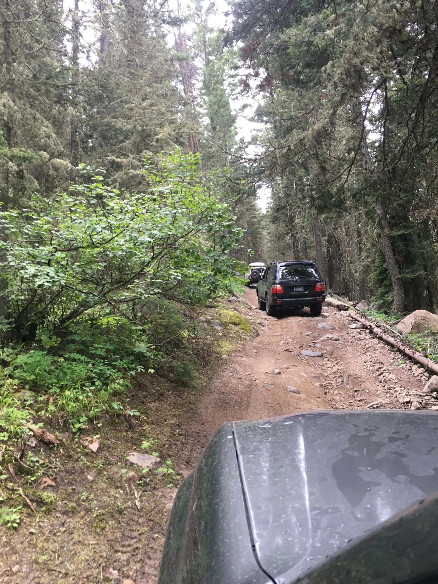

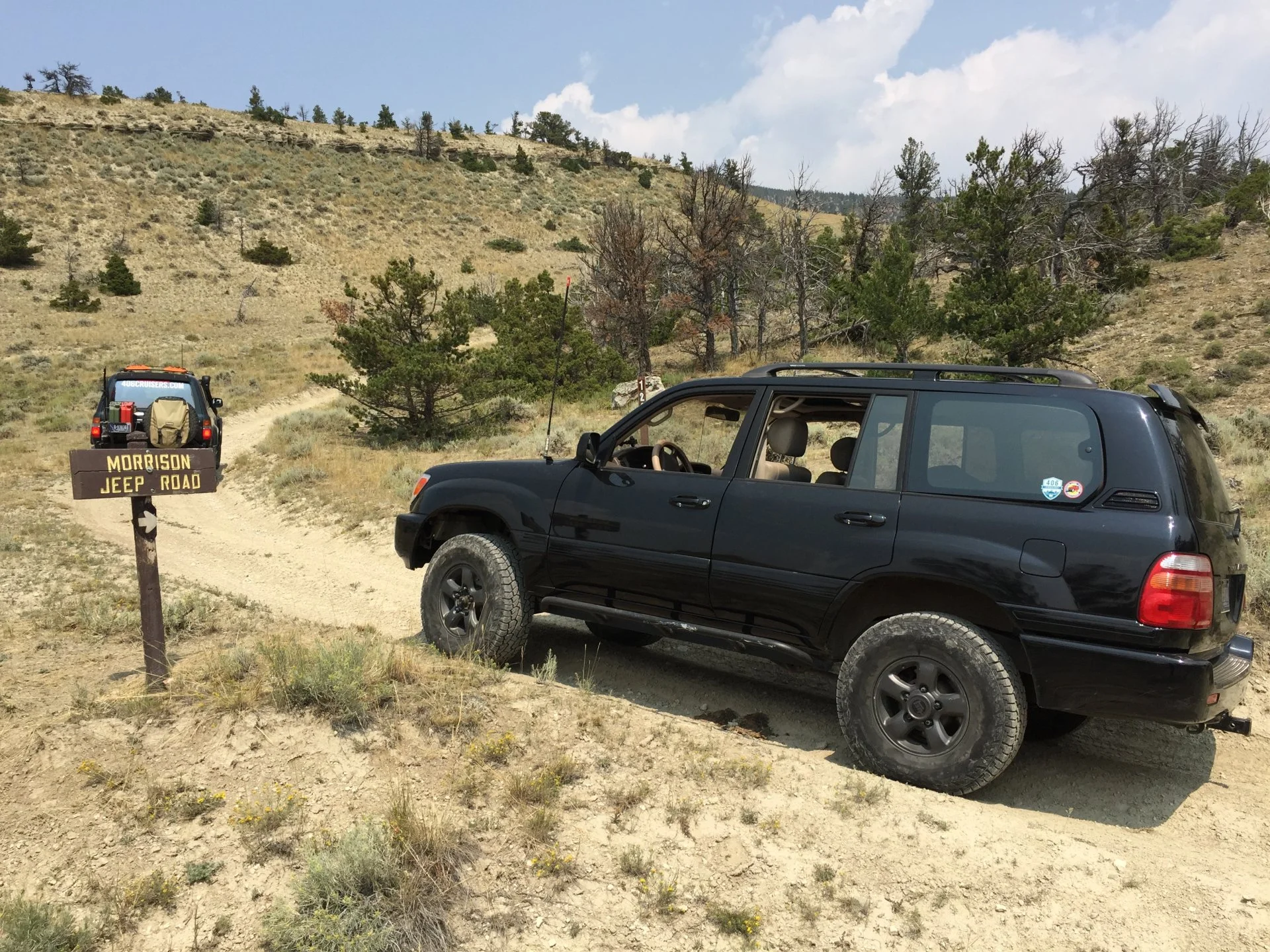

Then it was time to hit some trails. I was lucky enough to be following someone who really knew their way around the area. Here are a few pictures of the places we got to visit.
The cruiser performed very well. I would hit my sliders, pumpkin, and shock mounts every now and then, but I was following a nicely built 80 around, so I considered that a success. By the end of that summer, the bumpers were a bit scratched up from low approach and departure angles...and that one rock on the side of the trail I somehow didn't see. I didn't have any plans at the time to replace those, as I hadn't encountered a place yet that I would need the extra clearance. That however did change eventually...

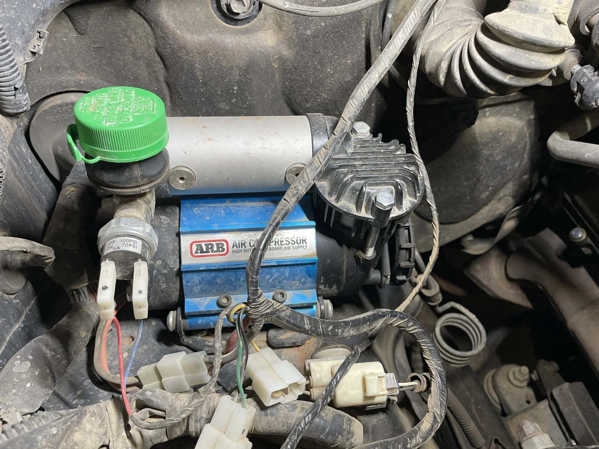

I didn't want to rely on the rigs around me to help fill up my tires after going on a trail ride, so I decided it was time for an arb compressor. I would have loved to go for the dual, but money was pretty tight, and I saw the single performed pretty well, so I opted for that one. Again, I would love the slee mount, but I decided I could just use the empty space on that side, and mount it straight to the fender. And before anyone asks, yes that is a bottle cap. It has worked great as a dust cap.

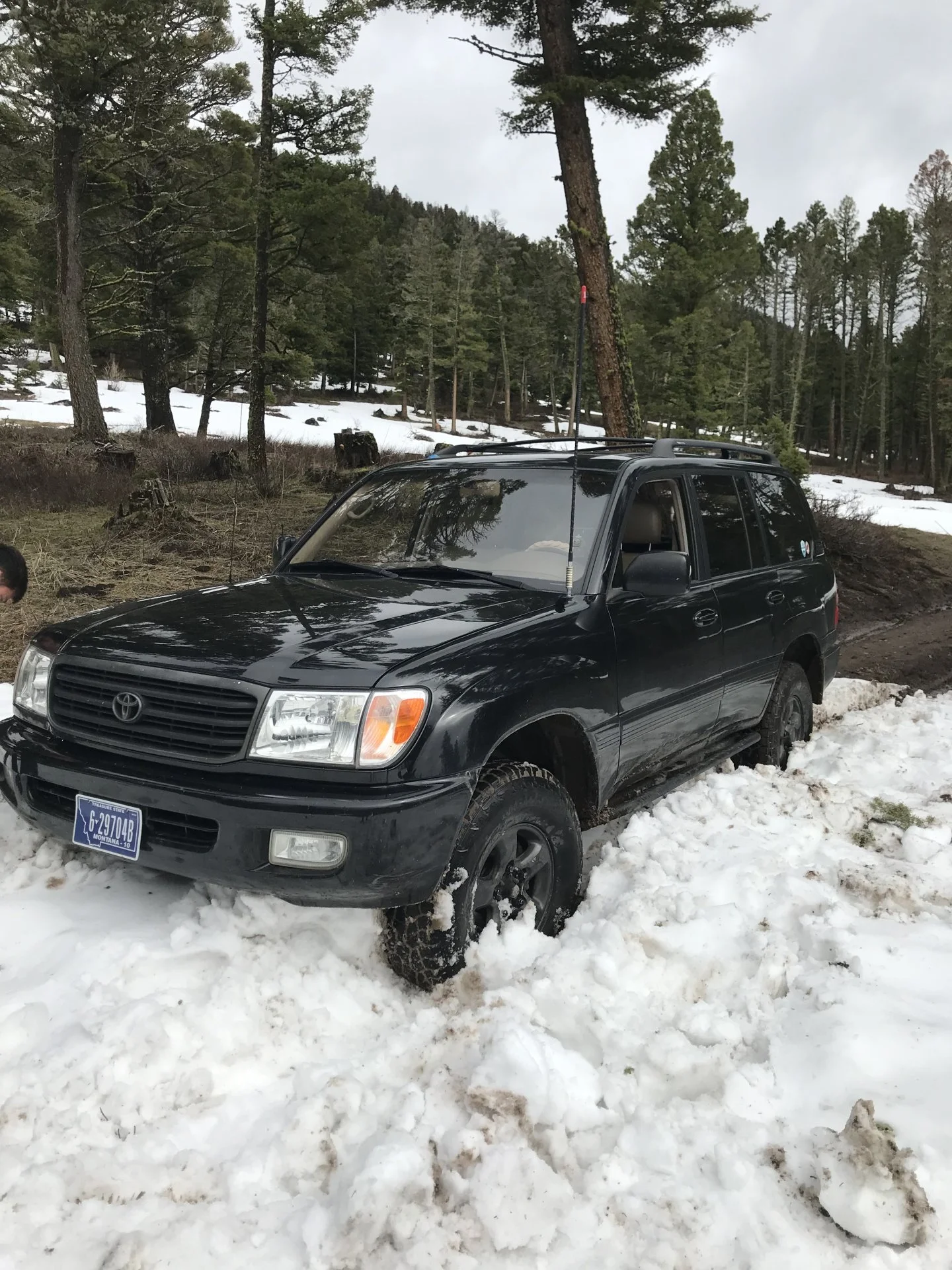

Then it was off to more trails, and getting stuck in a snow drift during a bachelor party.
Nice pic. Our rigs our great in the snow but once that heavy snow hits the frame rails it's just like a beached whale. Took me a few dozen times getting stuck to realize It's just not worth hammering down trying to get through to eventually get hung up.
Agreed. There have been a few times I have been buried that deep, and it's a battle to get them out.
