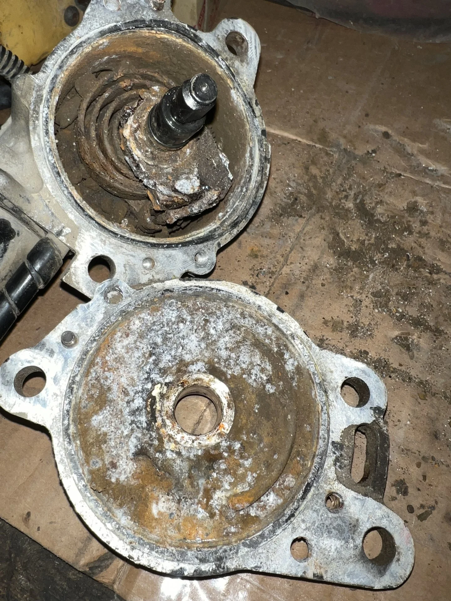

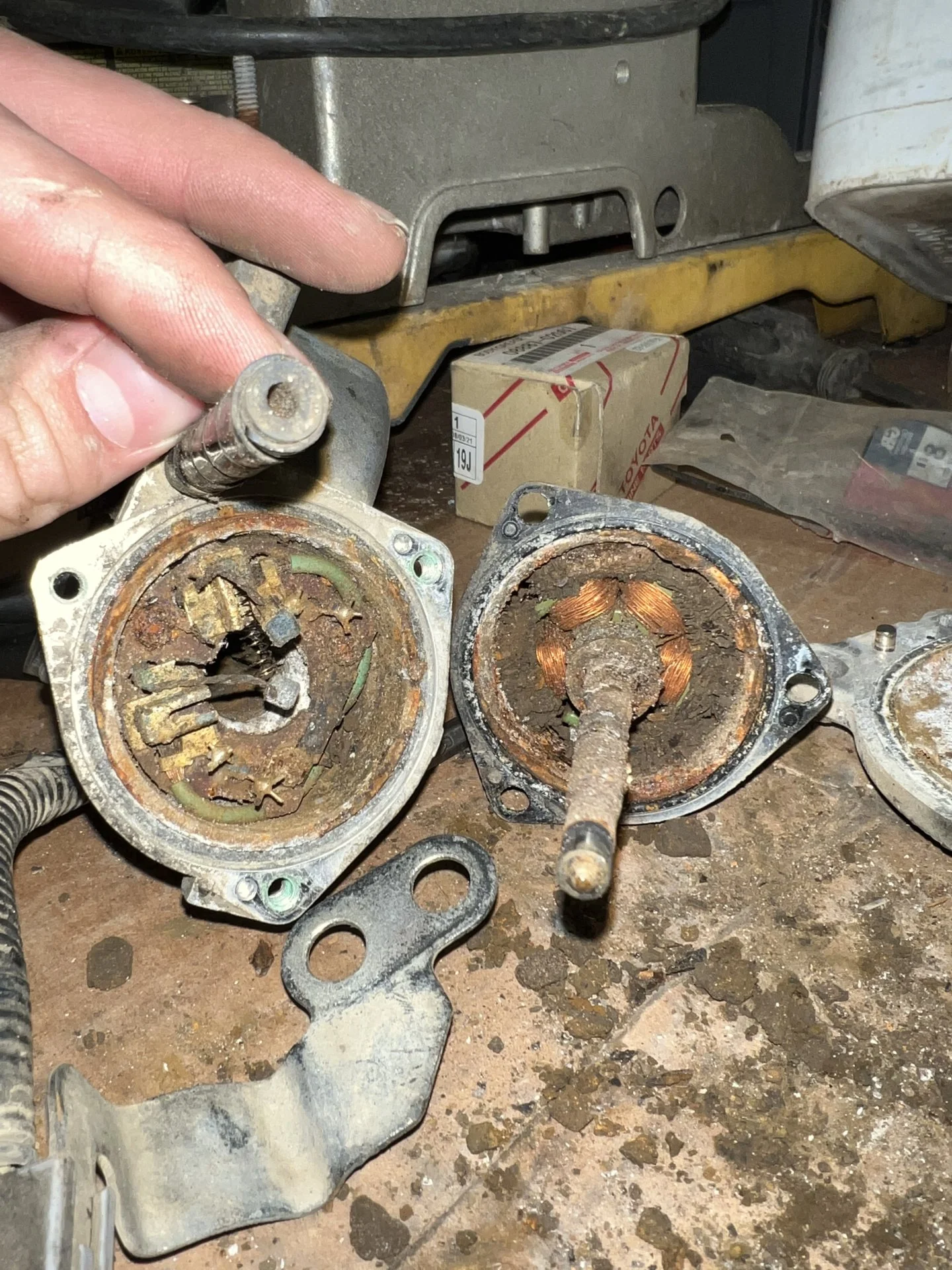

I’m just going to skip the backstory for now. This is the elock actuator that came with my Craigslist differential. I figured I’d just open it up and re-grease. I found more than I bargained for…
I’ve got the wiring harness, I’ve got the fancy Toyota grease, and I’ve got the re-rebuilt-regeared differential. If someone has a actuator in serviceable condition, I really don’t want to attempt to fix this one :/
Mine was in worse shape. I looked for a used one for a while, but then bought one from aisin brand new.
I’m baffled. How can so much mud even get in there? The seals look old, but otherwise totally fine.
What your index finger is no is the breather and it's full of mud, I think it was coming in through there.

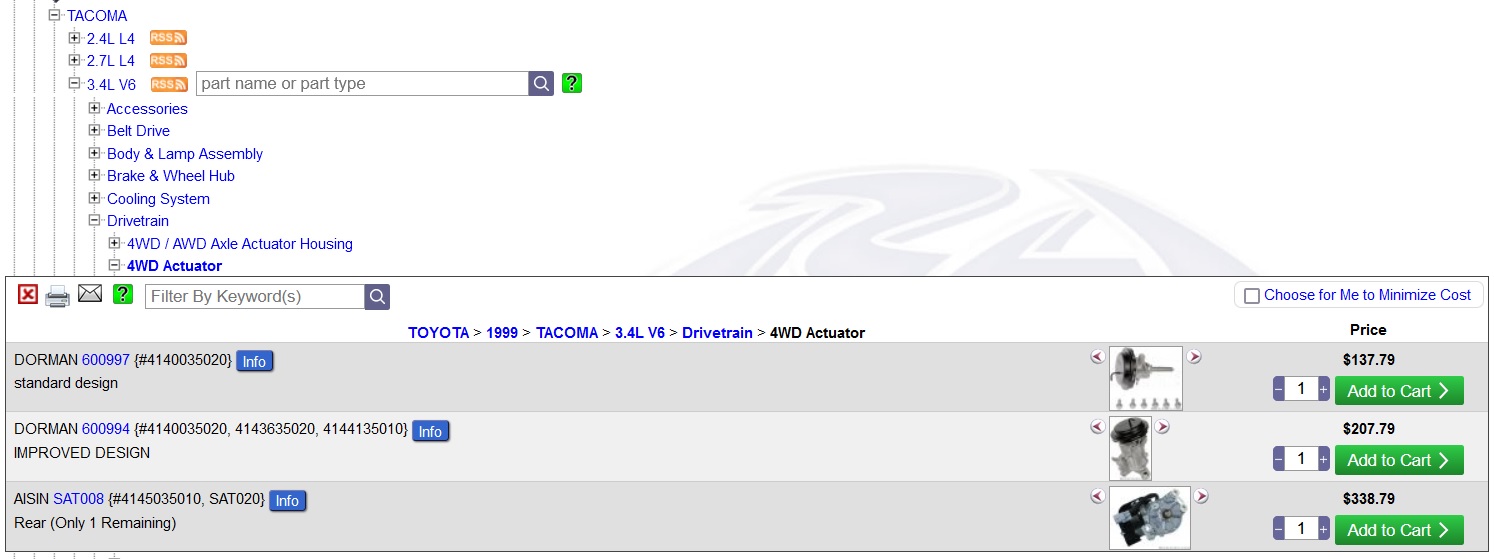

Check Rockauto. After the Aisin suggestion above I looked and they might sell it for around $200. Don't forget the 5% MUD discount code.
Search up an 80series on RockAuto, that's where I found them...nothing came up for Tacos or 4Runners.
They have for the rear of a 80 but there north of $400. 🤷‍♂️
I was looking at this one.
With out seeing the base hard to tell witch one ;)
Dang, that is more than a discount dealer. Usually Aisin aftermarket is way less.

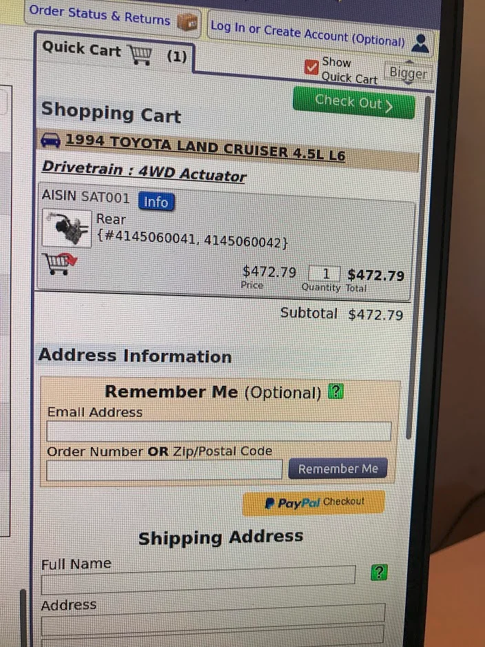

I bought my Aisin replacement actuator fro
Rock auto and I am pretty happy with mine. The one I took off was ten times worse than yours.
Edit:
Sorry didn’t read over the rest of the comments but mine was for my landcruiser I don’t know if the actuators are different on different models.
