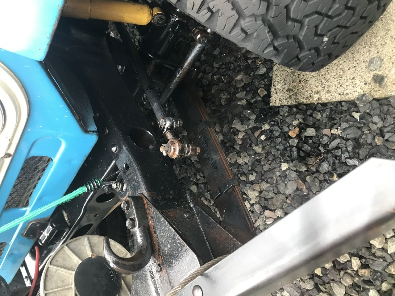

Here’s another I’ve been looking at. The buyer seems honest and responds quickly. The rust scares me a bit. Also just let me know that the heater fan is toast as well as some other items listed in the ad.
I’d think prob 6-8k to have a shop fix the rust issues? Is that realistic? I’m fairly mechanical and I’ve always wanted to learn to weld… Would it be realistic that I could fix these areas myself with a little help? The guys on YouTube make it look “easy“!
He said the engine was rebuilt by his uncle who is a master machinist about eight years ago. Most everything is original.
The black patches are covering rot.
What do you think a fair price would be for this 40? Should I run away and keep looking? 15k it’s about where I’m at budget wise if I find the right one.

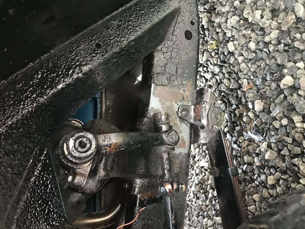

Couple more photos he sent me. Undercoat is cracking but he said the frame is in good shape.

also, where is all that wetness coming from on the driver side frame ?
That wetness looks like brake fluid. Look at the frame and see it cleaned the undercoating off.
