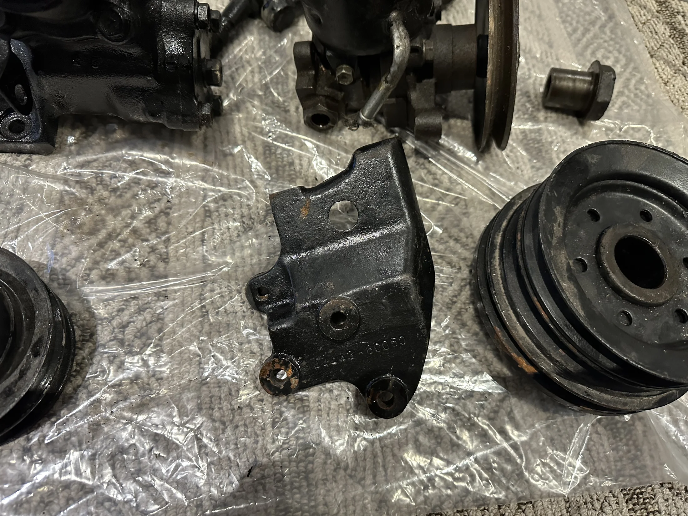

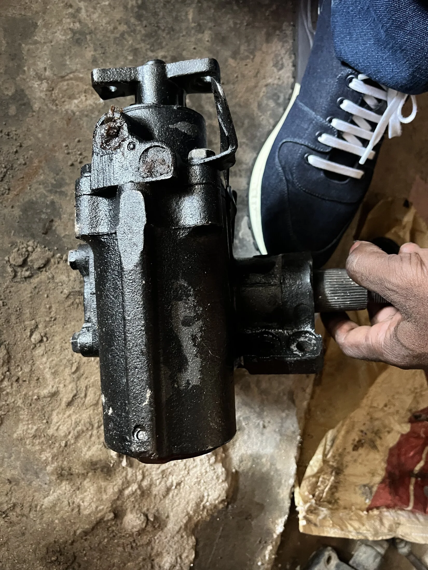

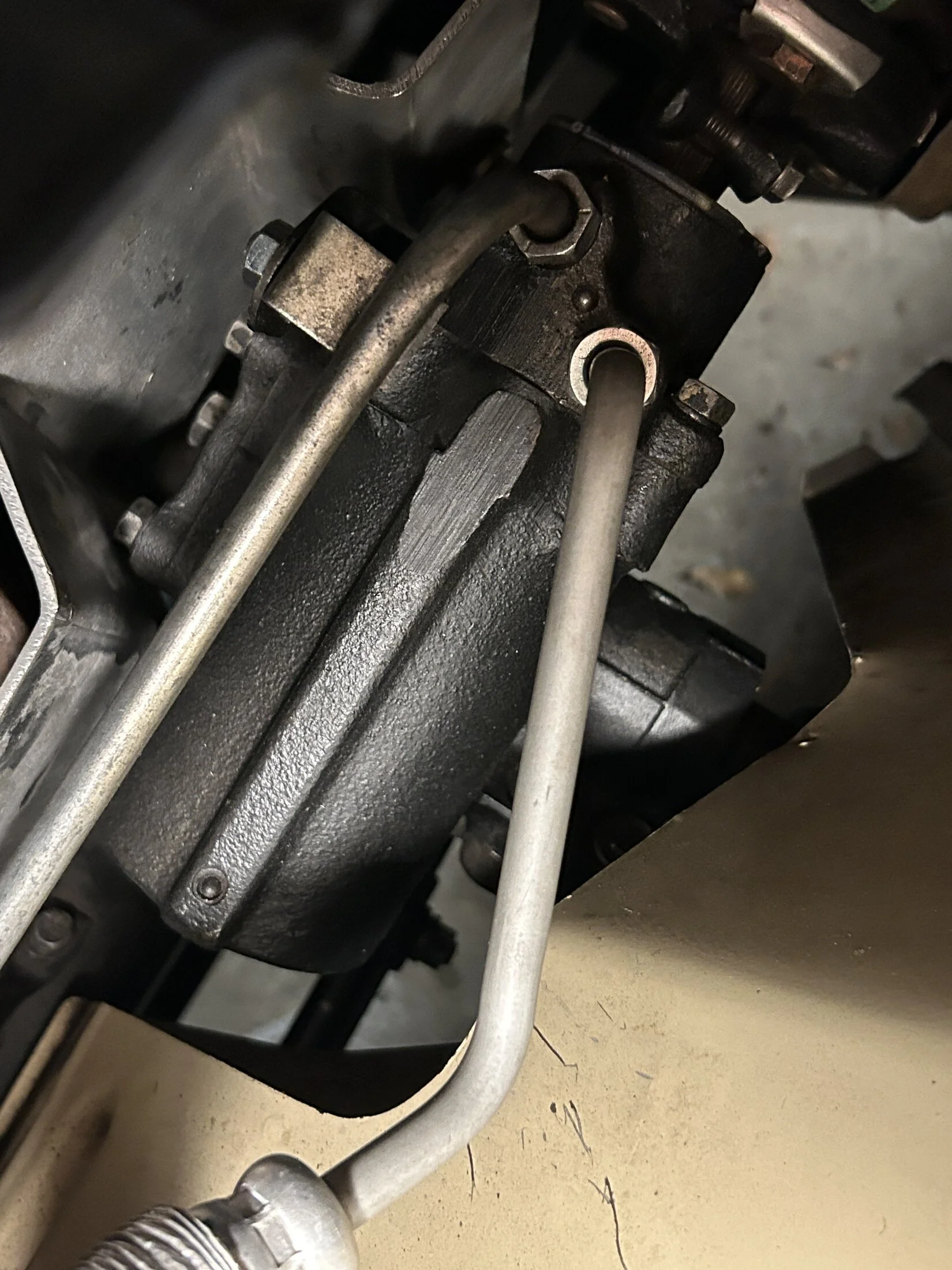

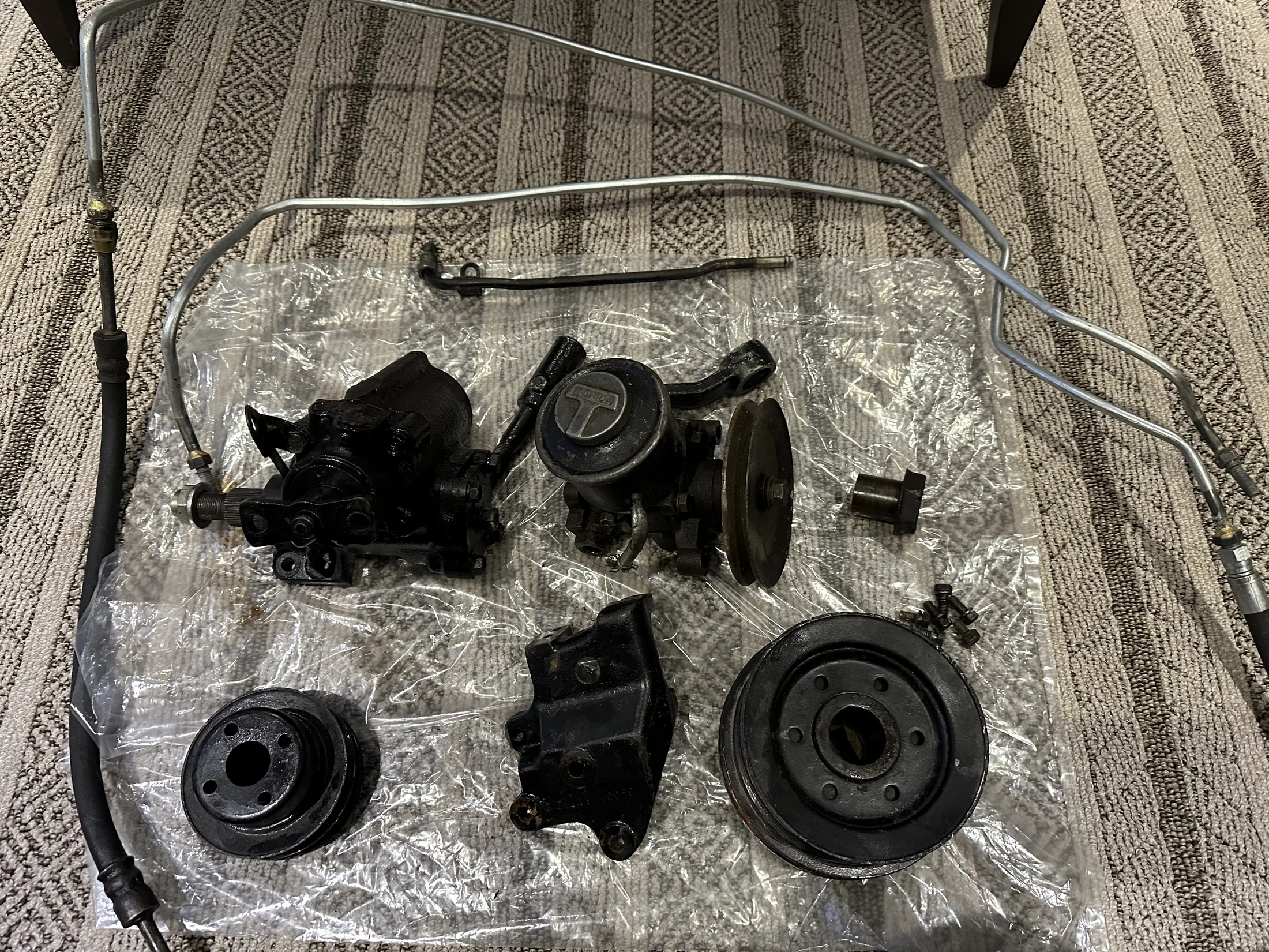

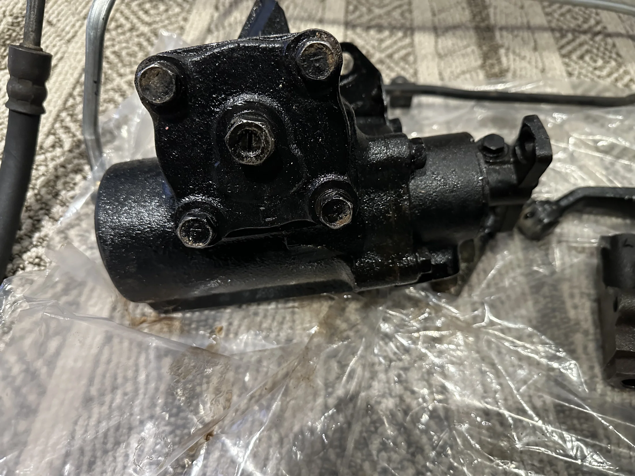

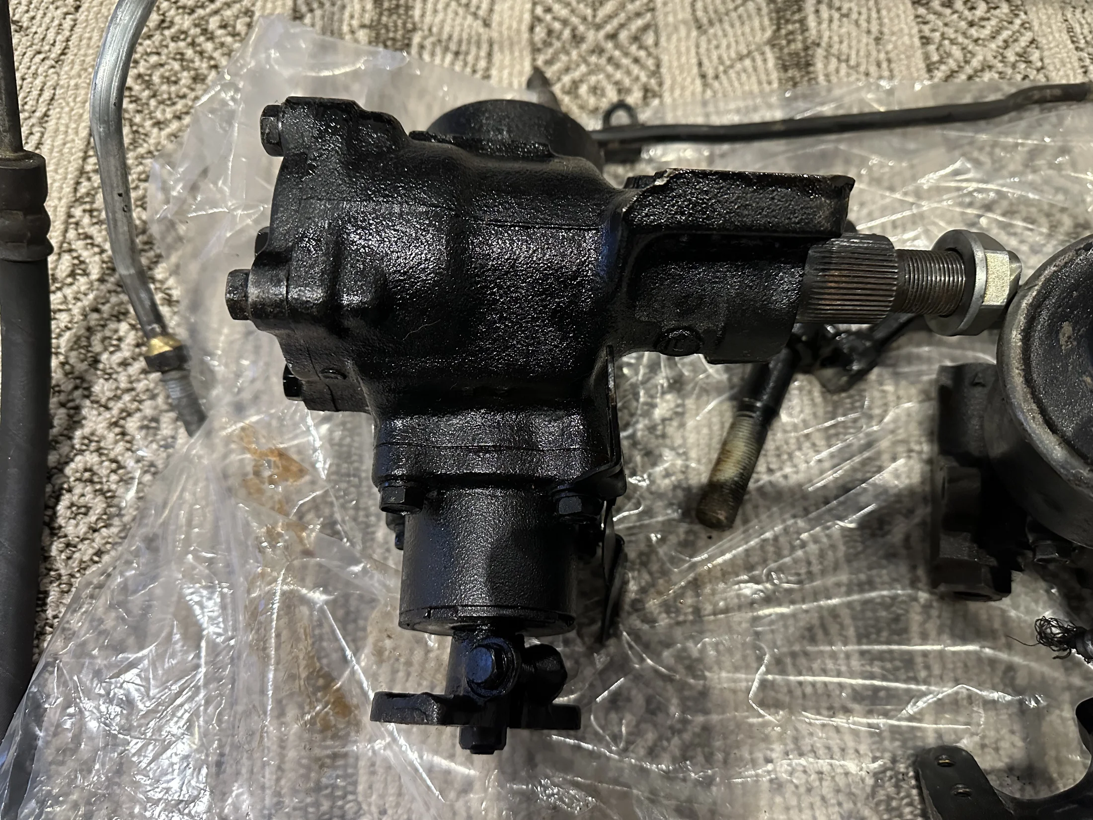

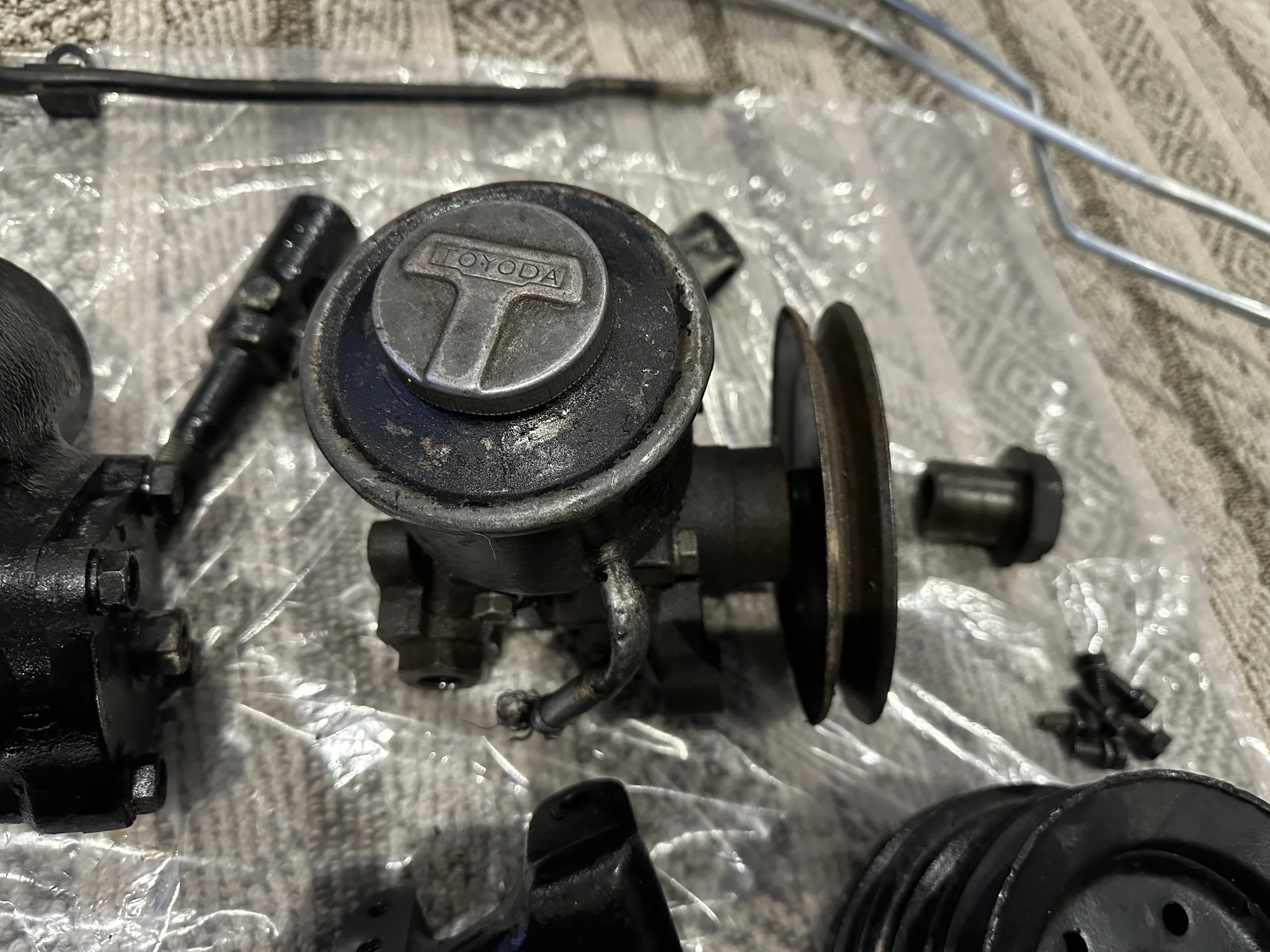

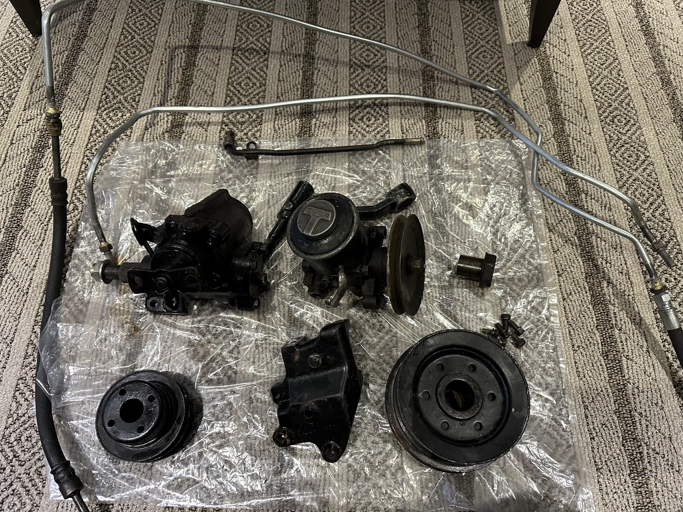

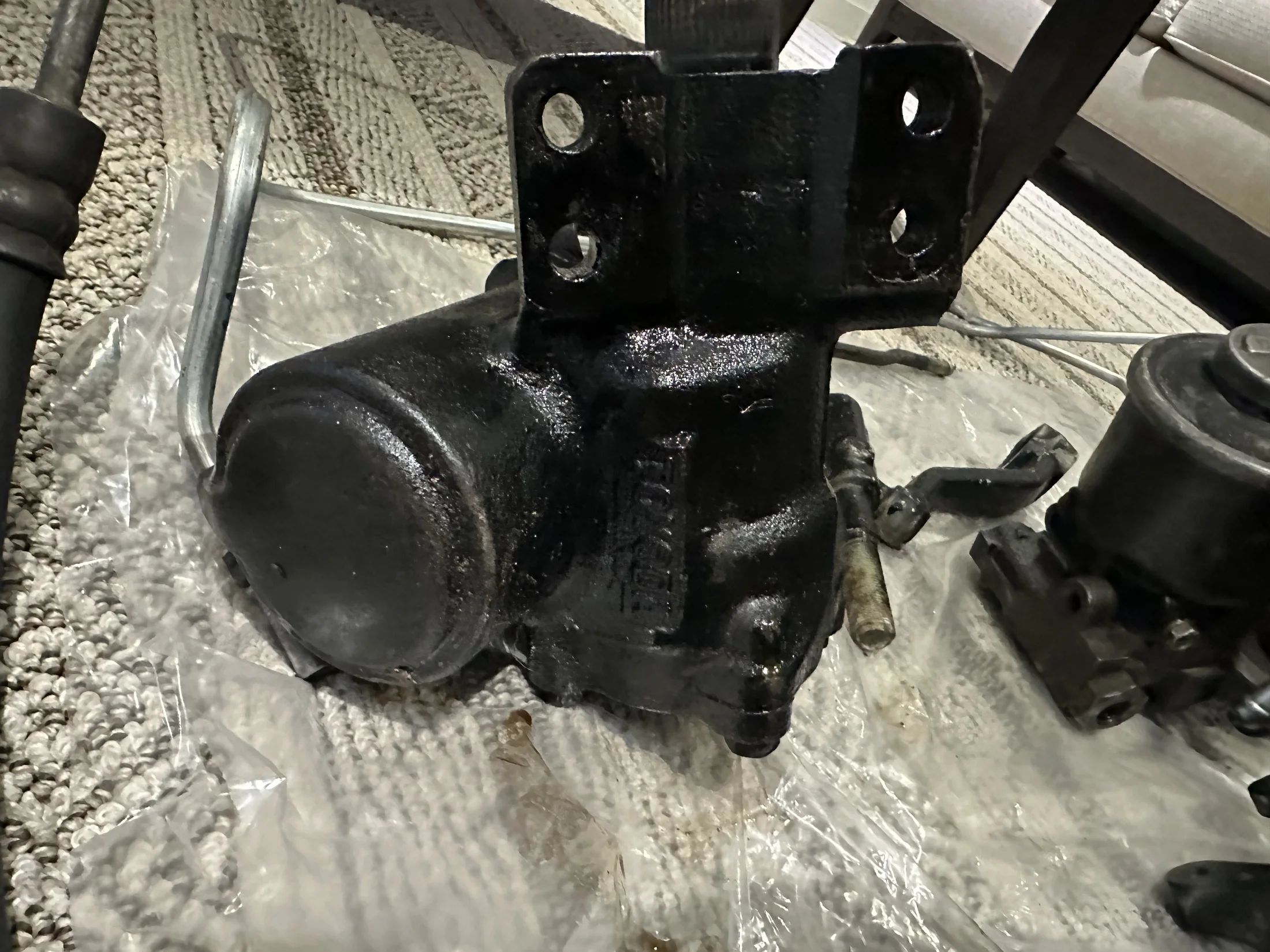

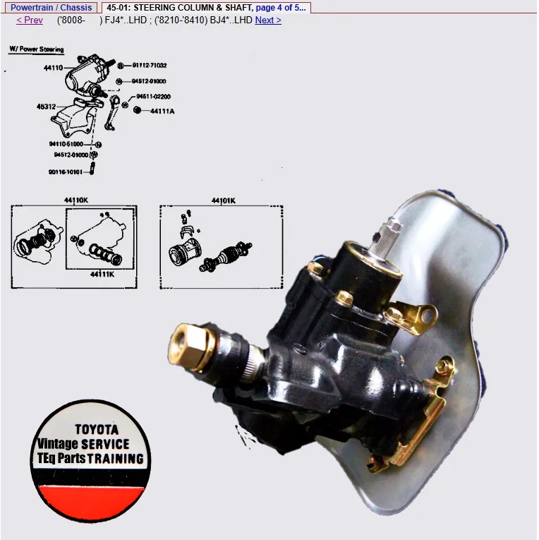

Trying to id this recent purchase- presented as the elusive Toyota Factory FJ40 Power Steering. Was this a good buy or is this the wrong box?
That is definitely a 40 series power steering box.

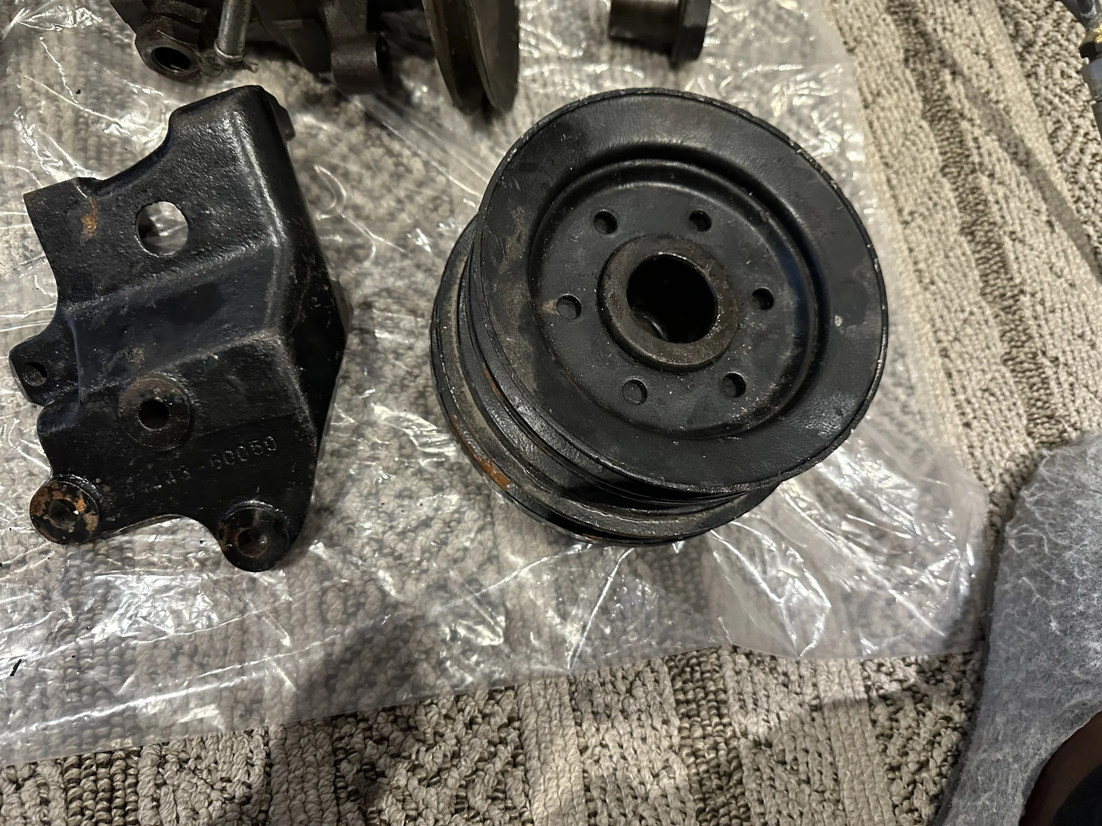

That is a 3F balancer (will work fine on your 2F)
And that is a 3F pump and bracket. Will work fine on your 2F.
It’s actually better for you as you’ll have an easier time sourcing replacement pump in the future from USA FJ62.
I don’t see the adjuster bar present?
If you are missing one, get one from an FJ62.
I have the V-belt in stock you’ll need for this set, they are NLA from Toyota
These parts are all from South America, right? I would not expect that pump or box to last long if so. They’ve had hard lives
@cruisermatt Great to hear from you!! Bought parts from you previously-definitely appreciate your input. Shoot me an inbox price on the V-belt. Thanks- the guys down here in Ecuador sends their thanks!!
