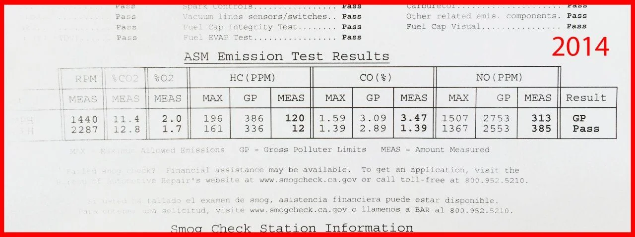

Stumbling through California smog again (inched through 2 years back). After the carb rebuild and everything running well I’m again a gross polluter. Didn’t do a tuneup or anything before taking it in because the truck has been running great. The tech guy said it almost passed, “maybe lean the carburetor out” and recheck. I had opened the main jet a bit (per Jim C’s suggestion) on the carb rebuild, would that maybe have an effect? I’ve attached numbers from 2012 and yesterday (2014) below. So should I just go through a complete tuneup, try to lean out the carb adjustment, etc. and take it back in or should I also be worried about that opened-up jet? Thanks!
I think you also need to richen the fuel mixture - a lean AFR will cause high NO. Could also be a vacuum leak, or if you been letting it sit for a while the carburetor may need to be cleaned.
Since it is failing at 1400RPM, the carb is still partially running on the slow circuit. Leaning out the idle mixture screw may get it lean enough to pass.
Or it's hypothetically possible to oxygenate the fuel w/ E85 and get a similar result.
Thanks for the comments - much appreciated. Pin_Head, the smog guy did say it was running too rich. He said he didn’t know much about carburetors but he also thought leaning out the mixture (as Jim suggests) might help. Does that mean I just follow the “Adjust idle speed and idle mixture” steps in Toyota’s ECR Manual or is there a way to adjust it even leaner? And Jim, is “oxygenate the fuel w/ E85” just an additive I would put in the tank - and should I be doing both?
Edit: I think he also said that raising the idle a bit might help - I think it's around the 650 rpm.

Yes. Make the idle 850 or so....
make sure the engine is nicely warmed up before you go in
If leaning out the idle mix doesn't cut it and there isn't some kind of weird fuel leak, then the next step would be the next size smaller primary main jet. It is also close to failing at 2500 rPM, so a smaller main jet may be needed.

I'd bump up the idle just a bit, lean out idle a touch, and put in the next size smaller jet (you're borderline failing at 2500rpm). Get it all warmed up and take it in

Well I did open up the main jet (21251 ID=1.36 --- 21253 ID=1.24 CAL SPEC.) to 1.50 when I rebuilt the carb (per Jim C.'s advise). So maybe I need to go back to a stock Main jet. When I rebuilt the carb they were discontinued from Toyota and I could not find them anywhere. Anyone know a source for jets? Maybe the even leaner 1.24 CA (my truck is Federal with 1.36) would help me through smog?
