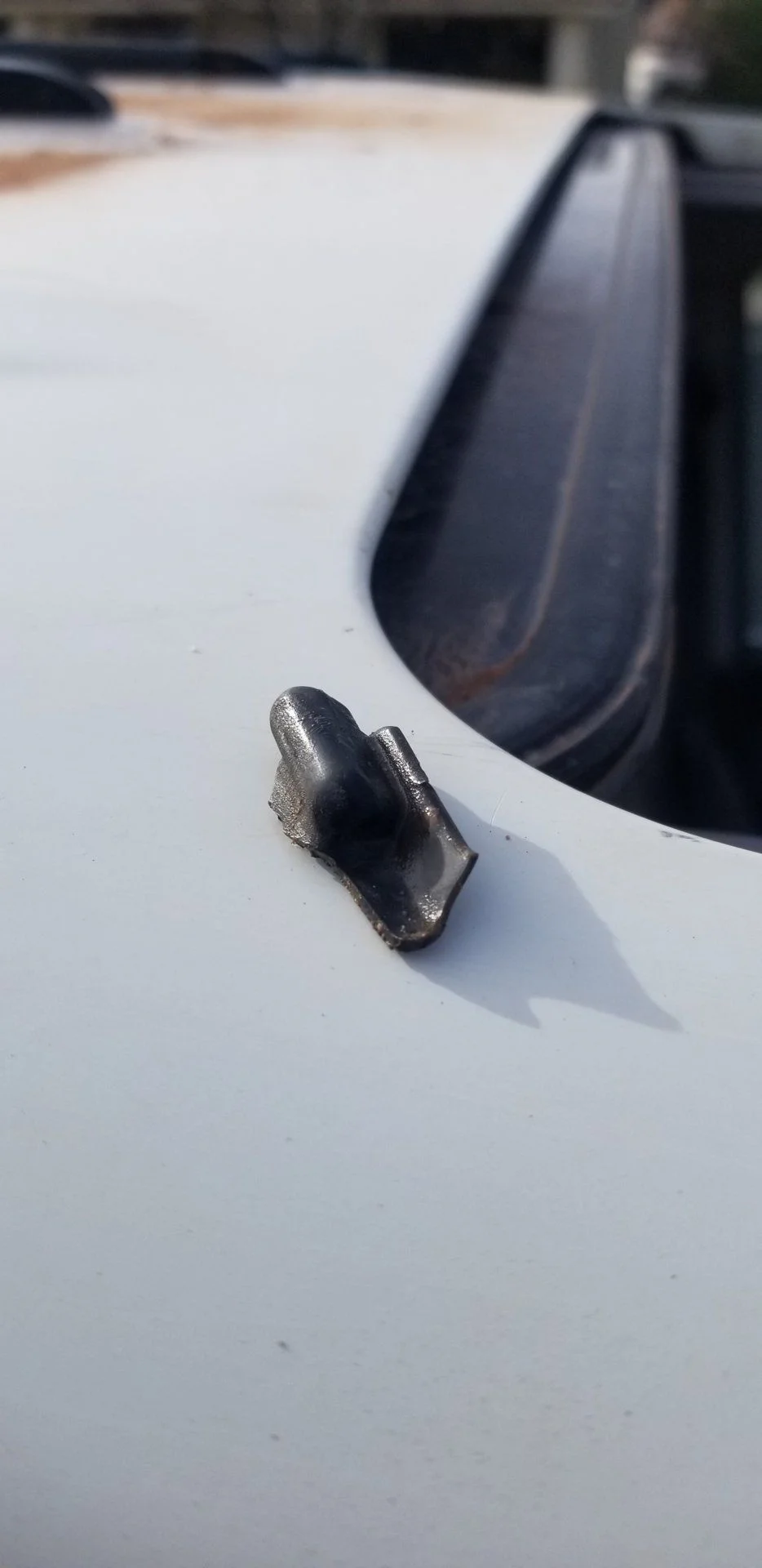

I noticed water sloshing around my 91 after this last storm. I figured my drains were clogged so I opened the moon roof to check them out. I have never messed with the moon roof and it was sticky and crusty. I was able to locate the two drain holes in the front of the moon roof on either side. This piece of plastic was inside one of the holes.
Any idea what this piece is?

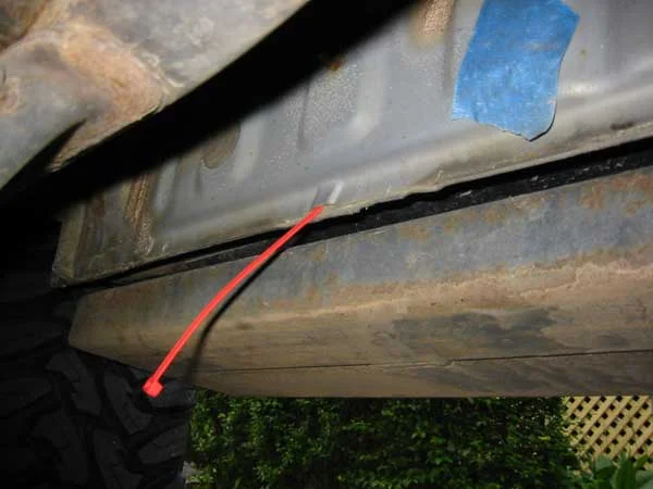

The plugs you removed are not the lowest point in the rocker. You need to clear the drains in the pinch weld as shown by the red zip tie in the picture below.

I know the slits you pic’d, but that purely just drains the hollow-core of the rockers, correct?
I find I hit the door drains & rocker drains semi-often, but I normally think when my floorpan is holding water, time to pull the 1” round plug (and frankly I think I left it out this last time) - and toss a space heater in to dry everything completely.
-Are you saying the rockers are flooded if water intrudes to the point the FR floorpans are holding water?
-I’d always just thought water in the floorpan was the drain being plugged so it ran down the A-pillar into the floorpan.
-Is my last statement false as you know the rocker/floorpan?
Not following your description and question completely but the sunroof drain empties into the rocker as long as the plastic tubing is not kinked and is positioned properly. The floorpan can get wet if the water in the rocker accumulates and sloshes around. The floorpan can get wet from a leaky windshield or rubber seals on the doors and if the vehicle is pointed downhill it can leak in further back. You need to remove the kick panels and check things out.

it truly is incredible how much water came out of my rockers when I cleared my drains a couple weeks back. It was like having the faucet on max for a good 45seconds, but yeah since clearly your slits are clogged, make sure you clear them and open up the circle black plugs under the rocker.
Once the slits are cleared you shouldnt have to unplug the rockers in the future (until they get clogged again).
If the rockers are plugged, it is possible for the sunroof drains to overflow the rockers and flood the floor pan, through the A-pillar.
The front sunroof drains snake through the A-pillar, and down through a hole in the bottom of the A-Pillar into the rockers. If the rockers fill up, it could back up into the kick panel and flood into the cabin.

yes if the rockers are full it will overflow into the cab, I personally like to remove the rocker rubber plugs and leave them out, allows the rockers to drain, the seam drains just never stay open especially on a truck that is 4x4'd

I wrote this thread a while back. I'm pretty confident the plastic piece you showed in your picture is related to the part in my thread. Good luck!
