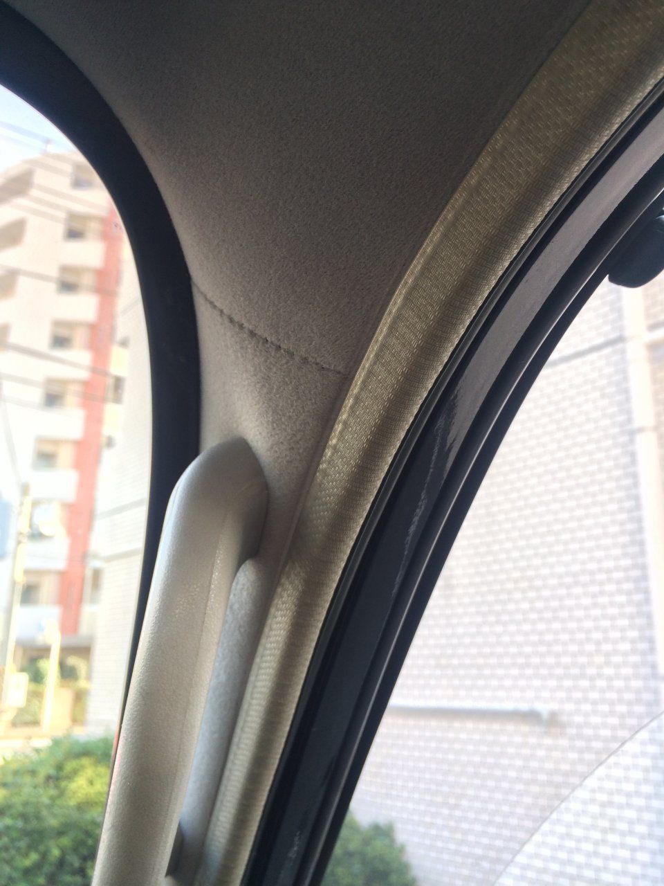

I've been dealing with a leak for the past month or so, and I just had no idea what was causing it. During rainy days, water would seep trough the headliner on the driver's side A-pillar and would develop a slow drip. I was concerned it was somehow coming in my rain gutters as there are a few cosmetic cracks in the seam, and I was quite put off by doing that kind of maintenance myself (I'm just now learning at 26 how to work on a vehicle). I wanted to inspect the A-pillar to make sure no rust was forming. I was also thinking it could be a hole in my sunroof drain and maybe there's an open seam or hole in the pillar right where it was leaking. The leak was dripping right where that seam is in the headliner above the OS handle.
I pulled down only the driver's side headliner being careful to not take too much since I didn't have any glue to stick it back up. A-pillar looked great but with a bit more snooping I looked up toward the sunroof and.... Boom, I can see clearly to the light of day. Now, this may actually be normal with the sunroof open, I'm not sure, but this piqued my interest.
